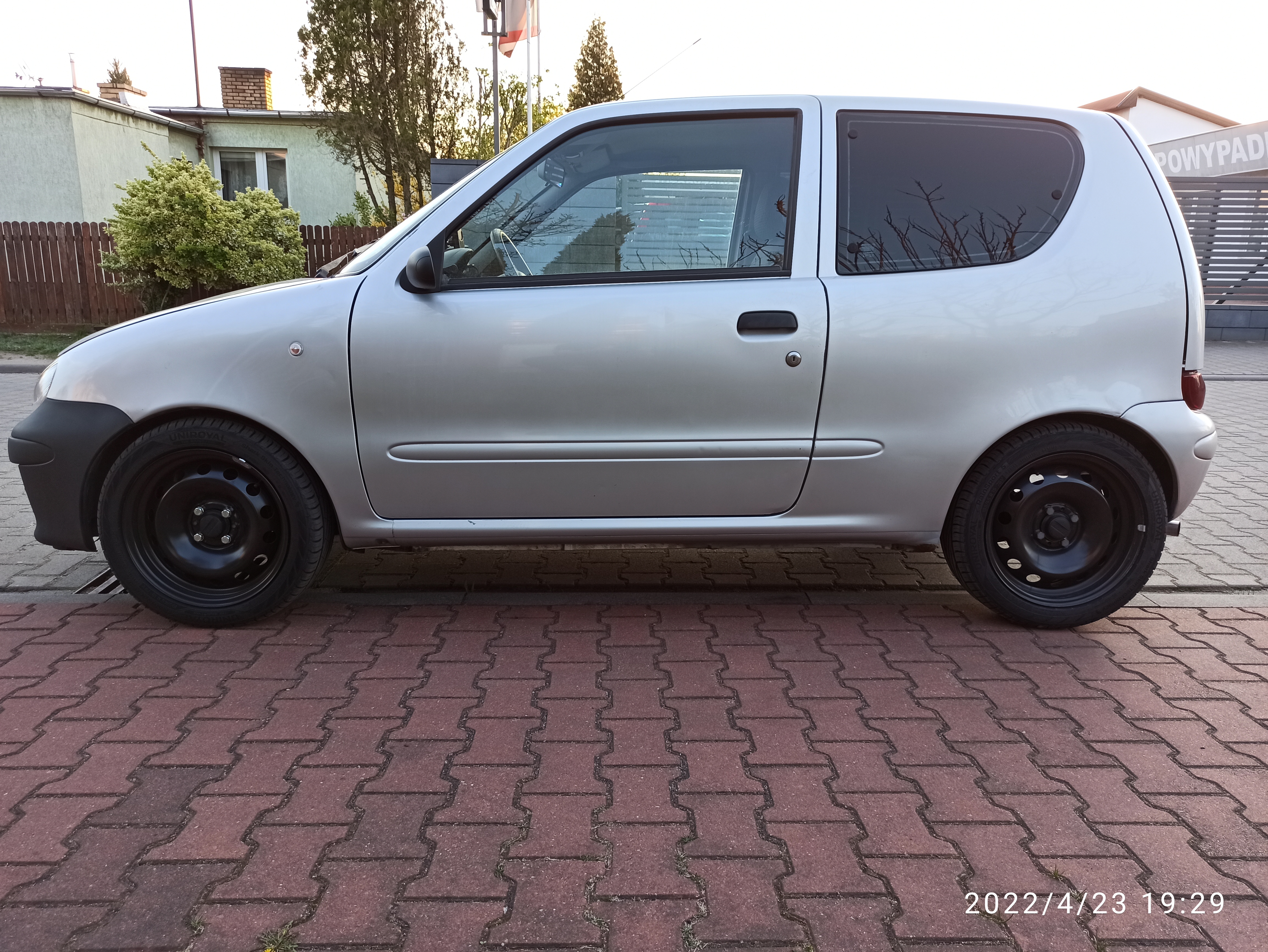

Hi there folks!
I bought a seicento hobby 1.1
Firstly out of need bc thats what i could afford but i fel in love with her.
I want to put 15inch on her.
What do i need to look out for?
Do i need to use wheel spacer? If i do how wide should i use?
Is it possible to put up a 6jx15 et 40 on her?
If it is then what tire should i put on her, and how wide spacers should i use?
Sorry for my not so perfect english
A seicento lover from Hungary
