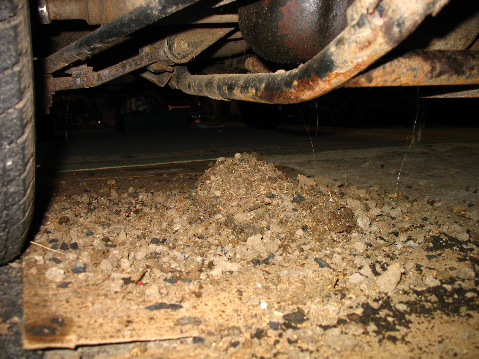

Is that gap between the propshaft and diff is normall?
Dear FFCP section members, any comments, suggestions and observation are more than welcome, especcialy regards the 4x4 drive train i.e. leaks etc.

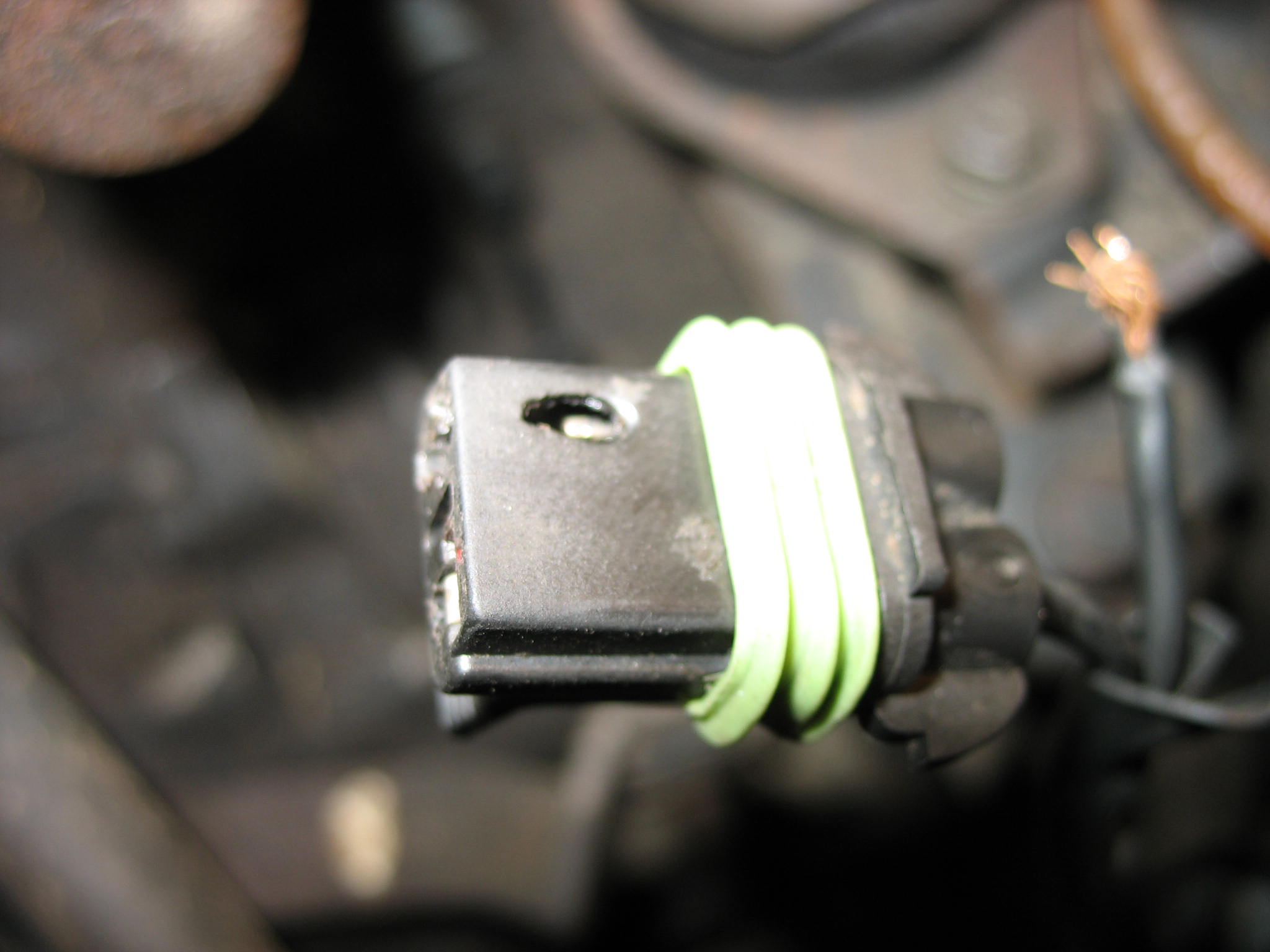

So now the horn is wired to saparate button type switch mounted in cig lighter socket place, what the C & N AUTOS garage done to the horn button wiring (read steering wheel, switch stalk) only God knows that.
Now, almost 8 years after I can say what caused horn to not operate correctly, same as 4x4 engage indicater light, and most of the electrical problems which sisley had in the past - it was all caused by
Yes, mice heavily addicted to screen wash liquid and volts.
Black and white/black cable to the 4x4 egage connector and sensor. There is much more cables affected by bloody mise, same mess at the oposite side behind the batery.

Answering the question "What happend with the timming belt cover" i can say it does not look good as the engine may now suffer from extended periods runing really hot. As you can see 3 pictures above the head temp sensor wiring was bodged allready. I left the car (outside) to run in tickover for some time to burn out any remaining oil from the exhaust manifold, after couple minutes i was expecting the rad fan to kick in - as it shoud - but nothing happend at all. The head, rad, hoses, rocker cover were really hot ( 2-3 sec max hand touch ) when the engine temp indicator was at rough low 80*C - which was not correct for sure. I did fiddle the female blue crimp connector at the engine temp sensor at the pointer went streight to high 90*C in few seconds, so why fan didn not kicked in?
Now I know why, the black/violet cable conductor was still crimped in the right place, but the actual contact between male/female crimp pin was bad generating much heat melting the plug not letting the fan operate as the power feed runs thru the temp switch.
