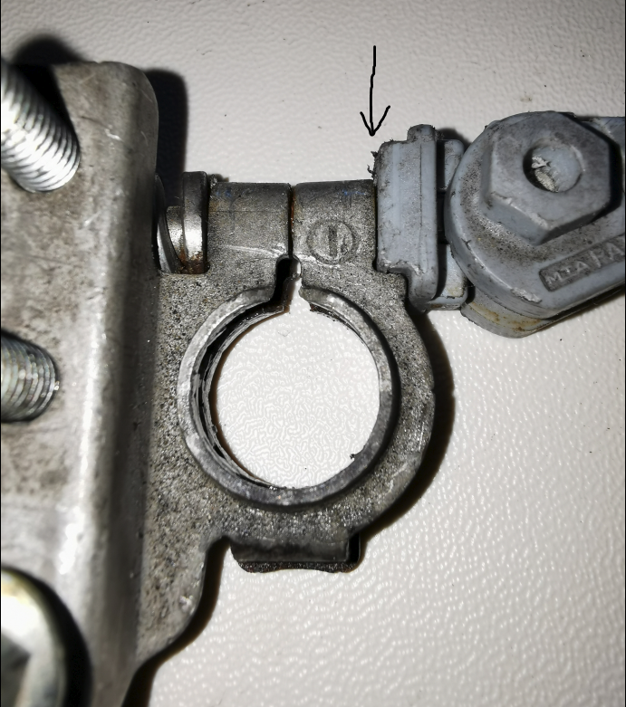

Pull yellow tab as much you can then keep press on black tab and pull from this part of the connector.
I do not see anything wrong with = batt terminal.

One of the bolts missing from the positive side, not sure that's how it should be?

The missing nut on the lowest bolt of the positive battery connector (the one marked with the red arrow in post #41) is not a problem. In fact, it's not missing. The bolt is there just in case some optionnal equipment would need extra power / cables.

I've noticed a bolt is missing from the positive battery lead, not sure that's important or not.

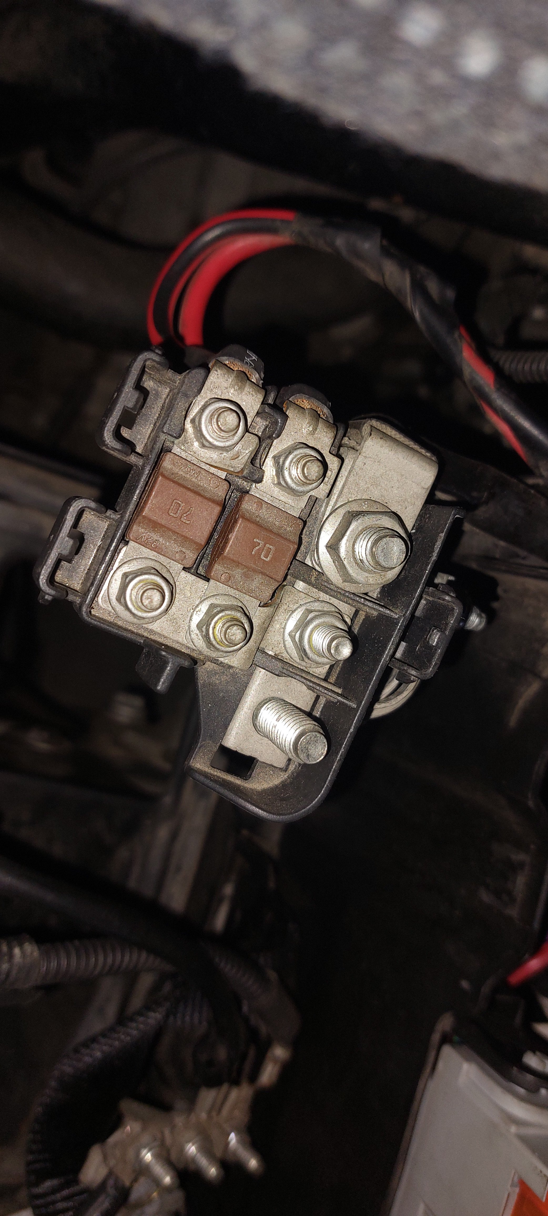

First, check the connectors on the battery, if they are clean and are firmly attatched (the negative connector in my Ducato is a quick release one, it had a minor play even when attached, so I added a washer (where the arrow points) between the connector and a screw, now it holds the battery connector firmly).
Check the grounding cables (there are lots of them in the car, I wanted to find a diagram but it seems there isn't one for the Bravo or I just can't find it).
What is the voltage MES is showing when the engine is running? Should be around 14,4 V. Check also the charging voltage on the battery terminal. Should be more or less the same. If there's a bigger difference it can mean that there's some connection problem on the loom that goes to ECU / BCM. Could be due to higher resistance.
Disconnect the battery (following the procedure if there is one in the owners' handbook, as shorts on the battery can damage the airbag module) for some time - 20, 30 minutes. Same for BCM / ECU looms.
Once disconnected, check the BCM and ECU connectors for oxidation. Clean them if necessary. Use some contact spray. Try not to push too much of the product into the module (do it when the connectors are facing downwards).
Check if the main looms BCM / ECU looms do not touch any metal elements (body) that could lead to insulation damage and shorts.
After each step you can check for new errors on MES. After reconnecting the battery let the engine run for some time (15 - 20 minutes should be fine, you can go for a ride).

I've already checked the battery leads, even under the battery tray, the earthing points too, all looks very solid. Even had a new battery in place, but engine stalled the same.
With multimeter voltage 12.7v, running 14.4v, didn't dip below 11v when starting the engine. When the engine is cold, starts great.
