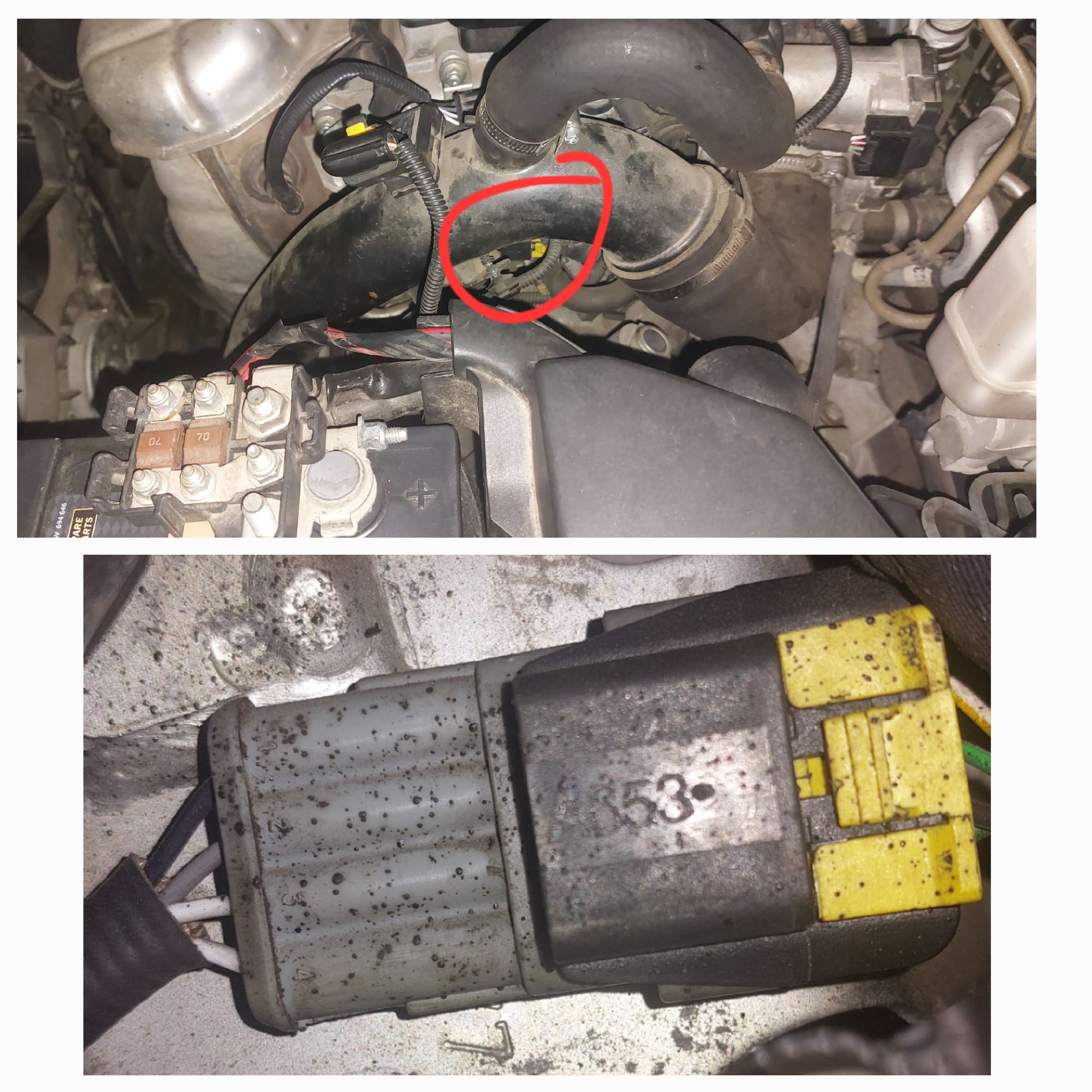

I'll have a look, I assume it's this one?
Is there a way to test it, or should I just get another one? Thanks

The sensor looks like that:
EDIT: the aftersales.fiat does not work again :( so I won't be able to check how to test the sensor. It shall give different voltage when hot / cold. But don't know the values.
Another useful information about the sensor:
