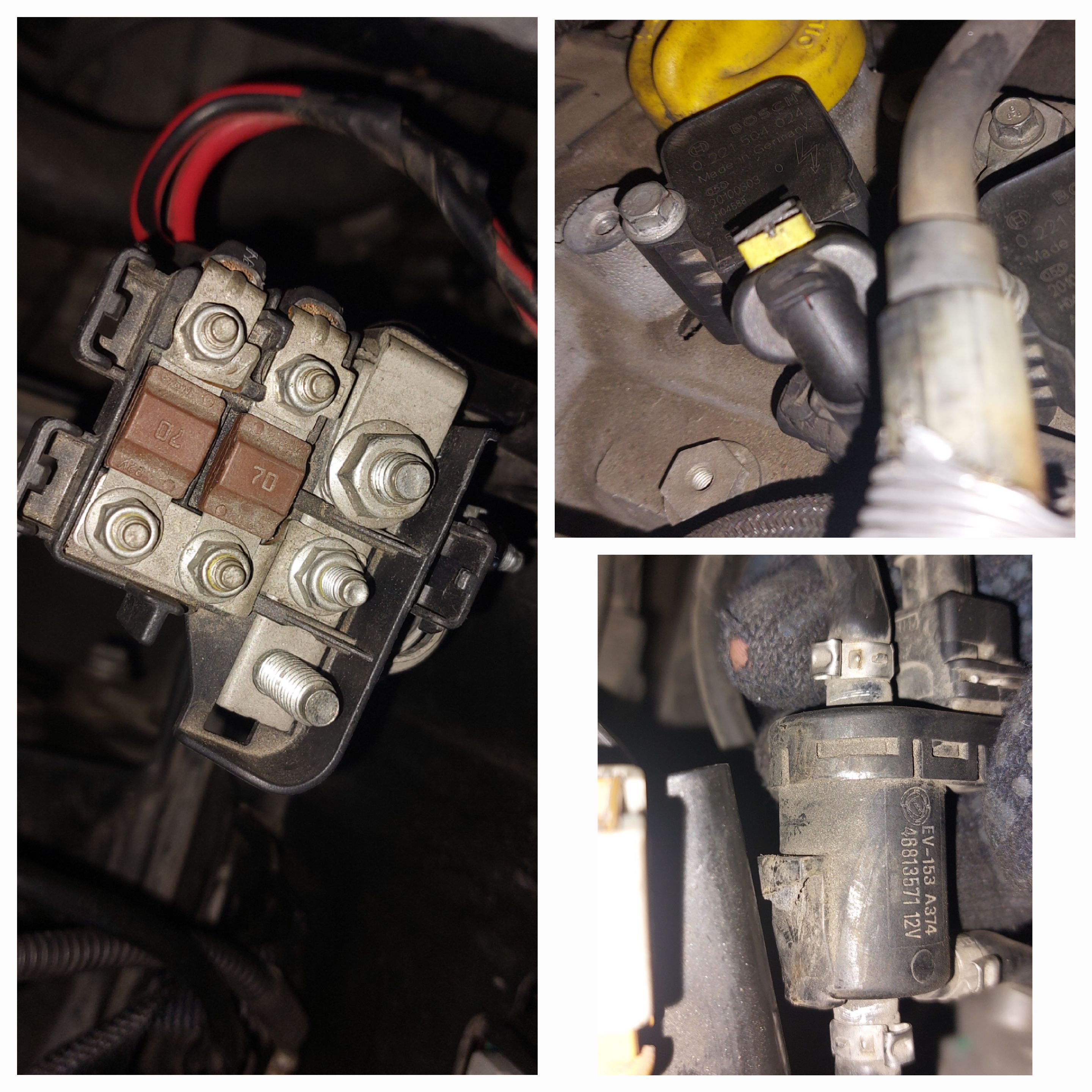

So....I've checked the engine and found these:
-This line has a lot of play, is it normal?
-This line has a bit of play as well, the one below the yellow crank position sensor(?), is that normal?
-Battery cables looks good, only has very few split bits, earth points are solid:
3 IN 1 picture:
-Turbo solenoid tab is broken, been held by ziptie/1 bolt is missing from battery positive, not sure it matters/ 1 spark plug connectors has bent top
That's all I've managed to find for now.
Could any of these cause the engine cut, especially the cables with play?
Thanks for any info.

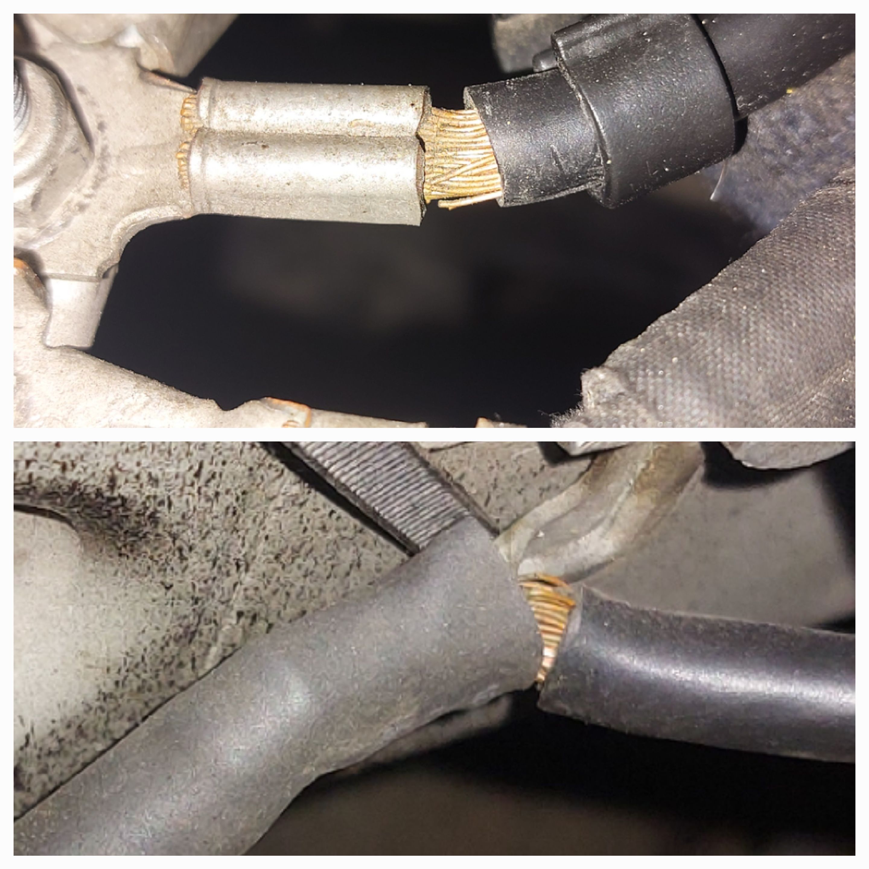

Hi, I've checked the engine today and posted what I found with pictures just above. The most concerning are the lose lines, show in the video, not sure those are normal. Any idea any of those issues may be related? Thanks
Rough roads .... cut out when reverse gear used....
Suspect battery main cables , especially the negative cable . On other models the main battery negative wires are very prone to disintegration under black covering.

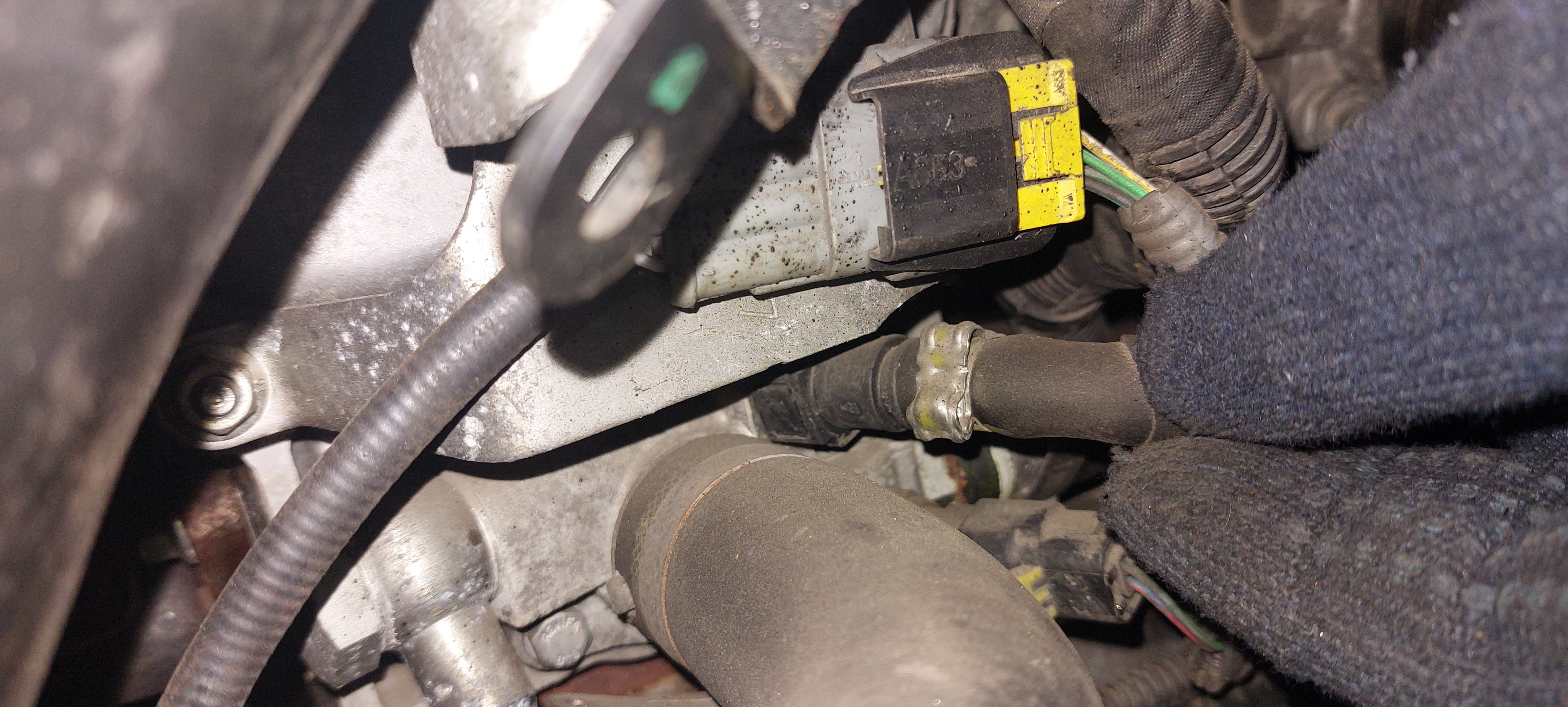

Lamba and cranks sensor's are common things to fail when the engine is hot and prevent the engine restarting at least they used to be
I've checked a few things today, the yellow crank sensor looks okay from outside, but I'm definitely looking into it as well. There's a few wobbly lines, posted all with pictures, cheers.
Re the crank position sensor, I didn't see if it has been mentioned , but usually the rev counter will not even flicker if that fails.:)
Hi, yes it's been mentioned, I'm looking into it as well. I know its difficult to access, but other than that, does a new one need adaptation or some software calibration? I've done TB and EGR adaptation on my previous car, but not sure about crankshaft sensor. Cheers Mike.

Checking the crank position sensor when engine will not start is simply a case of seeing if any sign of movement of the cars rev counter when turning the starter, if the rev counter is trying to flicker or move, generally that would indicate that the crank position sensor is working and sending a signal to the cars ECU telling it when to fire and that the problem lies elsewhere.

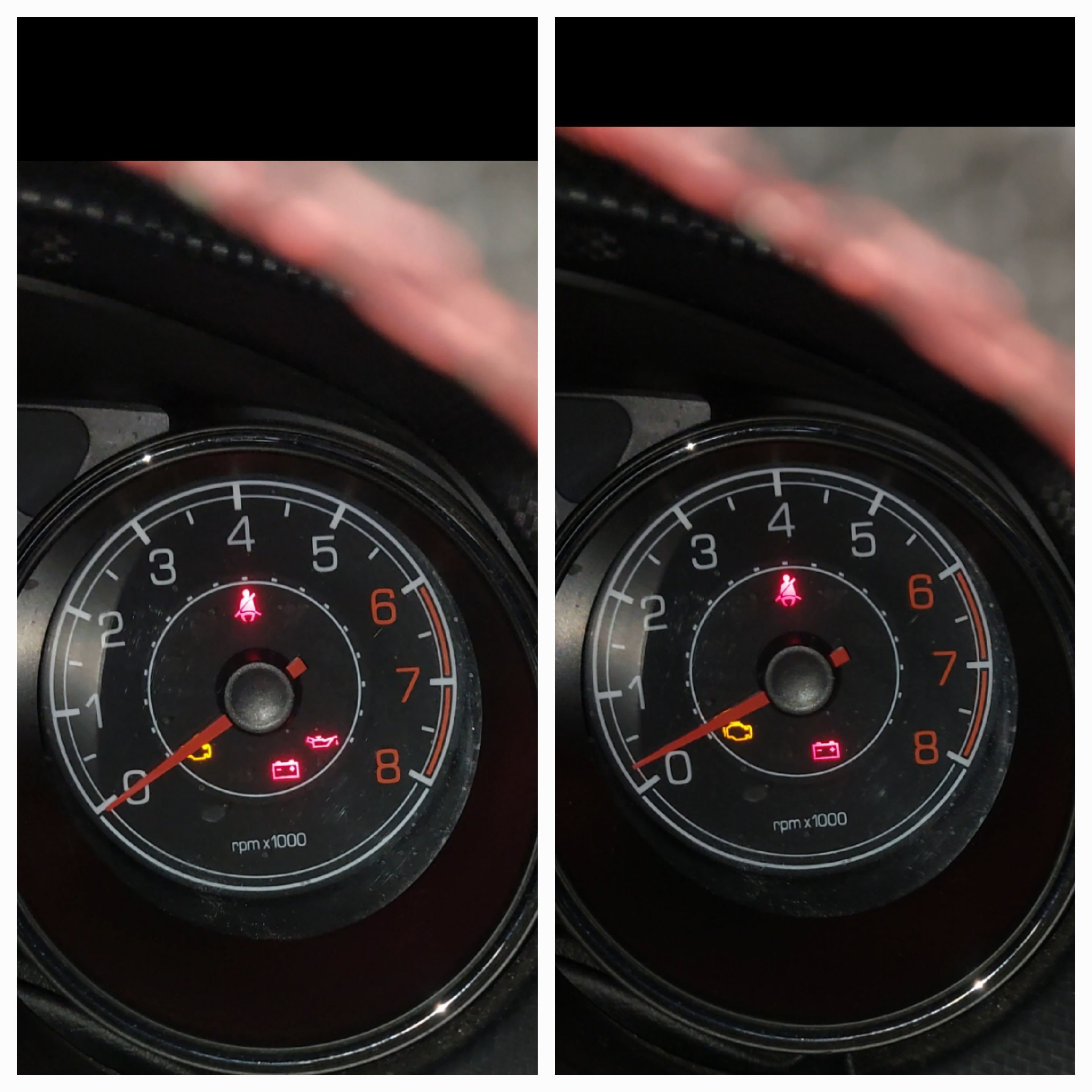

Hi, I've checked and when the warmed up engine stalls again, upon trying to restart it, it doesn't fire up, but the needle does moves slightly, picture shows the difference.
Does it mean the crankshaft sensor is actually good?
Are Crankshaft Sensor and Crankshaft Pulse sensor are the same?

So rev counter moving a little when engine not working should indicate crank sensor less likely to be the issue as it is sending a signal back to the ECU and on to the Rev counter. :)

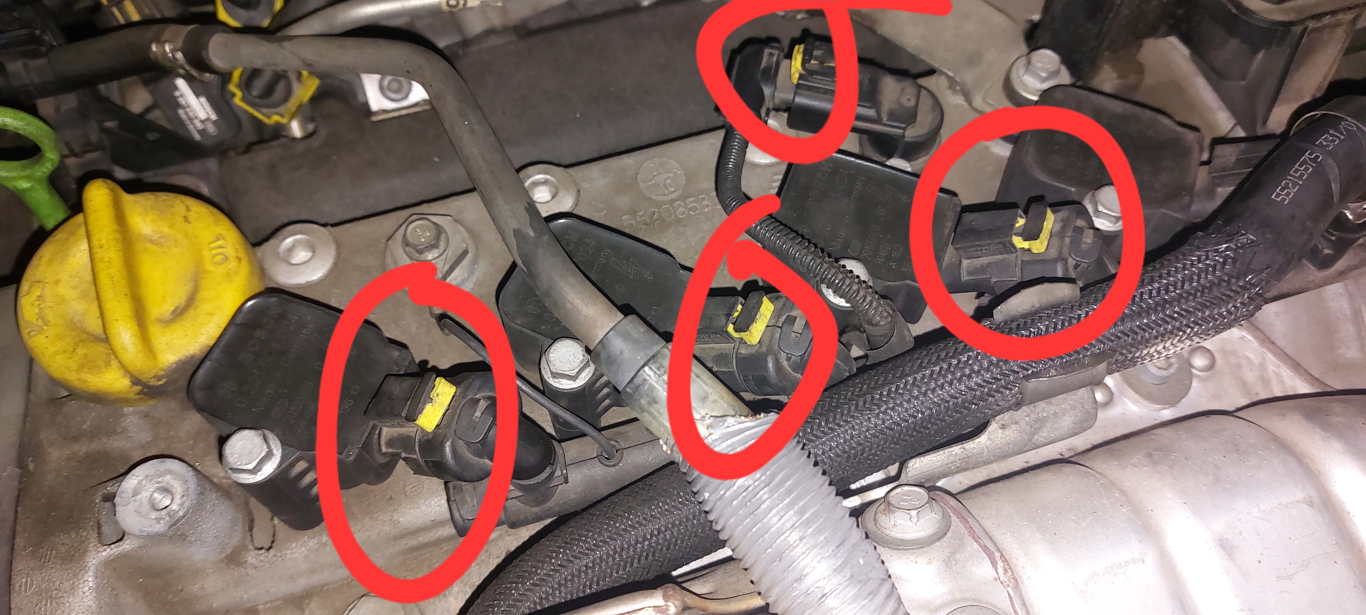

Btw how to remove the yellow tabs from things like sparks plugs and sensors?
It's a push, pull or lift it?
Thanks
Thanks
The yellow tabs are slightly different to my Fiats, but generally they are locking to prevent pushing the release bit that allows the plug to pull off.

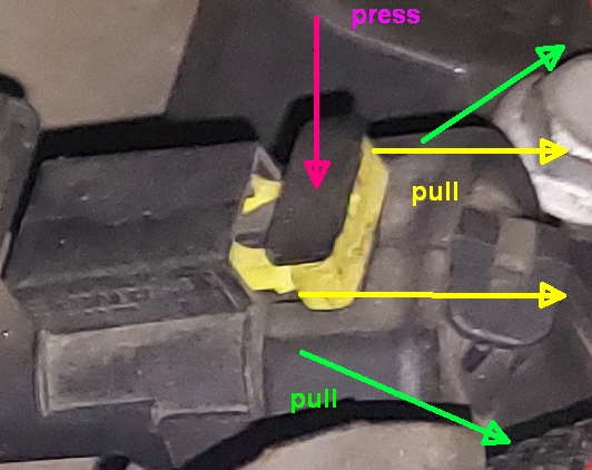

I've tried to move it around a tad, don't want to force it too hard, but doesn't seem to buldge any direction. Anyway, I'll figure it out tomorrow, cheers.
Pull yellow tab as much you can then keep press on black tab and pull from this part of the connector.
