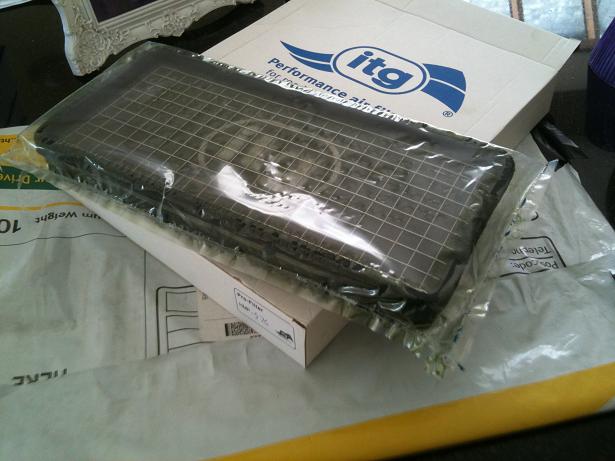

When I came home this evening there was a 'note' from the Courier that he was here with that ITG Panel Filter - so it's in the country !

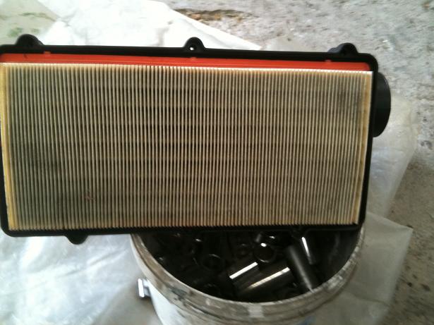

I have finally put in a ITG Panel filter and can report back on the result. Ordered from Camskill and after the last c*** up - really my own fault - ordered the wrong filter I was re-imbursed for the FIRE 1.2 panel filter plus the delivery cost - impressive service from Camskill - so I placed my order with them again. Because its an export and I'm registered for VAT cost of filter plus post came to £58.77
I had dithered about getting another Pipercross CAI, GSR, BMC Panel filler (cotton gauze) or even a 'cheaper' K&N Panel filter and opted for what I believe is the best panel filter - the ITG despite a possible warranty impact.
Wrapped well. Pretty hard to damage a filter in the post.
Feels well made and bit oily in the hands.:)
The 'old' filter has quite a bit of dirt despite only having done 2.5K miles (changed last Nov).
Changing the filter literally took no more that 10-15 minutes.
