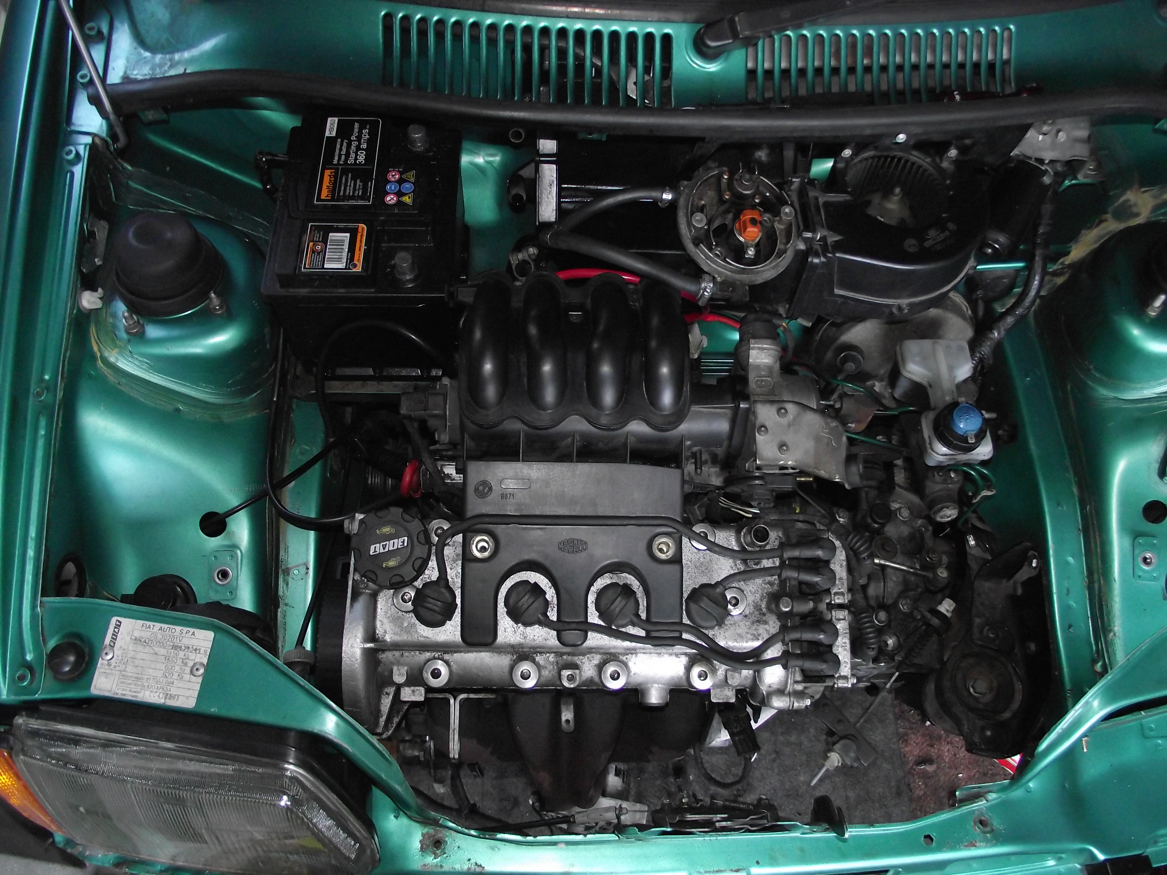

Cinquecento my green cinq project.
The day i got the cinq sx with its crap racing stripes :p
looking rather good for its age 1995 no rust no dents no deep scuffs
i previously owned a mk1 punto 60s but ive always wanted a cinq so after i purchased cinq i striped the punto down to bear chassis including engine and gearbox :D loom and so on ive been collecting parts for the 1.2 conversion for a while p75 cams full engine rebuild re skim using a big cnc machine from college :) cinq gearbox and mounts ect

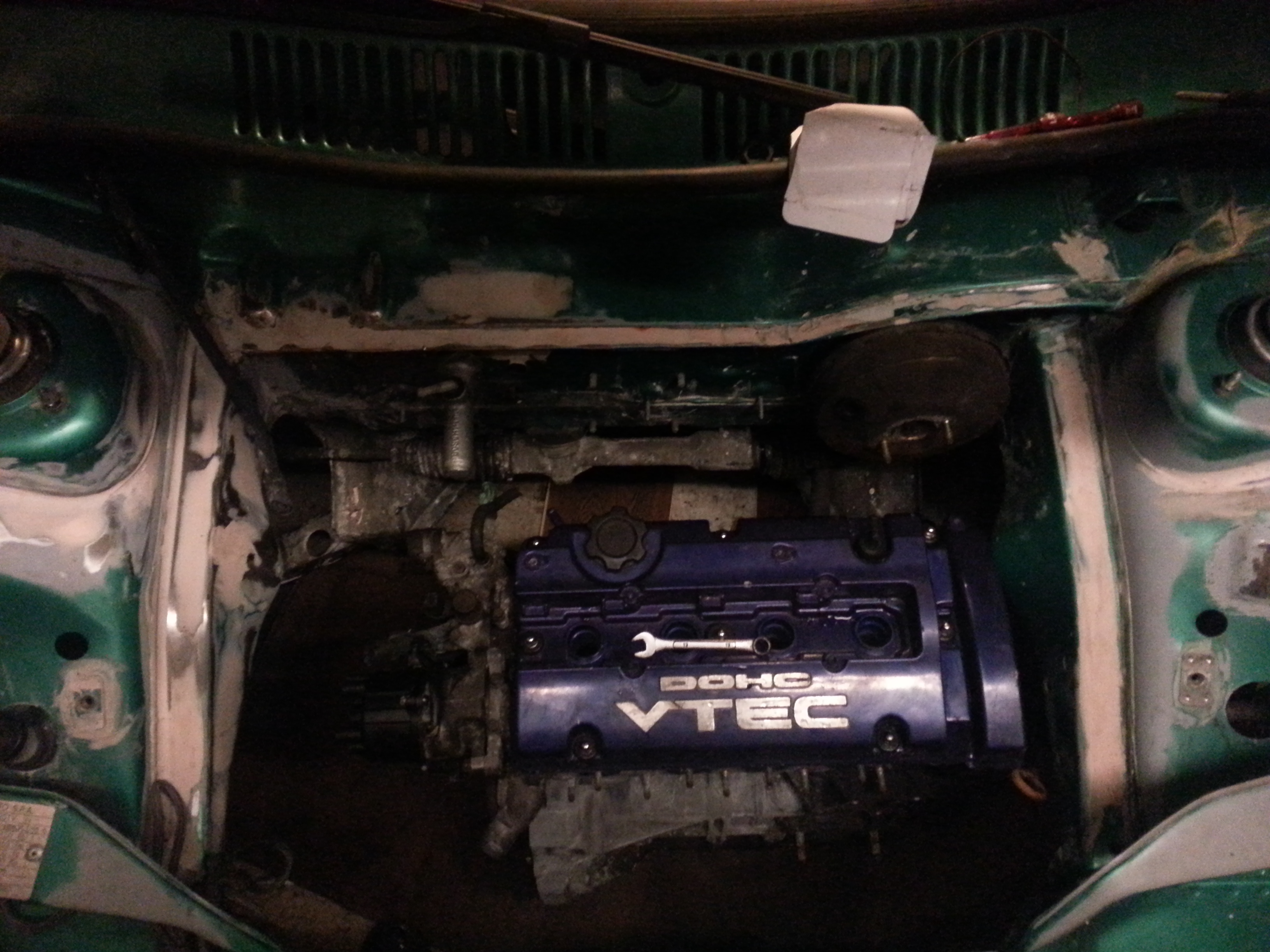

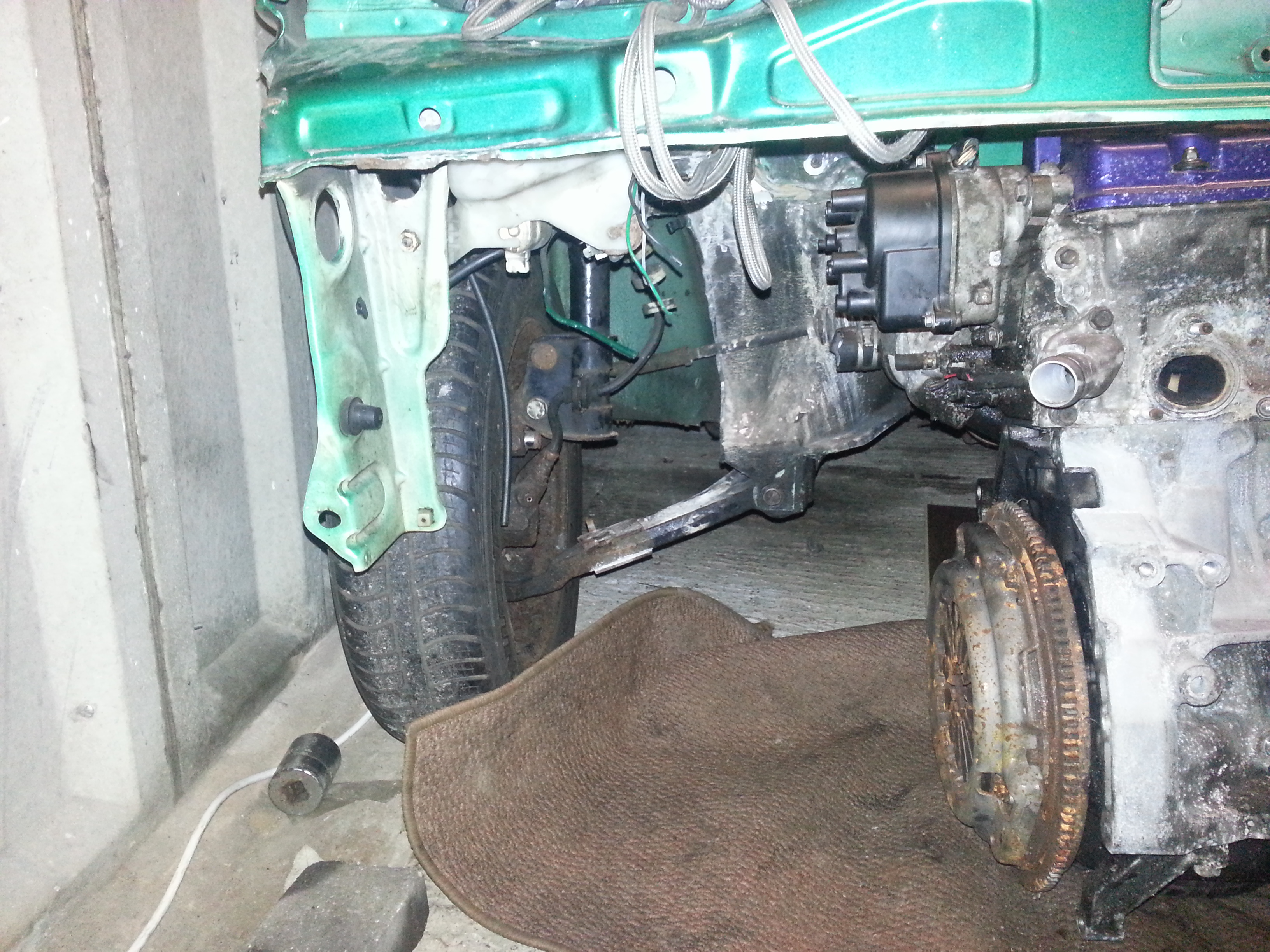

Love it... Be interested to see it with the box on, and on a crane in the rough fitted position, as im sure you will need to mod the passenger chassis leg...
Be worthwhile bolting the box on, as it probably will change where the engine sits...
Looking good so far!
Thinking of making a subframe for it oh yeh no need for engine cranes in this garage haha but cutting legs and welding plates in and that may as well make a subframe and yeh will bolt box on on weekend but so far things are looking good for space but those legs may need to be swapped for stronger boxsection but I think I have come up with a method to keep the standard bay style went to get grinding disks today will do all the figuring out tomorrow :)
