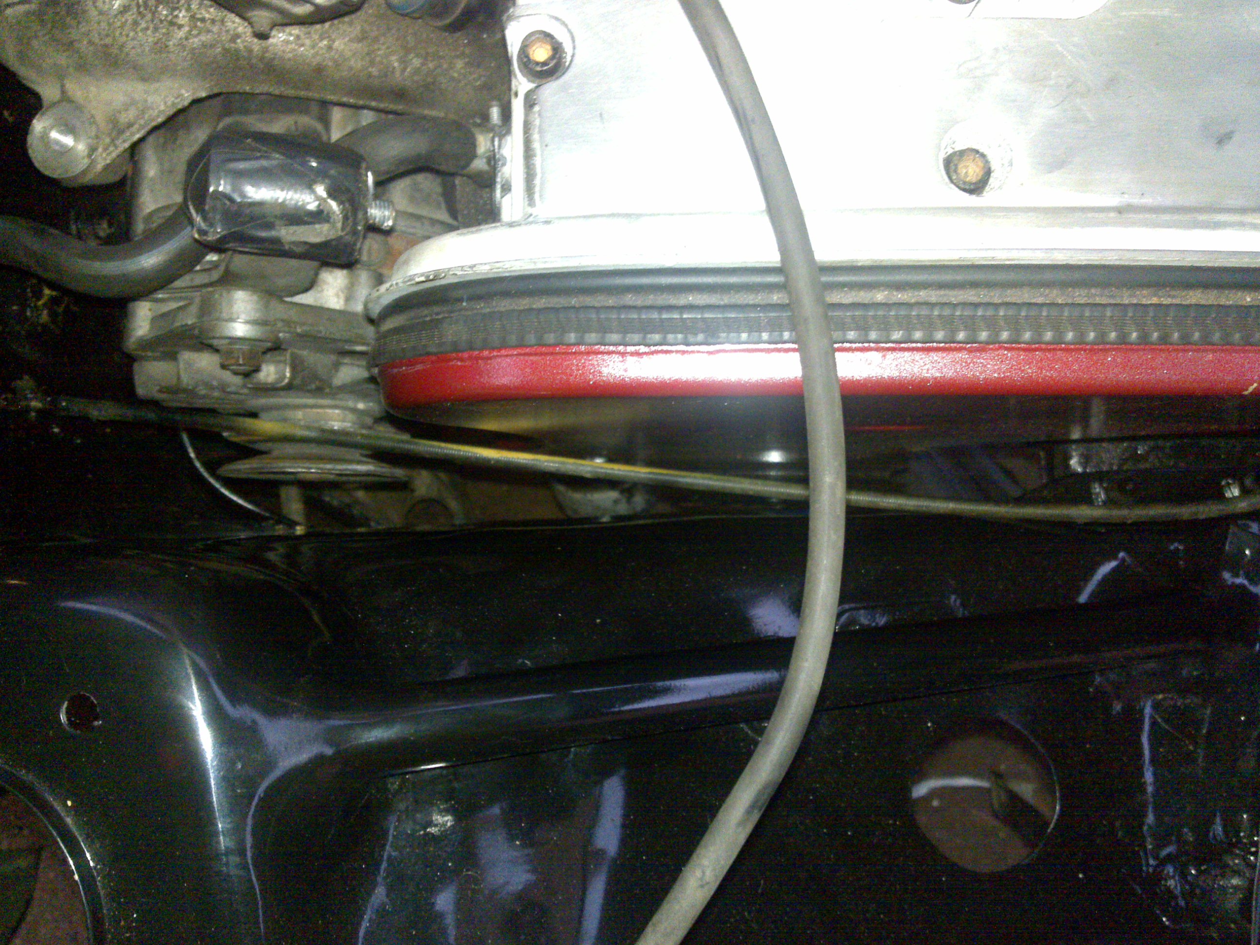

Where have you taken the measurements of the bay from? Reason i ask is the horns are a funny shape as they get lower, giving next to no room... I had to remove practially one of the legs and replace with bar-work all around the engine bay to re-strengthen it... Looking back at it i could have done it better, but the point is i could not get the engine in as its was..
This was the room i had to play with (as you can see the leg was practially non existant on one side)....
And another pic of the engine in place... Sure your block built up could be a tad wider?

i have a complete list of mesurments of a cinqs bay taking more or less everything into account i can supply them if you wish ?
Yea, would be interesting to know what you got measurement wise. My measurements are on here on the 'measuring engine bay for redtop' or a thread along them lines lol.
The horn to horn measurement is a lot narrower than if its just measured at the easy to get to parts haha.
Can't wait to see this get started lol
Length longest point = 50cm at a push
With from stock engine mounting points = 70cm
Then widest point = 75cm
Distance from space saver tire on the floor to the sutle panel 75cm
Then distance from space saver to bonnet latch = 50cm
Full lock wheel distance from chassis leg to tire = 10cm
Distance from stock engine configuration from nearside wheel no lock to the tip of box = 10cm
