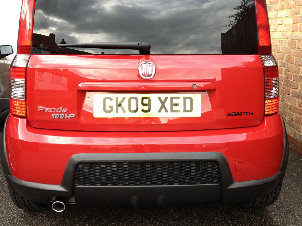

Our family is a great supporter of the 100hp!! ImageUploadedByFIAT Forum1368723596.094678.jpg
