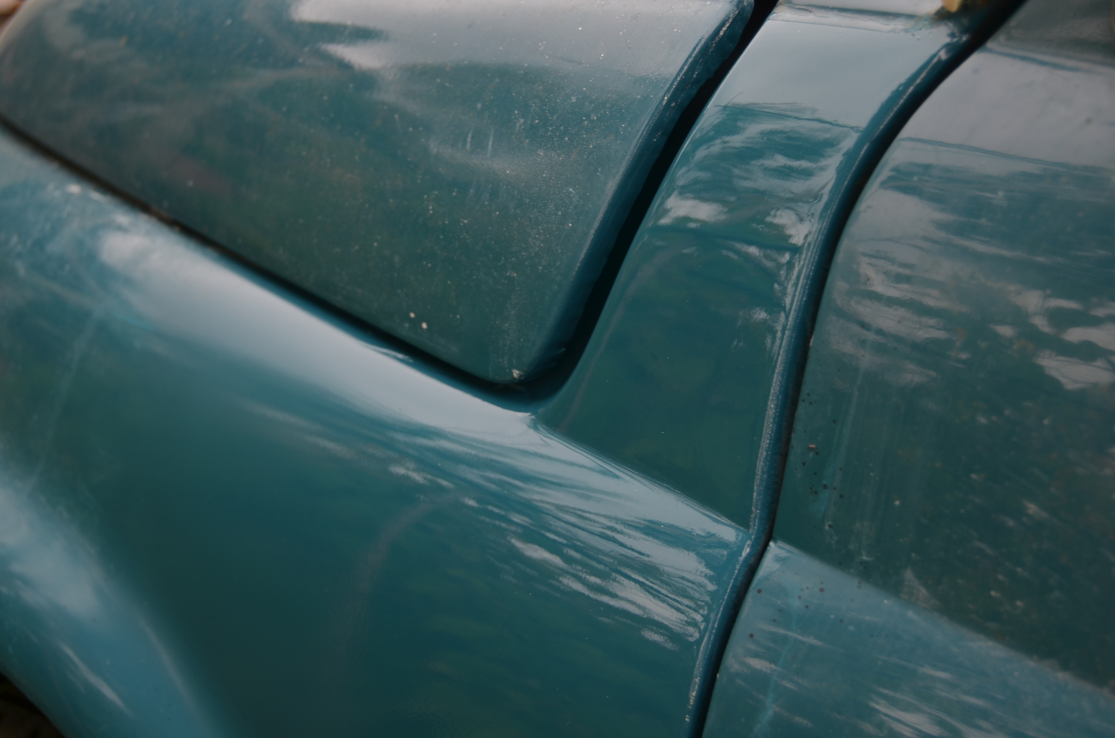

Just at the time when I presume that most people are putting in the bulk of their annual mileage, Murf has hardly meandered at all for the last few weeks. I've been away on holiday and then had a few quiet weeks at work. But that has meant I have been able to sort out several areas of the bodywork that had started to acquire a bad infection of rust. These areas included parts of the rear wheelarches, on one side where the slope of the roof-section meets the rear wing, the top of one front wing where it meets the scuttle and (worst of all) the joint between the front panel and the wing on the driver's side.
I've scratched away at all of these with a Dremel and treated and re-treated with phosphoric acid until all traces of rust were eliminated; no rust was so bad that welding repairs were needed. Then two coats of epoxy-paint followed on, then high-build primer, with polyester stopper where necessary and then five coats of cellulose paint. The whole car is now shabby and dusty apart from these shiny new areas. But it will now scrub up fairly well once I've worked to blend the new areas with the old.
It's looking like a bit of this sort of renewal is going to be an annual job if I persist in vehicle abuse in the way I have been doing; the front panel needs a full respray for cosmetic reasons, due to stonechips, but it looks likely that Murf will at least get his proper cosy garage back during the forthcoming winter.

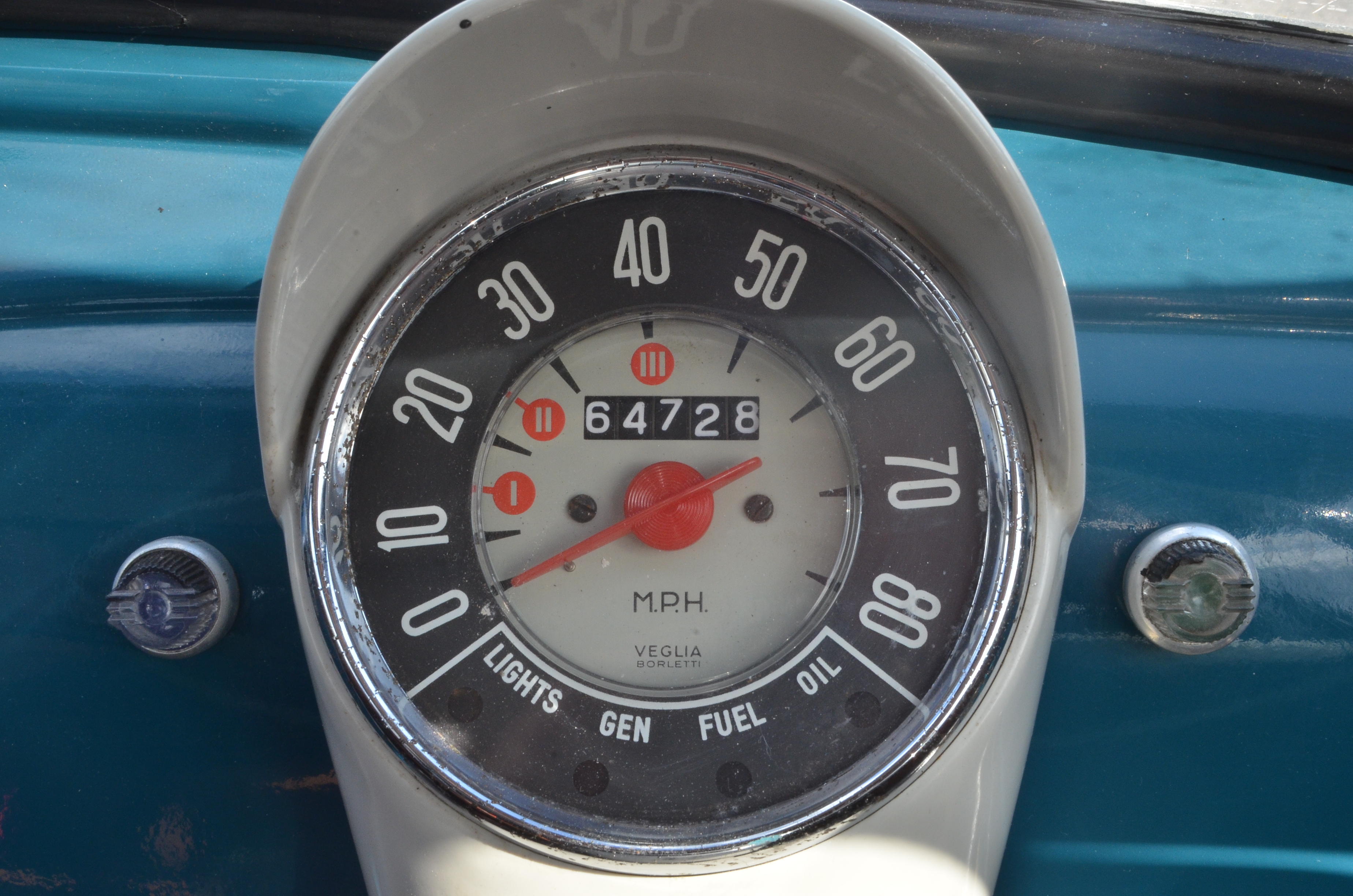

It's his birthday on November 21st. Before then there will be another almost literal milestone when I will equal the mileage the car had covered before my ownership. :)

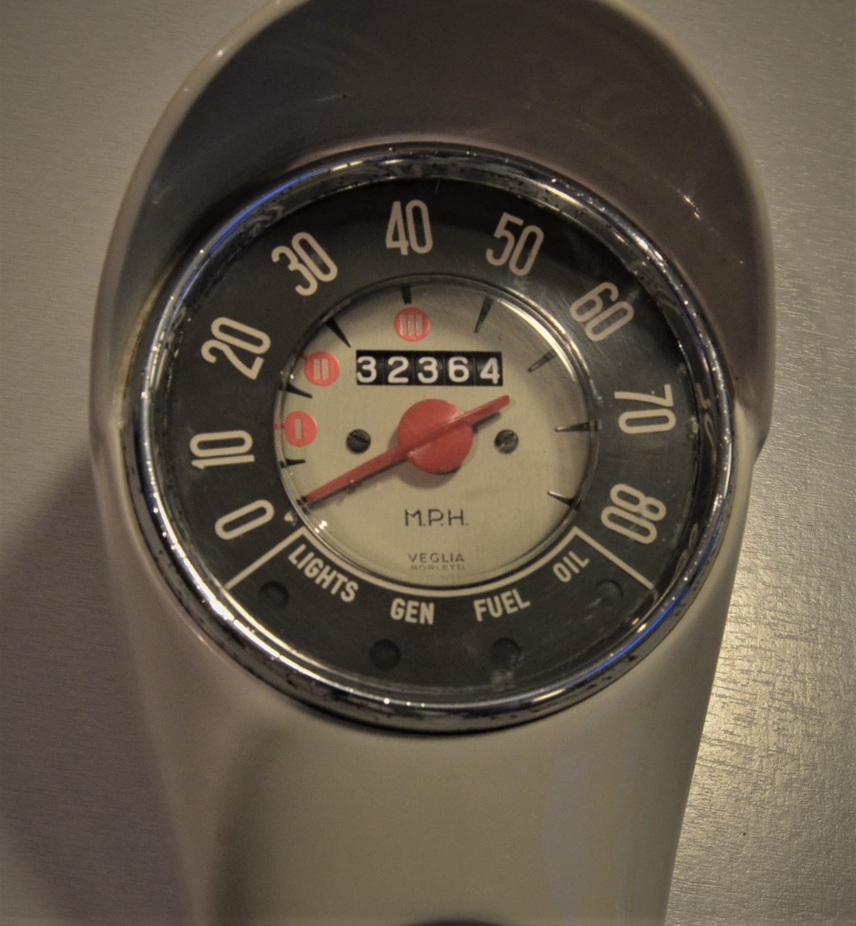

Today we reached that milestone; so we've done 32,364 miles (or 52,084 km), in a bit less than five years since getting Murf back on the road. We had a celebratory picture with another form of transport at Lossiemouth Harbour.
I think I can now consider myself to be the major, lifetime owner of the car as from this point I can be sure I have driven him further than any previous owner-driver.
This also means the replacement 652cc engine has propelled me the same number of miles as the original, refurbished 499cc before it blew out a valve-seat. Worryingly, the original engine had never sounded better until shortly before the incident; at the moment, this engine seems to be as near perfect as it could be too.:D:bang
But onwards and upwards; we will keep going for as long as it takes for me to be certain that a (more or less ;) ) unmodified Fiat 500 can be reliably driven over long and continuous distances. ;)
