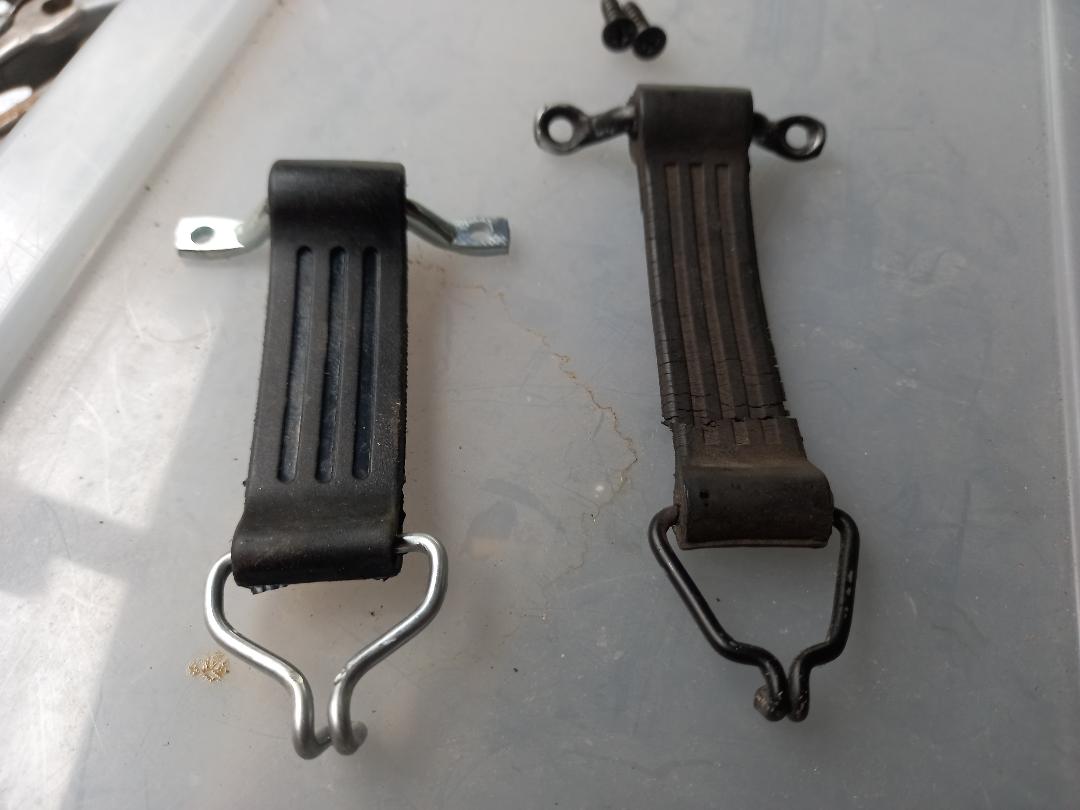

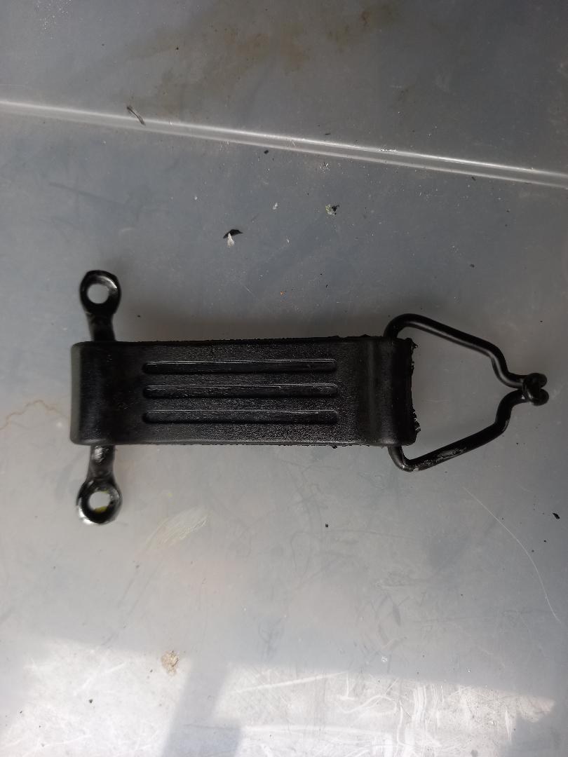

Keeping on top of little problems is important. So a new pair of spark plugs, a rubber rocker gasket and a new restraint strap for the rear seat were ordered. As usual, the pattern parts keep giving (or not!) You can see that the size, shape and finish of the hook and the securing bracket are different from original. There is no countersink for the screws on the bracket. The rubber strap seems short, but I'm putting that down maybe to the old one being stretched after 55 years! None of this affects function, and perhaps matters only to the "odd" person like me. But I removed and disposed of the new metal parts and fitted the old parts to the strap....that's better.

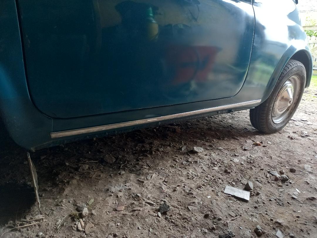

I had to remove the sill trims so that I could repair the rusty sills. I've previously said that the holes that take the plastic fixings are a stupid idea and that they probably make a big contributions to how readily the sills rust away on the 500. In the past I have used a combination of sticky rubber pads and PU sealant to keep them in place. That works OK once you have them fixed in place, but finding the correct position and securing the strips whilst the adhesive sets is very tricky. Last time, the strips ended up slightly out of level, and the glue seems to get everywhere.
In view of this and after finding that the sills rust regardless of whether or not you use the trim clips I've revised my opinion. For once, the aftermarket clips that are available for this purpose seem better than the originals. they seem to be made from slightly softer plastic which seals against the inside of the holes reassuringly.
I used a stepped drill to make the 8mm holes .
I didn't like to leave exposed steel, even though it would be hidden, so I then painted two coats of zinc primer around the raw edges, followed by a generous amount of Waxoyl.
The plastic clips push in by hand and then you pop in the central dowel, which locks them in place.
It doesn't look perfect because of the multiple repair patches hidden behind the multi-shade paint; I have slightly lost the correct contours of the sill. But I think the stainless steel trims add an appropriate finishing touch to a 500; they look a bit underdressed without it.
