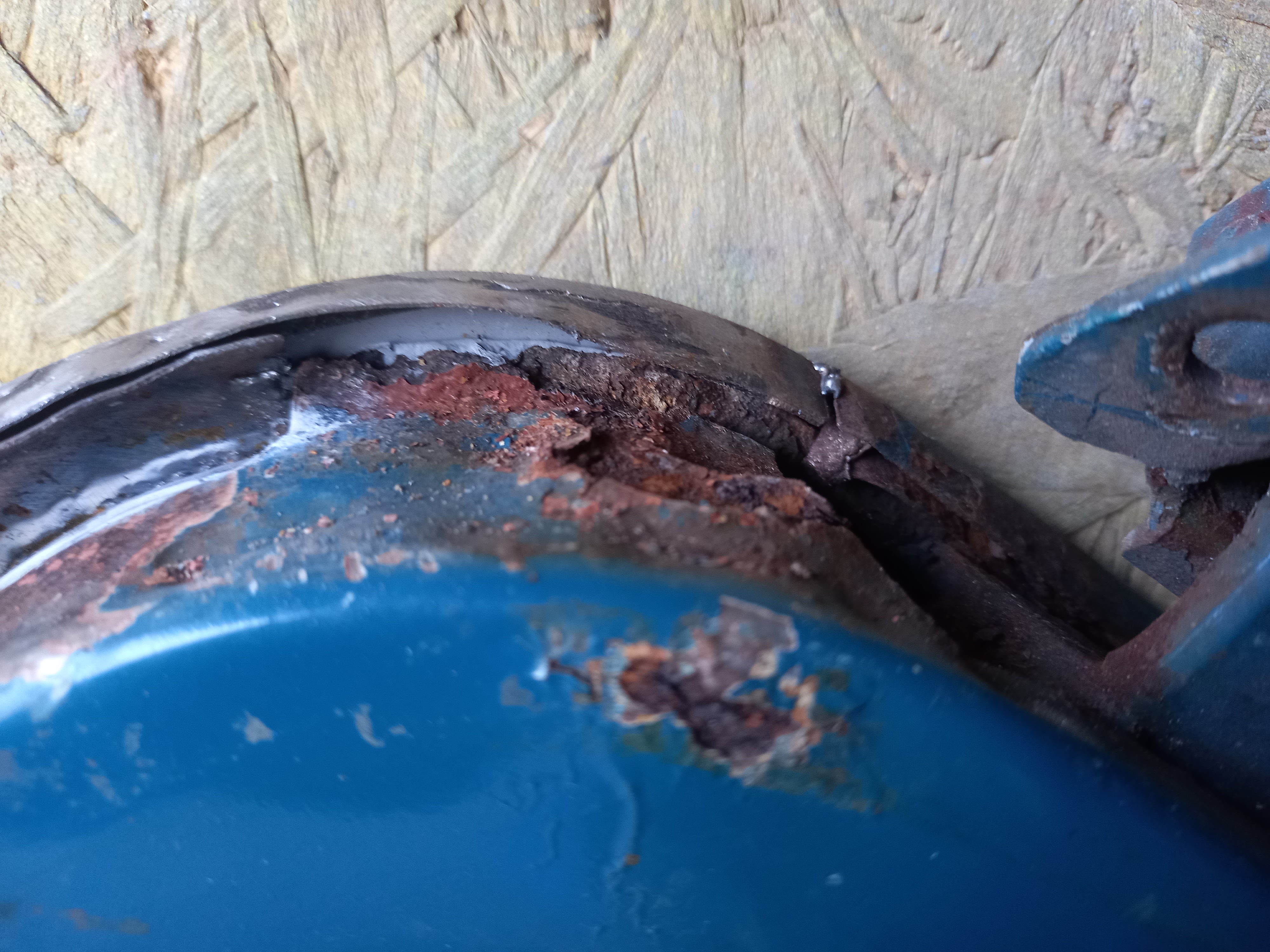

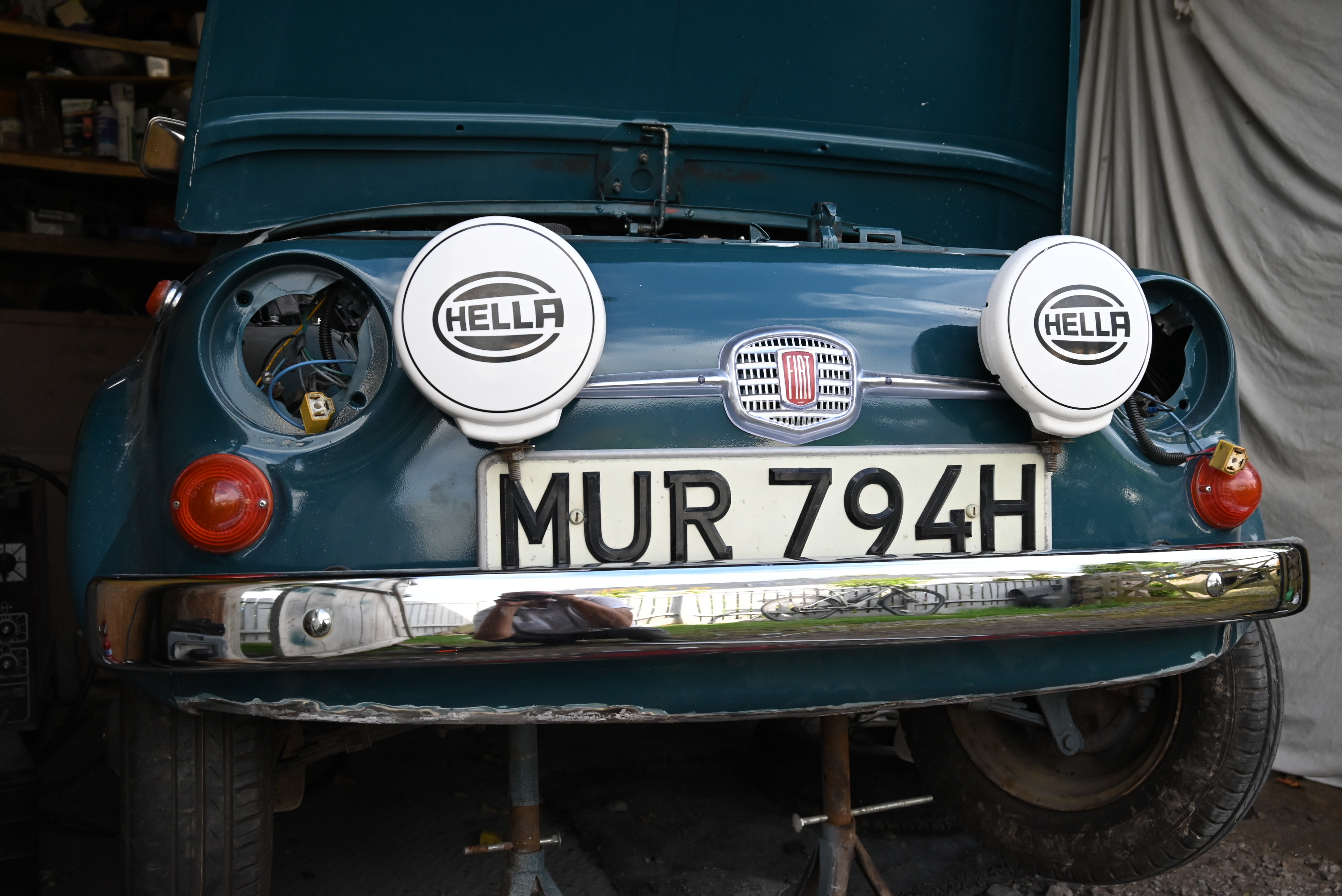

Seeing shiny paint on the rear wing where it used to be embarrassingly rusty got me thinking about other rusty areas. The front panel on Murf has been scarred by innumerable stonechips and corrosion that was started when I drilled holes for a bonnet safety-catch and spotlights.

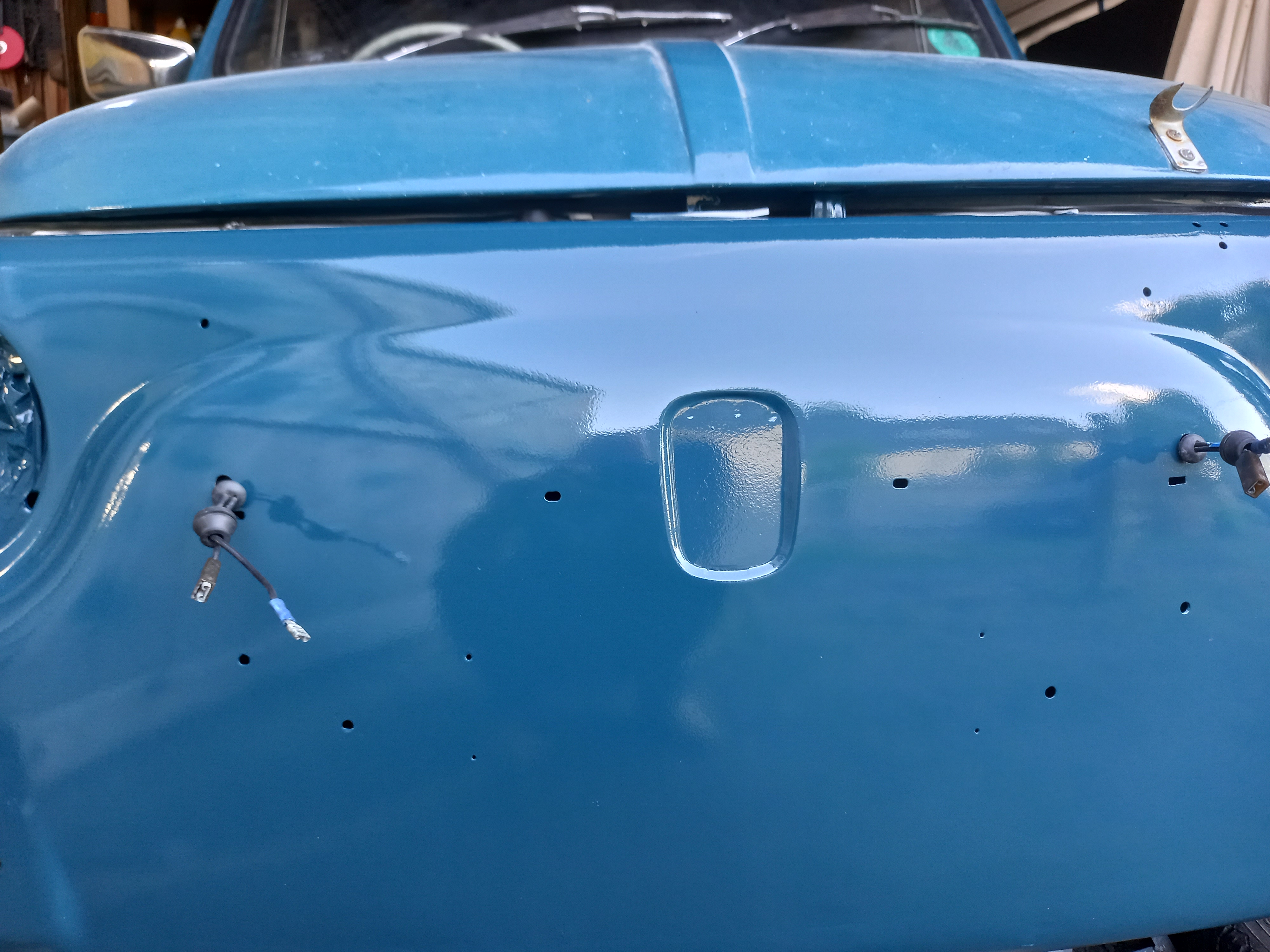

It's the original front panel and I want to keep it that way. So I sanded down to bare steel where needed and then etched away all the rust pitting and coated with epoxy primer followed by cellulose.
It looks much better now although the darker shade of 419 Blu Turchese jars a little against my previous colour mix. Maybe it's faded?
I took the image to show a detail that I have frequently mentioned before. Ignoring the many extra holes I have made, you may see four tiny pilot holes that were intended for the small, Italian plates. Despite being an "F" for which all the suppliers suggest a front panel with a round hole under the winged badge, my car has the indent for the "L" motif, which is small enough to be hidden by the badge. The four, bigger mounting holes for that badge are obviously also present.

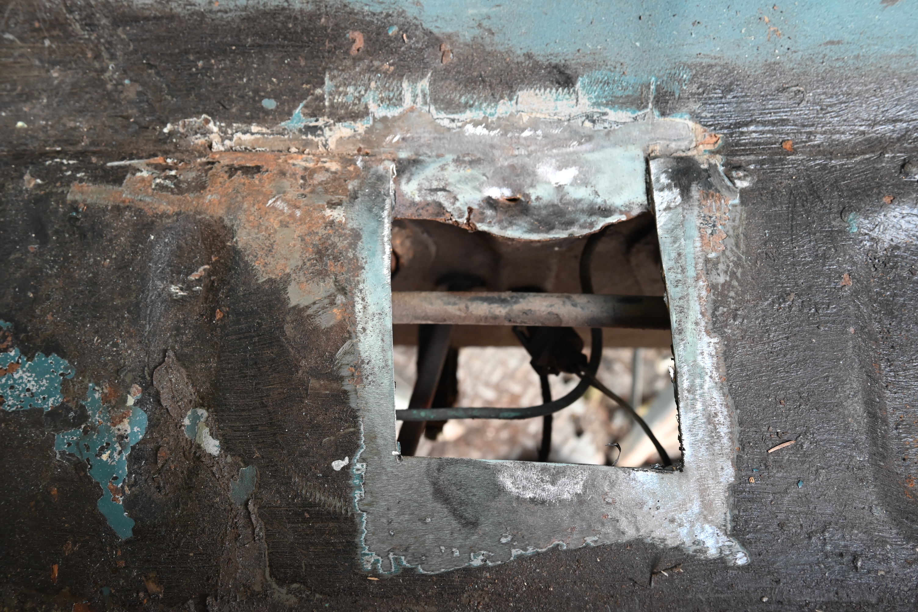

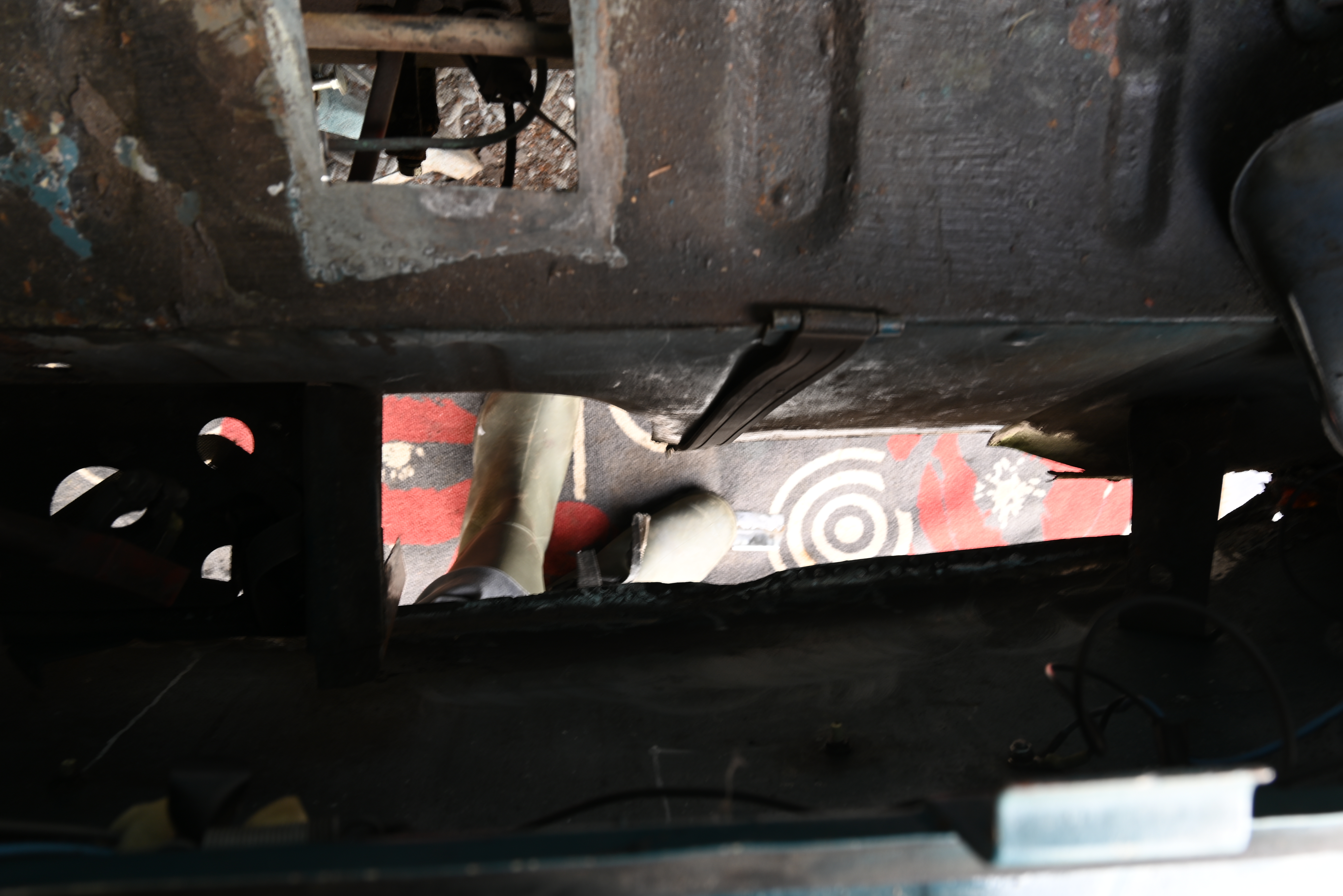

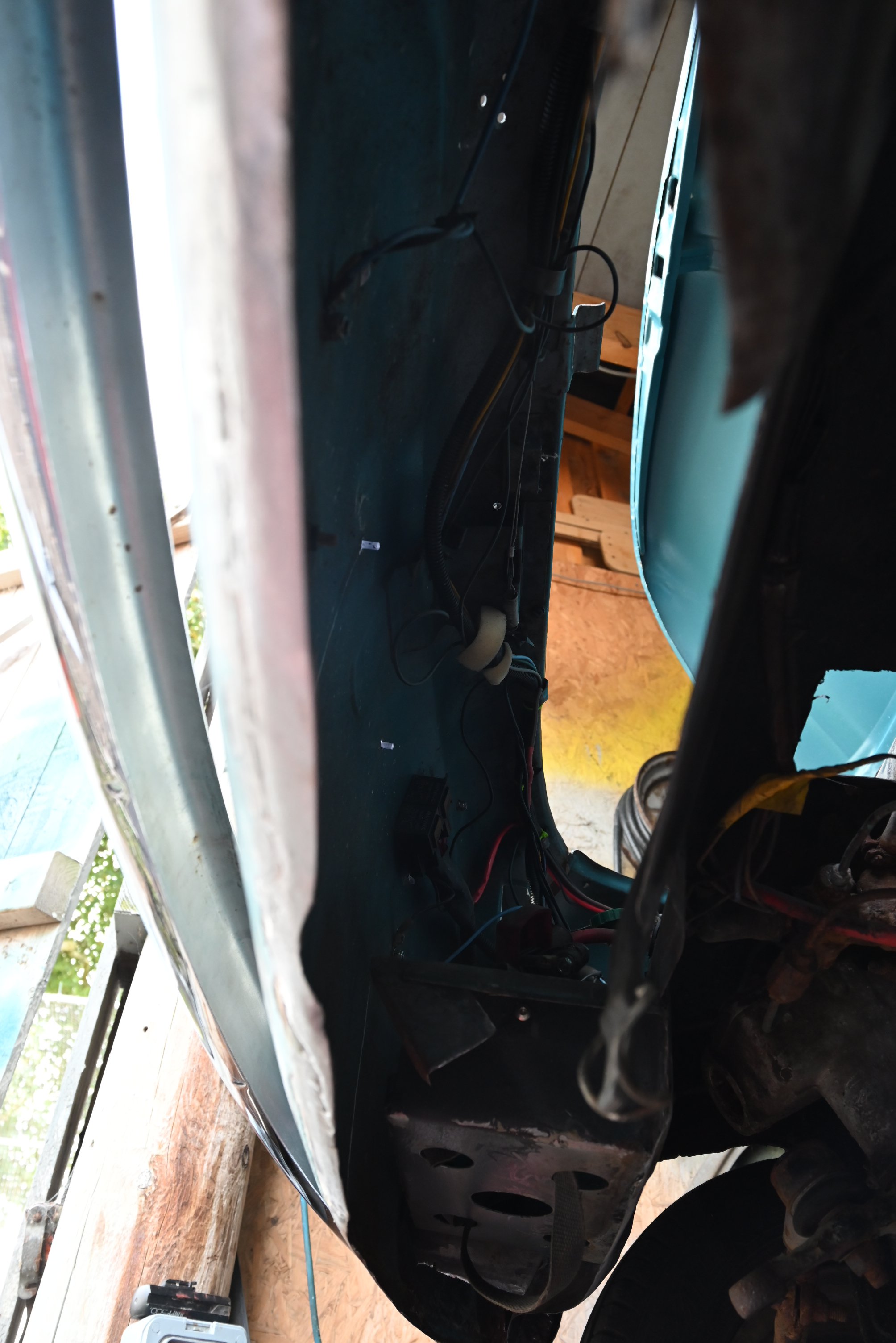

Big nasty hole above master cylinder.
He was getting there...just awaiting new headlamps. I recently noticed that the number plate was put on off-centre 54 years ago......it's the original.
Big, big hole. :(
Looking down at my wellie.

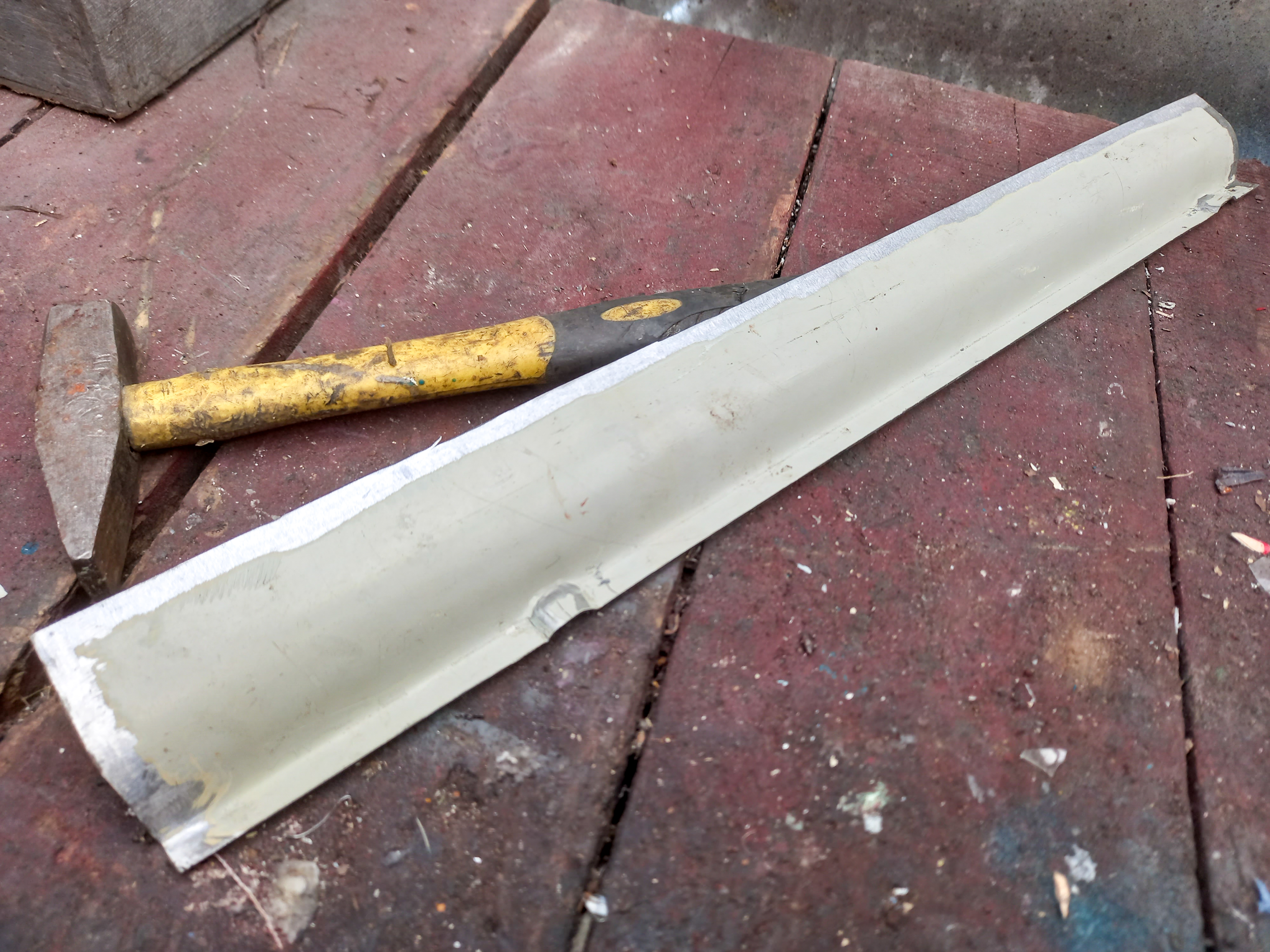

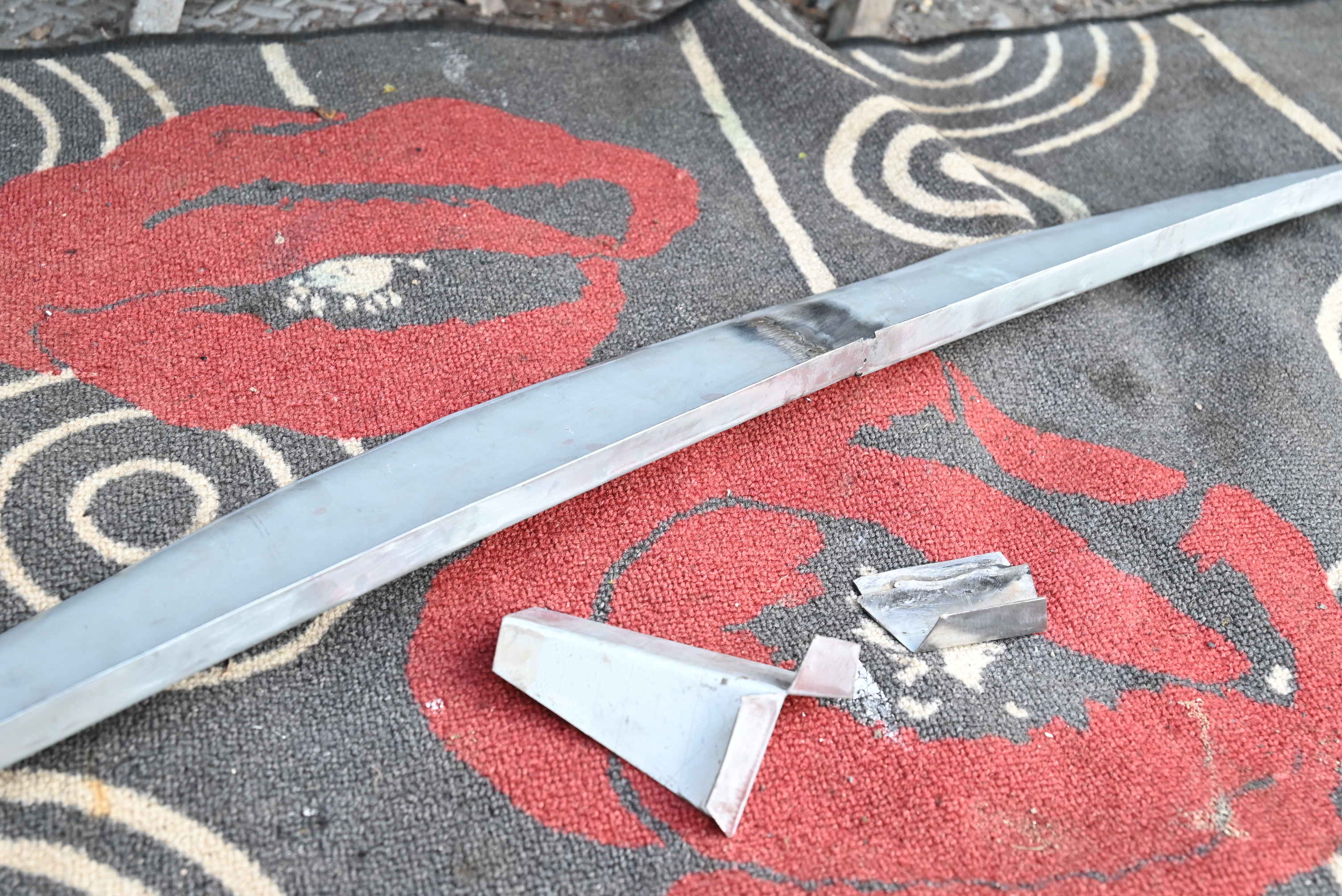

I had to make the replacement in two sections so that it would fit in my metal-folder. Then a bit of a tweak with a hammer and dolly to get the curve.

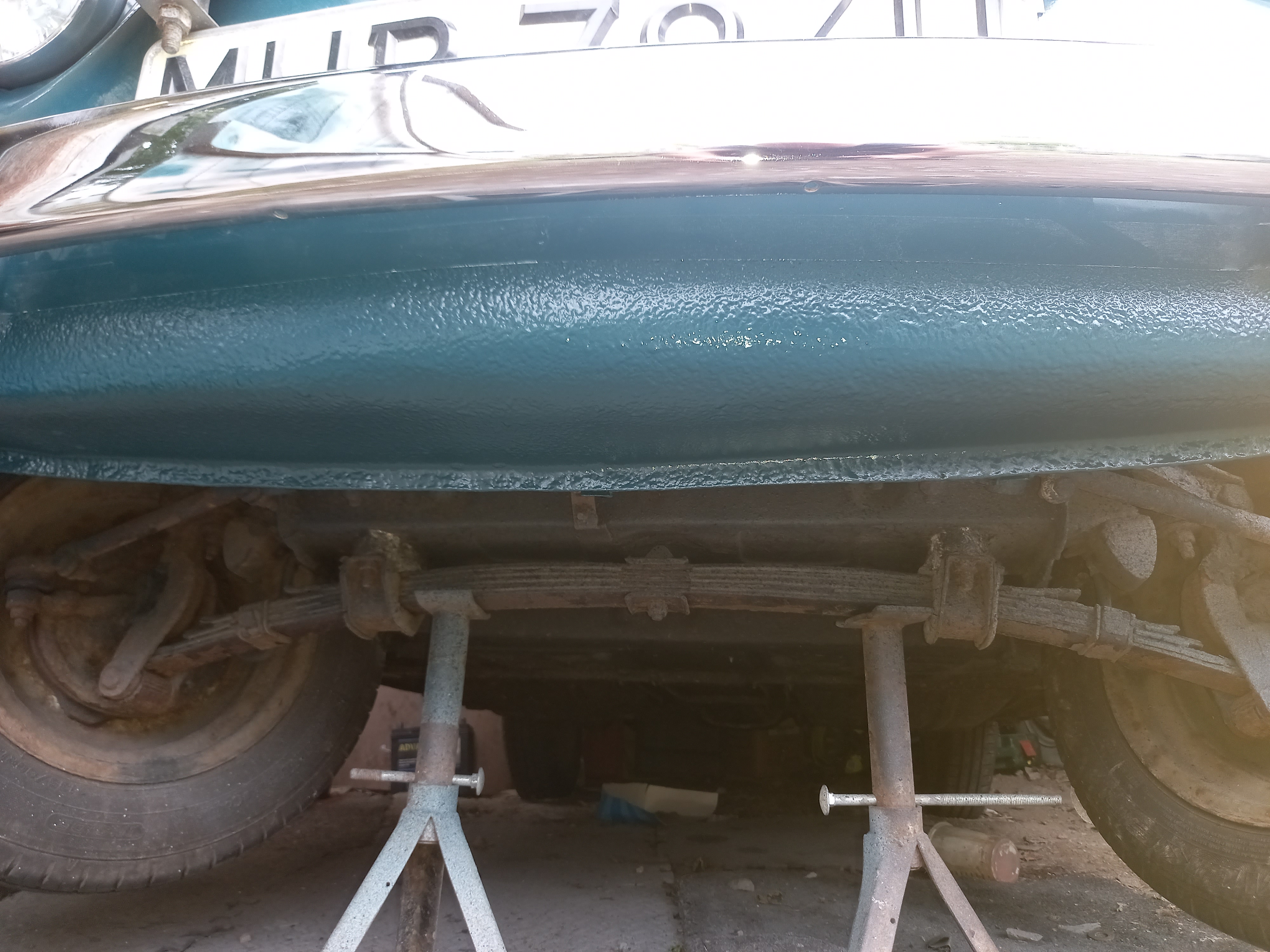

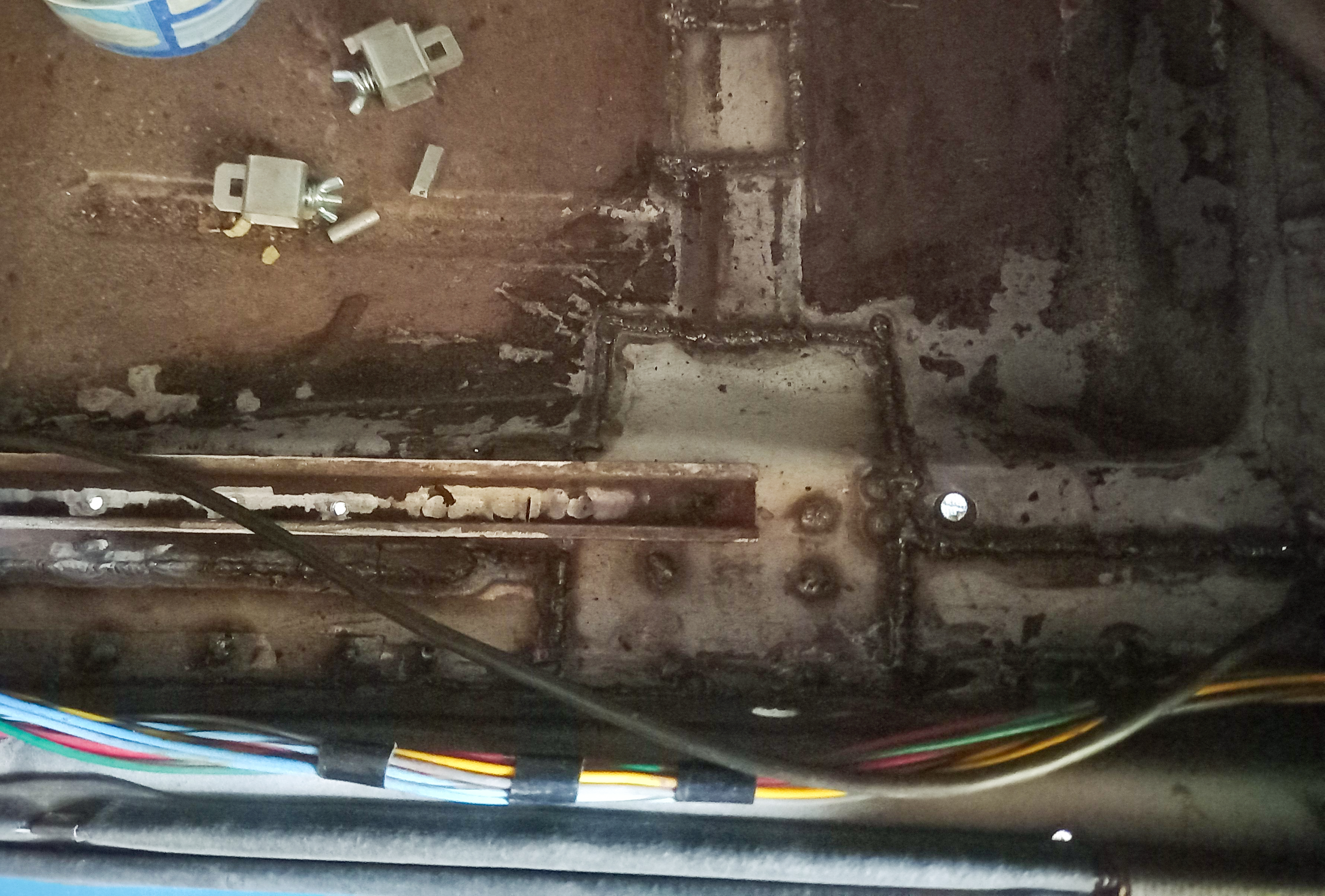

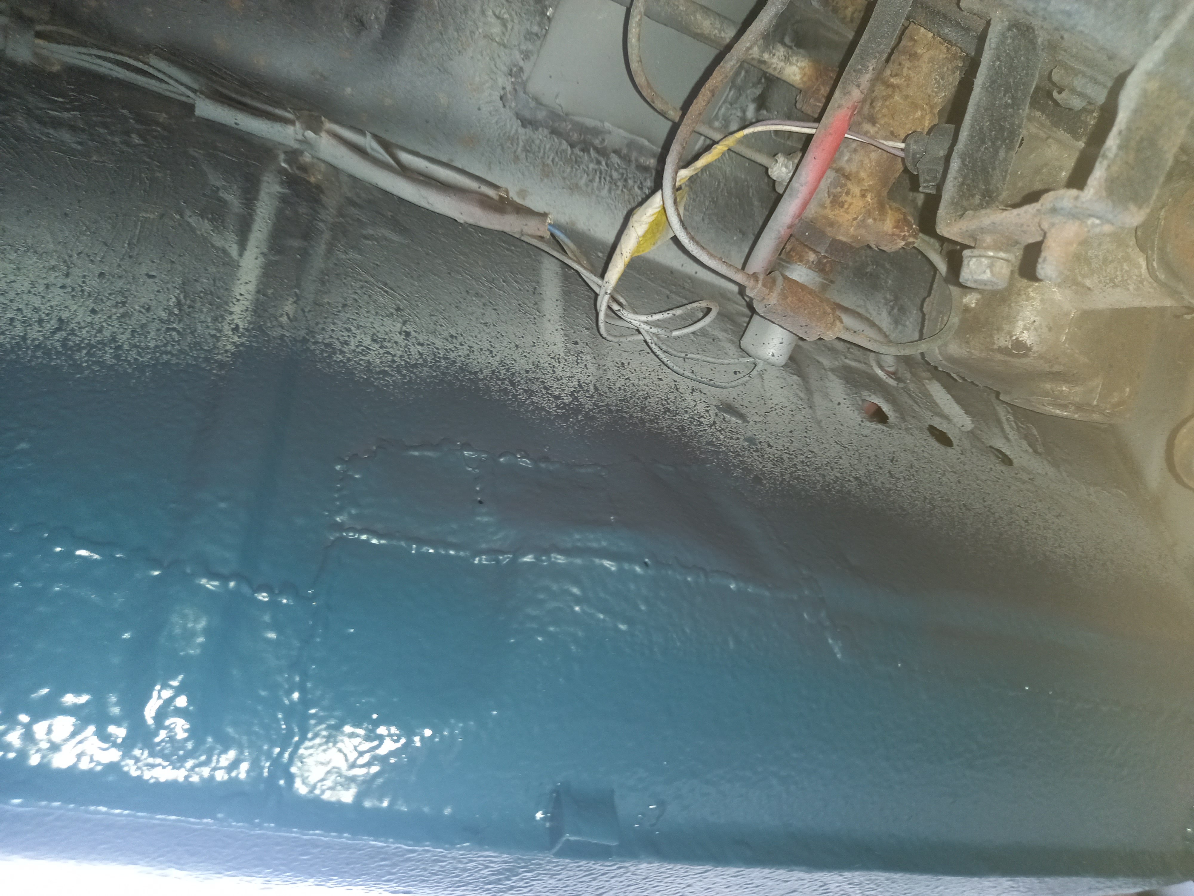

The wheel-well and front panel are now welded-up, epoxy-primed stone-chipped and painted. I've wiped Waxoyl on the headlamp recesses and still have to spray wax inside and outside. It should be good for, let's say 15 years, by which time I'll be almost 80 and paying someone else to renew things. ;)
Although it was done in sections, there's some good welding in there....much better than my original from 14 years ago. I'm pleased to still have kept most of the 54 year old front end intact.

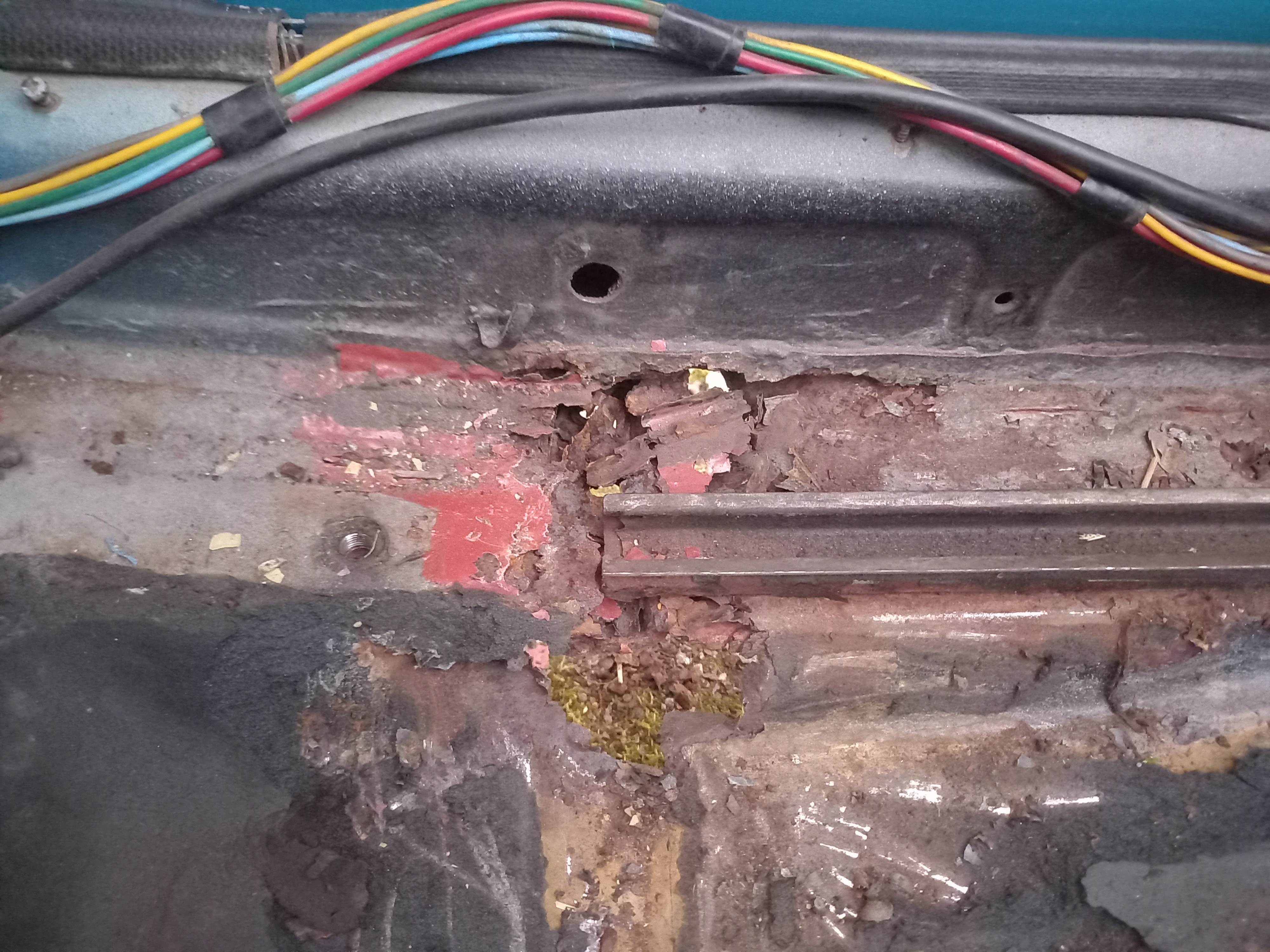

Did I say my last challenge was "straightforward"?

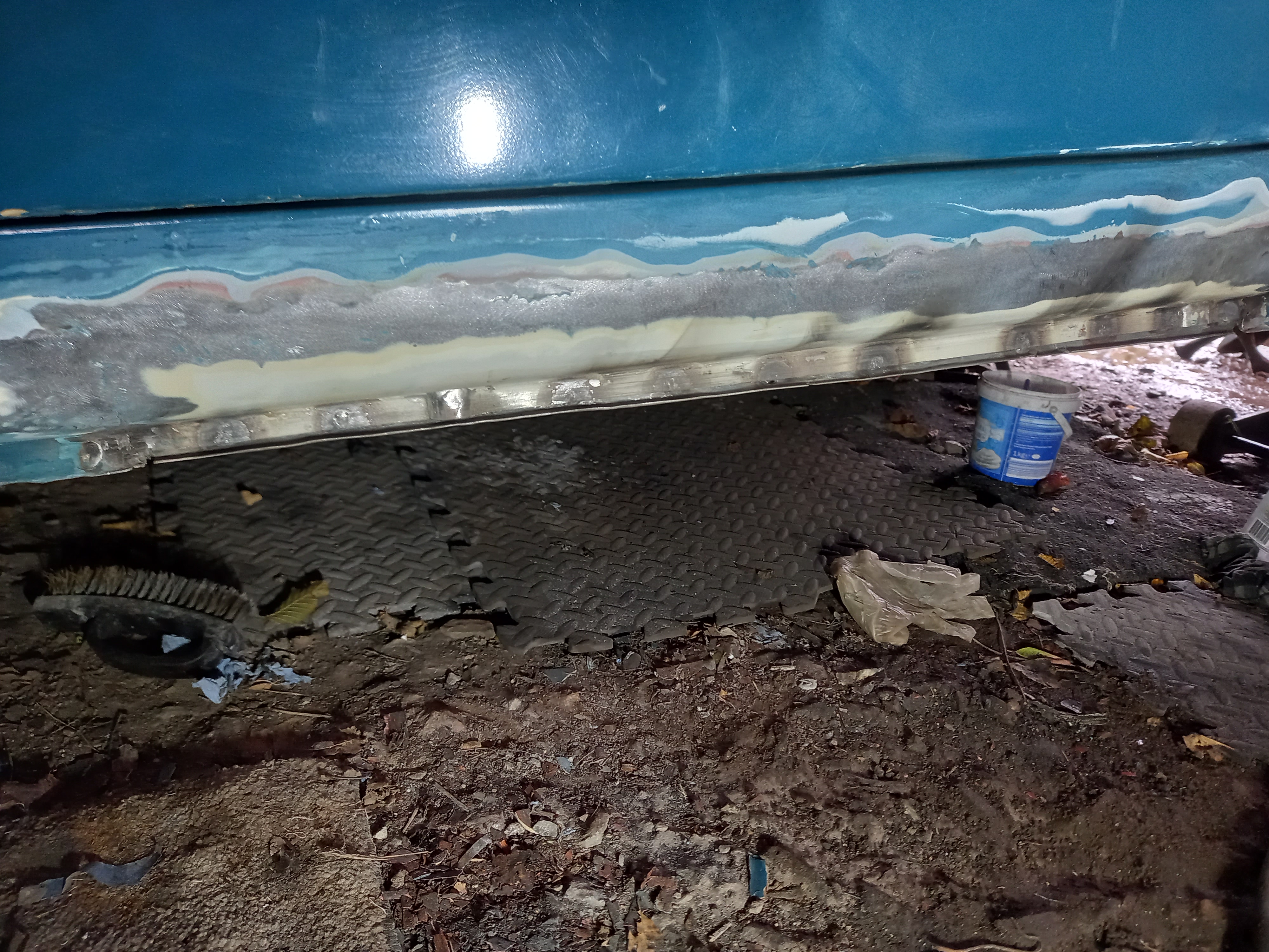

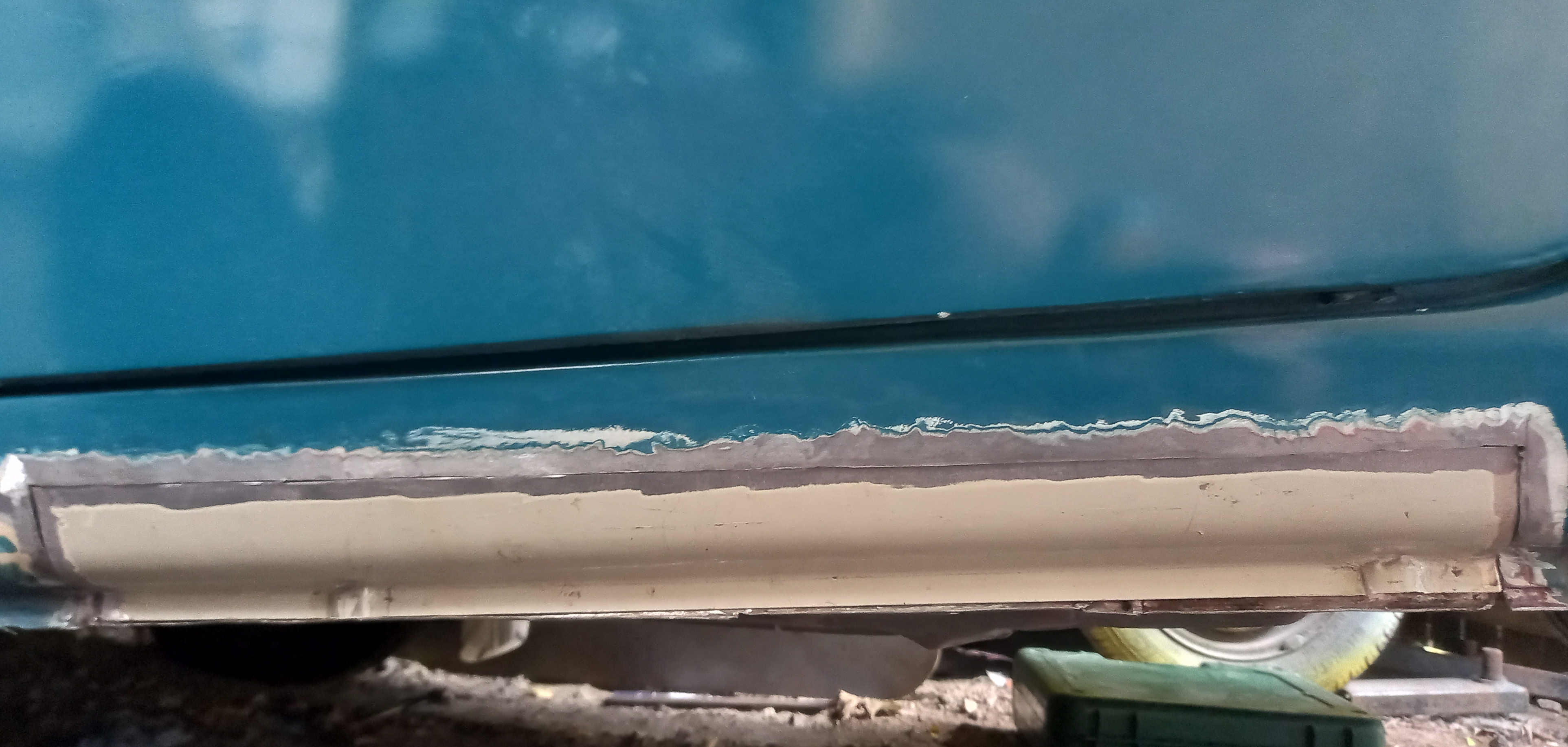

The "small hole" proved to be a big void. Some people might have replaced the entire half of the floor and would more usually have replaced the corrosion with one, large patch. I'm an oddity, so I chose to cut back to good metal wherever it existed and the resulting, complex areas were then replaced with sections butt-welded together. This meant I had to make a new U-channel under the seat and weld through the runner from the top.
About one third of the floor edge was rotten and that had taken the matching lower half of the sill with it. I made a new section and butt-welded it in. The slow method that is recommended to reduce distortion leads to an untidy weld, but ground down carefully it's an excellent join.
This means that the entire sill-bottom has been replaced in three stages over the last couple of years. It's all been done more slowly and meticulously than previous repairs and will have better protection than before.
For people who've restored their car and miss the thrill of welding, this gives you hope that there's always going to be something to look forward to with a Fiat 500. ;)

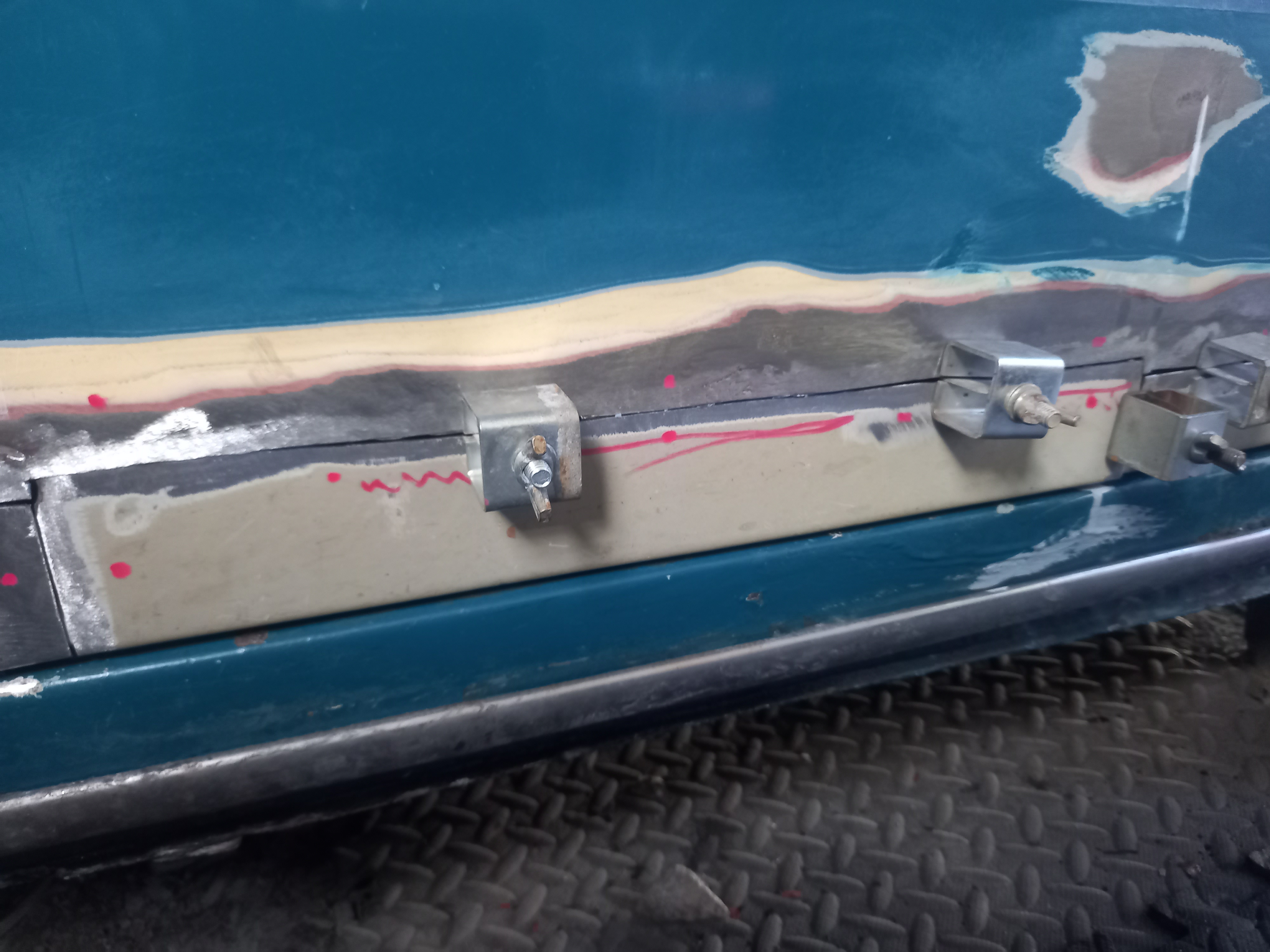

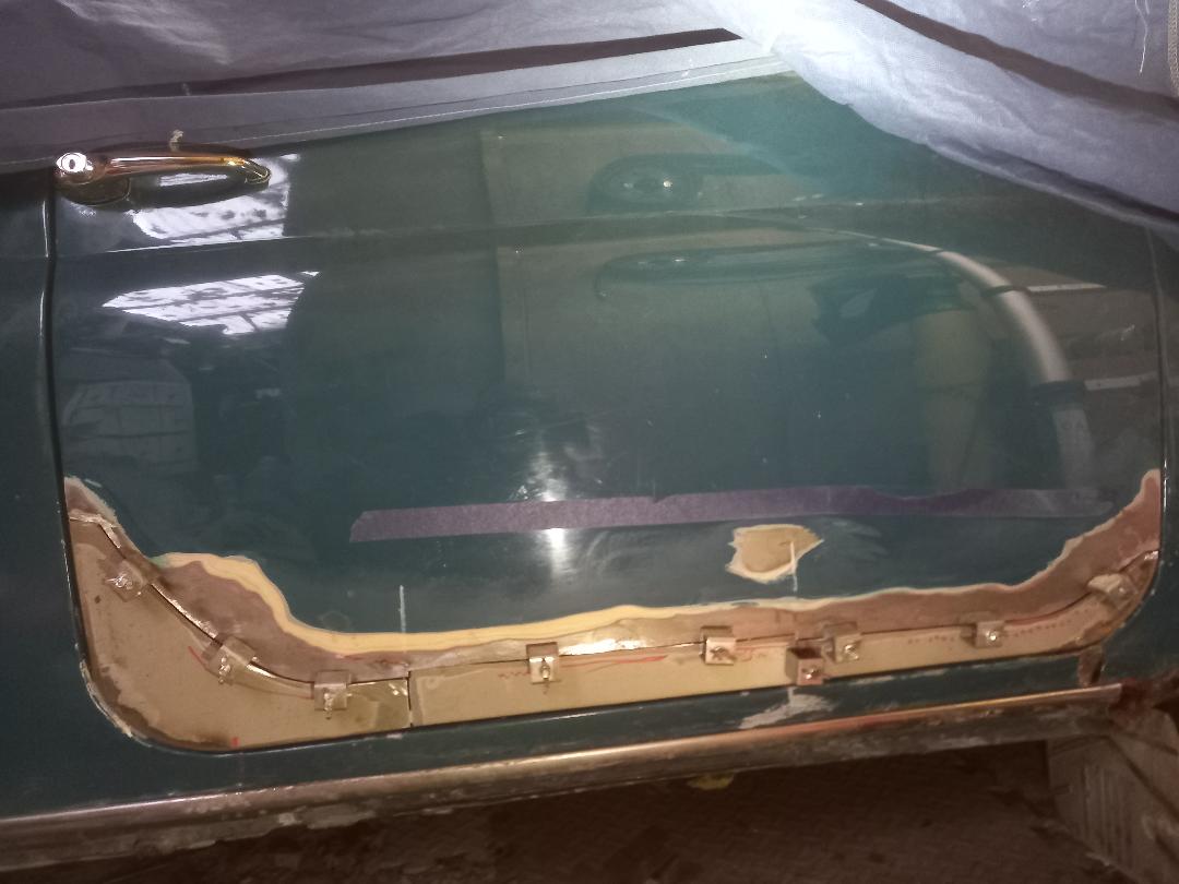

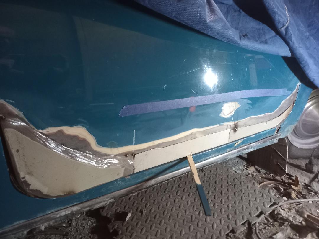

After my concern about the door bottoms mentioned previously I have got stuck in to repairing the driver's side. Door bottom repair panels were available ten years ago, but they didn't fit well. At that time I deemed that this door only needed a patch-panel at the bottom curved corner where it meets the shut-panel and some general de-rusting at the bottom. A lot of unevenness ended up hidden under bodyfiller. But this skimping ignored some corrosion in the frame and skin that matured over time to mean that I have had to make new bottom corners for the inner frame and replace about half of the return lip where the doorskin is attached. Too late to photograph that as I have now primed the new steel and made a new doorskin bottom from three, very precisely sculpted pieces ready to butt-weld in place. It has been handy that I recently acquired an unused, original passenger door that has been used to make good patterns. This has taken ages, and at this point, where I have everything clamped ready for welding, I reckon that I've spent about twelve hours on it.
I will tack the repairs in place and then remove the door for welding on a horizontal plane. That should be fun to achieve without causing any distortion in the panel.

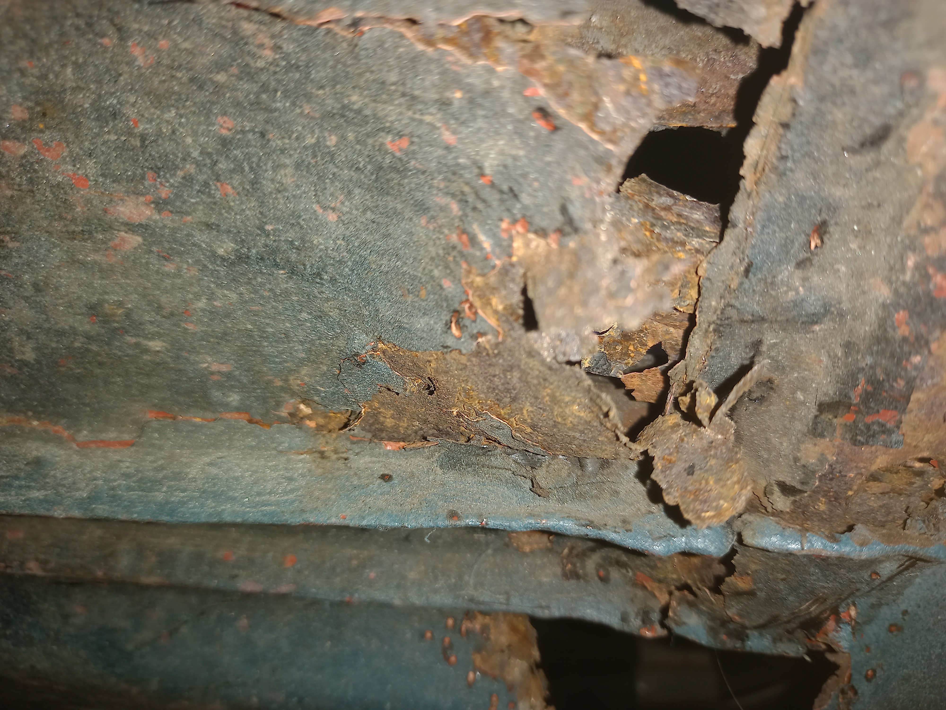

Having been down on the floor with this, I can now see that the front of the sill where it goes under the rusty bottom of the wing has problems too. I already knew that the top layer of steel that covers the door shut section of the "A"-pillar was pushing ot corrosion, and that will be my next target. That should make for some very unpleasant photos.
Test fitting

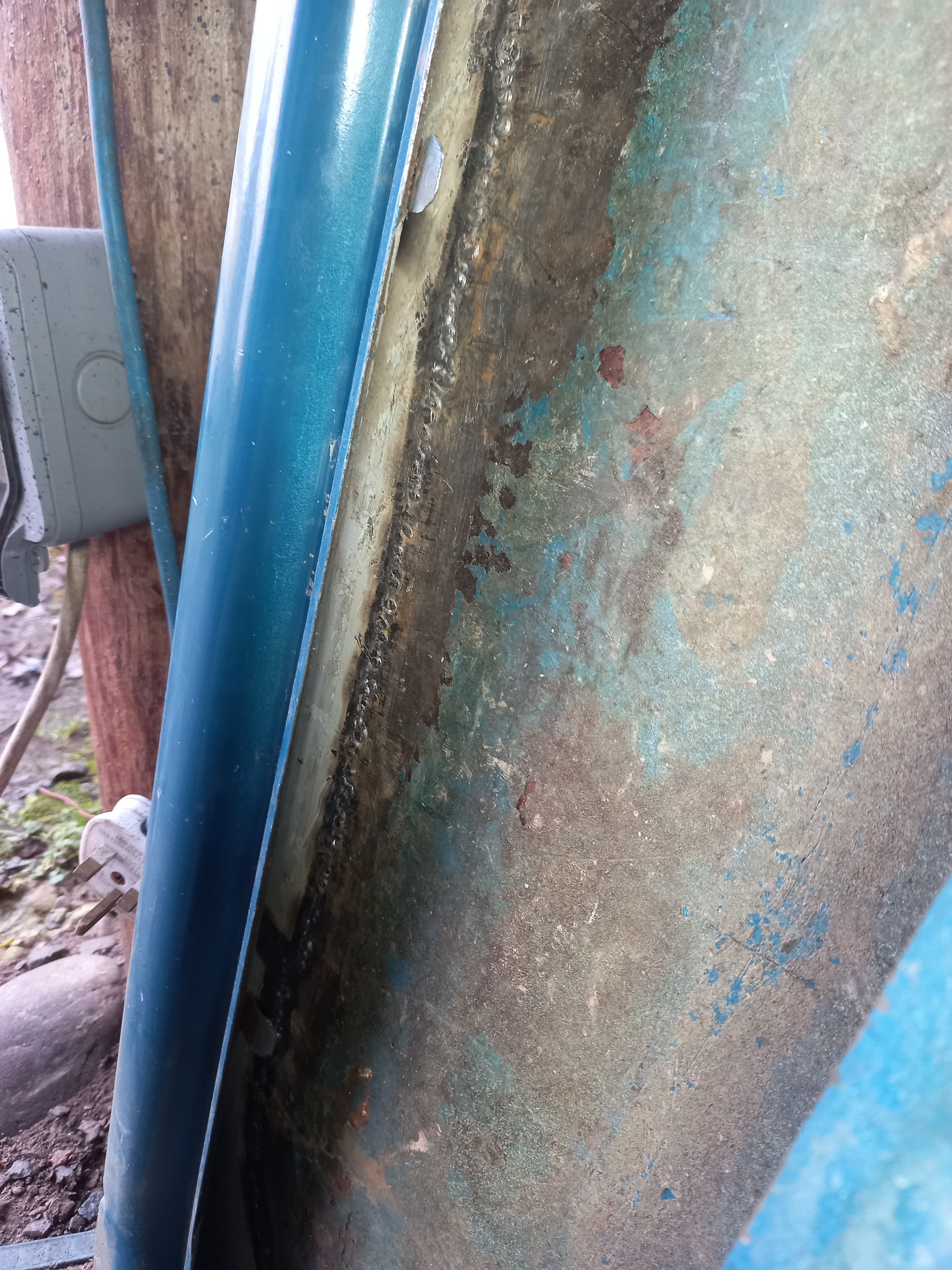

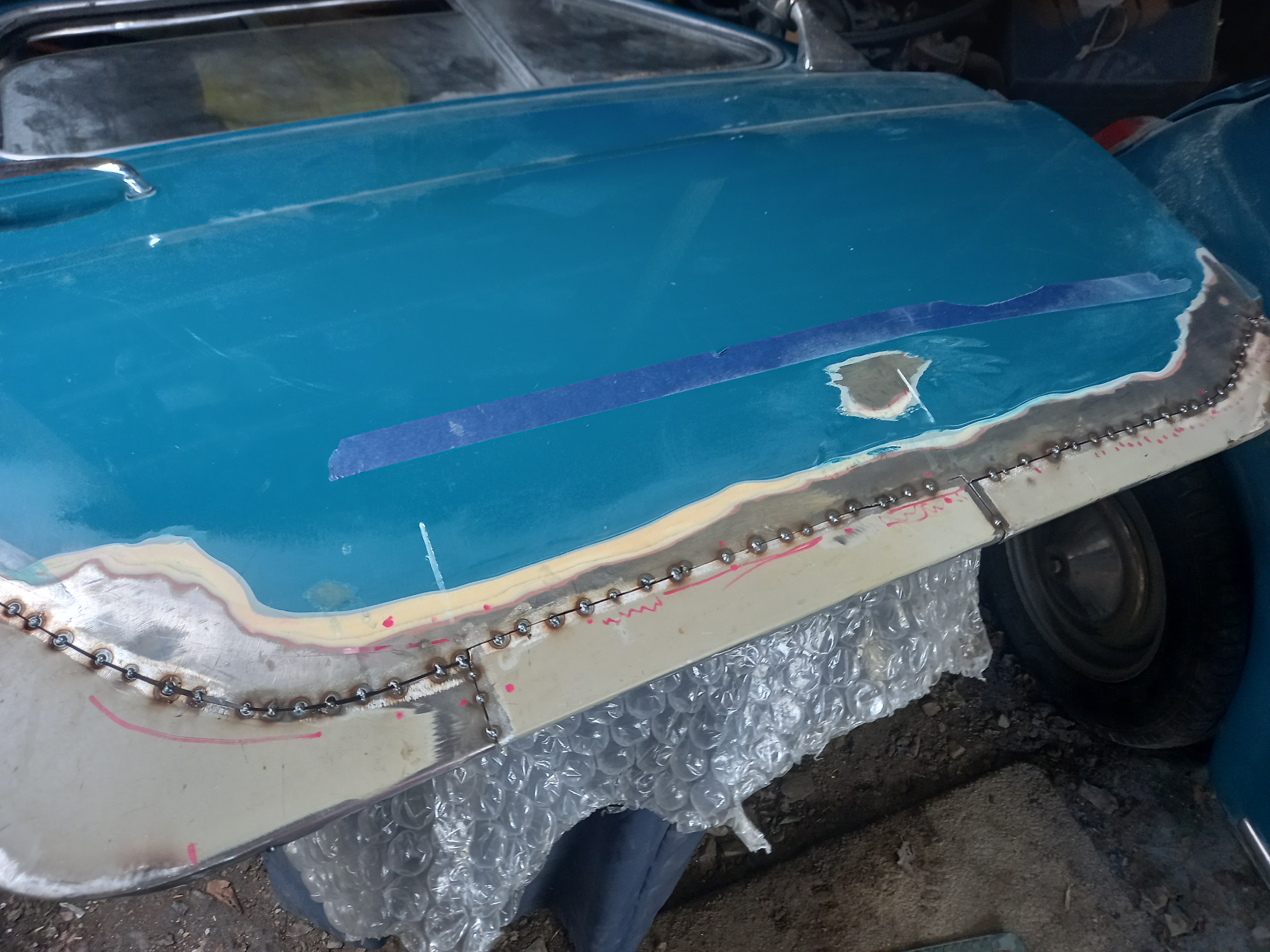

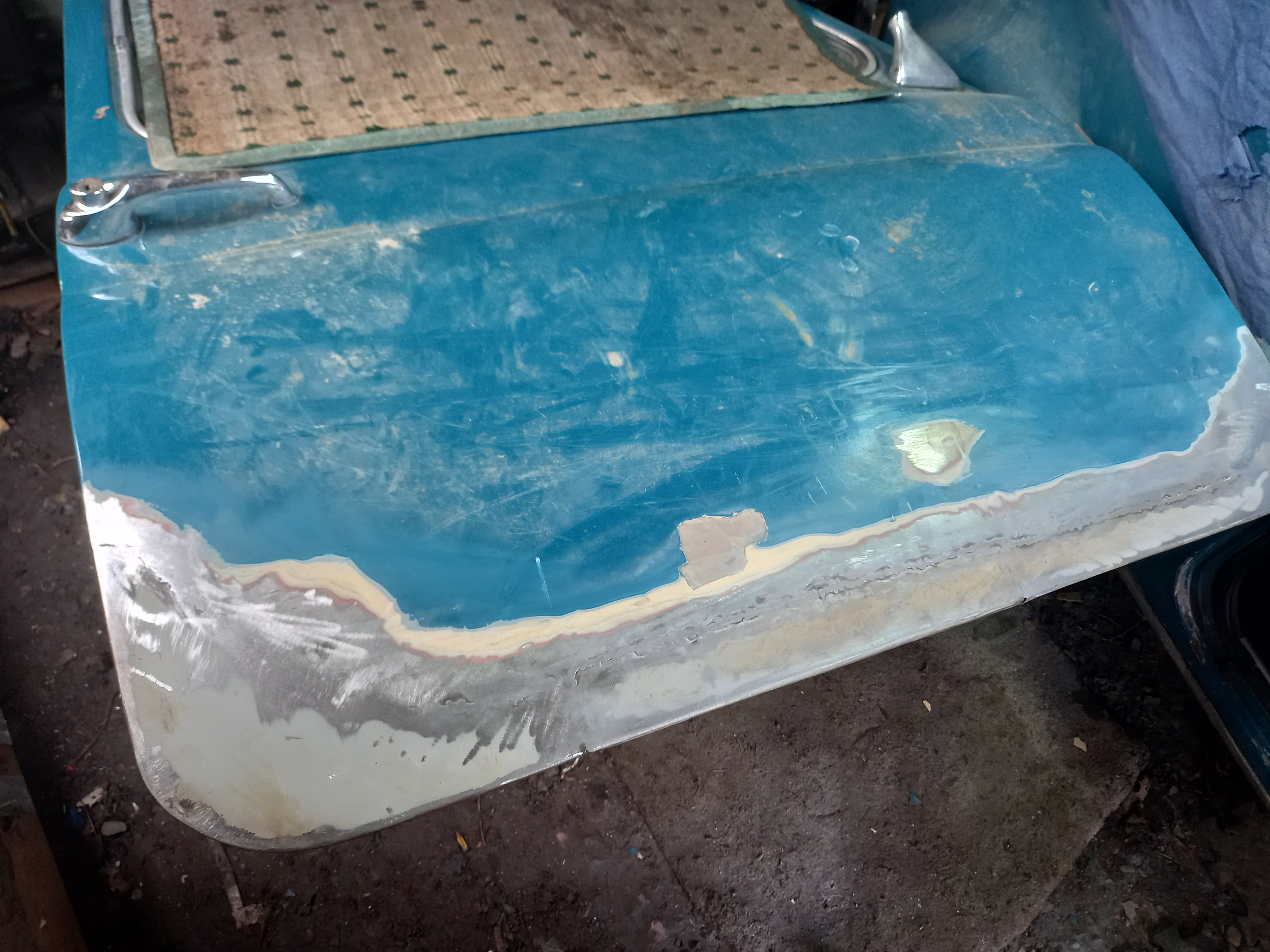

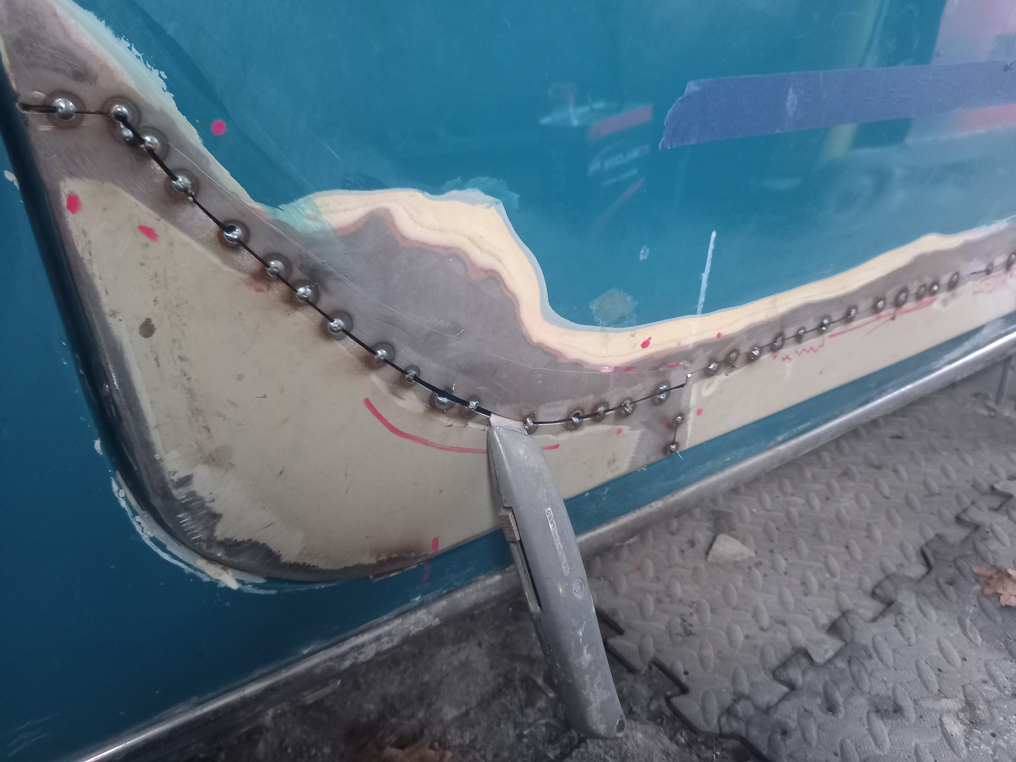

I'm taking a break after starting the welding of the door. Firstly, I looked for places where the two skins of steel met on a perfectly level plane and marked red dots for the first welds. Each weld was immediately afterwards quenched with compressed air.
Gradually, there were more places that came level, although a few places needed gentle persuasion by wedgiing the Stanley blade in.
The original doorskin is a fraction thinner than the repair and despite great care there were a few slight mishaps where too much heat went in. I now have the door off the car and after I've opened out a few of the welding gaps that have been shrunk together too closely, I'll be able to finish the welding.
This door is really stretching me. I'm able to microfocus in a way that I didn't when I was rushing to get the car on the road back starting in 2009.
Talking of stretching, despite my care care and slow welding I still got a significant shrinkage dip in the centre of the repair panel. It took a lot of hammering at the weld-line to bring it back to a reasonable contour. The activity broke off a big chunk of skimmed filler....a benefit really!
I still have to tack the skin to the frame and finish off where the skin is lipped round the frame. Although I've ground back the welds, the approximately 1mm gap I left has allowed excellent penetration and strength.

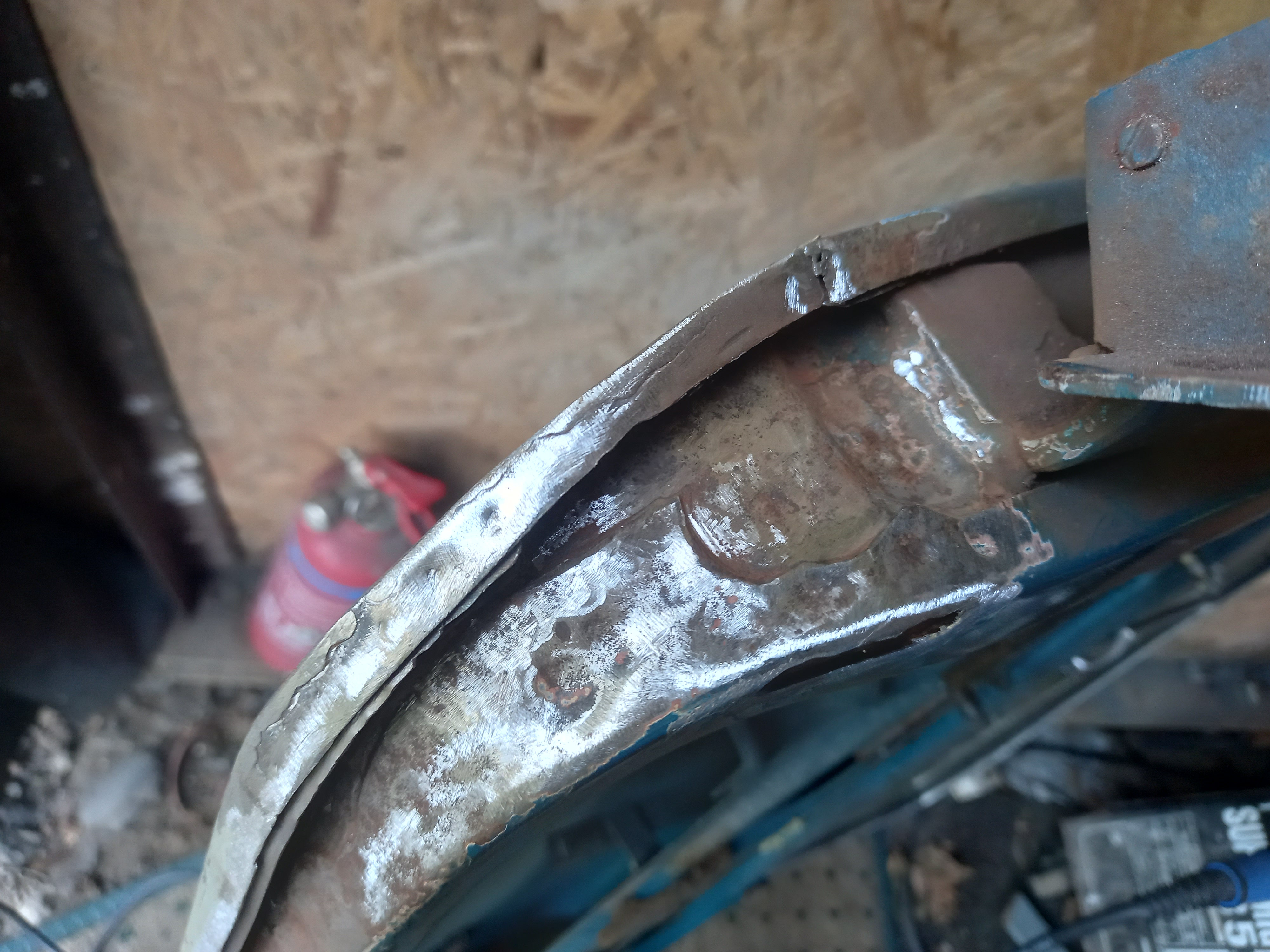

There is some damege to the door-frame that was only accessible with the door removed....yuck!
Cleaned up it doesn't seem so daunting. I'm etching off all the remaining rust with phosphoric and will prime before fitting replacement sections.
