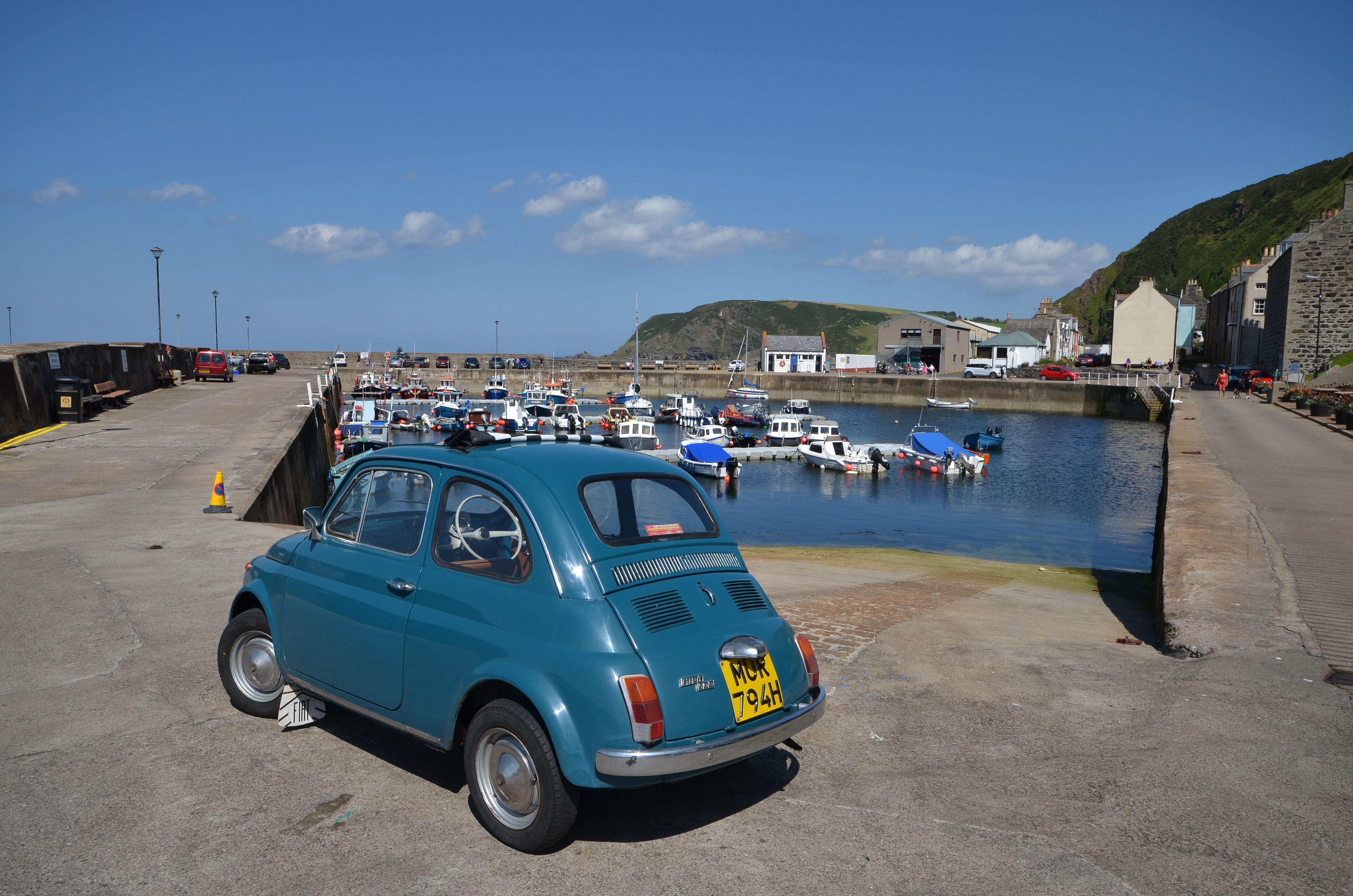

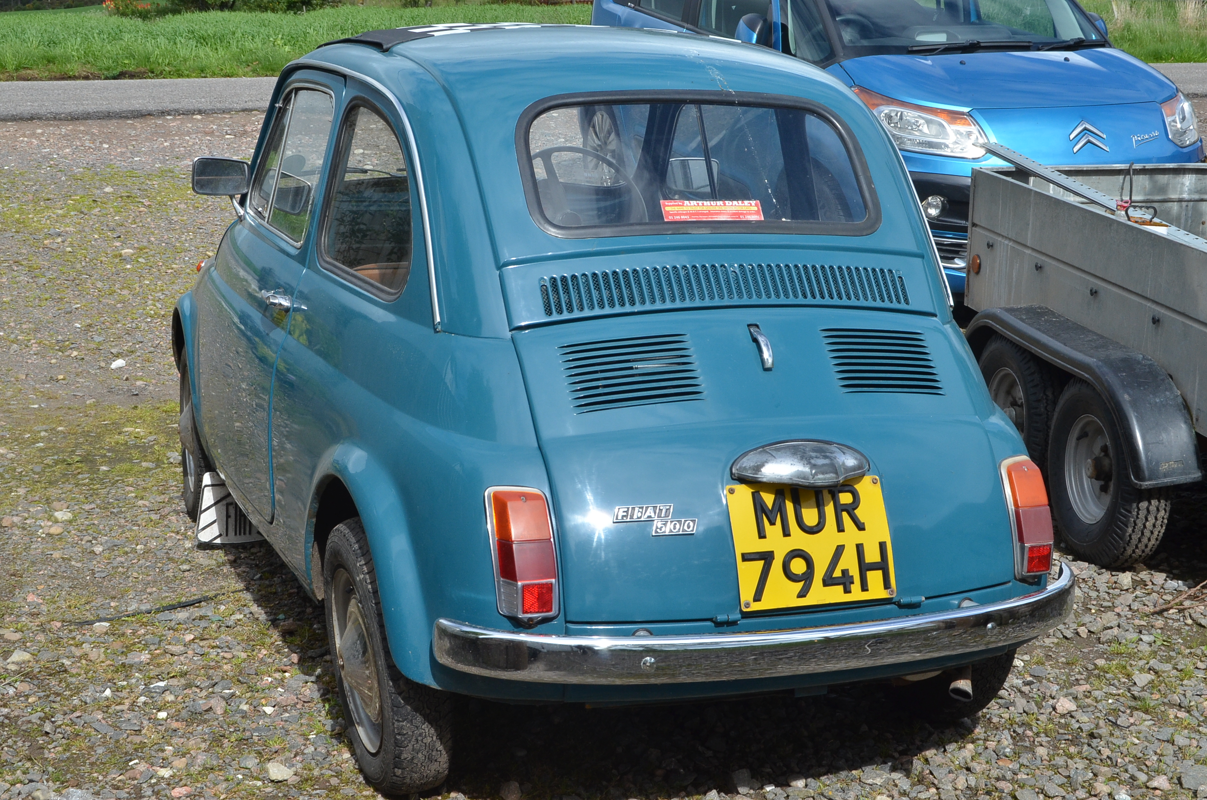

It finally stopped raining, so perversely, we set off today to test out Murf's new mudflaps. I bought these a few years ago intending to fit them at the back of the car. I couldn't work out an easy way to fit them but with all the welding i've done in the front wheelarches it was very easy to install some welded-on nuts and then trim the flaps to fit. I did all this with the car off the ground and now I find that at slower speeds and uneven ground, they are catching slightly on the road-surface. It won't take long to let them wear to a perfect fit and although Murf now has a bit of a Dumbo appearance and looks even more like a cartoon attempt at a rally-car, it will be a very practical improvement.....he's going to fly....:D

Not sure why.. but they don't look right..... perhaps the size.. but then if they were "to scale" they would not do the job....
Have you not considered fitting an all round skirt.. like the "Ground effect" ones used in F1 which were designed to wear away as the race progressed as the suspension actually lowered as the race progressed...
I take your point; they weren't designed to be there, but I did buy them on the understanding that they were designed for the 500, albeit at the rear.
In any case, if I was that bothered about looks I would never leave the house! :D I had them anyway and they should perform a very useful function. I'd rip them back off again if I found them that offensive...would that certain others would do the same with the plastic bits they've stuck on their 500s.:D
It's good to know that I've accidentally come up with an F1 concept but if it extended to the sides I think I would have a chubby hovercraft rather than a 200mph supercar. :)

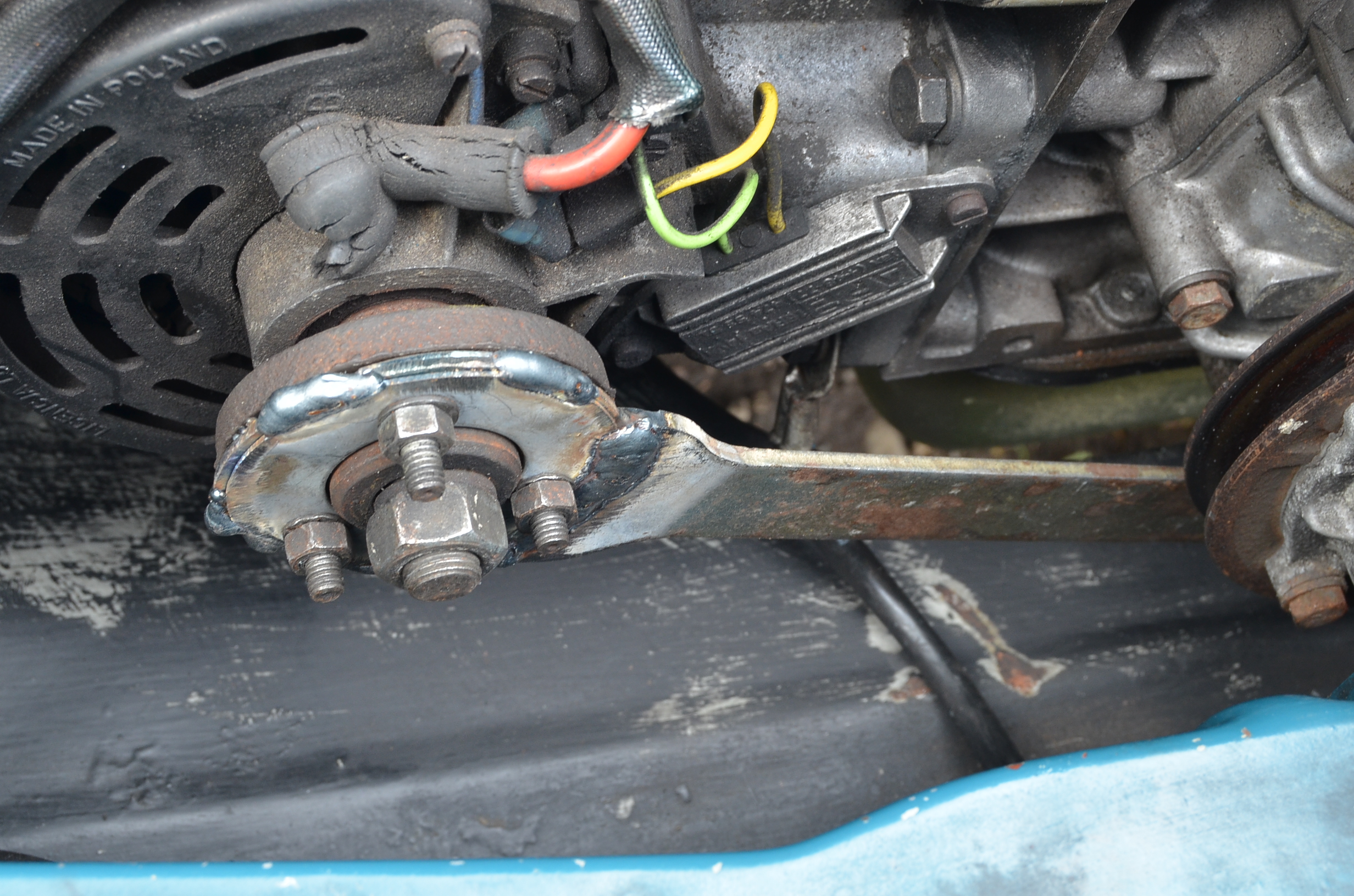

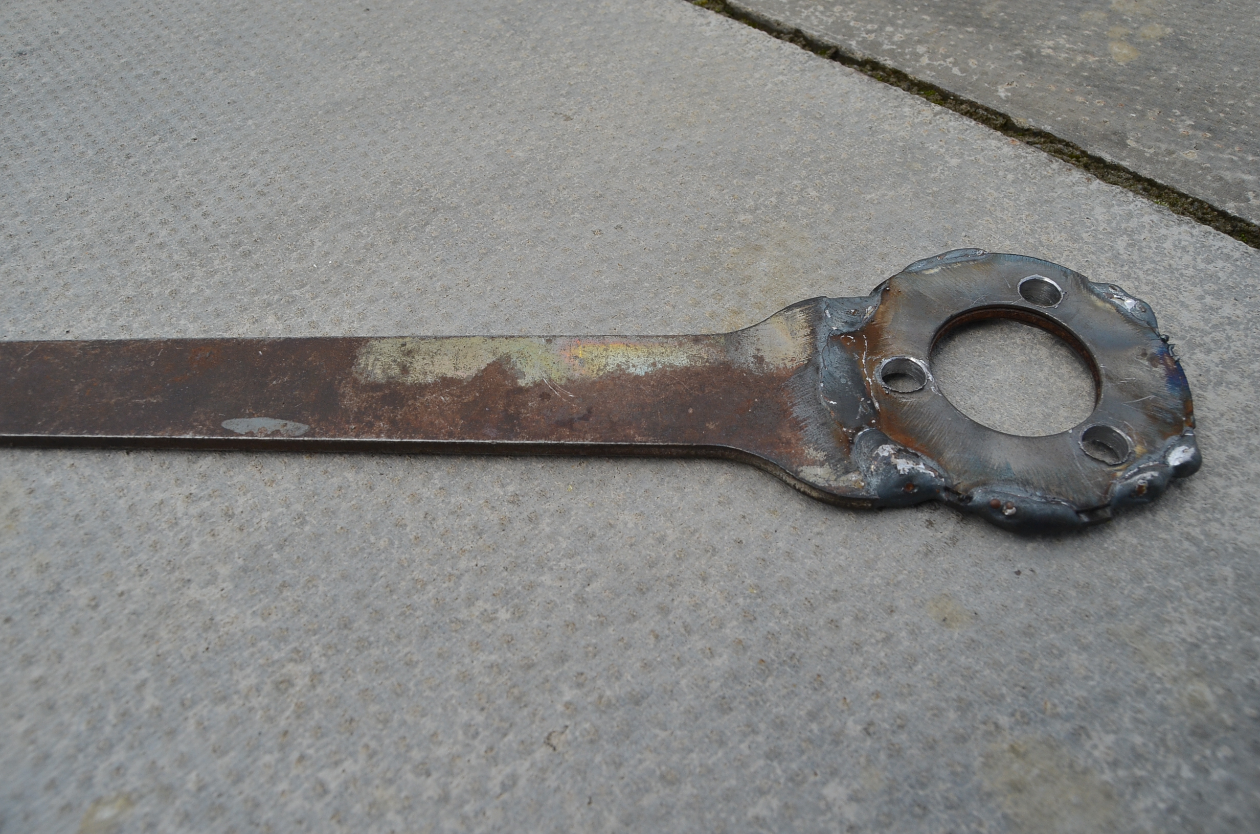

For them that's bothered....I solved the impeller issue. It was the least worst possibility in that although the securing nut was at the correct torque and even Loctite'd into place, there was a slight lack of friction between the securing washers and the fan; I suspect that it was just long-term over-compression and deterioration of the thin, fabric washers that are sandwiched in there.
So I tightened the nut maybe a third of a turn and all is well.
In the past, I have struggled to get a proper grip on the generator shaft in order to tighten this and the pulley nut. Instructions in Haynes say to wedge something between the three, small pulley studs. I once bent a stud doing this and I don't think that it's good practise. So a simple tool followed....another advantage of having welder and lots of spare parts.......it is made very simply by bolting together three pulley spacers and then welding them to each other and to a metal handle. It was ten minutes' work but made this job so simple. In fact, I found it easy to do without using a jack and I just slid under the car, removed the undertray, disconnected the bottom of the intake hose and "da-da"...access all areas.:D

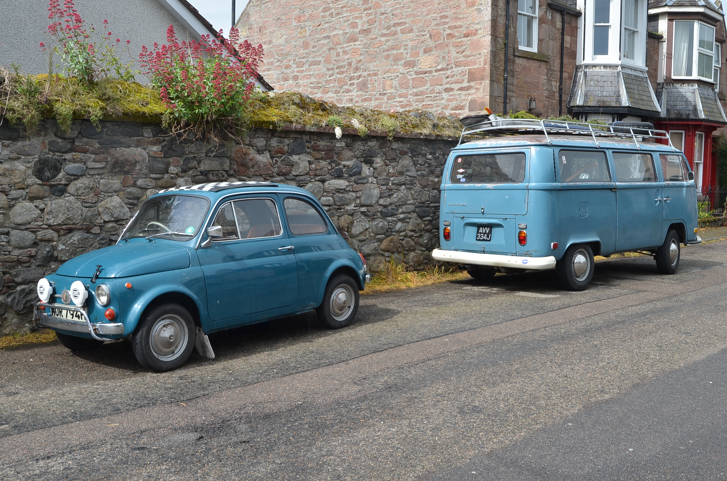

Lovely colour. Whats around the main headlights, some form of rubber gasket ?
You're obviously a lover of the radioactive spectrum!:D
The rubber rings are a non-original part which is intended to seal the recess where the reflector fits. They're a discredited item by some people as they (maybe?) spoil the appearance, can be tricky to make fit, maybe don't even work as seals and possibly trap moisture which would otherwise have an easy getaway.
