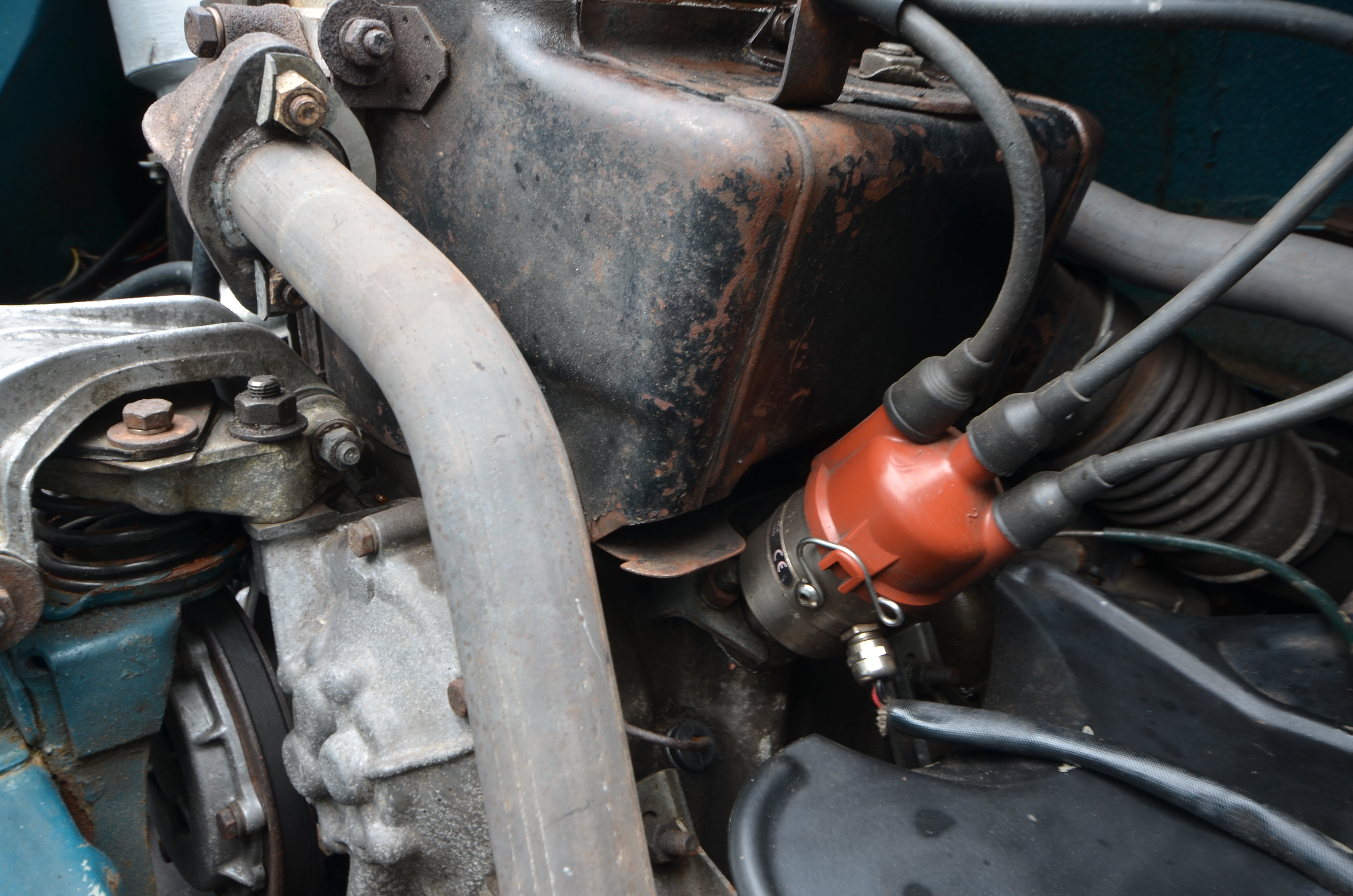

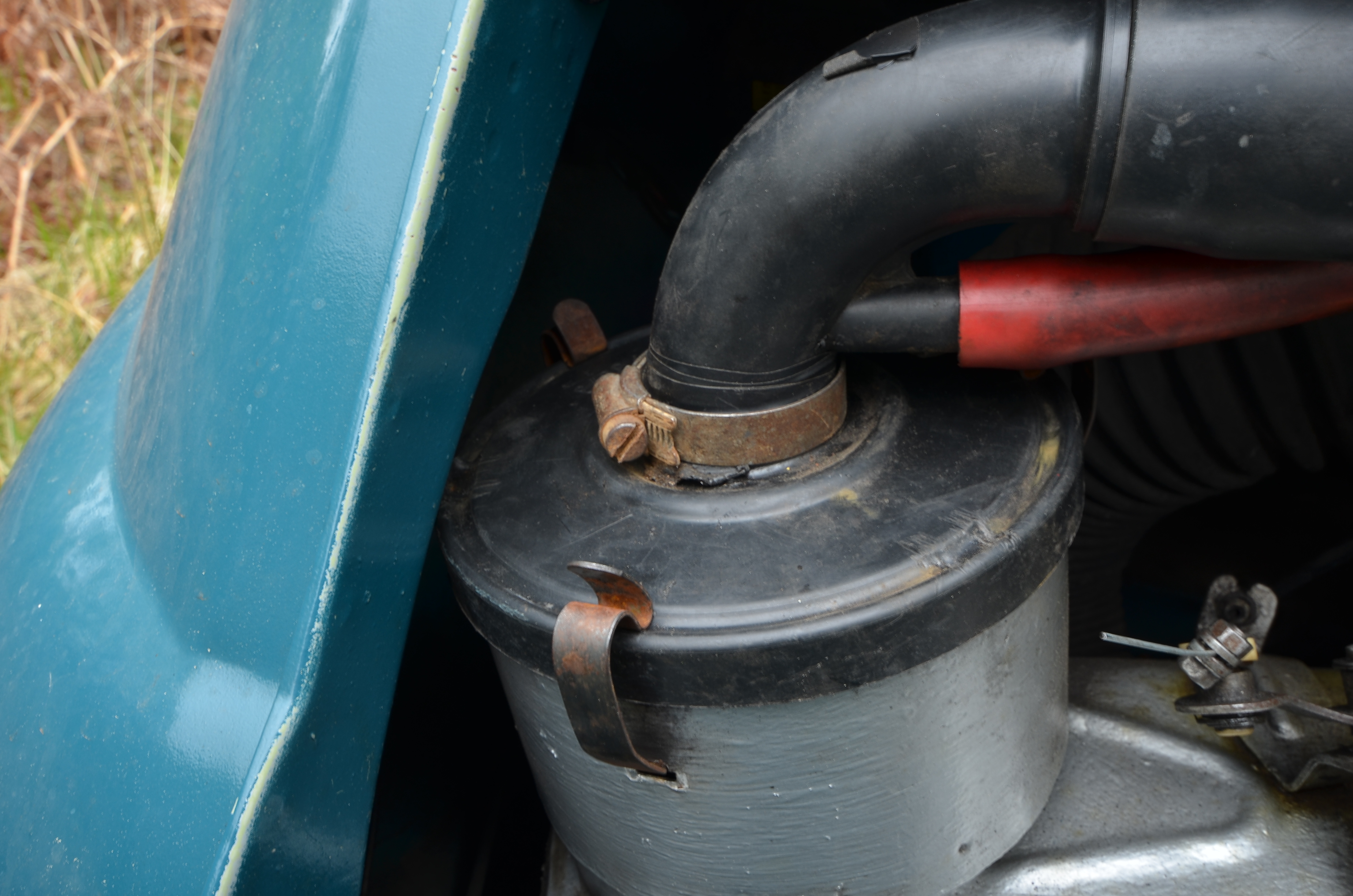

Today I noticed the car was getting a bit breathless when pushed to high revs. In a beautiful location, high in the hills and a long way from home, I checked the main jet in the carb..it may have had a blockage...inconclusive. But then I dropped it on the cylinder head whilst trying to refit.:bang: This entailed very carefully removing the rocker cover in order to find it. Things were better but not right, but when I got back, with a very hot engine, I thought the tickover was a bit uneven....it's usually like clockwork. So a flash of inspiration and thinking to a recent vapour-lock incident which I confided in someone, I wondered if I had a weak mixture resulting in overheating and this latest issue. A quick tweak of the mixture and we're fixed. I also checked the plugs and we're back to that perfect tan colour and no widening of the gap at all after 5,000 miles. I also felt guilty as the very low oil level wasn't helping; this engine fairly drinks the stuff without smoking! I reckon I must put in an extra sump's-worth of oil in between oil changes!:eek:
Tomorrow we're off to the island of Raasay for the day, which is a fair old trek, maybe 300 miles there and back; but unfortunately we won't have the sun like today.:rolleyes:

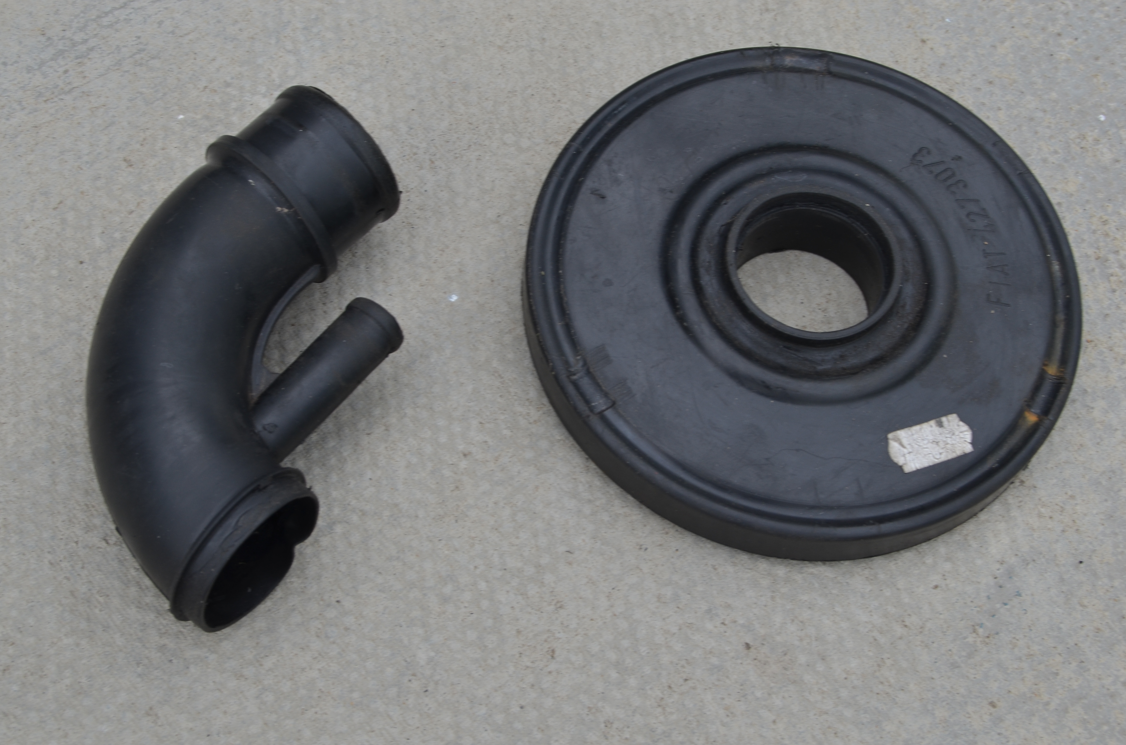

Post-script to the above: After removing it to get at the rear spark-plug I had forgotten to click all three of the spring-clips which secure the air-cleaner lid (650 engine).When I noticed it and started to fasten the clip I realised that the elbow part of the lid, (which on the 650 is made of plastic) was slightly detached from the lid itself.
So this means that air could be sucked in without passing through the filter....it will almost certainly have been affecting the air/fuel mixture. I've repaired it using my second favourite adhesive...black PU, and I'll probably find I need to redjust the mixture once it's all set.:bang:
I should have used my number one favourite adhesive....epoxy. The spigot-elbow of the air-cleaner lid has only a very narrow joint surface and even leaving it overnight made a repair that didn't last very long. Consequently, 90 miles into what turned out to be merely a 250 mile journey :D the engine was sounding very annoyed, losing a lot of power and backfiring. Of course, it was the elbow that had become completely detached. I tried taping it up which failed and then inspiration hit, and finding my bag of miscellaneous repair items, one of the Jubilee-clips was just the right size. So with a bit of insulation-tape as packing I was able to seal it up Tomorrow I will dig out the steel version from the 499 engine and work out a way to make the larger intake pipe of the 652 make a good seal.
More tweaking of the mixture followed and after a 20+ mile 60mph sprint I pulled over to check one of the plugs. It looked slightly weak to me so I adjusted the screw out a fraction. For the journey home Murf really found his second wind and we absolutely flew; I love it when you see cars behind accepting that there's no need to overtake the insane old dodderer in front driving slightly above the speed-limit at 60+mph. :D The incidental image of the thermostat-flap shows that the temperature has definitely settled down because despite the thrashing it is still not fully open.
Raasay wasn't very sunny but still impressive and another Scottish island to add to the list of those that Murf has set wheels on. The ferry man was amused by the size of the car and said he felt bad having to make me pay full price when I took up so little room. On the way back we were so agile and confident he had to restrain me from tucking the car in too tight and I ended up worryingly close to the leaking bow door.:eek:
This all illustrates how finely tuned the carburation of the engine actually is and gives more than a hint of just how much you are literally playing with fire when substituting any components in this system....no wonder overheating is such a problem with tuned engines.:eek:

I replaced the air-cleaner lid with the rugged steel version from the 500. With a bit of head-scratching I came up with a hybrid combination of pipes and clips which fits perfectly and involves no bodges.(y)
In the course of all this I also found that the carb had been slightly dislodged, which won't have been helping things. For the short term I have tightened the nyloc nuts which were quite loose. But if it comes loose again I'll remove it and do things properly with new nuts and gaskets. I also checked the tappet clearances which were still good.

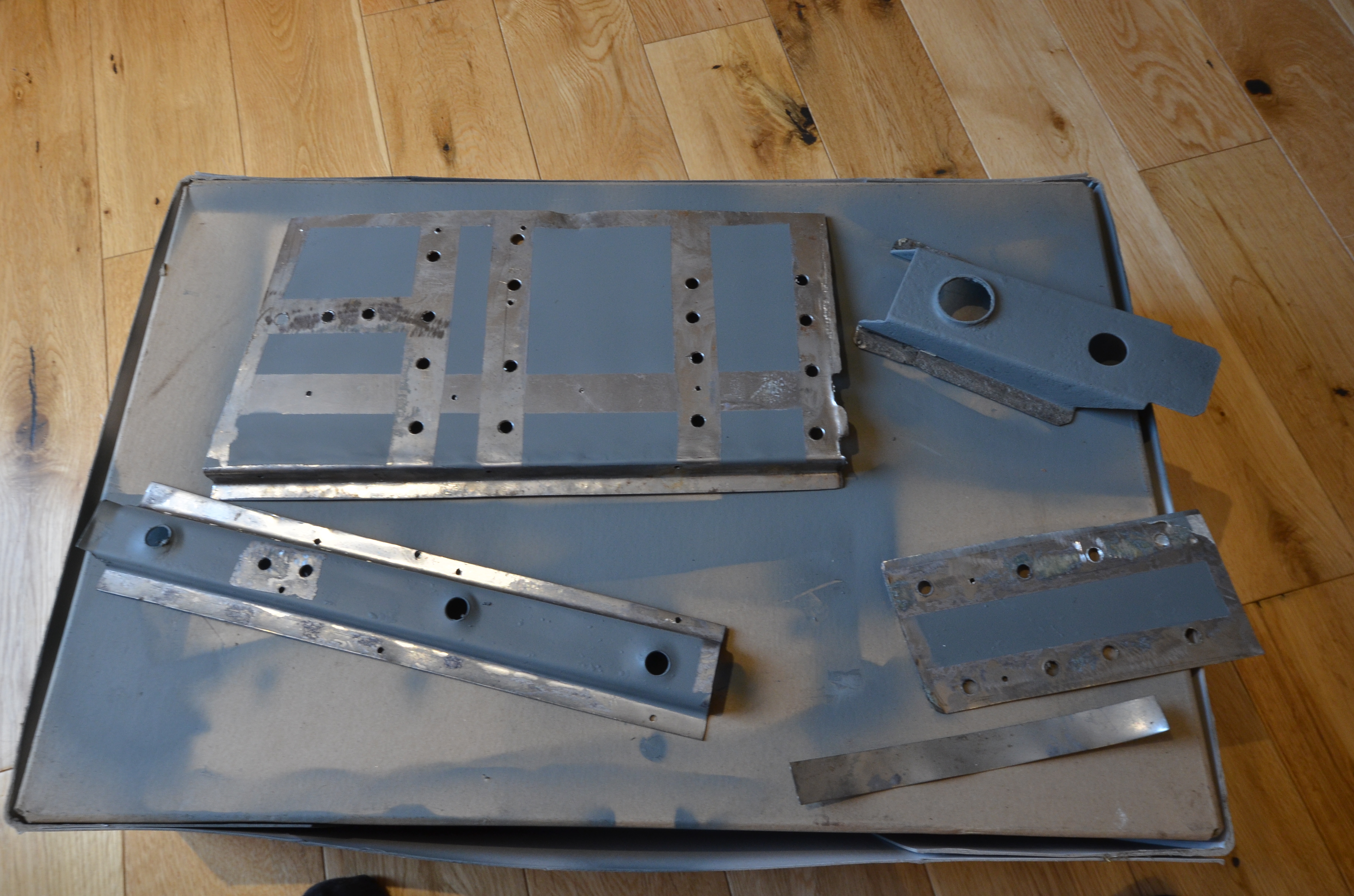

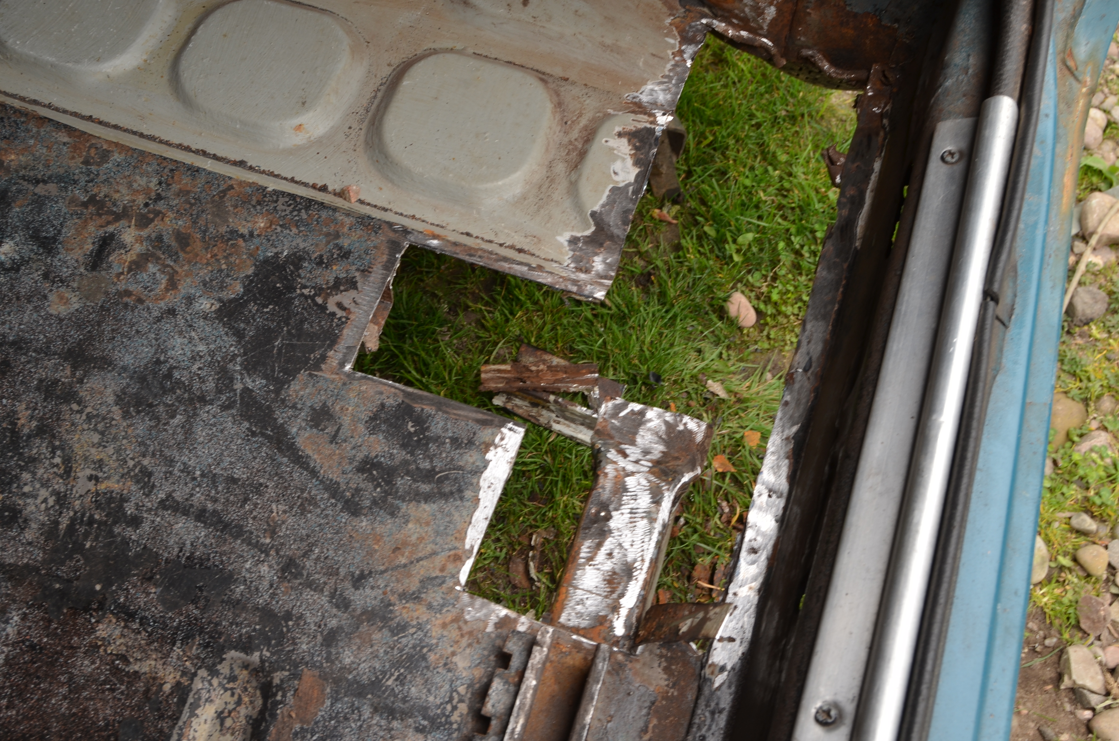

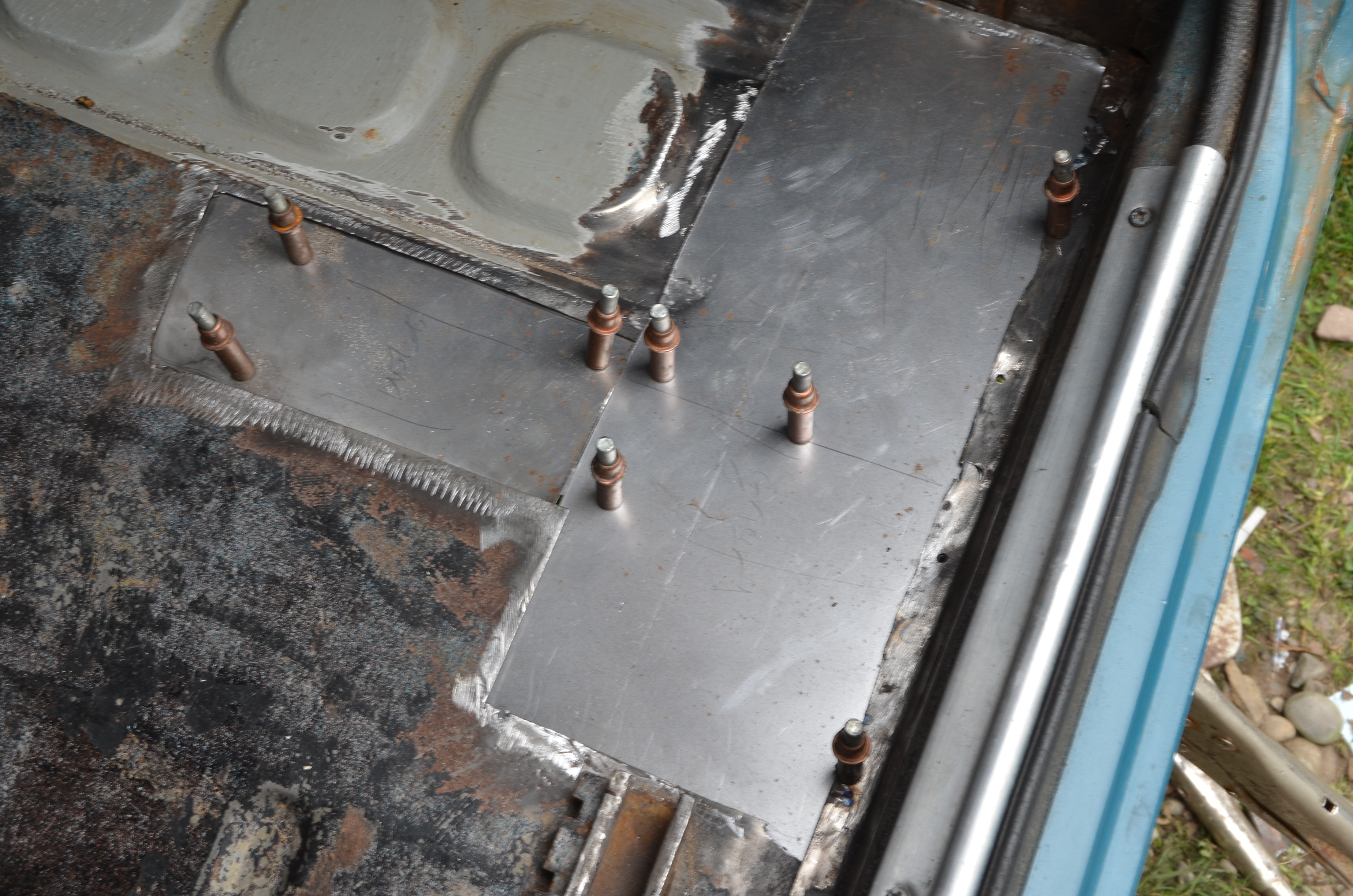

Now comes the horrid bit where my diligence in chasing up the rust in a "small" hole in the floor has lead to this huge void. I've had to make a lot of pieces including a reproduction of the "U"-channel which crosses the floor in front of the seat-runners; I have put bigger and an extra drainage hole in this.
It's ten years since I replaced the floor and the unused, old-stock panels I used did have a lot of "patina" at the time and seemed very thin. The car also sat in a leaky shed for four years after that and subsequently it has been subject to Peter-abuse. I think the leaking windscreen that took me so long to sort out has added to the problem. But I'm sure that the basic reason for the problem is the way the car is designed....if you use it as originally intended it rusts away as the cars originally used to do.:D
At least I'm in a bit less of a rush this time and have the opportunity to spend more time putting protective coatings on hidden areas, including those which aren't accessible when you buy a ready-made floor-panel. The Catch-22 is that there are so many bits that are affected by the heat from welding that paint-treatment is patchy whatever you do. :bang:
I'm hoping to get the welding done tomorrow...I hate it when Murf's off the road. :(

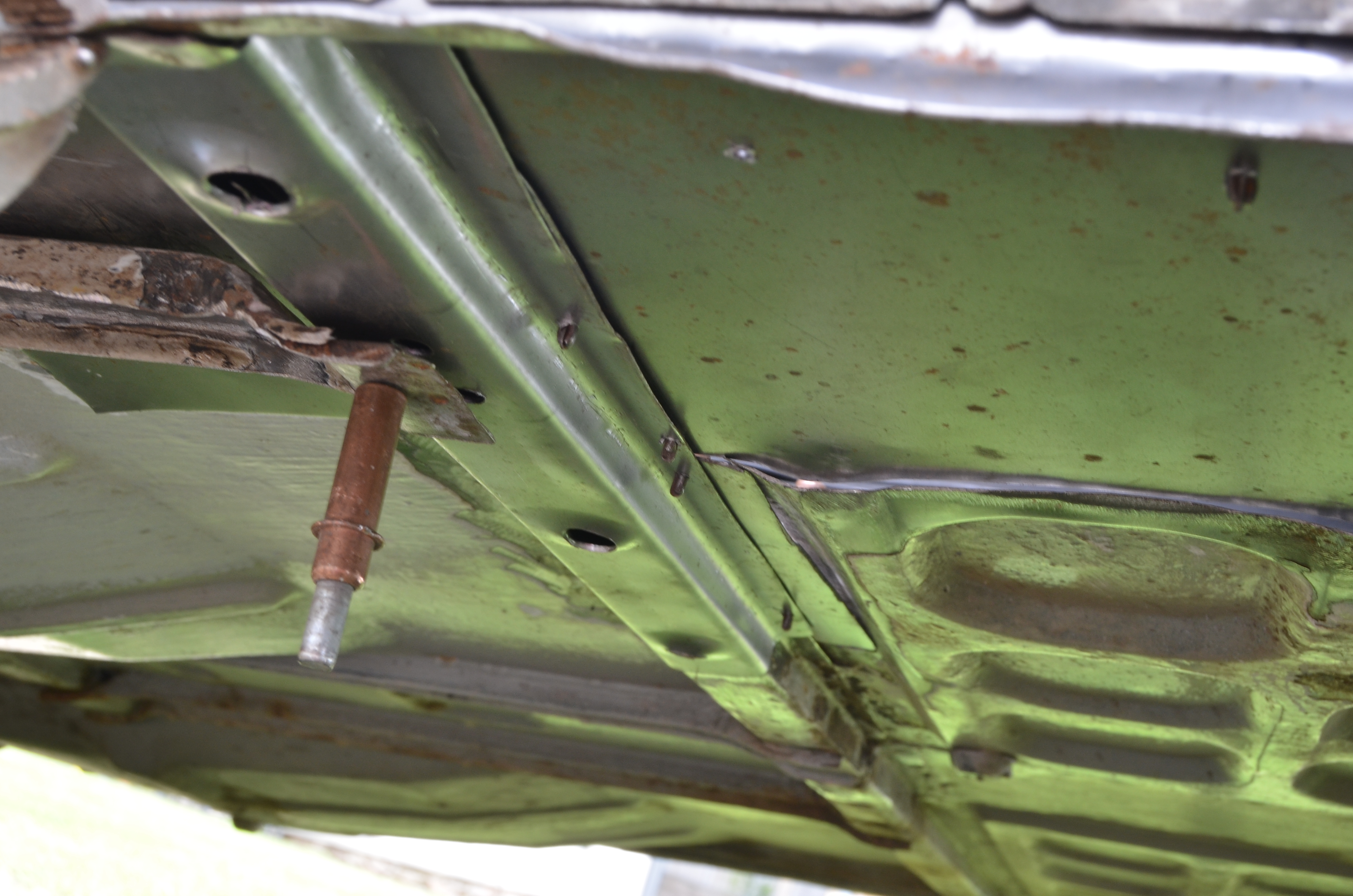

It all started when I began to give Murf his annual under-body clean and paint....I haven't dared to look at the other side yet.:eek:

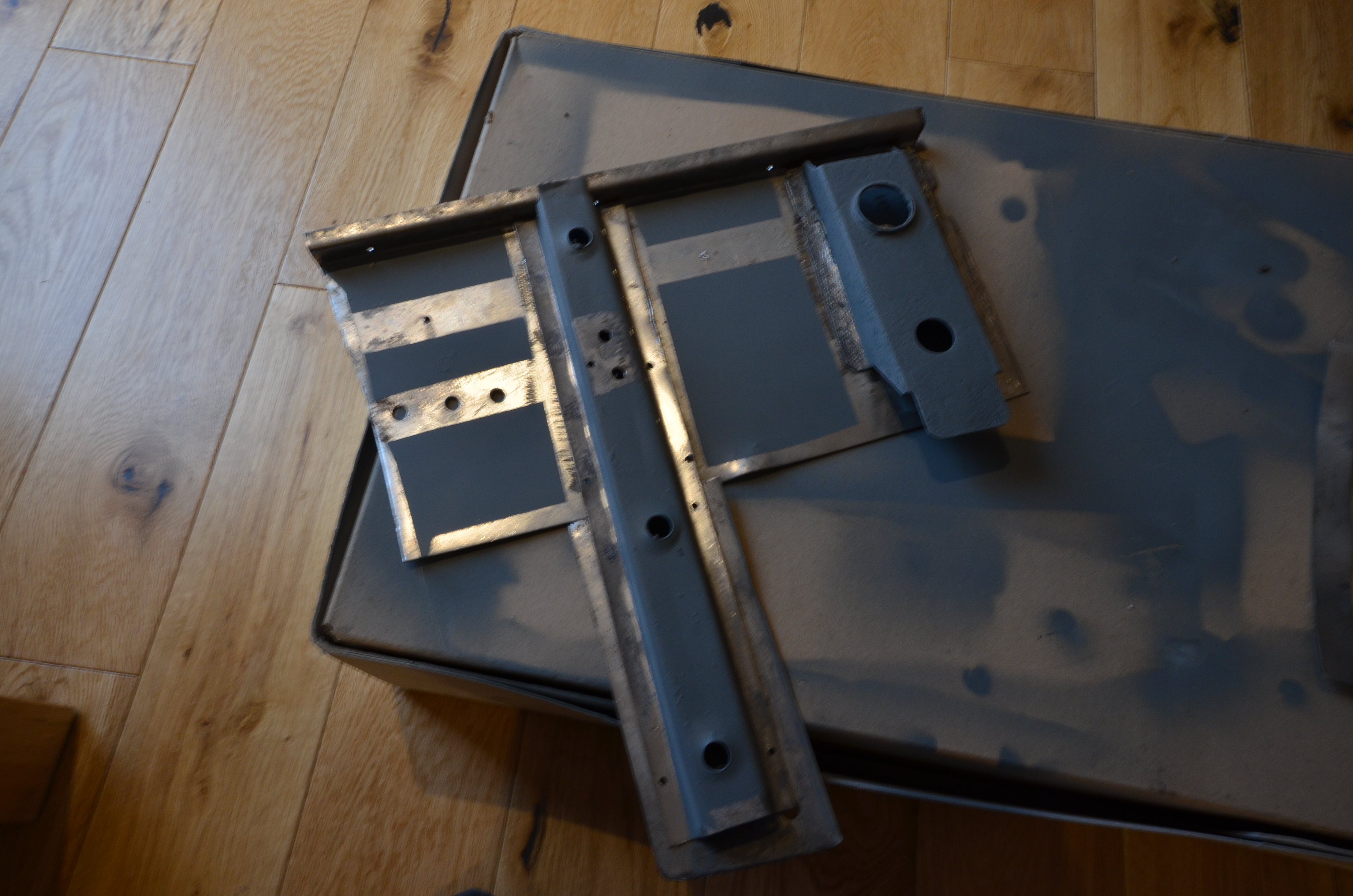

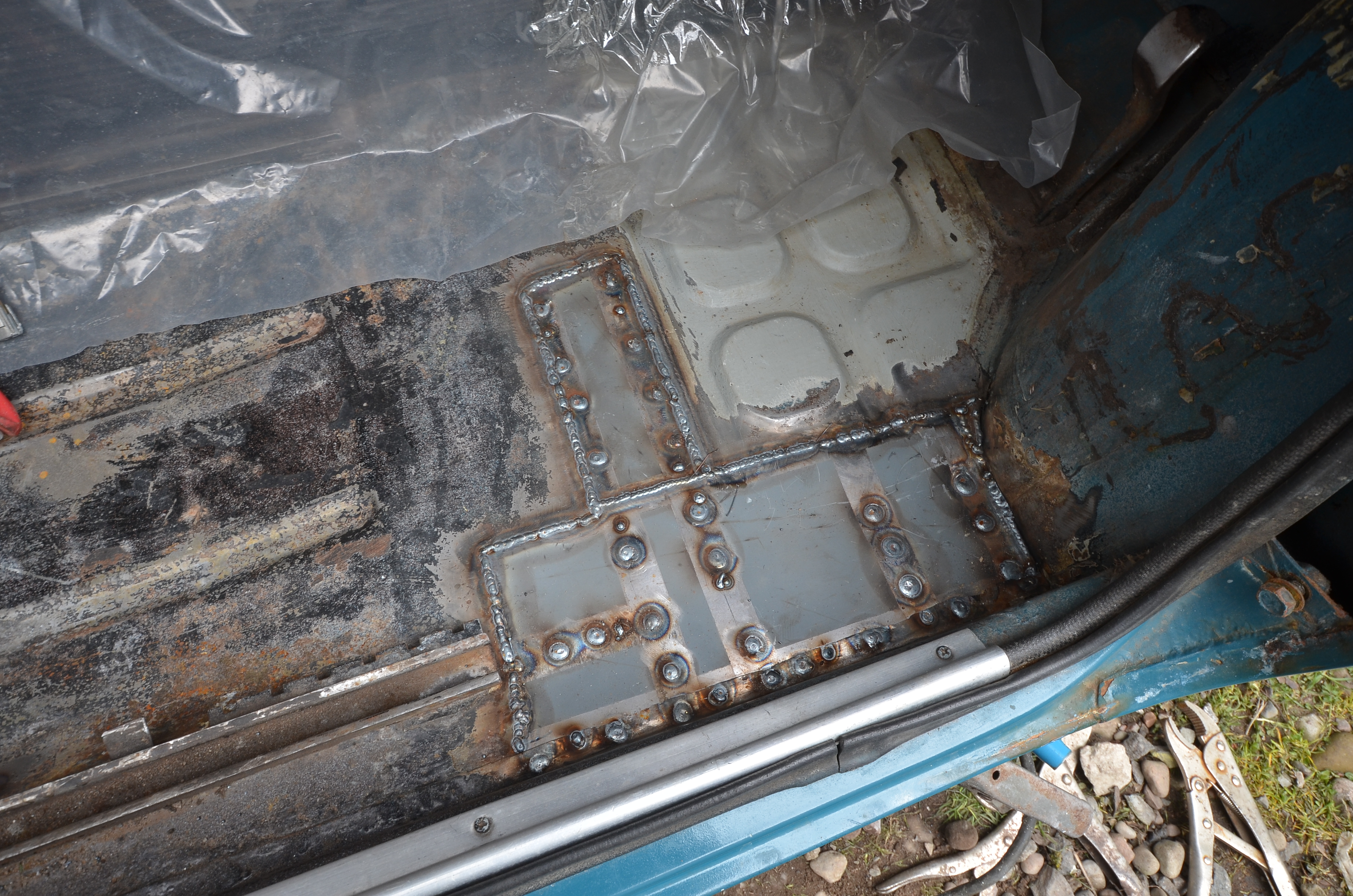

I was beaten by the weather today, but I primed all the bits I had made. I also did the existing support mounting that had to come off and is most easily de-rusted and painted when detached from the floor in any case. There is also an image of how it all fits together under the car. There's quite a bit of work in working that all out so no it shows how tempting it might be for some lesser restoration operations to take shortcuts.
I've primed all the areas that don't involve welding...there's not much left! I could have used weld-through primer but I've found it awkward to use with m.i.g. and once the heat kicks in I'm not sure how much more effective that stuff is in any case.

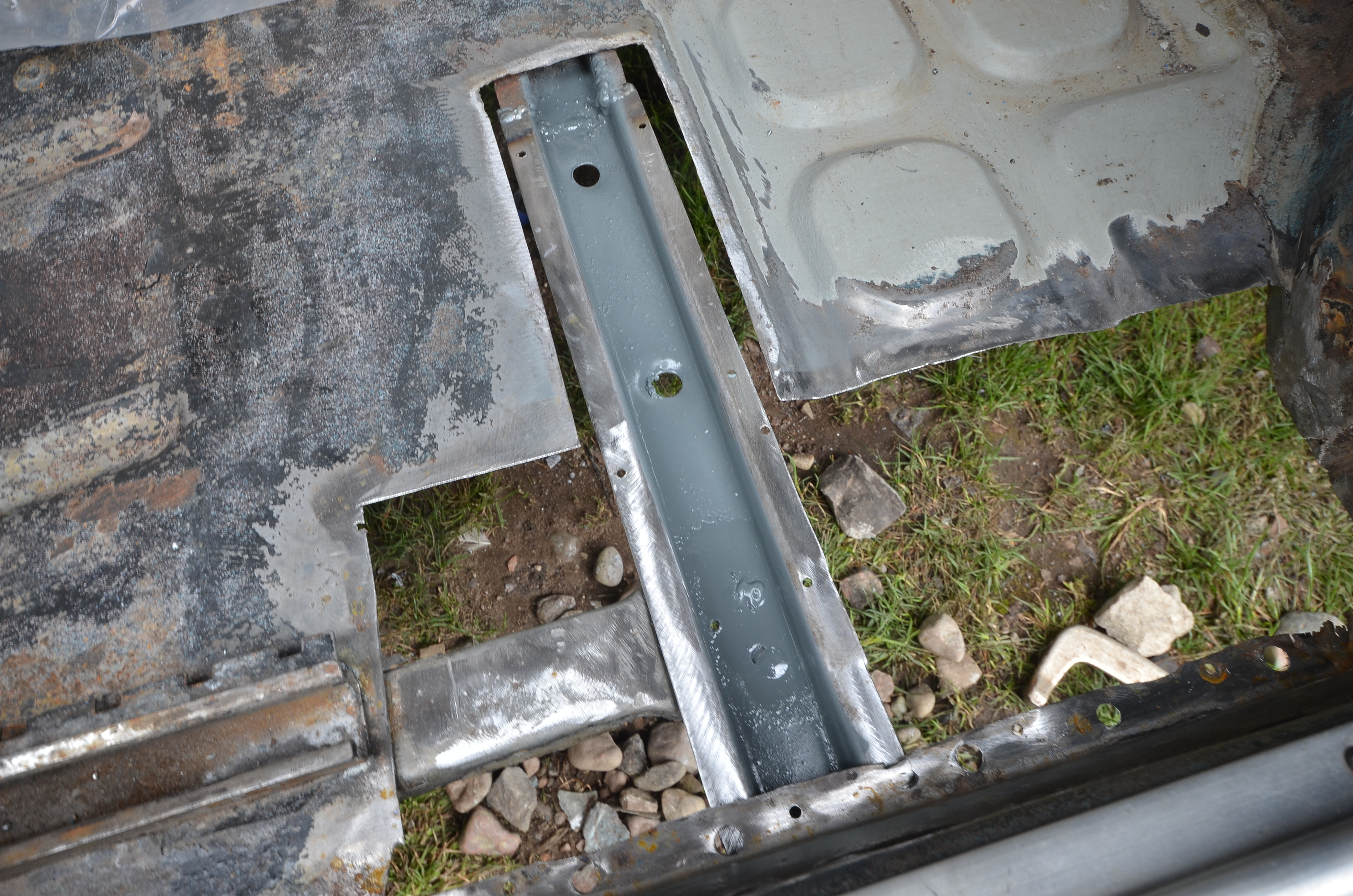

I finally got the chance to weld up the floor. As I'm doing this outside I needed a break in the rain and some of the time it was actually raining slightly.:bang:
New glasses make a difference because even with the bright light of welding it can be hard to follow a line and to gauge the burn-through point if you can't see close-up! So I think it was neater and more consistent welding than usual and because most of it could be done from above, there is no messiness underneath. Thankfully, the gas bottle just held enough to finish the job.
Next thing is to get a couple of coats of primer underneath and above, seal the seams and joins with PU and then I will be re-sound-proofing the inner floor with a better quality of insulation than I used previously.
I have an idea to take this further and to modify add to the lower part of the wheelarch by fitting captive nuts so that I can fit mudflaps. This would help to reduce the amount of water and crud that gets flicked onto this front and outer part of the floor; I also need to check all this on the other side:bang:
