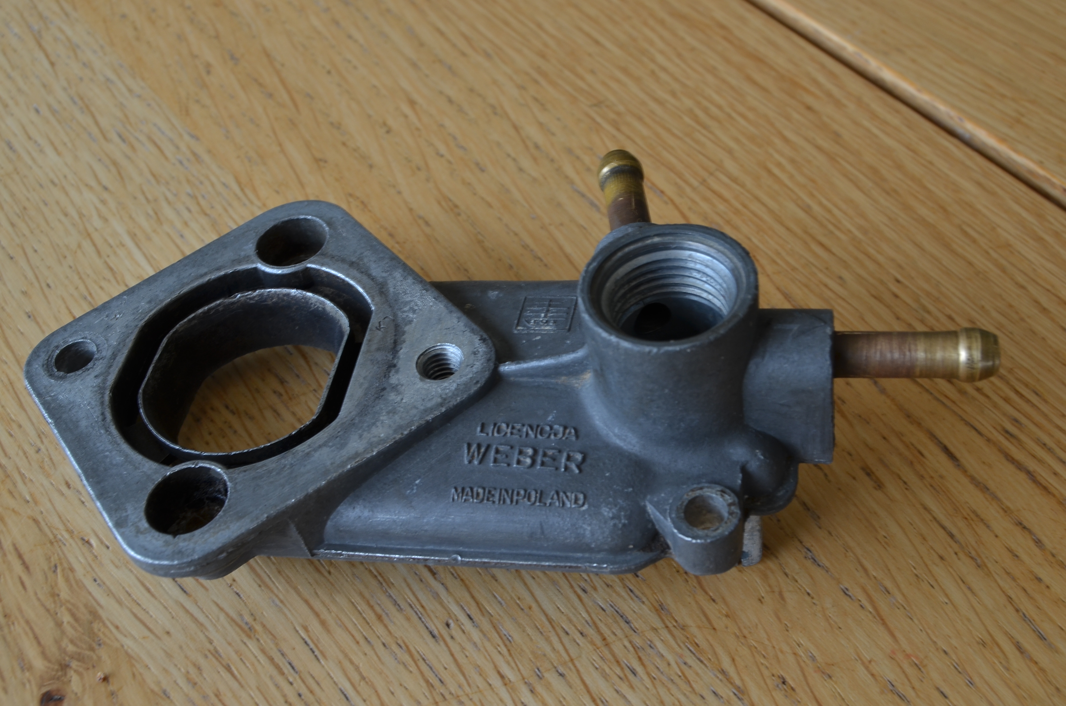

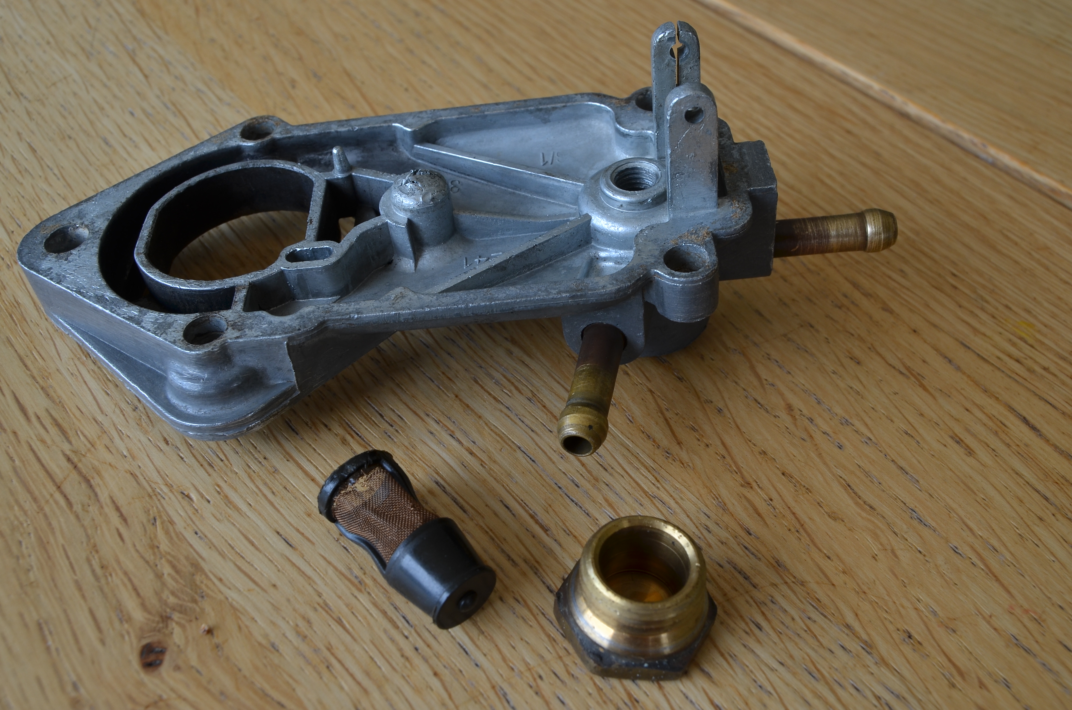

After Dave's Toshi 975 suggested it I've removed a spare top to a 28IMB carb. This one appears to be a genuine Weber as it comes off an untouched 652 engine. You can see the detail of the bypass arrangement and the tapered seat, brass filter access screw. This is the filter that should remove any speck of dirt that has evaded any other filters in the system, but after it's been through my ultrasonic cleaner (a bowl of white spirit and a toothbrush :D ), and been looked at closely, it has been twisted resulting in a split....now in the bin.

That is a shame , I have never seen one with a split before. Have you got a replacement? I would pull out the brass ferrules before the dustman comes, they sometimes come in handy. Message me if you have not got another spare :)
:)..that's very kind of you (as usual). The split is in the plastic fillter-basket.. you had to look very close to see it. The carb top itself is good apart from where the centrally placed elbow-screw has been driven slightly through what appears to have been a blind tapping; no big deal with a bit of threadlock to be certain.
It's going to work fine. thanks again for the suggestion.:)
Oh that little bit, I thought you were talking about the casting :)

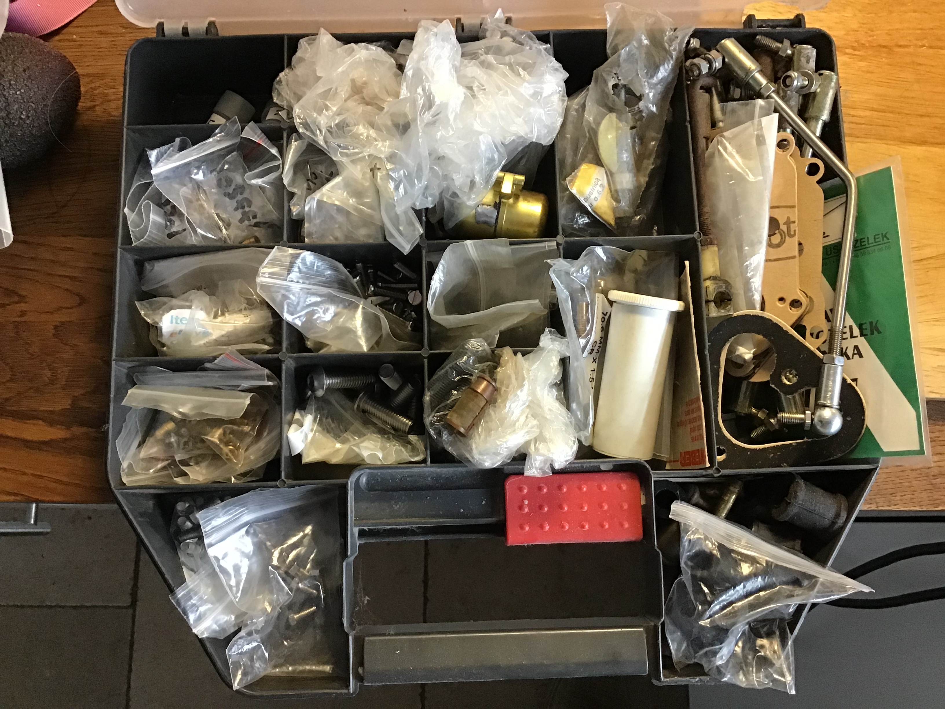

I have got a few carb bits including one with the brass mesh if you should need it.

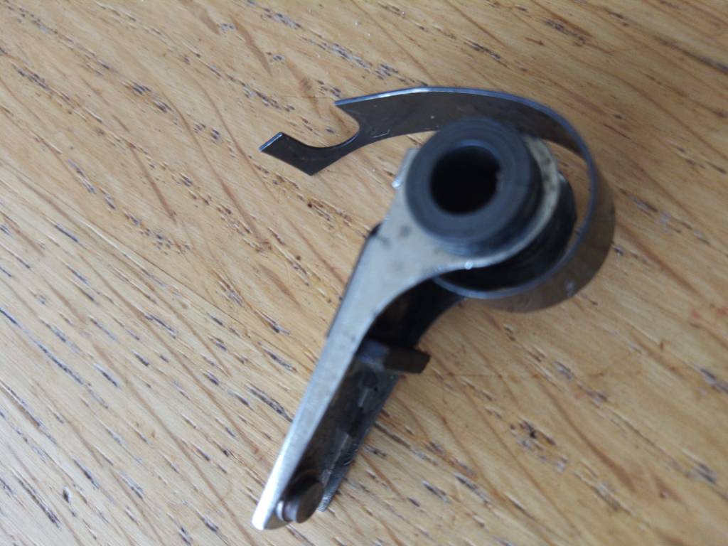

The contact breaker assembly is a mystery. I couldn't achieve my version of the old illuminating bulb technique to set the initial timing (I use a continuity tester). On investigation I could see that the pivot bush, which should be made of an insulated fibre compound, was made of steel. So despite having done many miles on this setup, in theory it shouldn't have worked; there should have been an insulated washer under the pivot. So I used a genuine, old set, smoothed on a flat diamond stone, cleaned and adjusted followed by dynamic timing with the strobe.

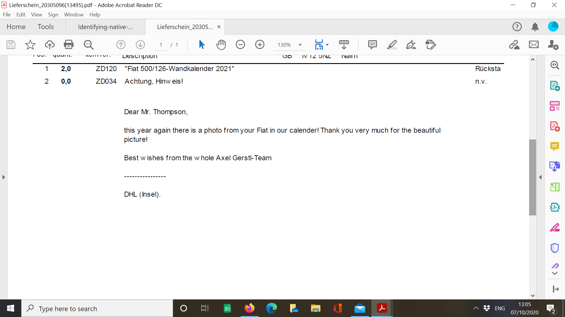

Here's what Murf looks like on the Axel Gerstl calendar and another standard photo of him posing in The Highlands. :)

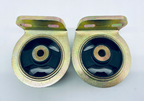

Of the 4 I have laying around, only one seems to be in what I would deem "good" condition. These seem like a less-than-ideal design. Have you, or anyone else, seen a polyurethane one that might be a bit more rugged?
I've been searching the 'net all evening. This is one part where the repros are actually quite good. As you say...less than ideal design. The later 126 BIS tried to improve on it with oversized, circular mountings. But in my experience, these were no more reliable. They are very expensive for anyone who wanted to experiment.
