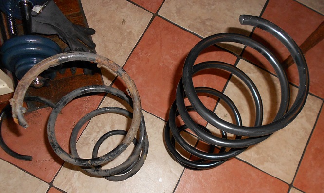

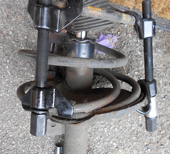

If it's not too late, I'm just in the middle of doing my Strut Tops (replacing).

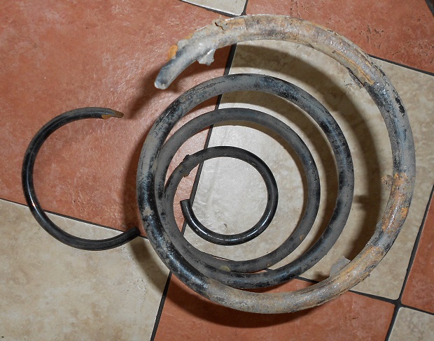

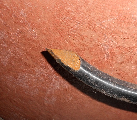

Right side went OK, but just found the left Spring is broken (n)
Approx 4.5 full turns on mine, I'm assuming they're the originals.
I'll post a pic a bit later.

Replacements are by Lesjofors, Swedish.
Not sure why, but the R/H Strut now seems to bottom out easily, only replaced the Top Mount on that side.
