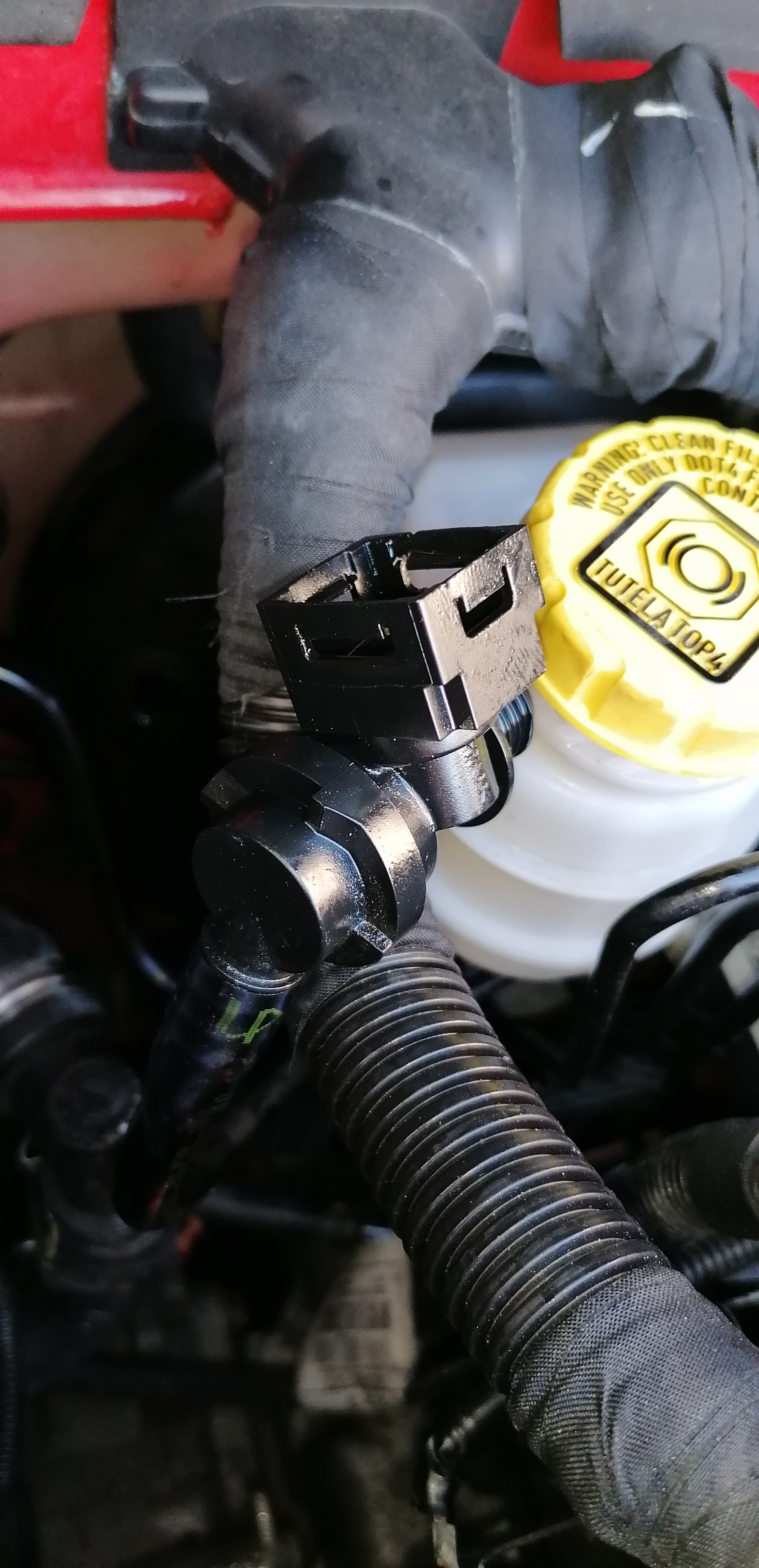

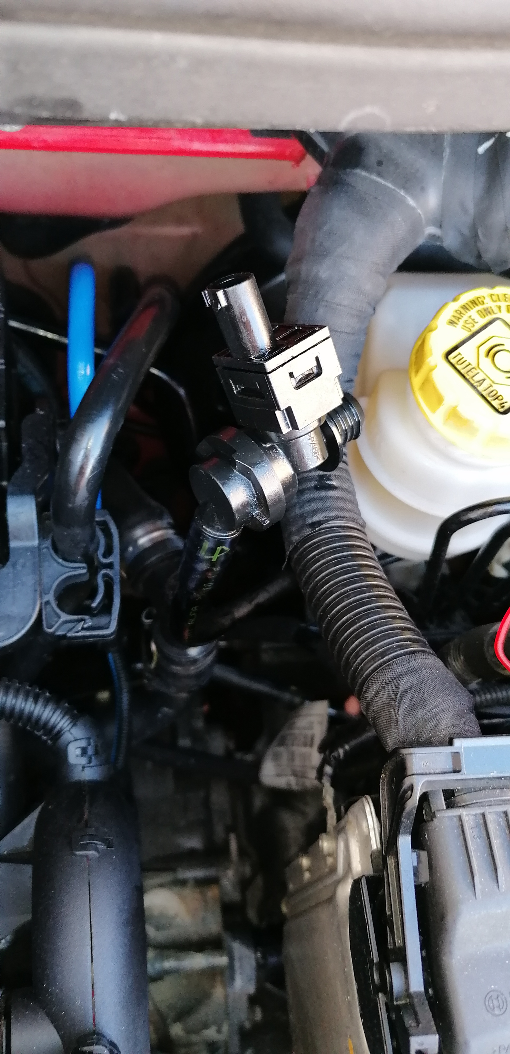

I did a video of the charging on a 22 minute run. At the start of the video the EML and triangle came on again. The video is here https://youtu.be/gmhQQSOkGgM
After I checked the code again and P0555 came up and lo and behold the brake booster vacuum switch open or short circuit was the result. My car DOES have said switch and unplugging it results in the same code reappearing within 20 seconds. The report back initially says its intermittent so I think this is the issue.
I've called the dealer and they cannot identify the part, I hope I'm not fobbed off with a complete servo for a silly switch.
Could that also show a lack of vacuum, perhaps owing to a split pipe somewhere?
Hi.

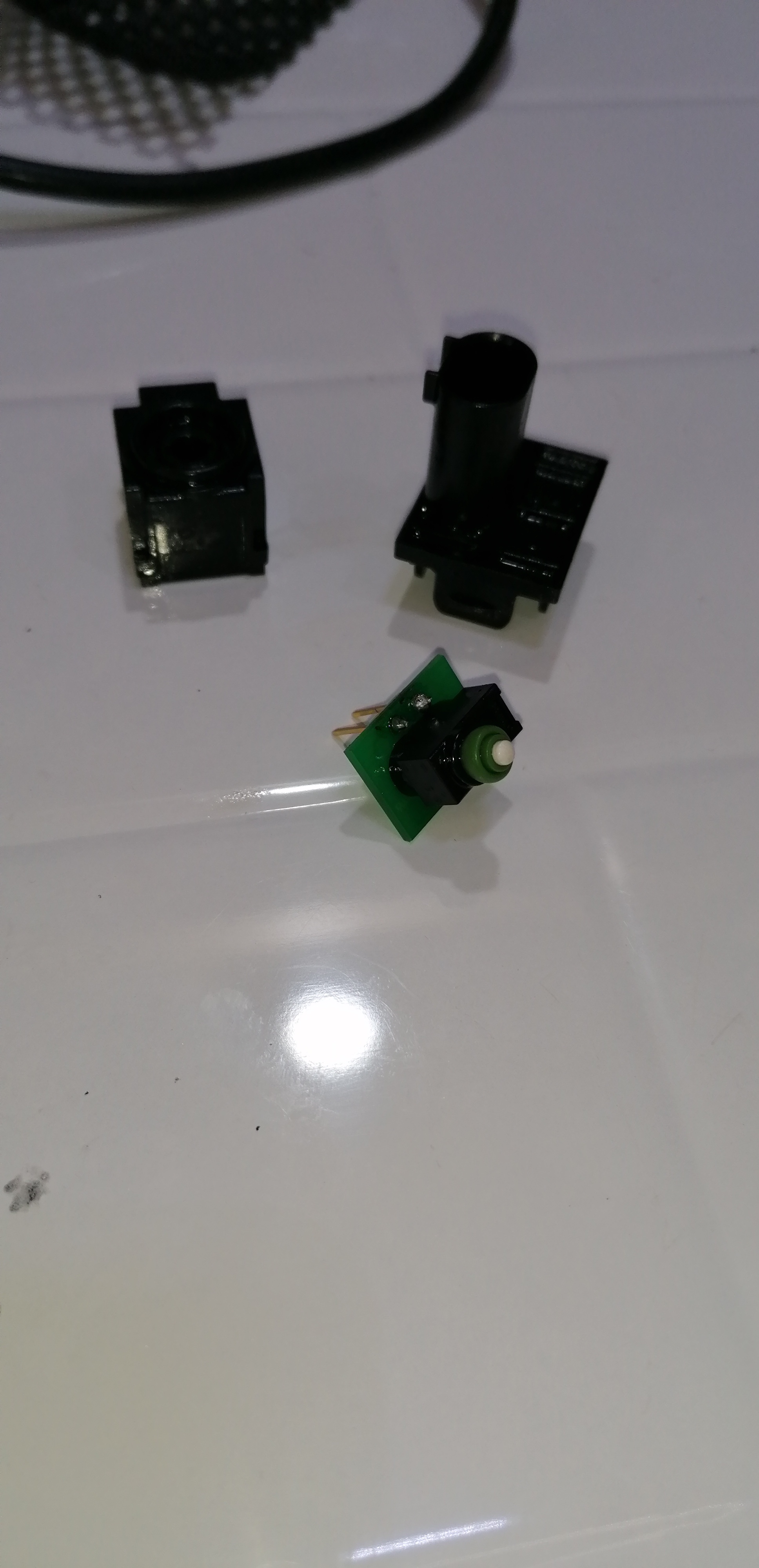

I dismantled the switch, it didn't have the issue as in the above post. What I did find is when under vacuum the plunger although retracting when you put this together the switch opened where it should be closed. So in the meantime I've not closed the clips and loosely cable tied it and it's now perfect. Looks very much like the plunger is swollen perhaps through oil..... and this is on a car with a catch tank. I can get a new assembly with pipe forv£58 from shop 4 parts.
