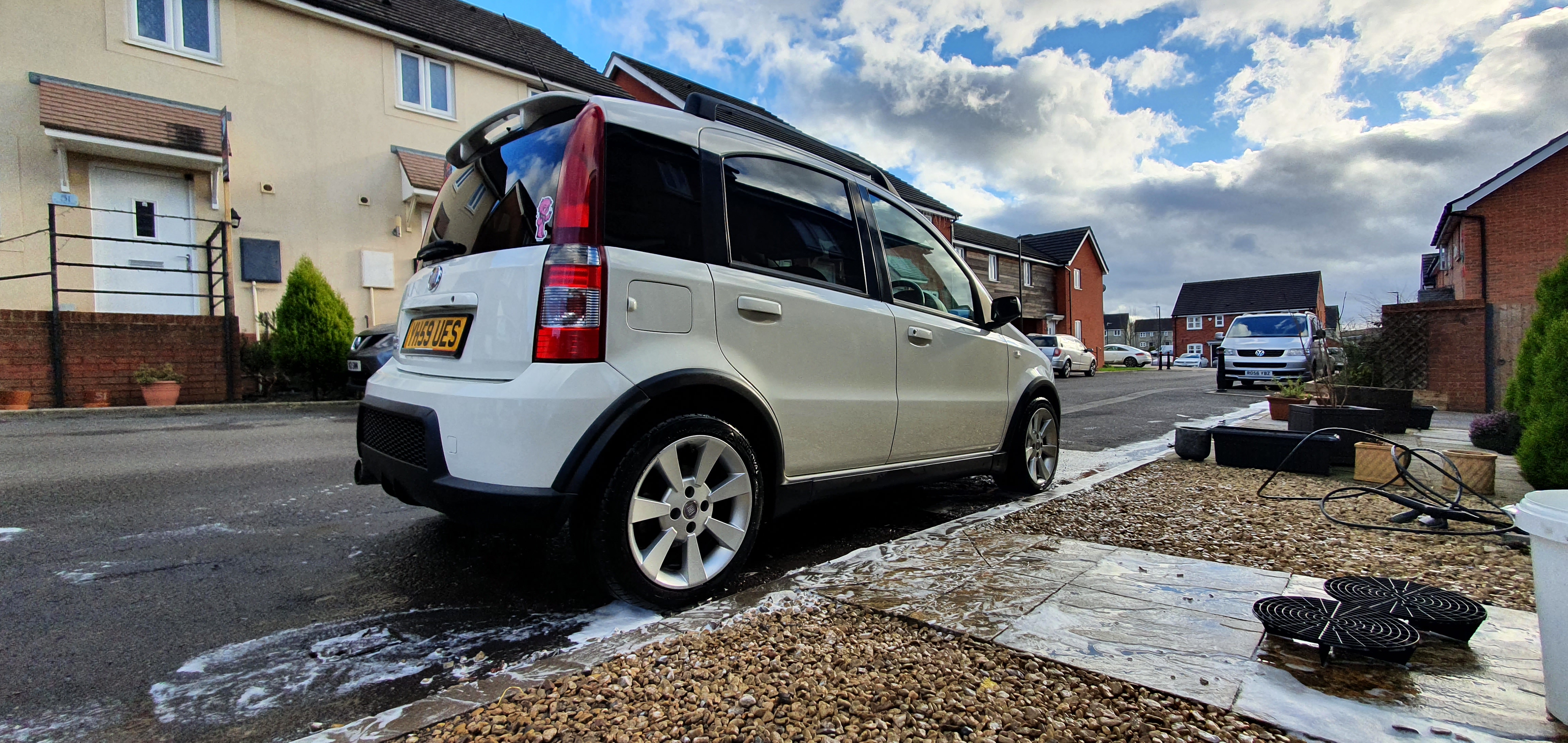

So after that, we washed it again, then clayed it, polished and sealed it. Also the first little change, new number plate holders and pressed plates.
Here's the results

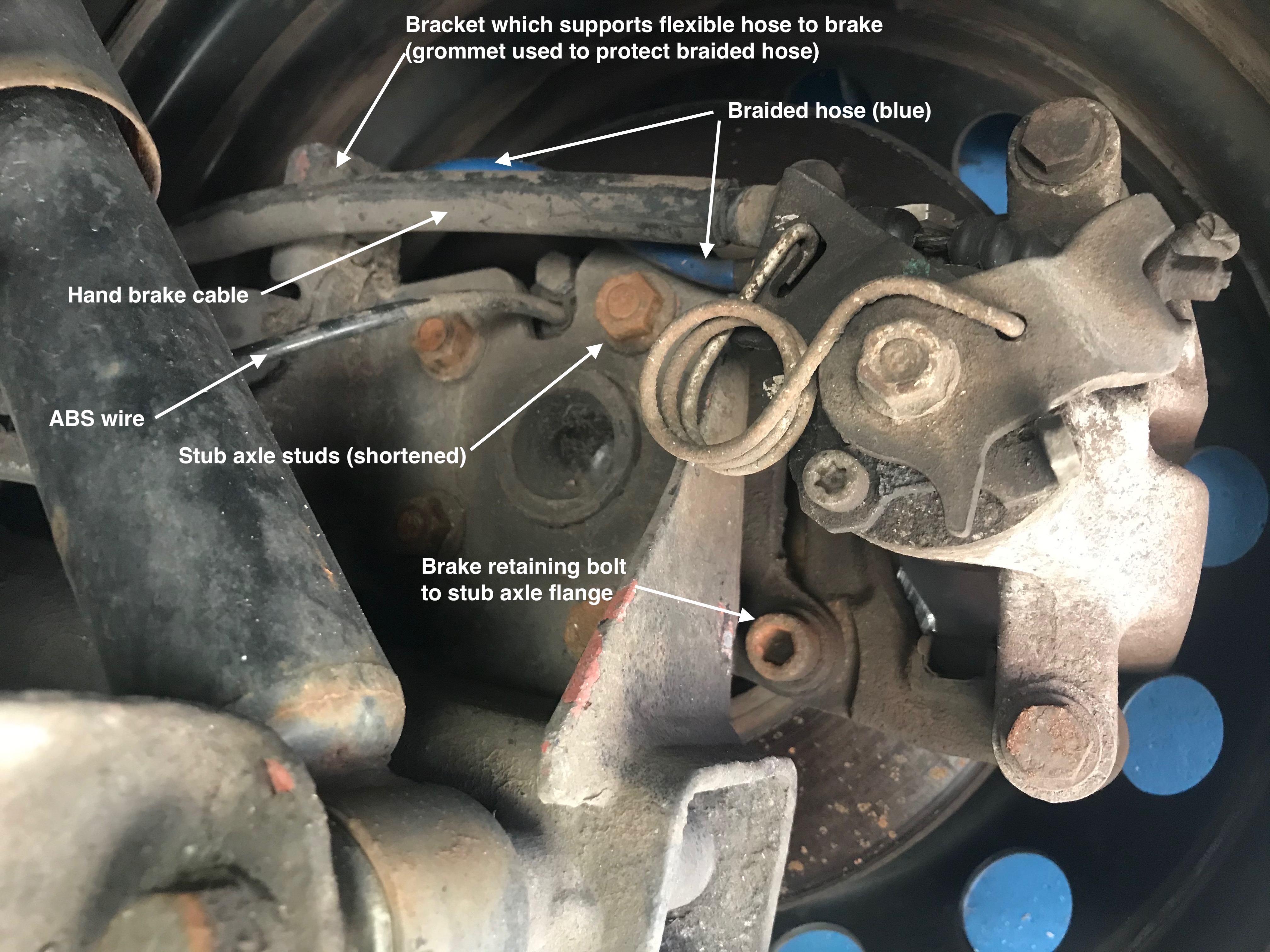

100HP rear axle and brake.
The stub axle bolts to the axle swing arm bracket. The brake caliper bolts to the stub axle flange - NOT directly to the swing arm. Undo those four M10 high tensile bolts and the whole wheel/brake assembly will fall off the axle.
The bracket hiding behind the hand brake cable supports the hydraulic hard line to flexible hose connection. I replaced the whole line from the under body bracket to caliper with a 600mm long HEL braided hose (blue). It runs through the bracket protected with a grommet. I used a banjo fitting at the brake caliper. With hindsight, a straight male connector would have been more convenient for brake servicing.
The hand brake cable does not rub on the hard line support bracket but a rubber sleeve could be added if it's a concern.
The red patches are exposed red oxide primer where the paint has not coped with life. I should have had the zinc metal spray finished with fishing boat epoxy paint.
