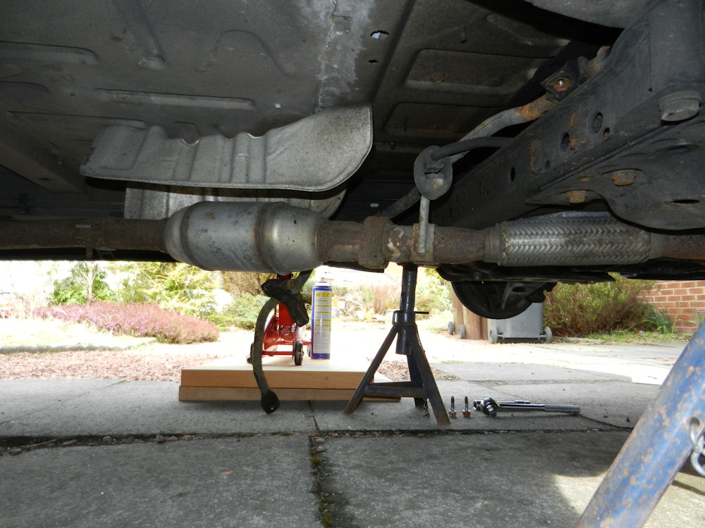

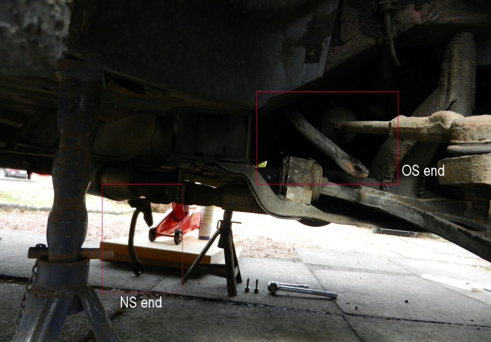

Found some pics from when I did mine. Definitely came out on (UK) near-side by passing it above the subframe. Didn't detach or have to shift anything else :slayer:
