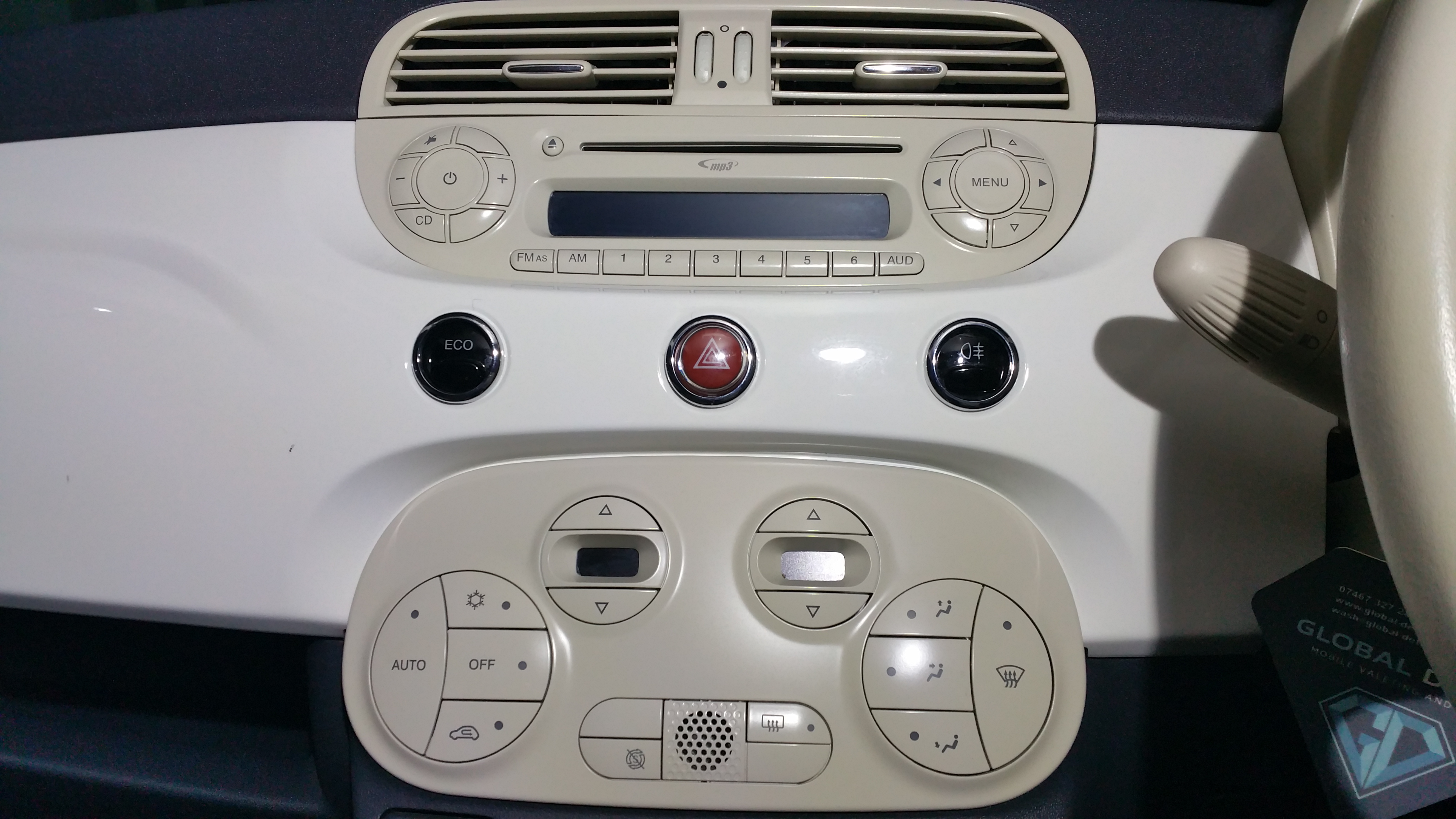

If I turn my AC off I dont get anything? How can you turn it off and still get heating?
Sorry, don't turn off the ac(compressor snowflake on) ie leave the ac on, use all other controls normally some of our cars have been 20 years old and the ac still worked only requiring recharging from time to time, climate control cars require ac always on to work correctly

If you turn the aircon off, the system will still try to achieve the temp requested. On a cool day, that's fine as it uses heat, but on a warm day, if the outside temp is close to, or above the desired temp, the system will flash the temp display to warn that it cannot achieve it. As already said, best to just leave it on.
The little round grille, bottom centre, contains a temp sensor. When you vacuum the car, run the brush gently over that, to remove dust. It will help it sense better. When I got mine, at 4 years old, it was insensitive, taking too long to react to temp changes, allowing me to shiver before adding heat, or sweat before cooling. First vac, and it was great. Been fine for the 14 years since too.

Ok, played with it today. I CAN turn AC off and still get heating, so my new setup is AC off, temp set to 24 degs and turn fan up or down to suit 😜
TBH, I chop and change to suit, but at least now I am learning what my options are, and they've just been expanded. So thank you peeps (y)

The aircon system has oil in the gas. This lubricates the pump, and keeps the seals moist. You need to run the aircon for at least ten minutes, every month, all year, minimum, to keep the seals from drying out. If the seals dry, they shrink, and the gas escapes. The pump can also destroy itself on next use. There are usually 6-8 seals in the system, costing a few pounds each, or less, but a lot of labour to replace. This is why so many older cars have non-working aircon, owners have turned it off over winter, it loses its gas, and the repair estimate is too much.
On a cold day, the aircon does not work much, so it does not really delay warm-up by much. The cooling of the air does reduce the moisture content, which helps a lot with keeping the windows dry inside. With the aircon working, then adding heat, it is possible to have a comfortable interior temp, whilst keeping windows clear. With aircon off, we're back to using more heat to keep the windows dry, so you cook inside.
I'd recommend keeping the aircon on all the time. An alternative, is to turn it off only to help warm-up in winter, then turn it back on again.

Why would it work at all? If the temp setting calls for heat why would the aircon need to kick in?
IMO, if the light is on in the dash switch, it doesn't mean the AC clutch is engaged to drive the pump. To get it to work you'd have to set the dash control temp setting, cooler than current cabin temp, which would cause the AC clutch to engage drive the pump and hence cool the cabin.
Running the A/C and heater together is an excellent way to dehumidify the car - it's particularly effective on damp days when the outside air temperature is around 10C or so.
Next time you're driving on one of those soggy days when the windscreen is hard to keep unfogged, just try putting the A/C on and you'll be surprised at just how much faster the screen demists.
Just be sure the A/C drains are clear, as you'll be condensing a fair bit of water onto the evaporator matrix. You don't want this water ending up in the footwell!
The ac works to dehumidify the incoming air so in winter it has dry hot air to clear the screen and prevent further steaming up it will click on about 10 seconds in a minute in winter
Because it does turn on
It cools the air first drying it then it oases over the heater element to warm it back up
The final air temp is controlled by a mixer valve/baffer in air box that controls how much air goes though the heater or Aircon
If only ran when you turned the temp down it would take too long to start cooling as it would take time for the evaporator to cool down
