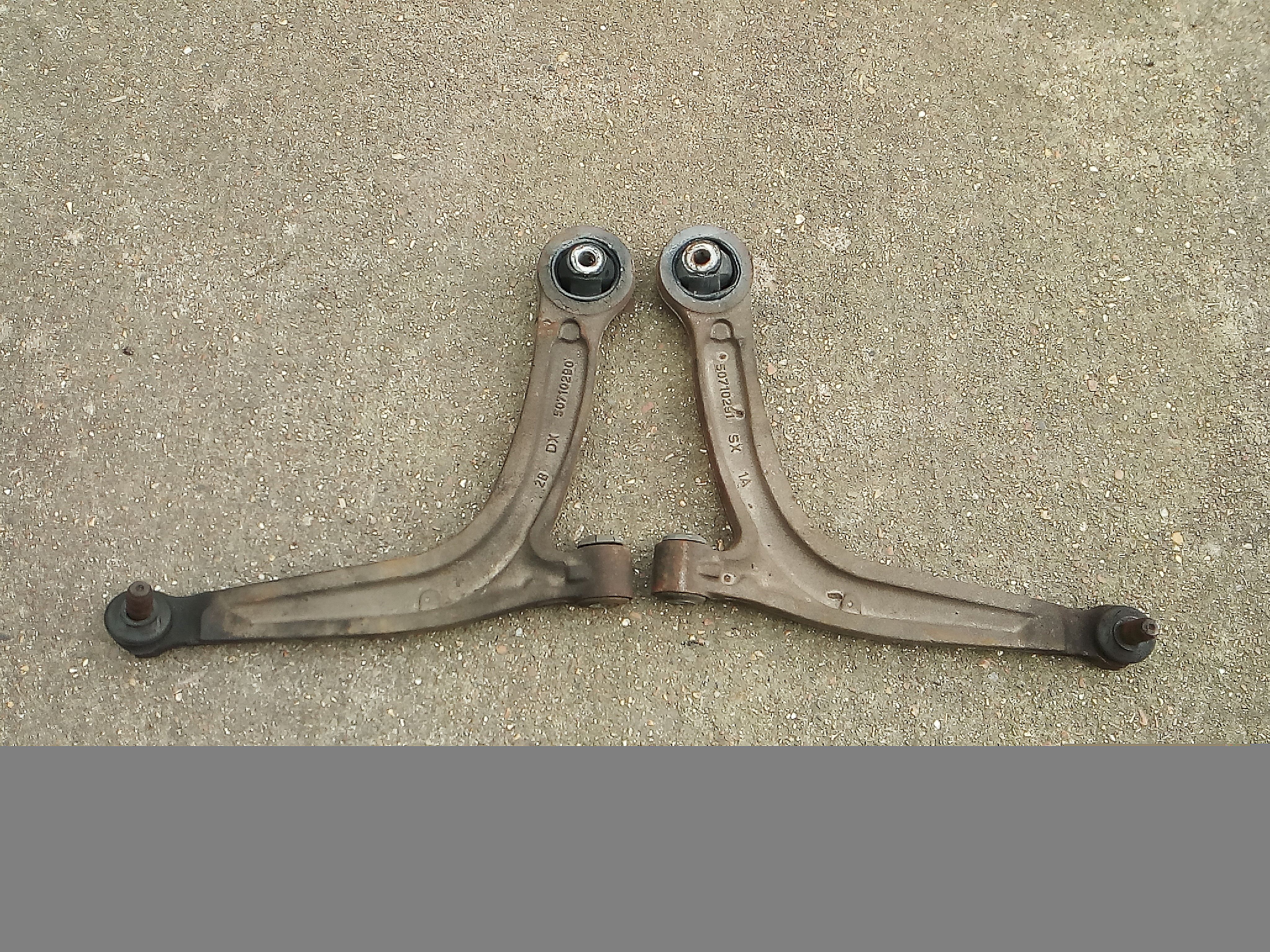

Rubber bushes in nearside lower wishbone assembly, and a rear shock gone.
So I replaced both shocks, & both that were taken off, were still functional and quite healthly looking. So spraying the underside with oil has it's drawbacks. :(
Front end was a different story, and although only the offside was flagged, I replace both sides and just as well.

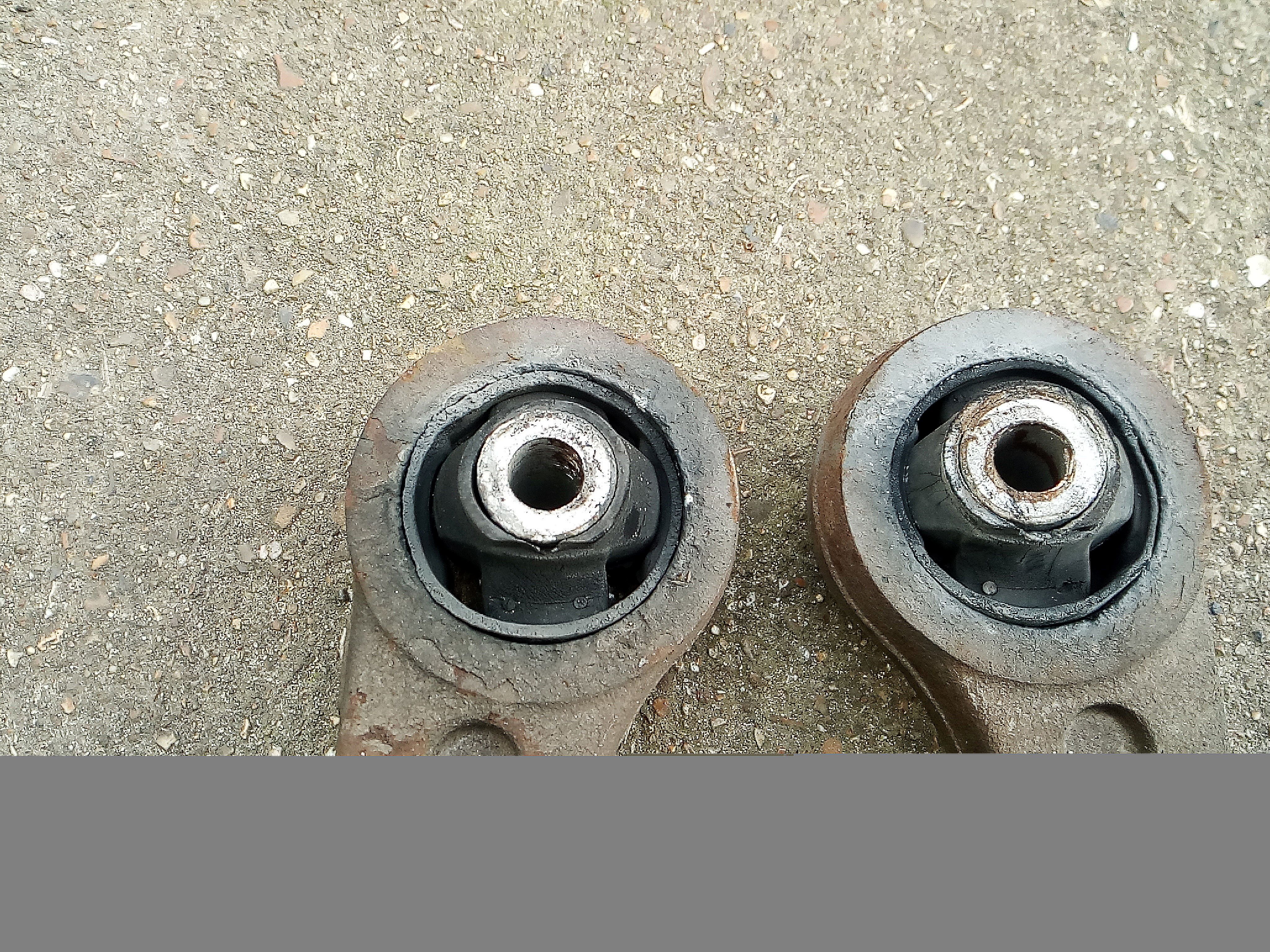

Both the rubber centres were seperated from the steel casting...

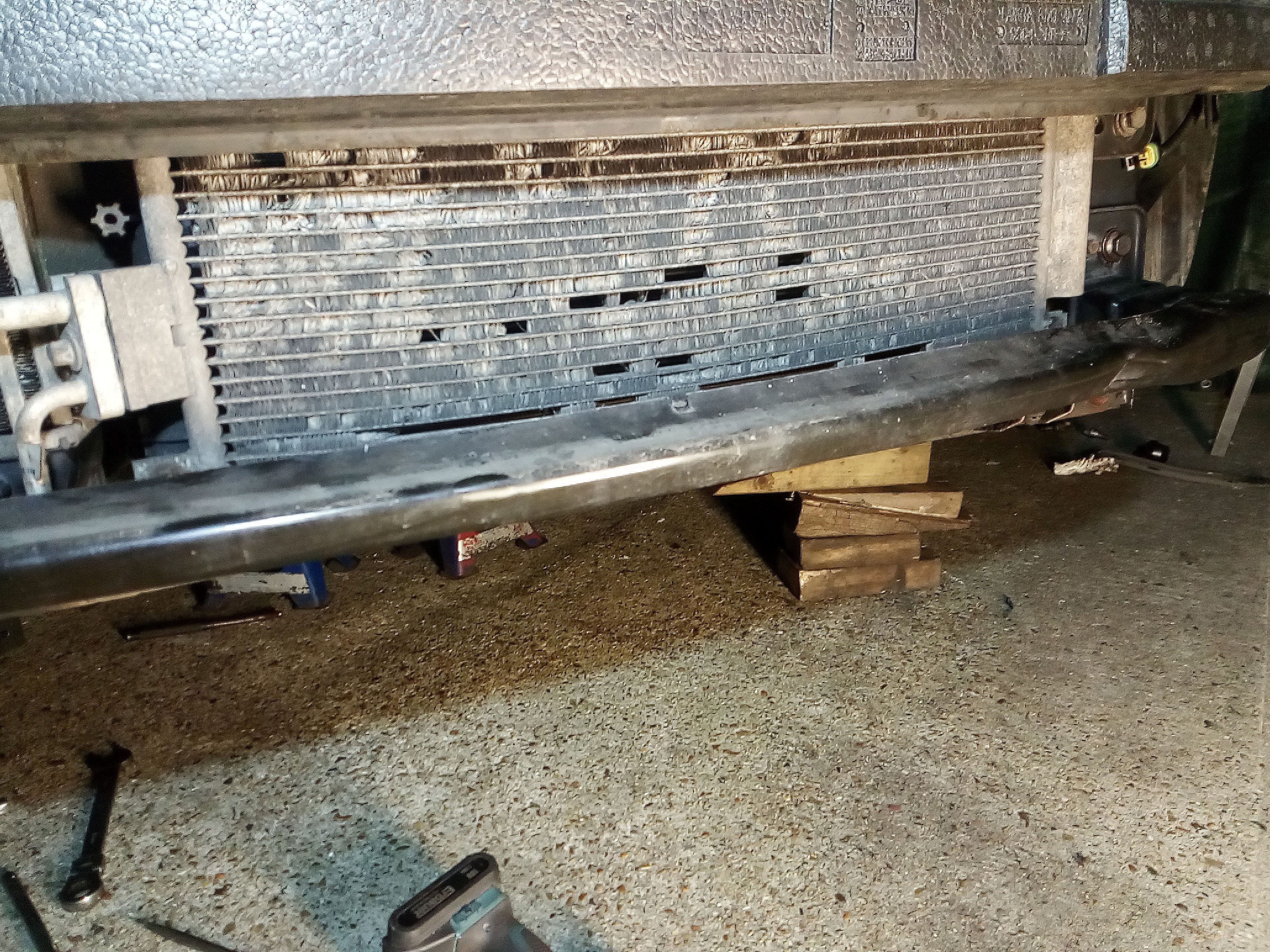

While the front bumper was of I noticed what a poor state my aircon rad was, so thats on the list now...

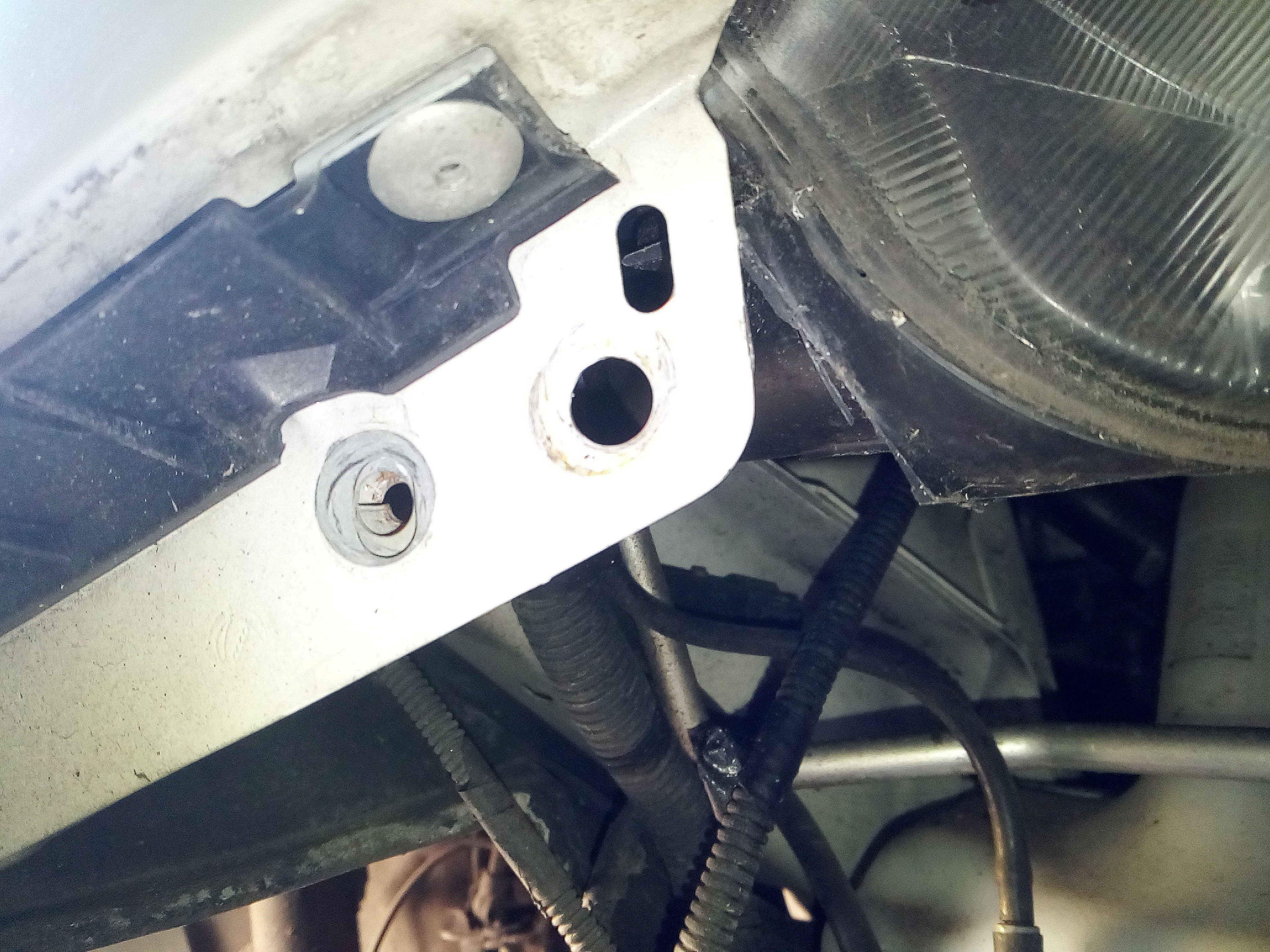

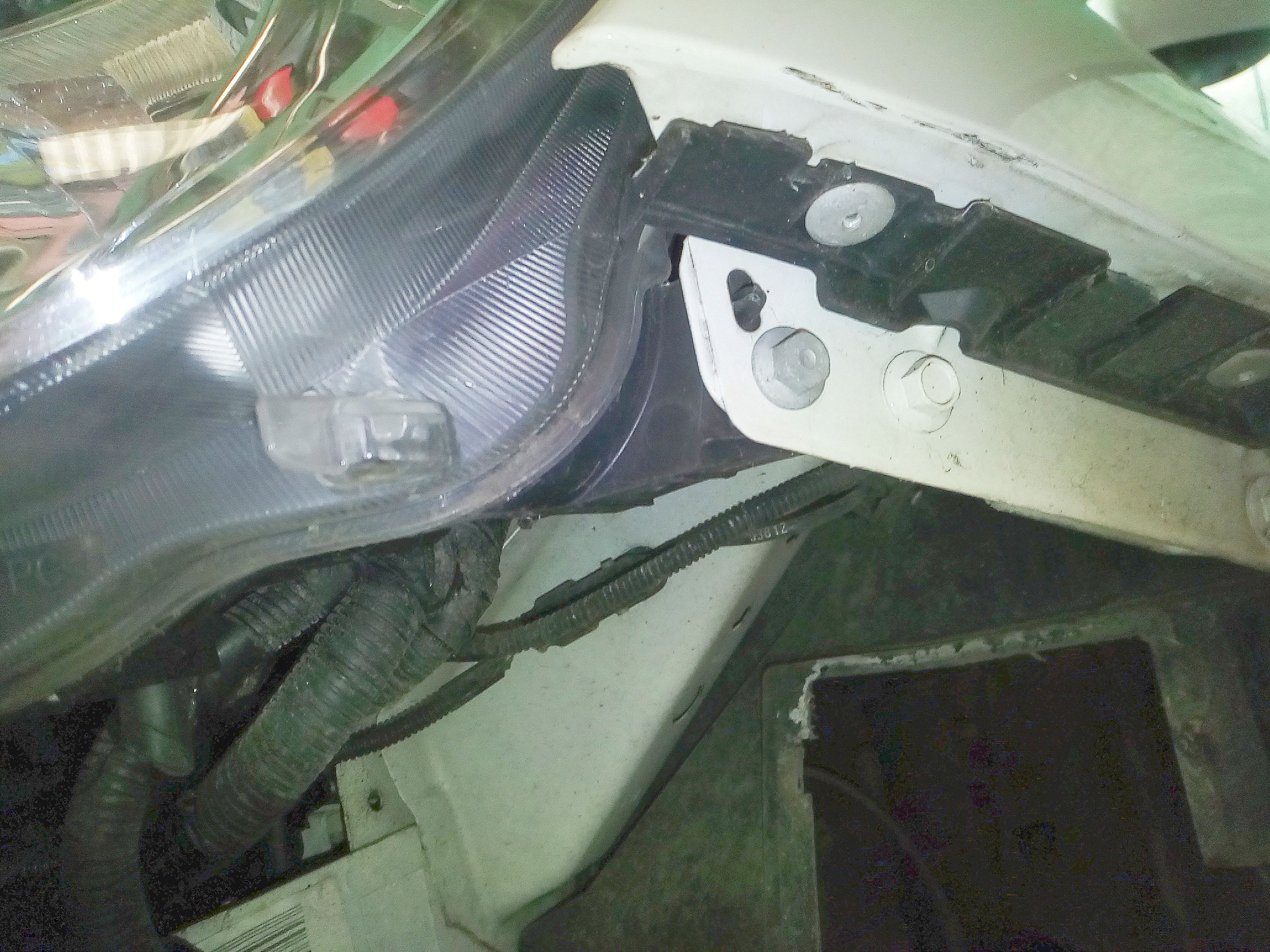

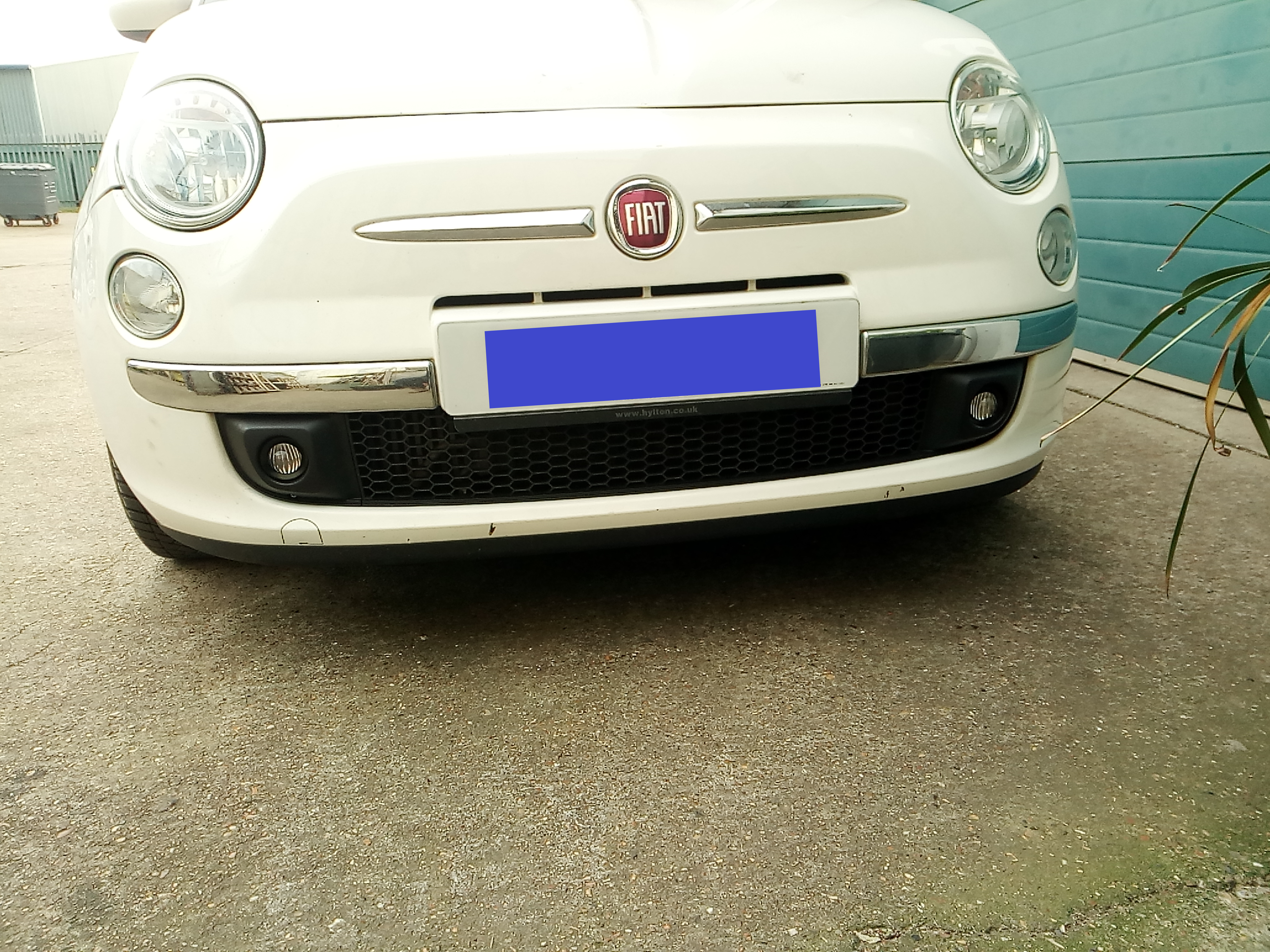

....AND.. I fitted my foglights :p
Bulbs as dim as dishwater, and I'll need to look at that later.

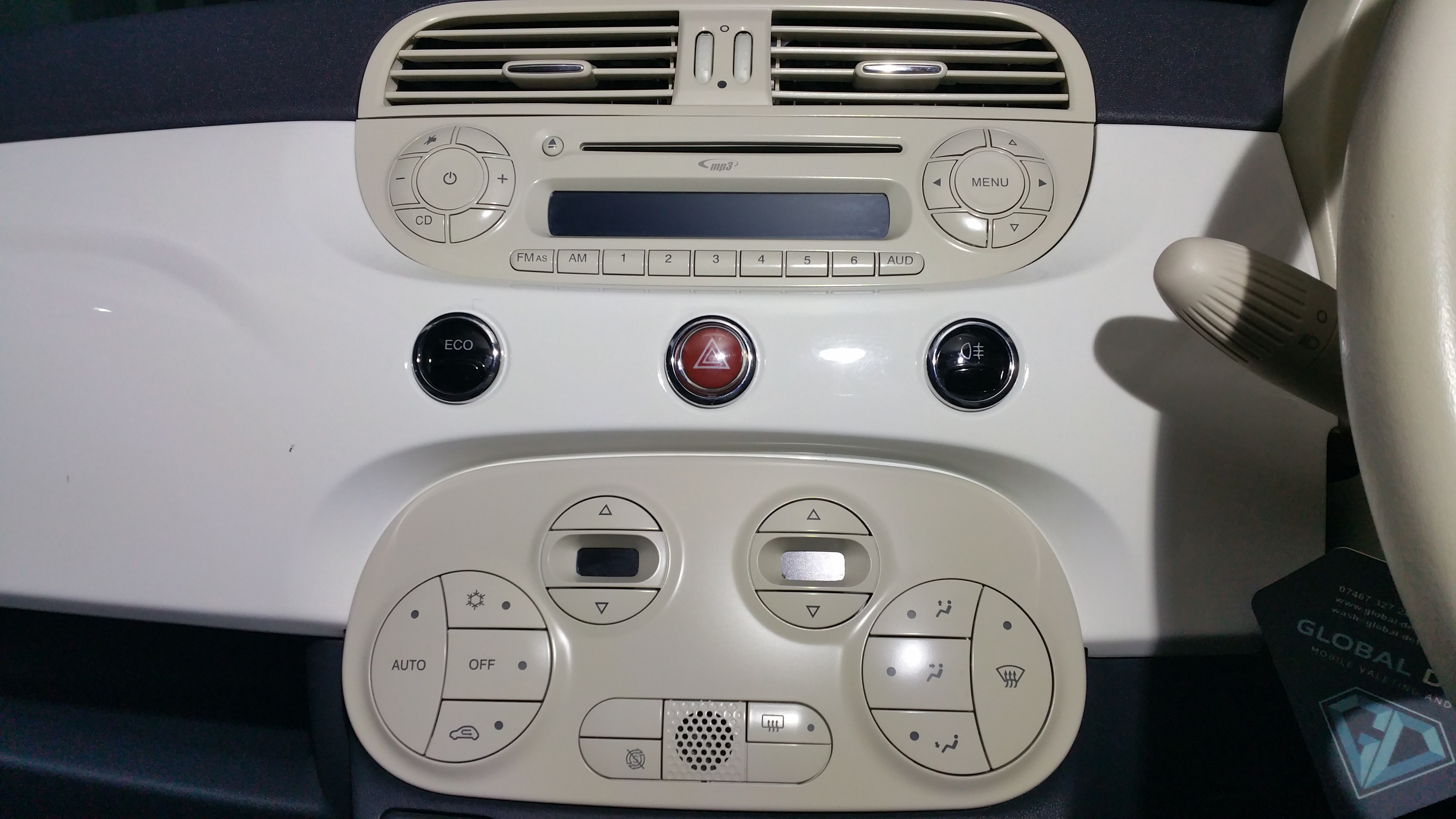

After lots of faffing around with the MES it works fine. Push once for front on, again fron front & rear on, and push again they go off.

Lower arm bushes would probably last longer if they used chewing gum instead of rubber!
surprising amount of rad damage there! previous owner an off roader maybe!

Perhaps if they actually put ALL the rubber in, instead of removing half of it, it would last longer.

I think there previous owner had some front end damage, and just put another bumper on, which is why the rad & headlight are still damaged. They obviously thought they could get away with it, (and they did).
No surprise to me; the A/C condenser simply isn't up to coping with being drenched in winter salt spray.
Most UK 500's/Pandas >4yrs old will be this bad, or worse.
Peek through the front grille of the next random 500 you see and it just might surprise you,
Fortunately they usually continue to work just fine, even once most of the smaller fins have disappeared.
There's no need to change it unless it's actually leaking refrigerant. Mine is far worse than this, and the A/C still functions well.

The missing rubber is deliberate
Is to allow more flex then a solid rubber bush
I thought it was due to the front end damage the car had before I bought it.
I think I will take your advice, and have a look. (y)
Well the fan goes too high on 'auto' for my poor delicate ears 🤣 , I use the top (AC icon) button and tweak the fan and directions, depending on conditions /preferences.
Really!? Is that not just while it stabilises the temperature? Not all the time I assume!? Do you get cold/ aircon and then heat? Without issues
Yes most definately, I just can't be assed to put up with that extreme fan noise, It'll does the job just fine if I manually wind the fan up to about 65/75%.
IMO the fan pushing the air past the cars heat exchanger too fast doesn't actually allow any heat to exchange, and it just comes out cold.
Yep, no trouble at all.
Phew … these automatic systems have flaws 🫣🤣
