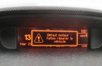

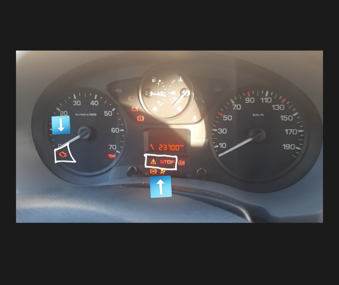

Hi, sorry I didn't see the message, so this is the code error that the car shows "Engine problem: please repair the vehicle" (sorry it's in french). Also, those are the lights that turn it n when I have the problem, they are surrounded in white. Hope someone help me. Thanks for your time.
Hi, sorry I didn't see the message, so this is the code error that the car shows "Engine problem: please repair the vehicle" (sorry it's in french). Also, those are the lights that turn it n when I have the problem, they are surrounded in white. Hope someone help me. Thanks for your time.View attachment 422447View attachment 422448
There should be some error codes that can be read via the diagnostic port, but possibly in the direction of the DPF and what it uses to clean it Eloys fluid or Adblue etc. low may be a starting point.
I had a 2012 Citroen that had those issues but with many more miles on the clock. It is possible for the fluid to run out early and cause DPF problems often due to people putting a small amopunt of fuel in many times , rather than getting low and filling completely as is advised. This is due to the computer adding the additive by the amount of time the fuel cap is opened and so running out prematurely.
A proper code read should be able to guide you.
