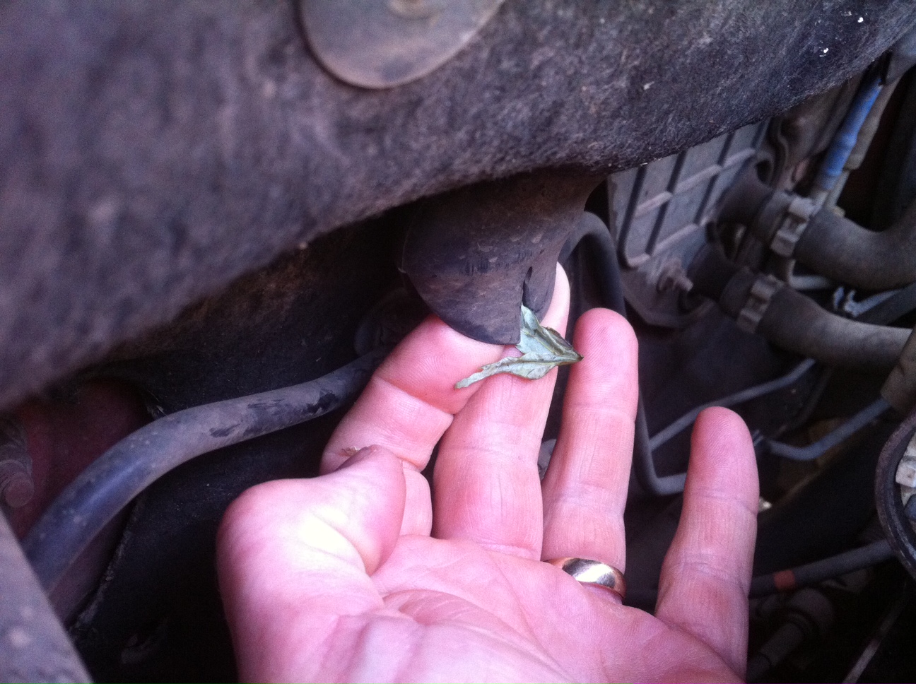

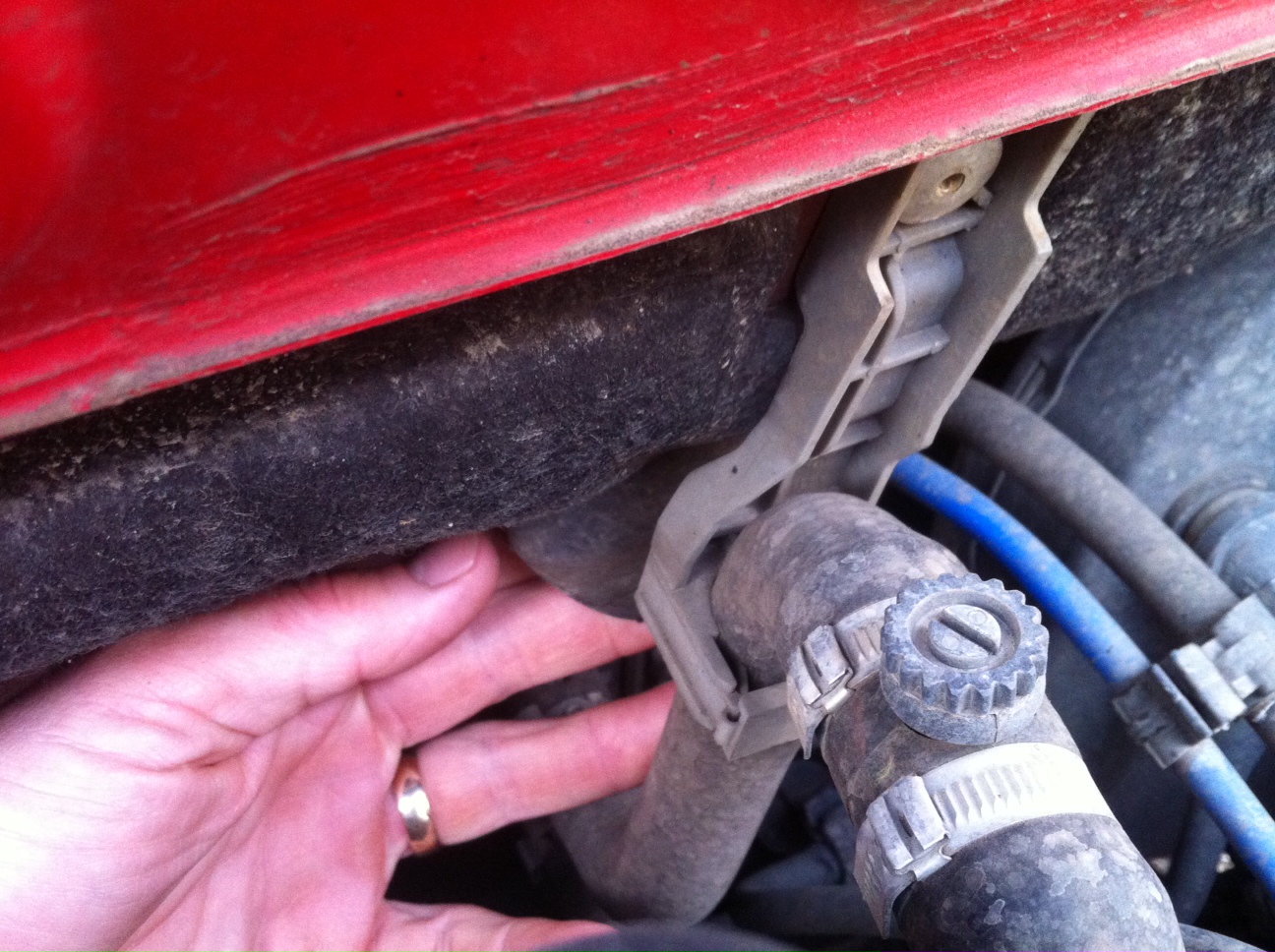

Bit hard to see in your photo, but if its what I think you are showing, there are in fact two rubber tubes like that, the ends of which are flattened out. They are there to control where the water that sits in the 'scuttle' drains away to. (The scuttle is the bit between the back of the bonnet and the bottom of the windscreen, where the wiper motor is and where air gets drawn into the ventilation system) These should be clear and allow water to drain away easily. But, especially during the autumn, leaves tend to fall in and block them... if you squeeze the tube (a bit like milking a goat, if ever you've tried that!) you can usually squeeze out the mush and they will then work as drains again. Best to check them now and again and pull out any leaves that get in there when they are still leaf-like and before they rot :)

But are these connected to anything behind the bulkhead? Are they supposed to protrude throught the bulkhead into the engine bay? While I was fiddling I pushed it back up behind the bulkhead, can't get it back again, it might move next time the car is driven, but does it matter if it's stuck behind there? If I get it out again I'll clear the debris out of it.

Yes they do protrude through the bulkhead and it is a weird design. I managed to accidentally push mine back up into the scuttle area too, so now they just sit danghling in their holes, somewhat more mobile than they should be. Still work fine though.
As has been said before though, just make sure there's no water pooling in that area and you'll be fine.

They block at the first sign of a leaf, twig, blade of grass or anything else that may fall into the area behind the bulkhead. I got so fed up of cleaning mine that I removed them and hacked a larger hole in the bottom of each one. that solved the problem for me anyway.
To remove just squeeze/twist and pull (!)
Over time they become less supple and mine just sat loosely in the holes in the bulkhead.

Just did this for the first time on our panda.. Filthy job - doesn't look like its been done since new... The only word that can describe the stuff I found in the goat teat things is compost. :yuck:
