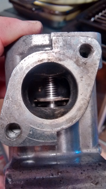

Anyway, i took off the EGR valve yesterday and cleaned it with Mr Muscle spray oven cleaner. Just sprayed it into all the holes and left it for half an hour, then went at it as best as I could with an old tooth brush and left it for half an hour again. This is caustic stufff so wear gloves and goggles. Rinsed it off with the garden hose it worked fantastic! I'll have to take an image of the spare one and post it here, I never realised that the valve itself was stainless steel!
My Multi now drives much better and returns better mileage - 38mpg to 46mpg.
Still not 100% perfect but I did have a spare washer after, resulting in less tension on the spring which could be the reason. When I have an hour spare in the next few weeks I'll put it on.
Image of EGR valve cleaned with Mr Muscle spray oven cleaner.

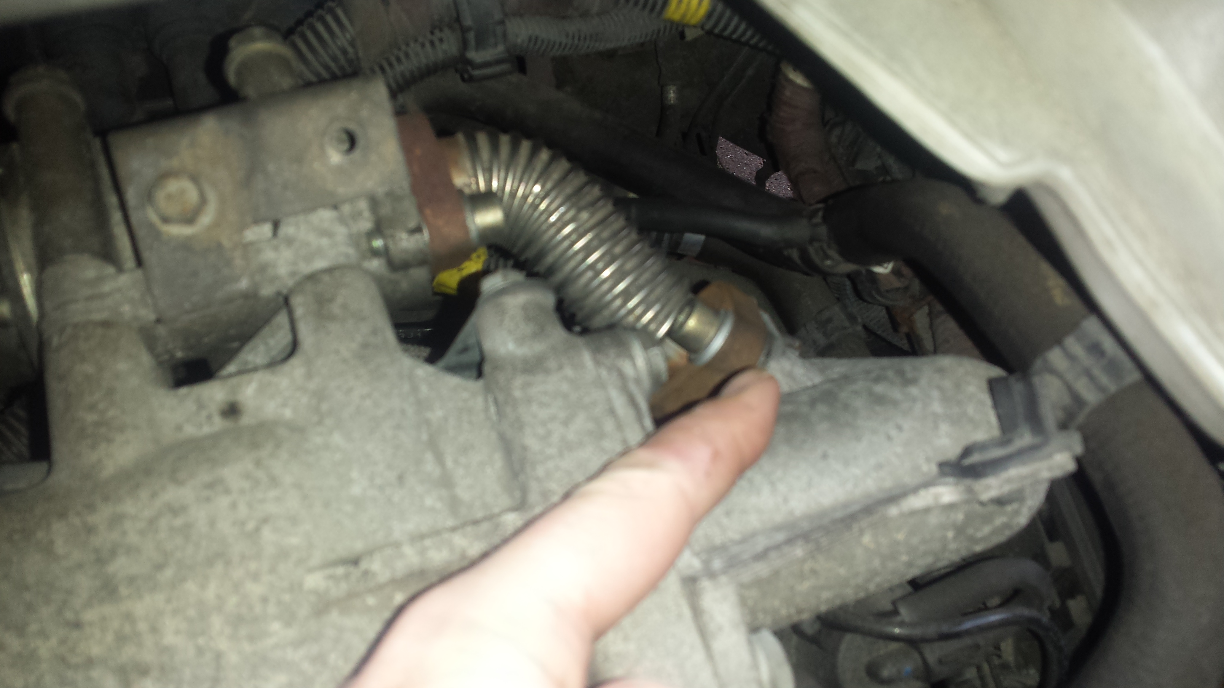

if this worked, should be a photo attached. In which case do I insert the plate where I'm pointing ?

assuming I'm in the right place, my hex bit H6 (assuming that's 6mm?) is too loose and my H7 bit won't fit in. I guess there are half sizes in hex heads / bits but not in my set aarggggghhhh :bang:
Mine was hex too
If it's been a little bit rounded try smacking the 6mm in a bit deeper do its in the bottom of the bolt head
And I didn't insert my plate there
I inserted it on the other connection high lighted on your pic
Up and to the left
I can get at the other one easier so that's quite good news.
It looks hex headed but I'll have to take another look as I can't find a 6.5mm hex bit to use with a socket set, Allen keys yes but I'd probably bend one of those anyway.
Confused ! I was all set to fit it and test drive it earlier too :( (n)
