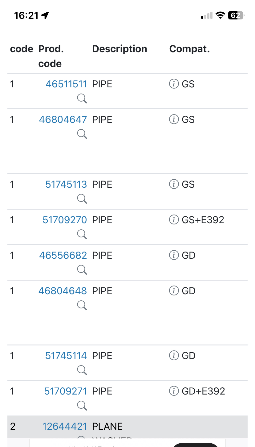

While the diagram is easy to navigate the problem i'm finding is that there is no part number to put forward when searching. It only gives you No1 which is the pipe but thats not a part number, only a diagram reference. Thanks though, i will try ebay again.

If you scroll down the diagram
You will see a series 1s
Next to each 1 is a part number
Look at the whole page next to each part number is a further number that if you click on gives info on which vehicle options the part number is for......
I will give you a clue GD is the right hand drive models
You know the number 1 links to all the possible part numbers in the list below, it depends on your car’s configuration so you need to find the part number that matches your car.
You just need to scroll down
There are 4 different part numbers that are for right hand drive. GD
You will have to know if you have
Vehicle dynamic control
A separate a.c. drier or if it's built into condenser
Click on the i in a circle for extra info regarding what part is comparable with
I think there is an option for entering your vin into eper and requesting it shows parts relating to your vin.... someone else may be able to help with how to or say if I'm wrong

Okay chaps. Now i know the left and right codes that makes things easier. Will check with the info you have given. Cheers.
