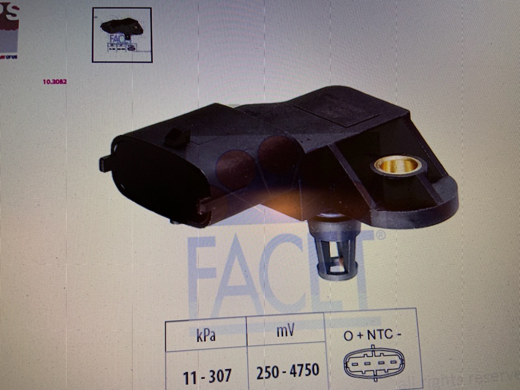

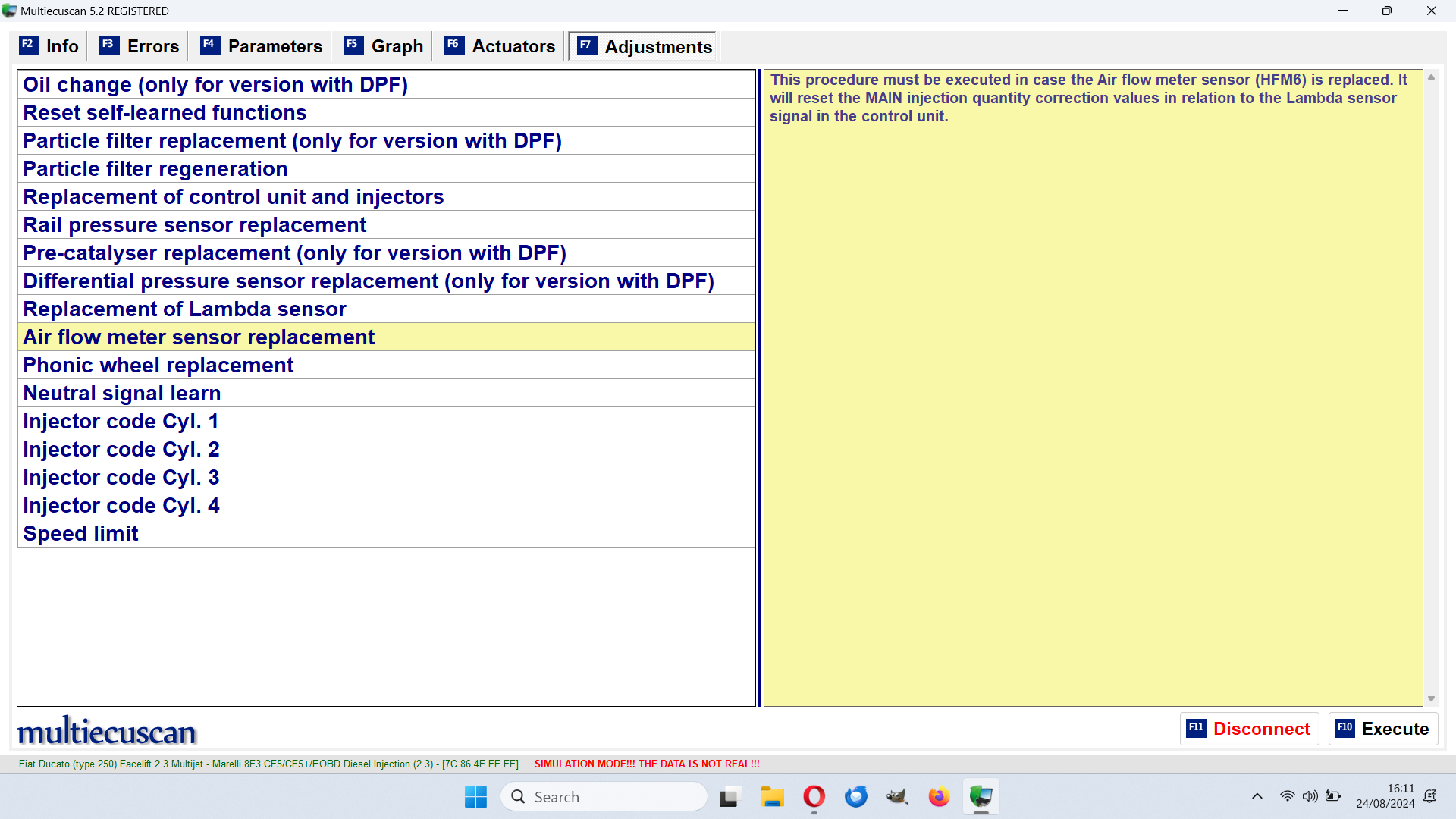

I have a Fiat Ducato 2.3 150 HP. Got error code P0238. I have changed the Mapsensor, I have changed the Turbo pressure valve, They have checked the EGR valve. But still the same error code. Should the ECU be set when the Mapsensor has been changed?
No , the MAP sensor doesnt need reading to the ECU. the MAF sensor does not the MAP. x250 2.3 facelift
But can someone give me a hint what the problem is? My workshop can't figure out what the problem is.
They found an unusual amount of soot and oil in the Turbo, even on the map sensor that was changed, there was a lot of oil on it.

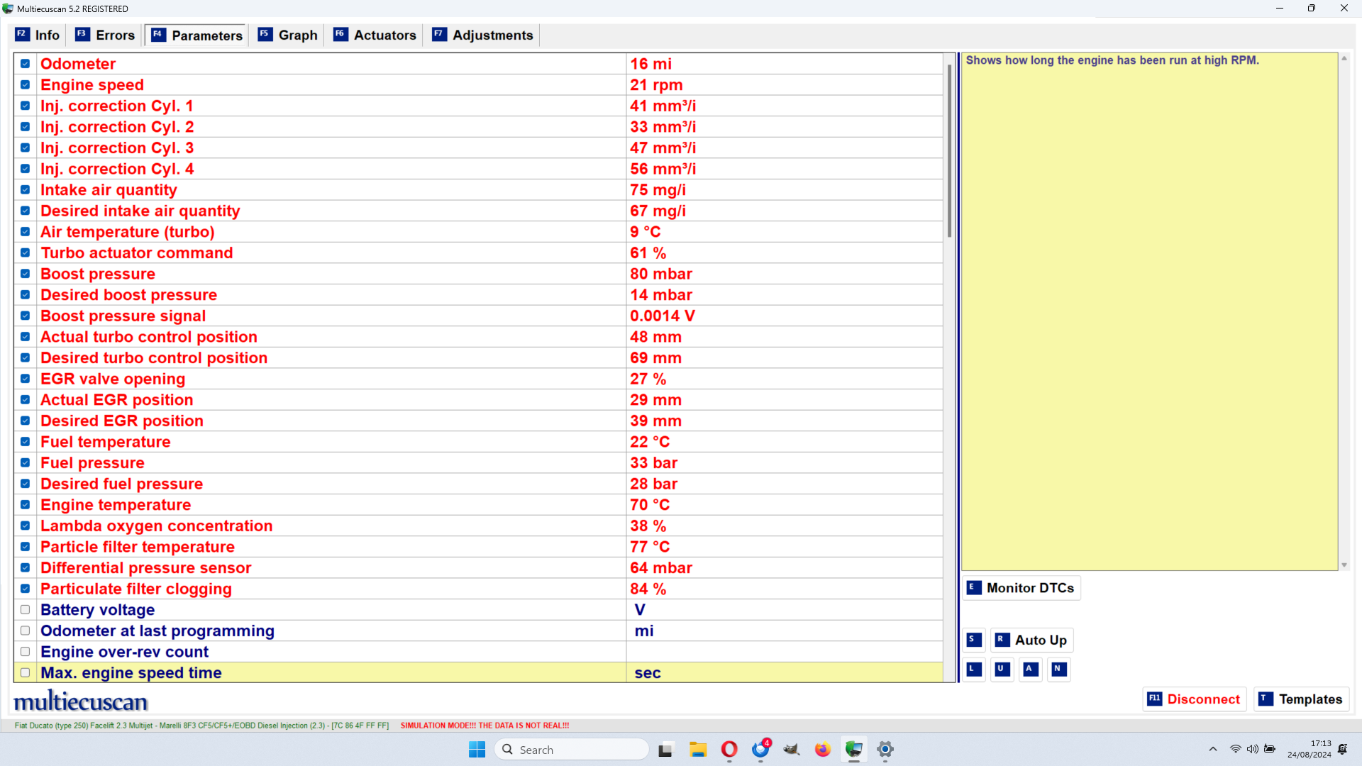

Error code P0238, Fiat Ducato 2.3, 2013 model year
The following things have been done:
- Replace Mapsensor. In connection with this, a lot of soot and oil was discovered on the map sensor and inside the turbo.
- Change turbo pressure valve Fiat original.
- Flue gas tested intake/pressure pipe/intercooler X2 no leaks found.
- Control hoses to turbo pressure valve, slightly rubbed but no holes.
- Tried with new hoses without results, old hoses refitted.
- Check connector to MAP sensor, all ok.
- Check values DPF, ok.
- Run wastegate rod function in computer, ok / rod moves)
- Control contact to wastegate, ok.
- Dismantling the EGR cooler, checking the EGR, is closed (no function in the computer to test drive)
- Check charge & atmospheric pressure while driving and stationary, it revs too low. Charging pressure at gas application approx. 1000 mbar, should be approx. 2000 mbar.
- Checked turbo pressure valve that it is the latest version updated.
- Control vacuum from the turbo to the turbo pressure valve, ok.
- Basic setting turbo, could not be implemented.
- Smoke test vacuum box in front of turbo pressure valve.
- Change the fuel filter.
- Discovered that my engine has too much oil. Sucked out about 2 l of oil, then the level on the dipstick ended up in a position between min and full. Could this have caused me problems with the Turbo?
All this done but still error code P0238.
Does anyone have a suggestion for a remedy?
