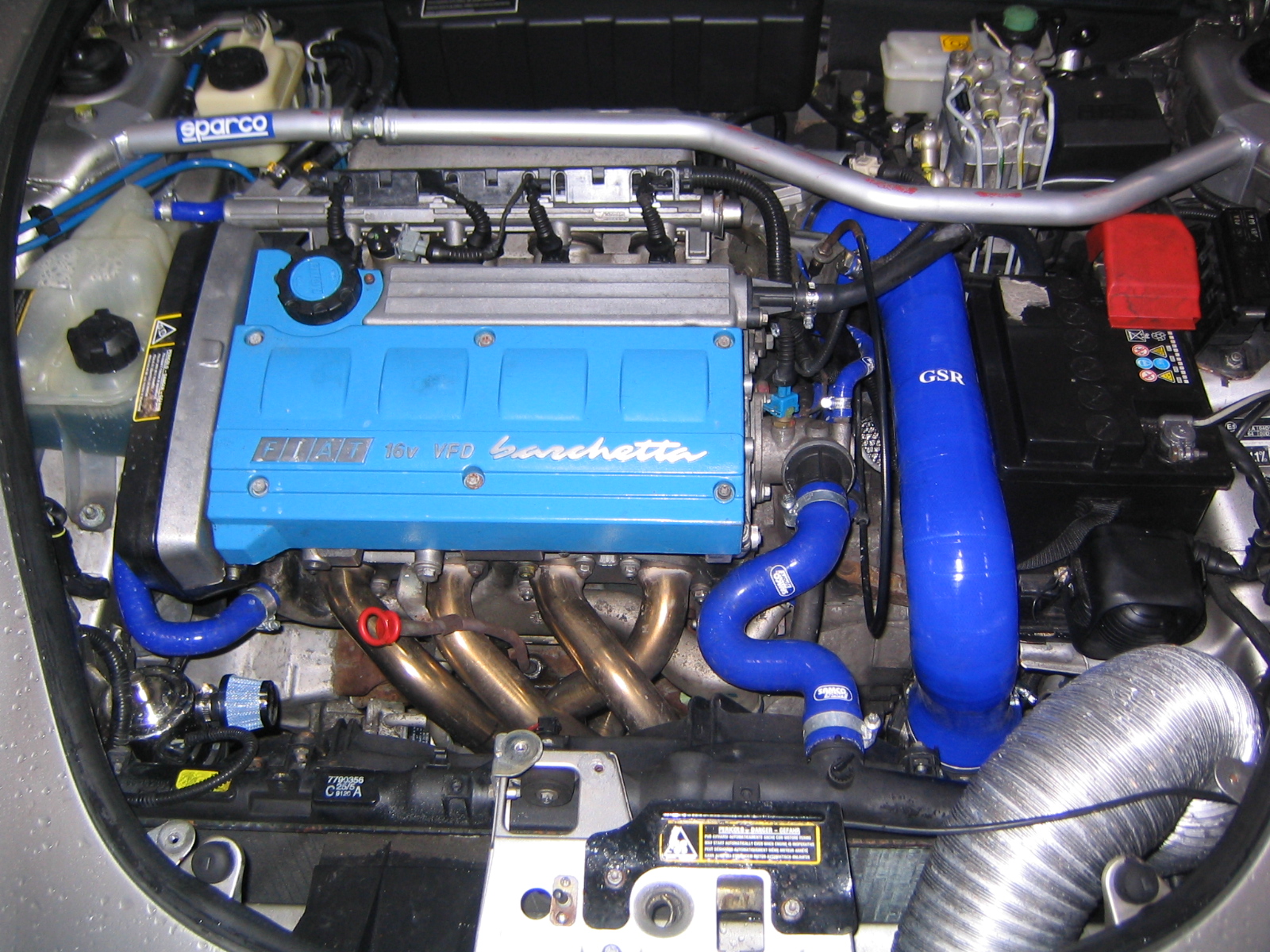

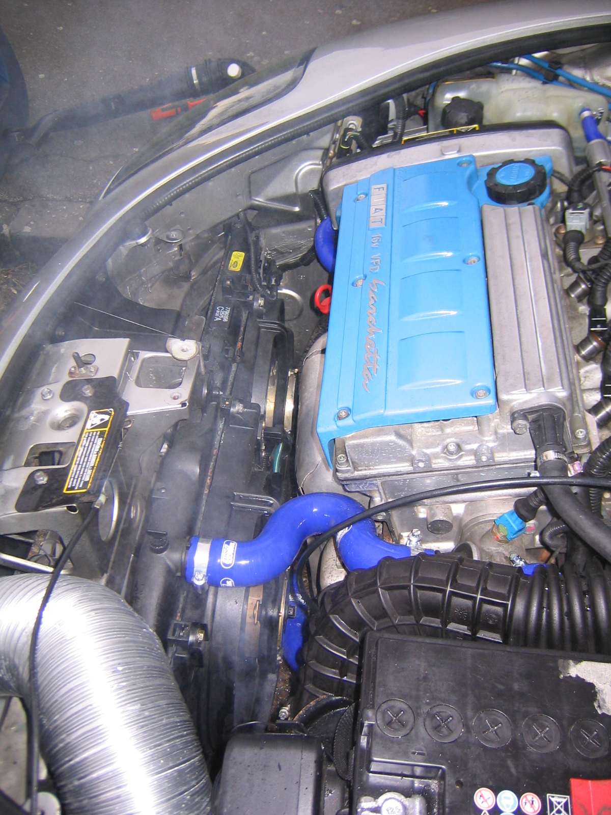

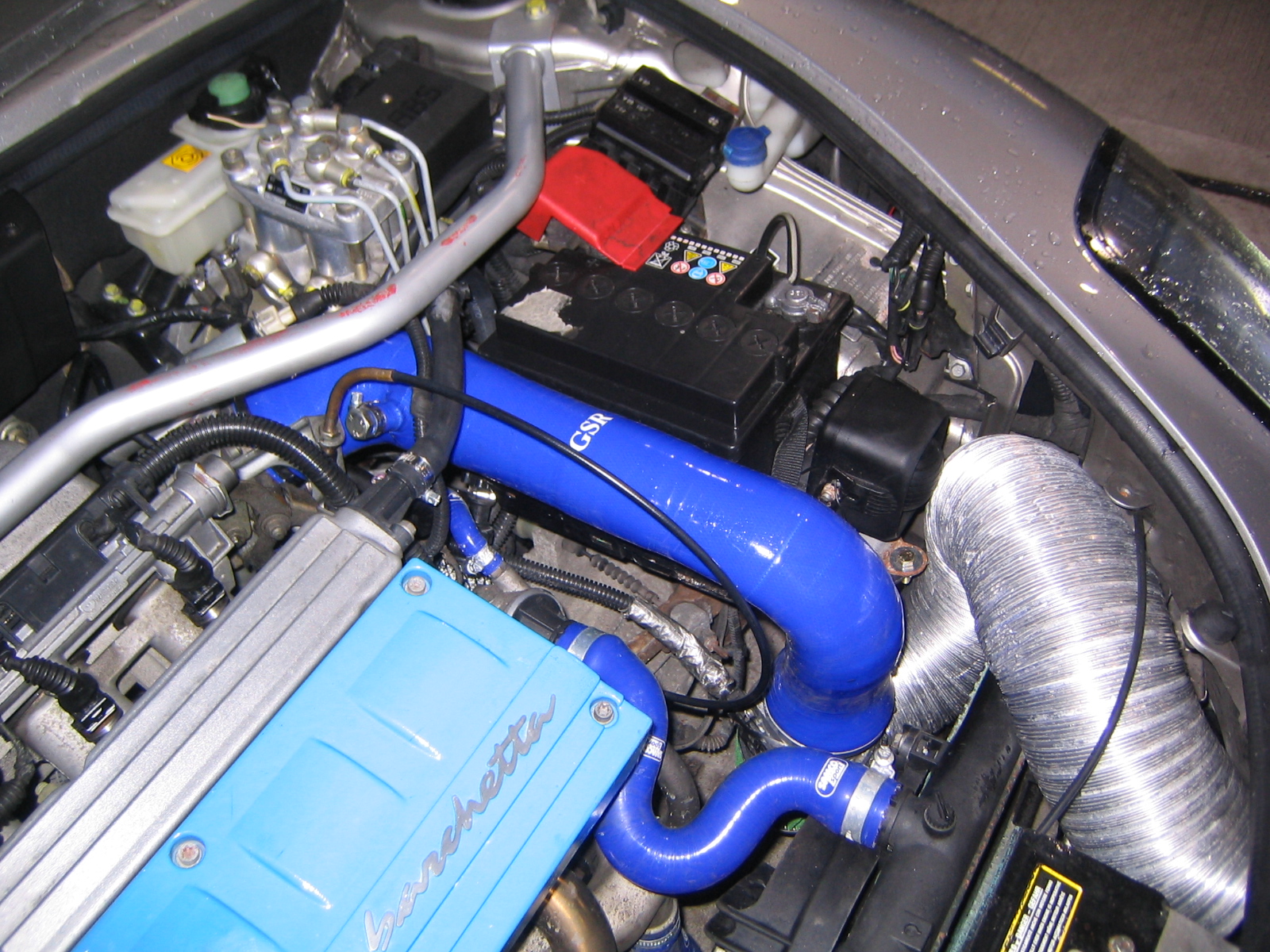

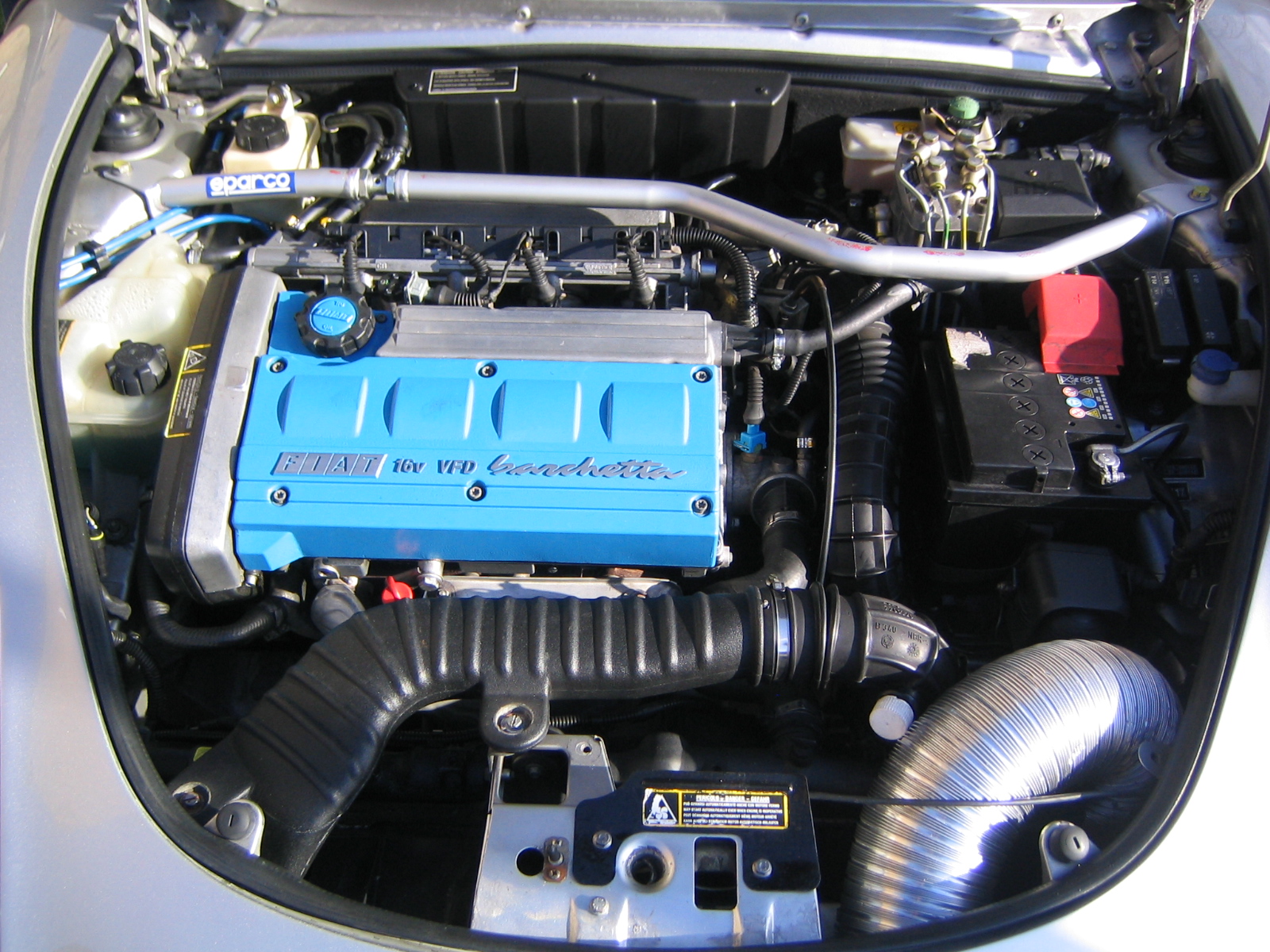

I managed to pick up the new GSR induction hose today from Peter
(old School) and have fitted it on the B(y)
I have still kept my green filter and is positioned in near enough the same position as before.
Havent had the chance for a real good spin yet. , but i might say there seems to be a little bit better response. Mid range torque is much better but not sure what exactly has made the difference, new exhaust or induction.
Guess both must help. :D
A rolling road will confirm but so far so good.
Some before and after pics:

Hi! Doc,
Yes, i will need to do something about that and paint the strut brace at the same time.
One thing, re getting a new rad. Do you think i should just get a new OMP or would it be best to have one made, Hence clearance issues of fans and cosmetic reasons too.
Think i will be ordering the supersprint rear silencer too, unless you know of something better.
Hi m8
I would love to have a rad made as I would have it only on the battery side of the engine bay so that it makes space for an intercooler and turbo later on. The rad would have to be thicker to help cool being that it would then be only half the size of the OEM rad.
An OEM rad is £140 but a one off rad would be more like £250 plus extra samco hoses and fan.
A Supersprint rear silencer would be cool but first would be the sports CAT if I was you.
The GSR kit looks good and fits in well with your samco set.
