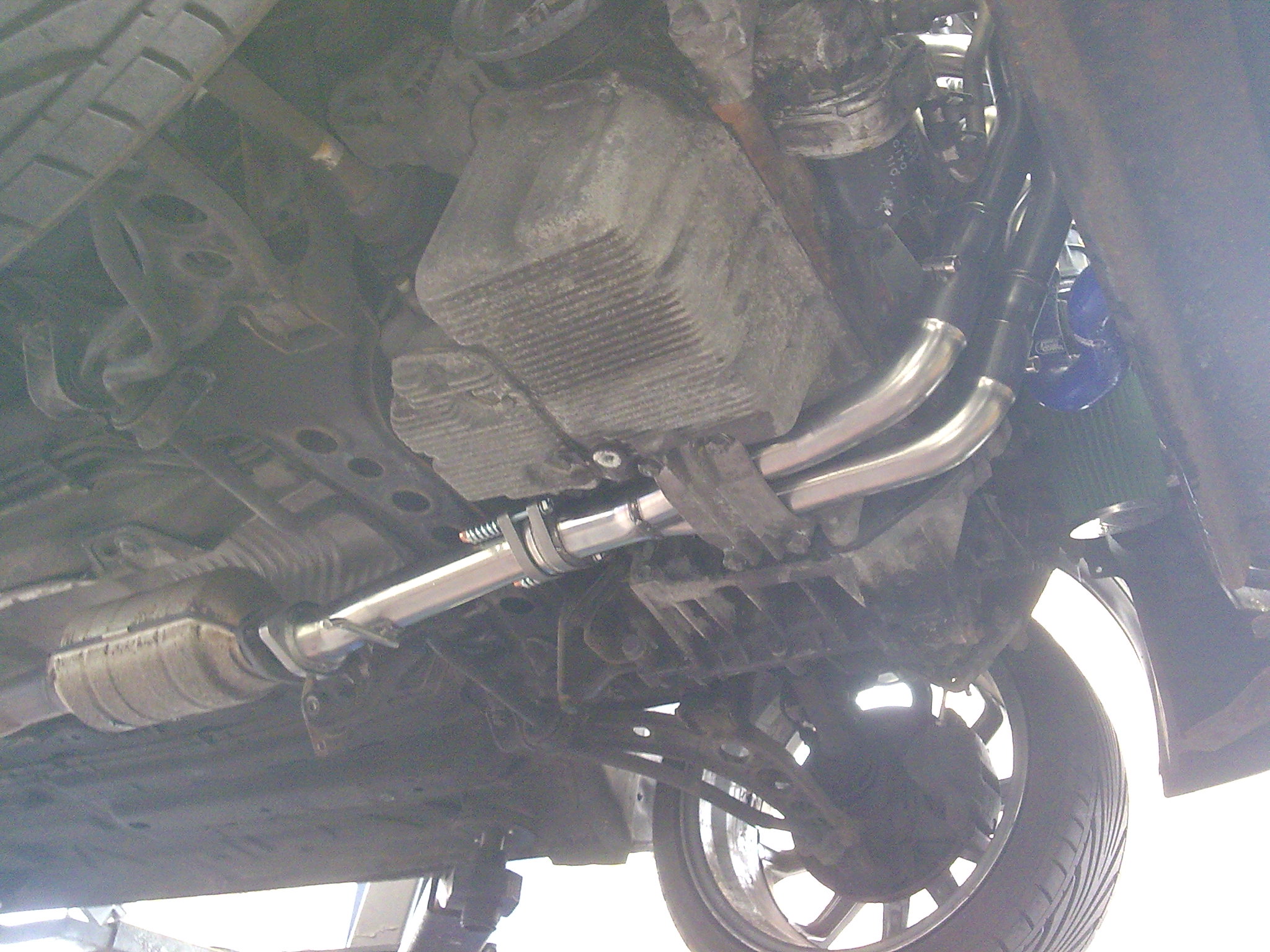

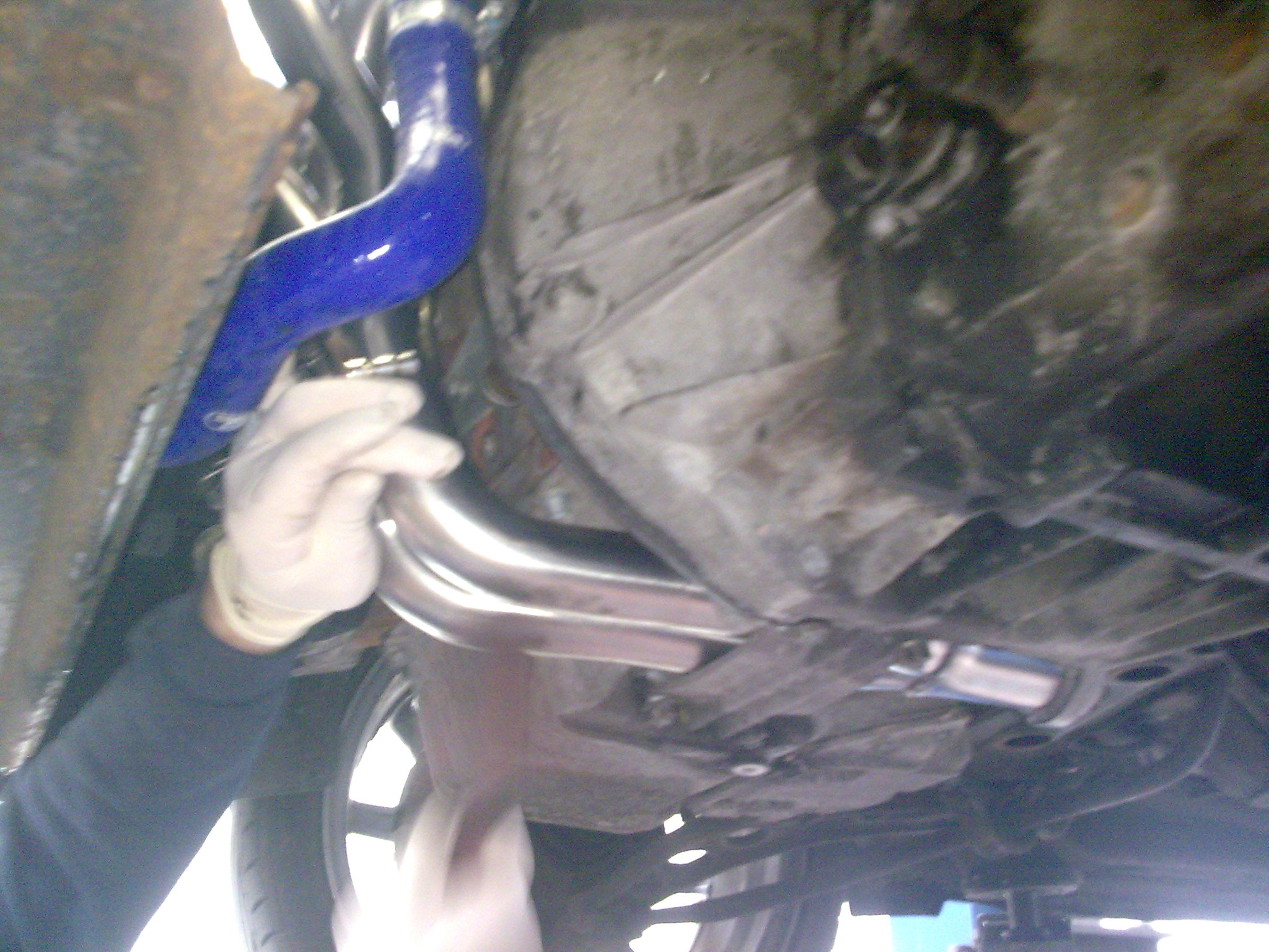

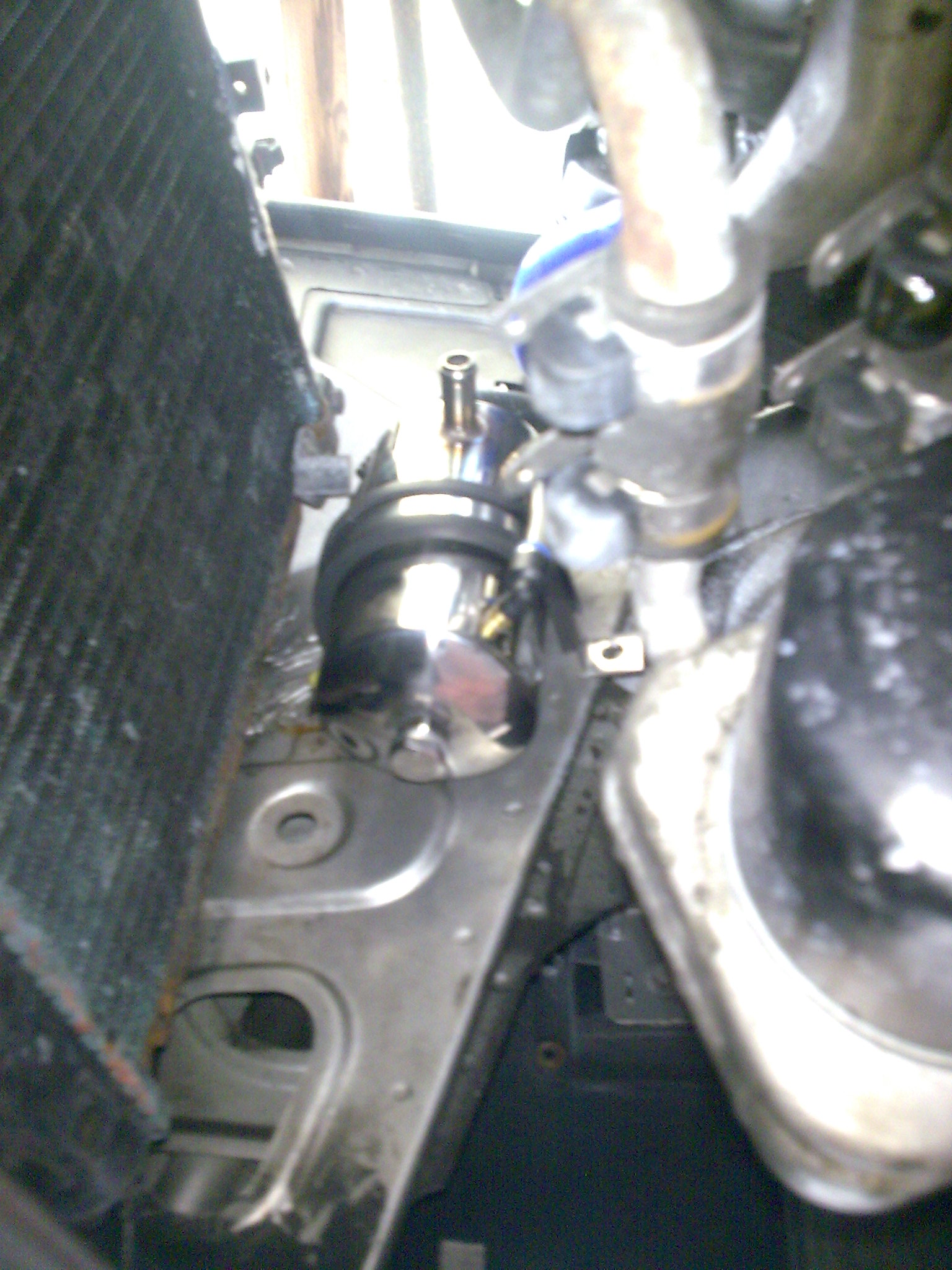

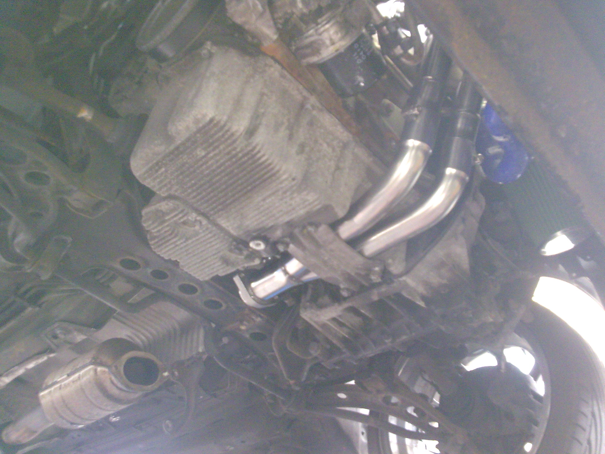

:) Here's a few pics of the new manifold from under the car. and a pic of the new oil catch tank and where it will be sited.
I will get some better ones from the top soon and post them up as soon as i can. VA VA VROOOOM!! :D:D
