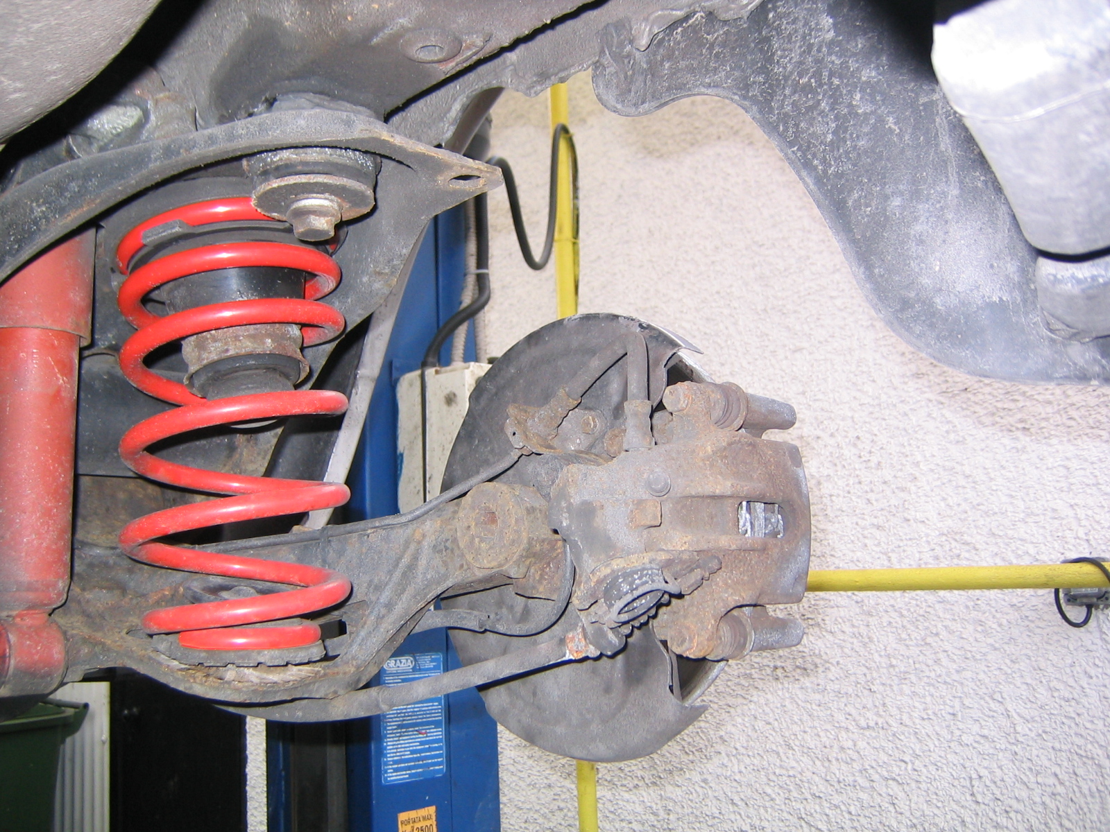

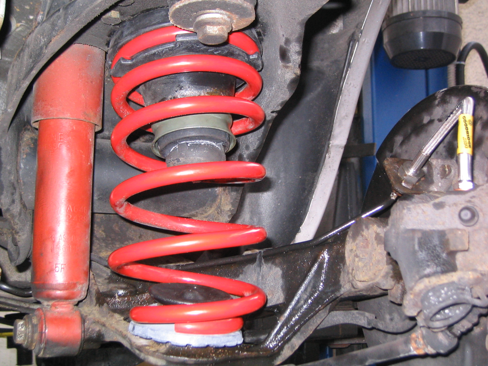

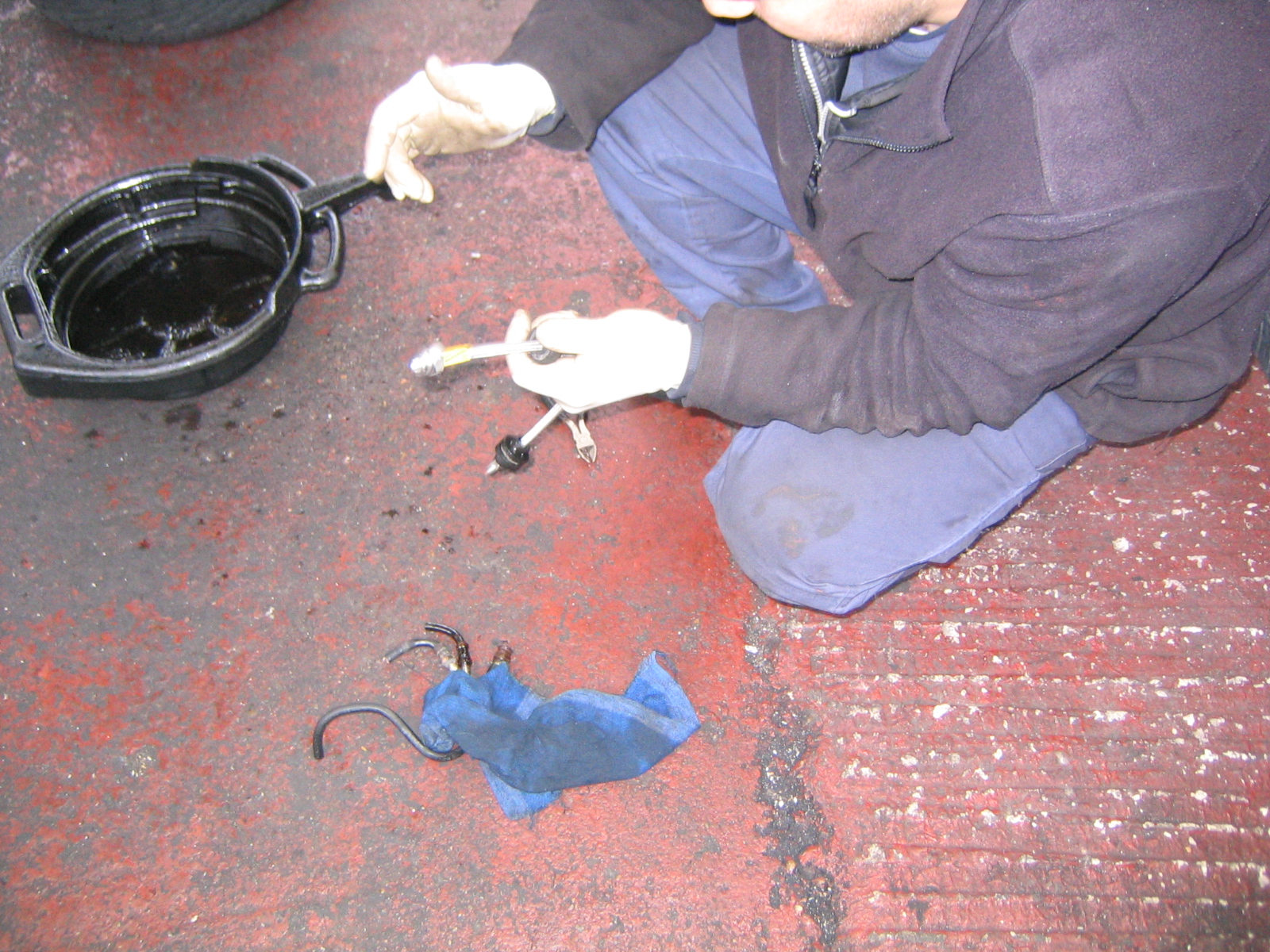

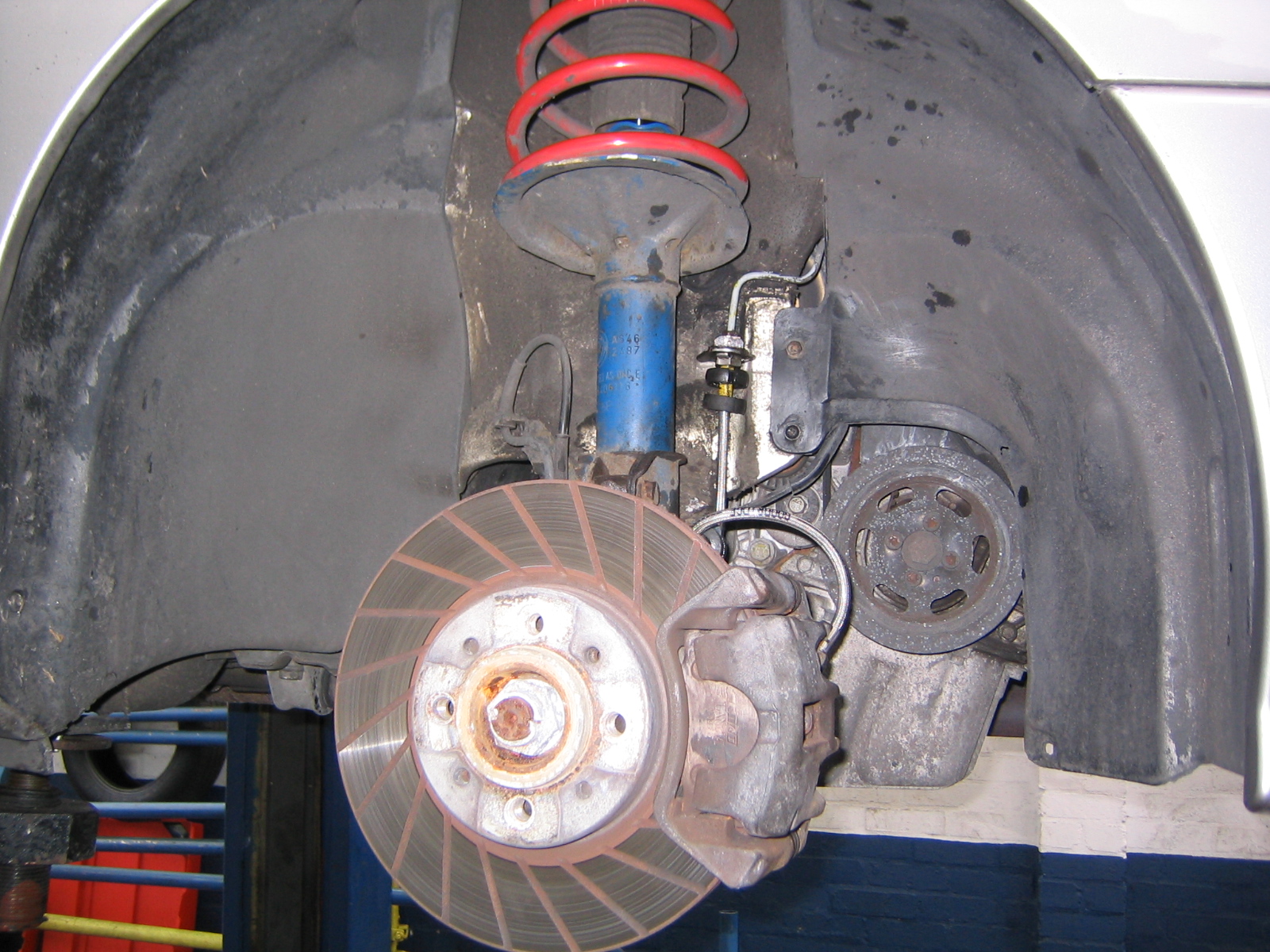

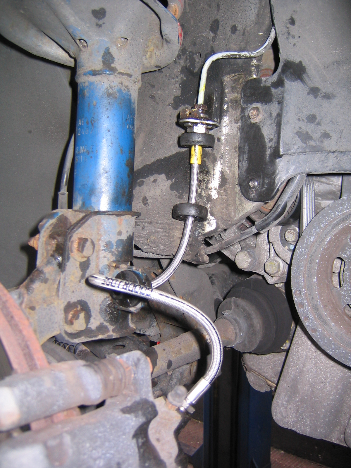

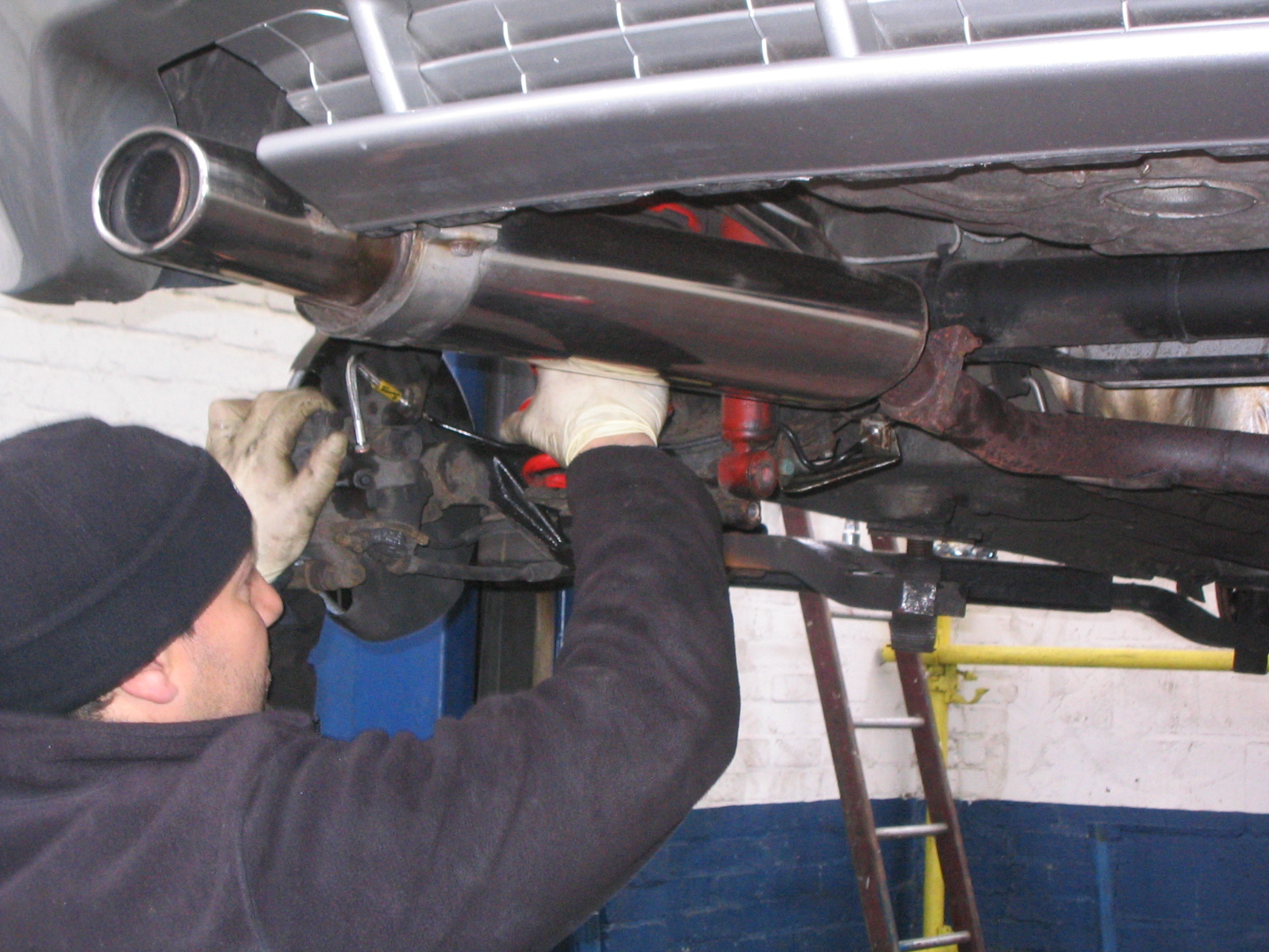

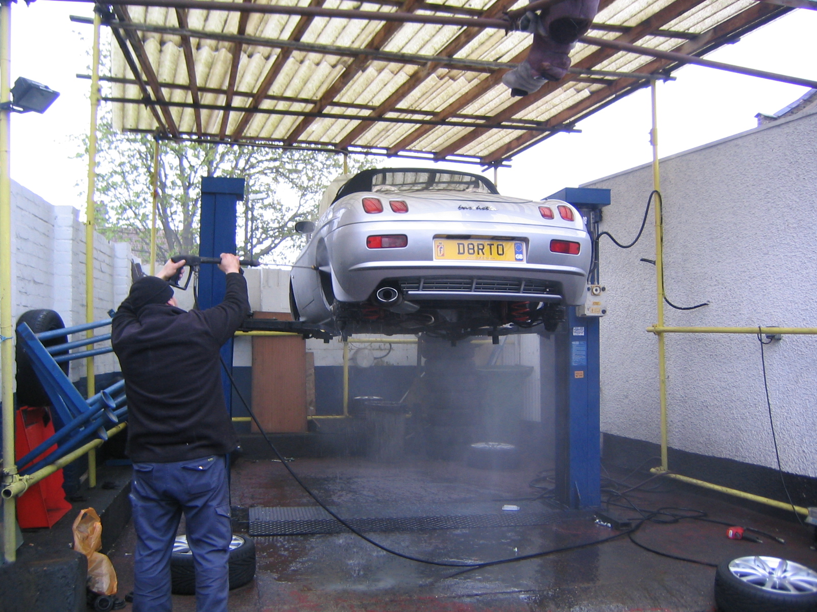

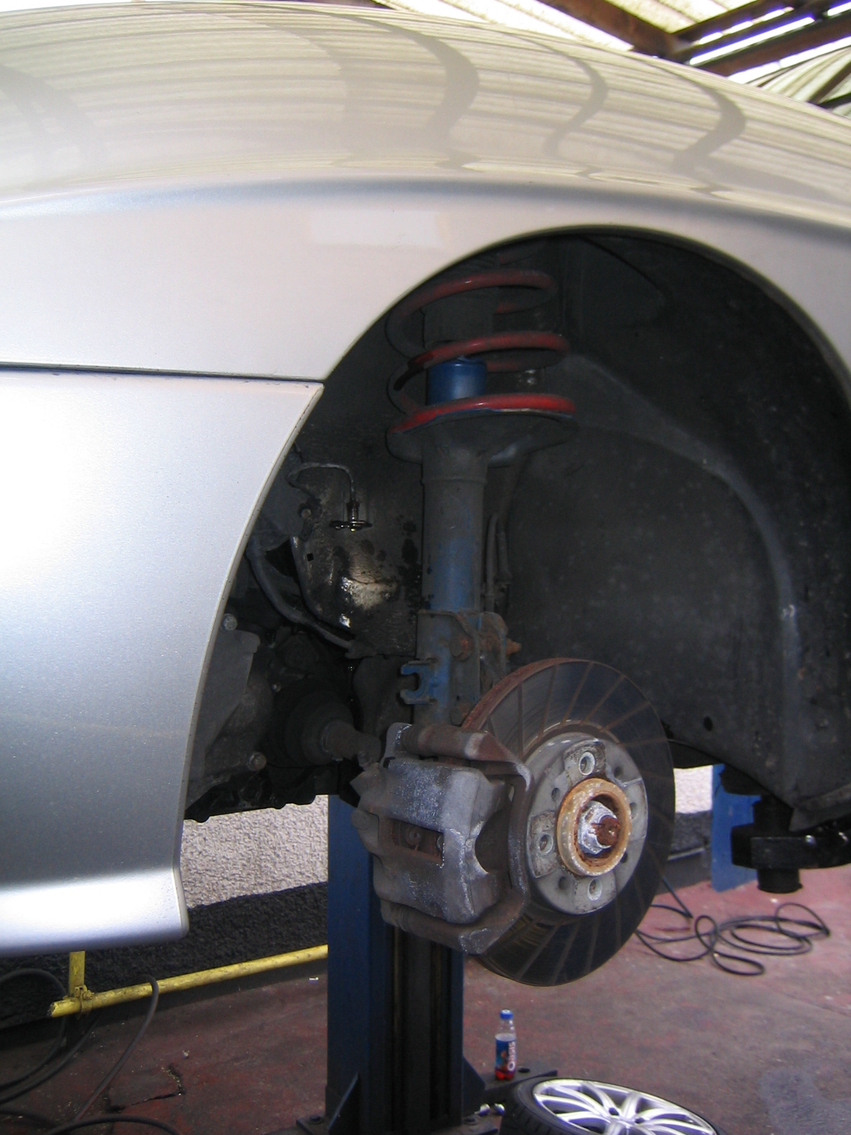

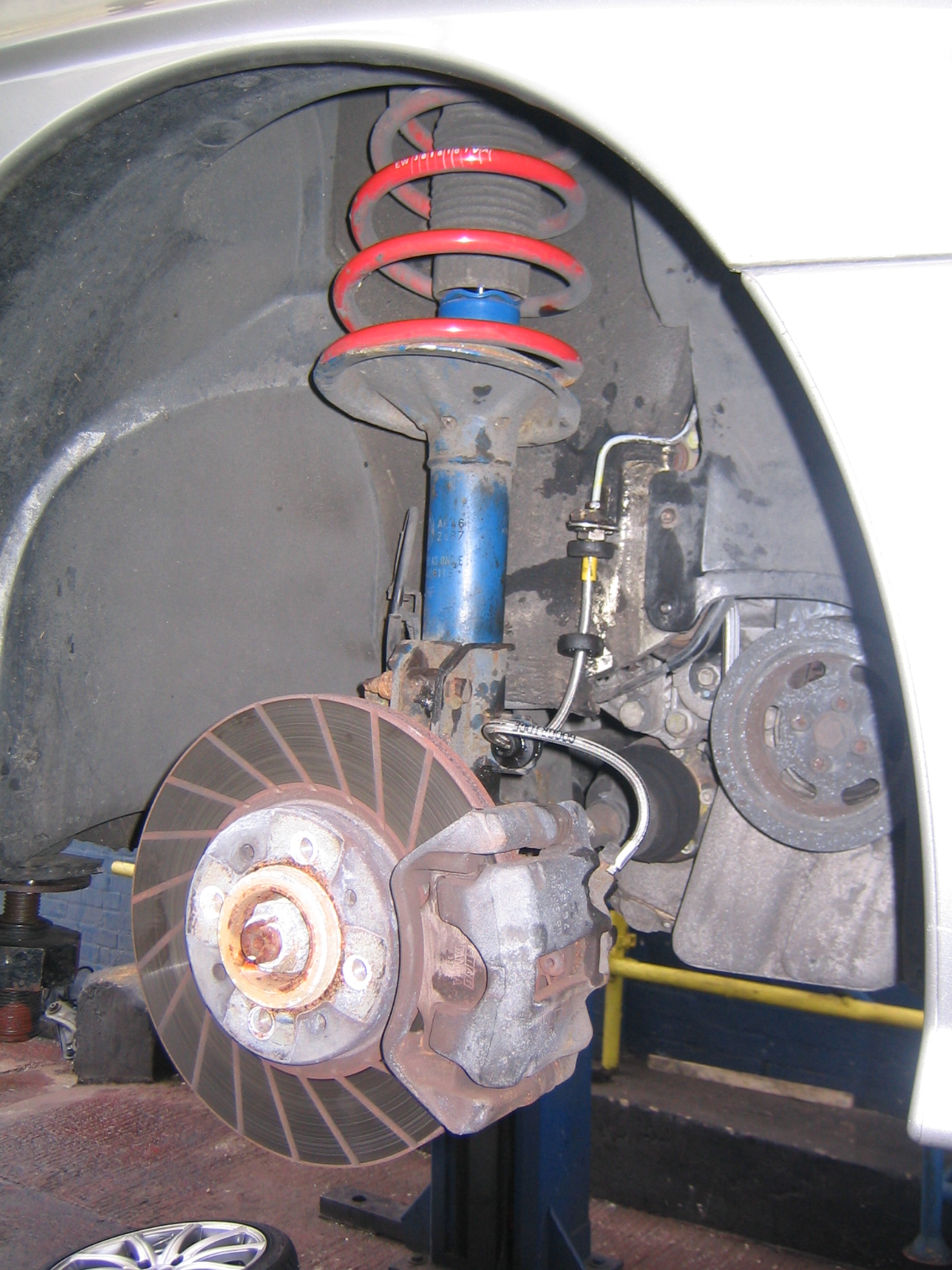

:) Been a busy B today. :D

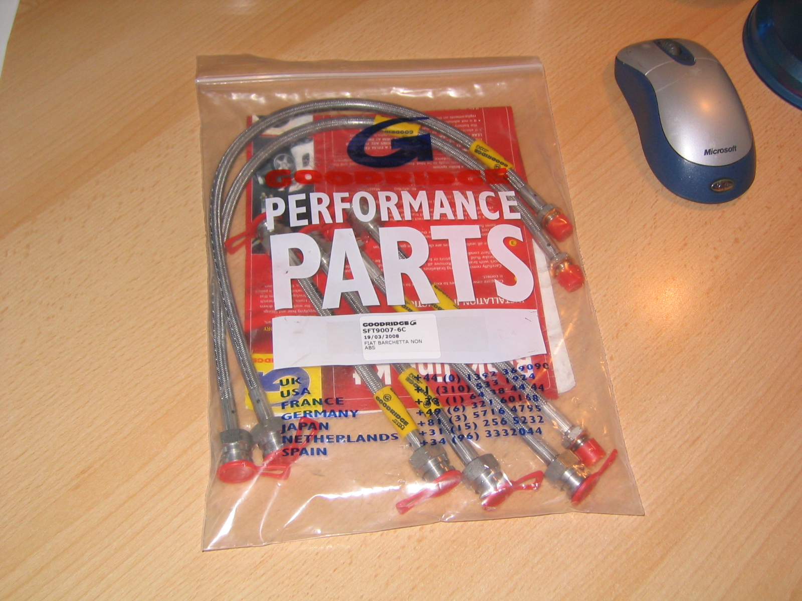

Got her down to my mates garage and fitted the new goodridge stainless steel brake hoses.
We removed the old rubber hoses which just screw off with the correct spanner.
Replaced with new hoses and a good bleed and refit with new DOT 5.1 high performance brake fluid.
An easy enough mod to do, once up on a ramp.
A little messy but a good jet wash afterwards sorts that out.
A few pics before and afterwards.

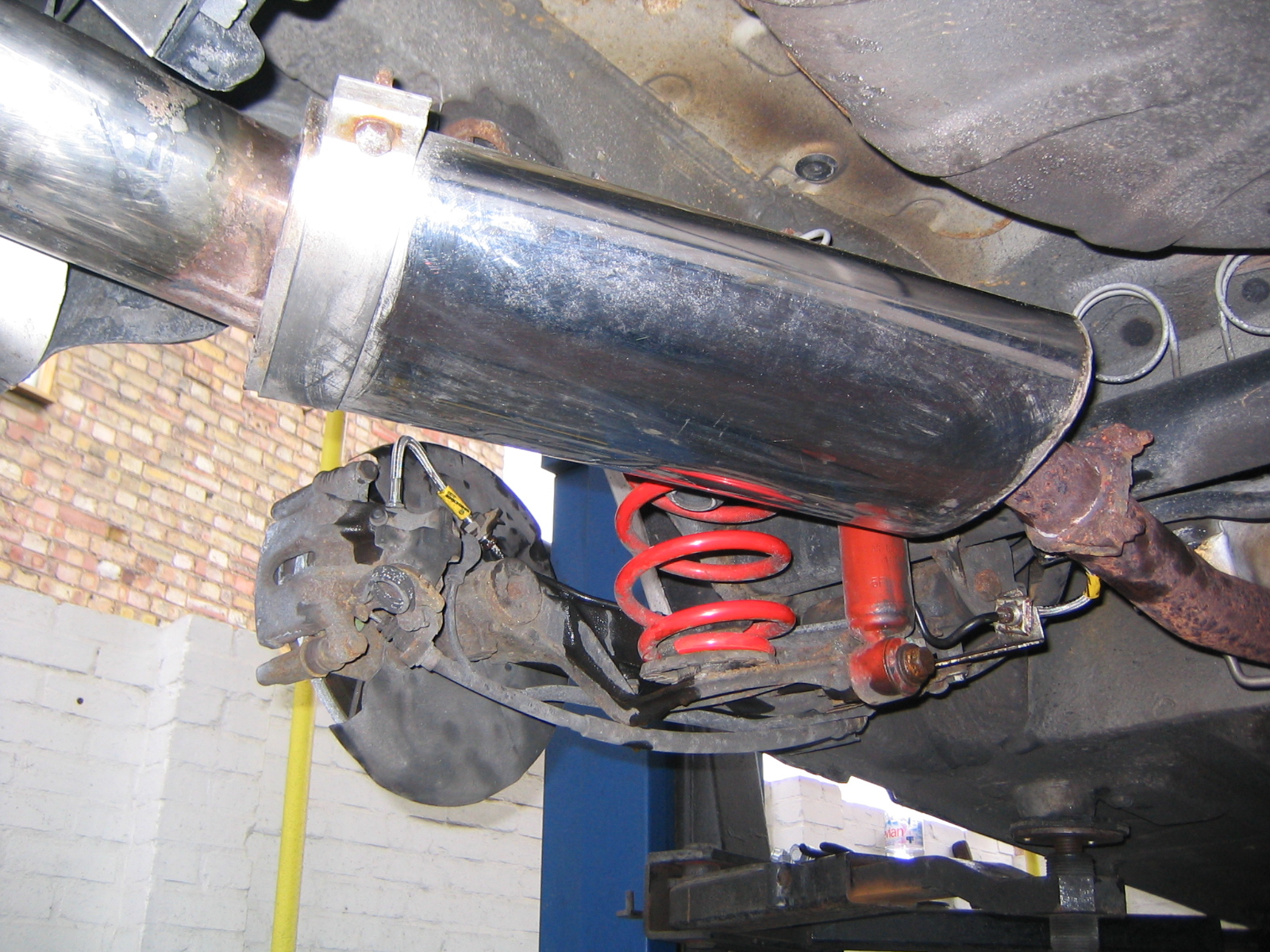

Some more pics of the new lines, and i also changed all the rear suspension rubber mounts and bump stops.
These i purchased a long time ago, just never got round to fitting them when i first fitted the suspension springs as i was waiting for additional rubbers to come.

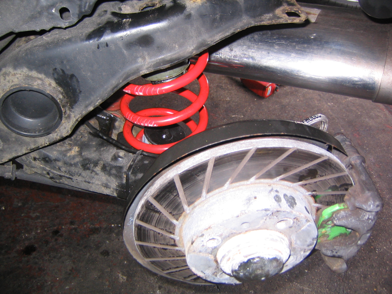

Pics of new rear lines and bump stops and a good jet wash to finish. (y)
