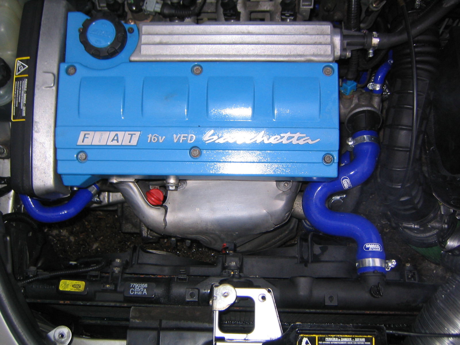

Found the picture! It was easy to fit and no hammering needed :D

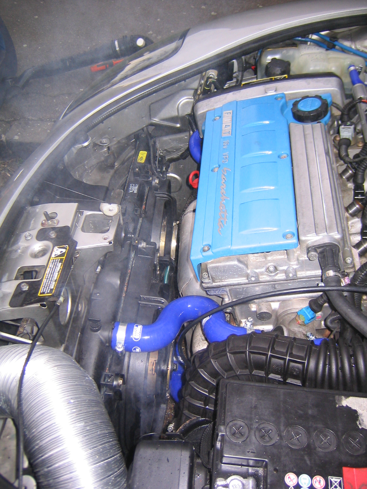

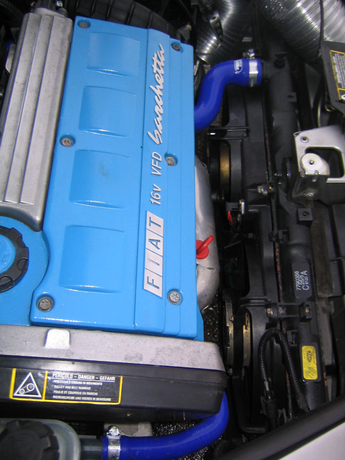

Fitted the dual fans in today. Not a difficult mod but not without its problems.
Firstly removing the existing fan consists of 4 10mm bolts, two on top and two at the bottom.
One of them was rusty and of course, sheared off on me.
There's a wirring loom that just unplugs so off comes the fan.
The dual fans come with a different loom plug as they have a slow and fast speed, but I cut this off and bi wired both fans so as to kick in together and then used the old loom connector.
Fitting the dual fans is a little more tricky. You will need to undo the top rad hoses as to slide the new fans into place.
It fits as did the orriginal fan but with the addition of three more 10mm bolts.
Refit the top hose, top up water levels and thats it. :D
