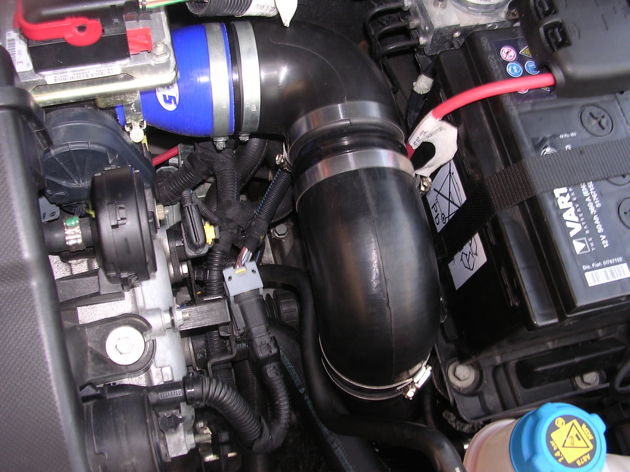

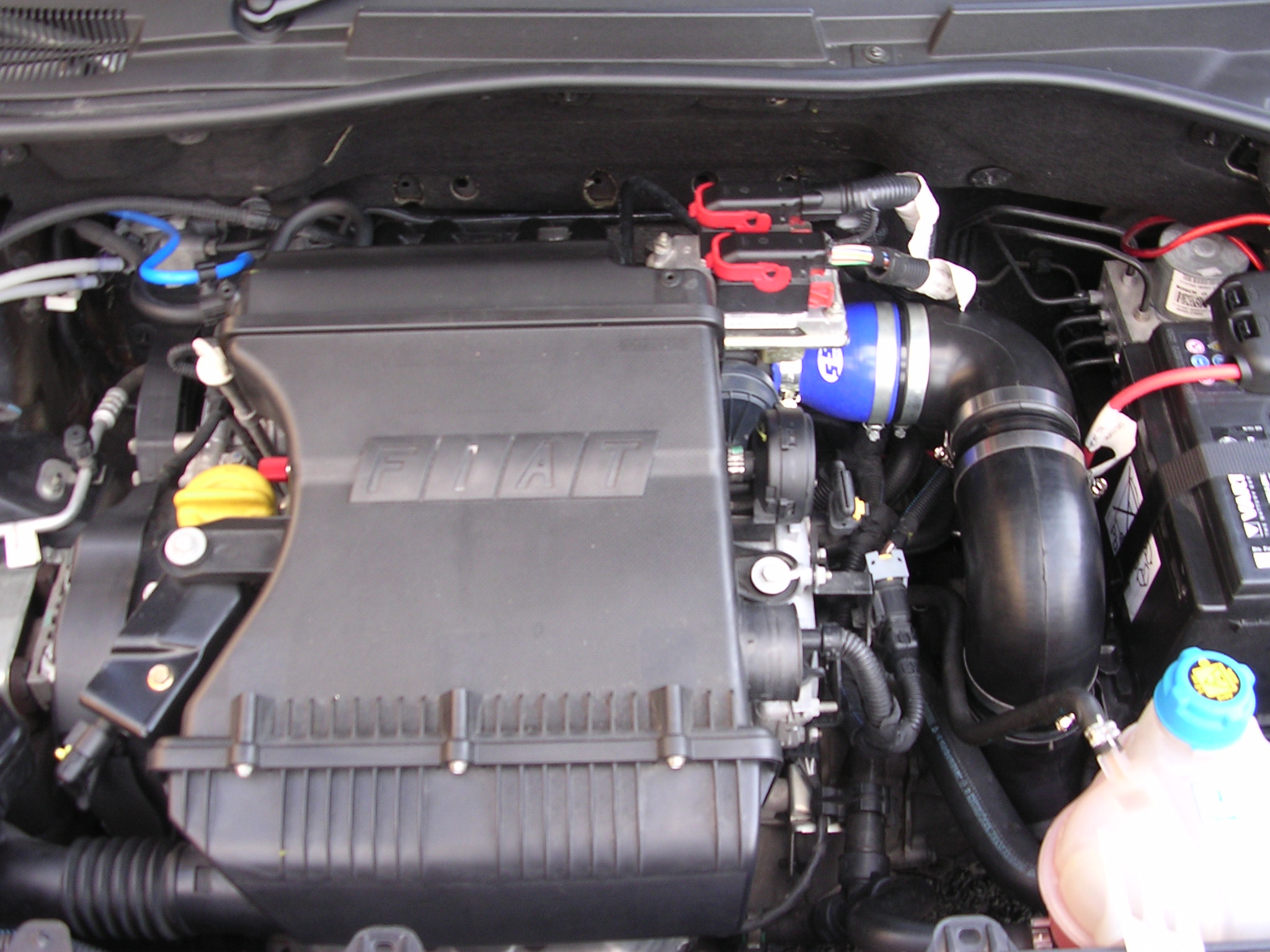

Here We Are. Having Problems Though!!
I GOT IT FROM A1 MOTORSTORE. BECAUSE THERES NO KIT OUT FOR THE 1.4 16V YET, I HAVE HAD TO USE PARTS FOR DIFFERENT CARS ( CRX/CIVIC ETC). A1 MOTORS WERE VERY HELPFULL. YOUR BIGGEST PROBLEM WITH IT, IS GETTING A HOSE TO FIT THE ENGINE. ITS SMALL AT 32MM. I USED A REDUCER FOR A HONDA COOLING SYSTEM MADE BY SCS PERFORMANCE (BLUE PART) WHICH WASN'T CHEAP AT £27, BUT ITS SILICONE ALLOWING IT TO FLEX AND NOT DIS-SHAPE WITH HEAT. I SURPOSE U COULD JUST USE A SEIRES OF 90' BENTS AND RUBBER PIPE. THE SYSTEM COST ME 80 NOTES, NOT INCLUDING THE FILTER.:whogives:

halford?? u would do better goin to asda. there a waste of time and don't know what there onabout. i first thought about using a flexi rubber hose but it don't look as good. also the inside ant smooth. the best way of doin it think, is to use universal silicone cooling system hose. u can get them in all shapes and sizes. i spent weeks looking for a air induction with a 32mm hoses. there like rocking horse sh it. the problem is slicone hose isn't cheap. BIG TILL
i was bidding on a new silicone hose on ebay yesterday for £10 for a metre and someone got in at the last second as always!! so still looking for a new one! but i think they are about 20-25 for a metre which i think is needed, nt sure if half a metre would be long enough would it?
probably but get a meter to be safe.
half metre will get u to the radiator. u don't want it there mate. trust me. its not good. didn't think of looking on ebay.:cry:
