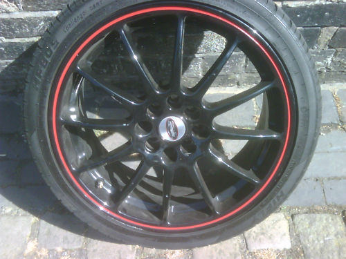

Go pick these up on wednesday :) wooop!! what we reckon?

Compare the rolling circumference with the old wheels/tyres. If 17s are much longer than standard the car will be over-geared = slower acceleration, use more petrol and stress the gearbox.
Paint the brakes black you wont want to advertise their tea plate size.
i know but its nothing MASSIVE is it if i decide to change my mind i can always re-sell these, but i think they will be alright as long as they look the part i aint bothered i dont drive like a nugget anyways so....:rolleyes:
There are websites that will tell you the relative rolling radius of the tyres. But the gearbox "sees"
the circumference - about 6-2/7 times as much so a small radius change can be quite a bit longer where it matters. Anything more than 5% bigger can start to cause problems. 10% is a long way towards the next gear.

Personally I think 17s dont suit the Punto. But I wasnt asked for my opinion on style
Which is why I was careful to point out the technical issues od large wheels with a non too tough gearbox. As for tea plate brake - its a fact - they stop the car adequately but they are small.
Ive had 17s on my car for nearly 2 years now and the box on my car used to drive 17s for years :) Ive had no problems apart from 2nd syncro being a bit weak. This is on a 6 speed box however, the 5 speeds dont seem to be as strong...
If I were you, a nice set of 16s suits these cars better :)
Some nutters out there put 18s on these cars... :bang:
18 = way to big - and it'll roll like a pig unless lowered + Diff stress
and the rubber will be so thin, it'll be pointless, might as well run on the rims
17" = Too big still, alot of stress on diff
16 = Tyre sizes aint as common, could find 16" cost more for tyres, then paying for a different size
15= FTW!
14 = if you are happy with stock wheels :)

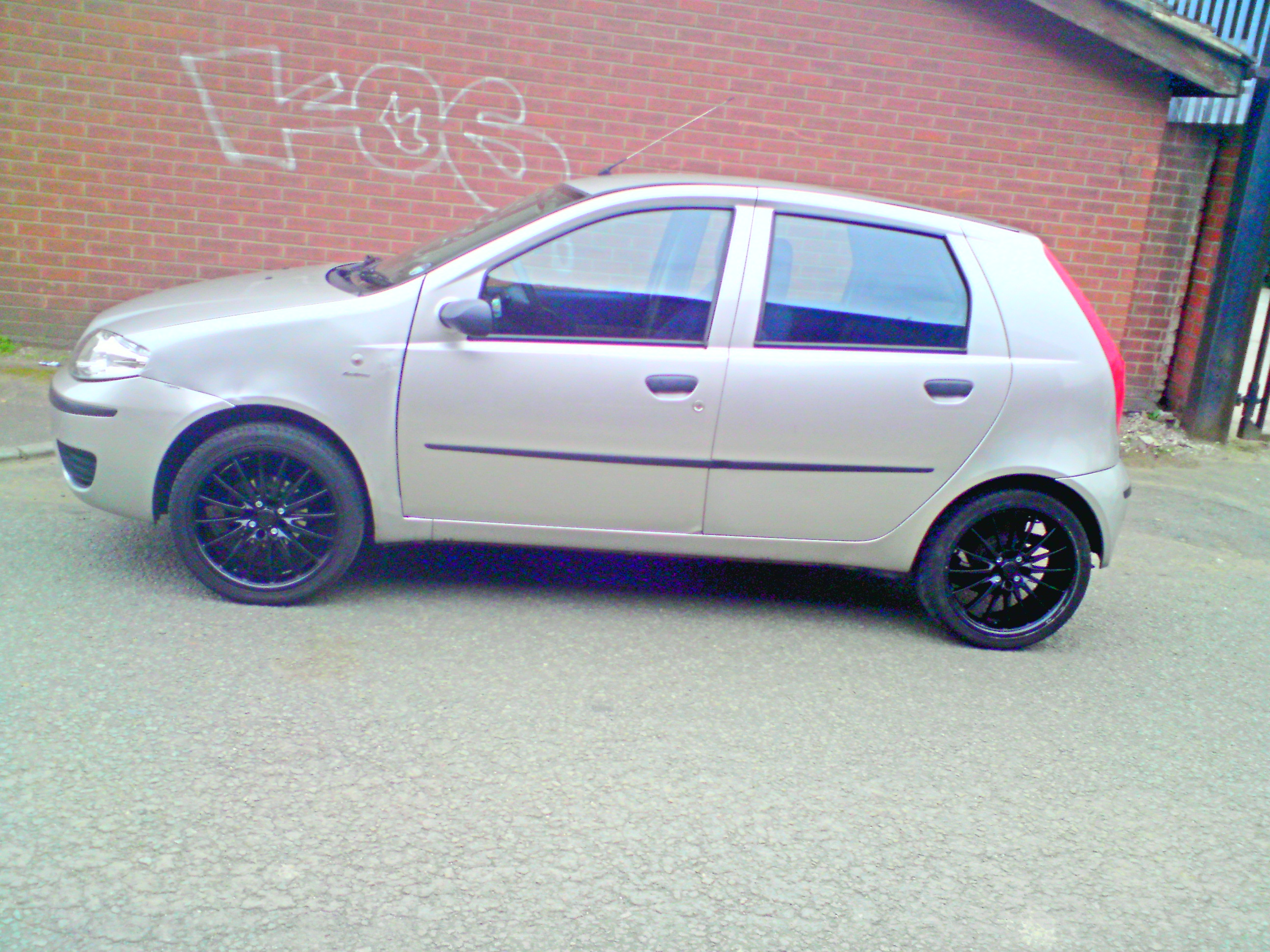

Here we are and let me say they are...... well nice (y)
