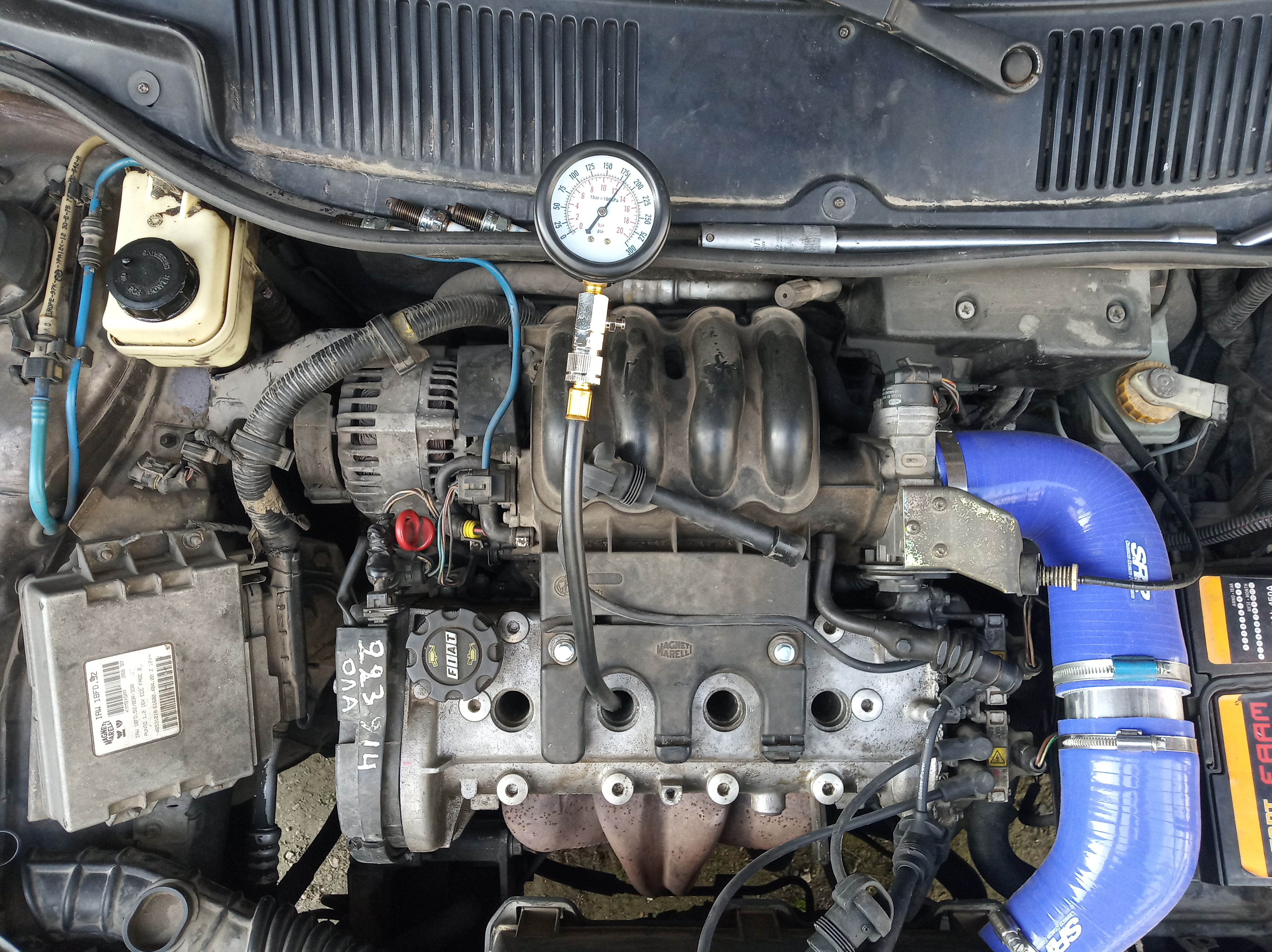

Sorry for the delayed answer,i just managed to get an update of the situation...
First of all thank you all for your help and interest with manuals and so,it has been a great help for info i'd never thought i get so easily.(y)(y)(y)
I made a compression check and there is an odd situation with the two cylinders,at first sight i would thought of a head gasket loosing compression but nearby cylinders don't match compression numbers...
So i suppose that the issue is from excessive wear probably from the piston rings.

From what i suspect,the proper compression of this engine is nowhere around 165-170 psi as i read somewhere but it is probably around 13/14 bar(200+ psi) as you mentioned before.
Of course the engine has never been rebuilted,it has almost 400.000 klm on the dials and the only service that was made was a head gasket replacement along with valve seals,ets aprox 100.000 klm ago...
The oil consumption is rather high with almost 1,5 liter per 5000klm with daily normal use.
So probably i will start rebuilding a second engine block that i got...
I also measured and two cylinder heads that i got,the one is 77,04mm and the other one is 77,45mm and i also noticed that there is quite a lot improvement to be made,not by port shaping but generally by port matching as the three items of the induction system have slight differences between them.

If you plan to keep the car, go for the rebuild. 400 tkm is a lot.
Very first thing you do in any Fire family engine is "piston soak" (kerosene/"lamp oil"), to free the rings (they tend to clog with sludge, burnt oil residue).
Numbers are acceptable (both 12 and 14 bar)...if they were equal (so try to make them closer).
Thats exactly what my mate(mechanic) said,that oil consumption might be from stuck oil rings but if it was from such a thing,would this effect the compression test?
