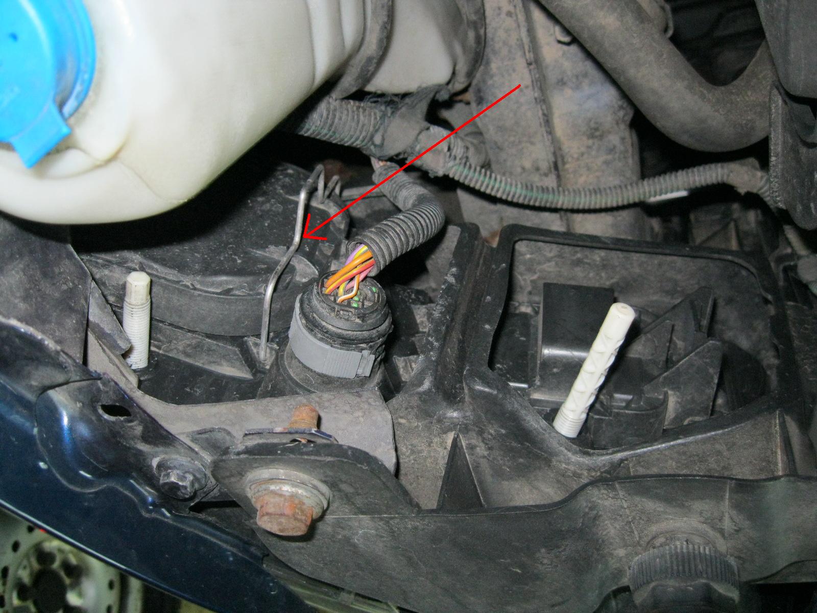

unbolted the top of the washer bottle and tipped it back, disconnected the connector plug, got the cover half off... so I could see the motor. But there's no way on this planet that I could get anywhere near it to take it out, or even see the connectors!

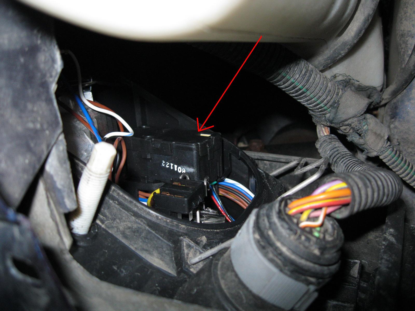

Well a good idea would be to test if the beam pattern moves with the adjustment switch. If it does, then it can't be the motors in the headlamps.
I'm sorry I'm a little late, but here's some pictures of the headlamp. You know what you need to do now, but I am posing them for future reference.

The beam adjusters work fine, I can see them going up and down whilst rdriving down an unlit road.
