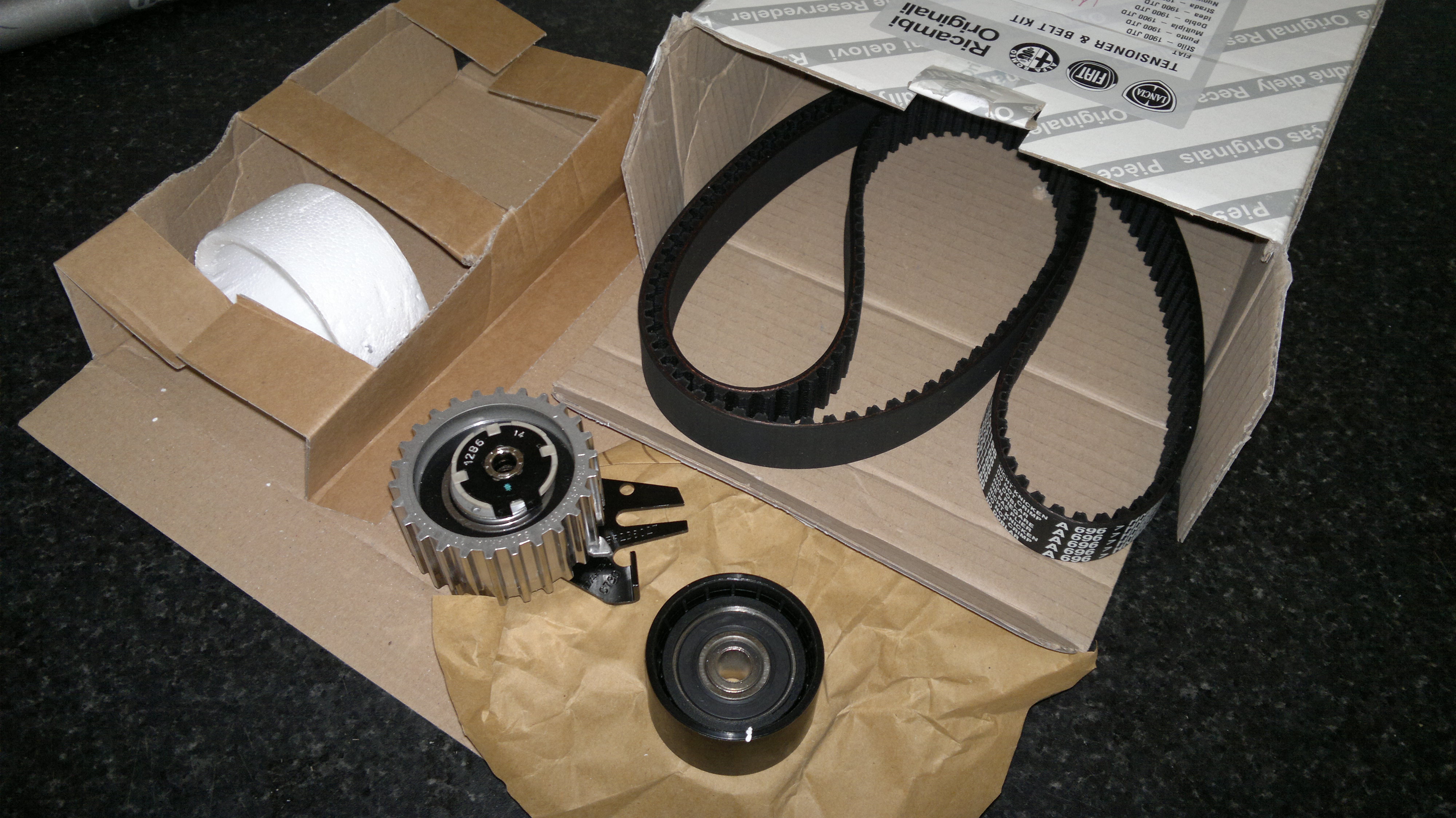

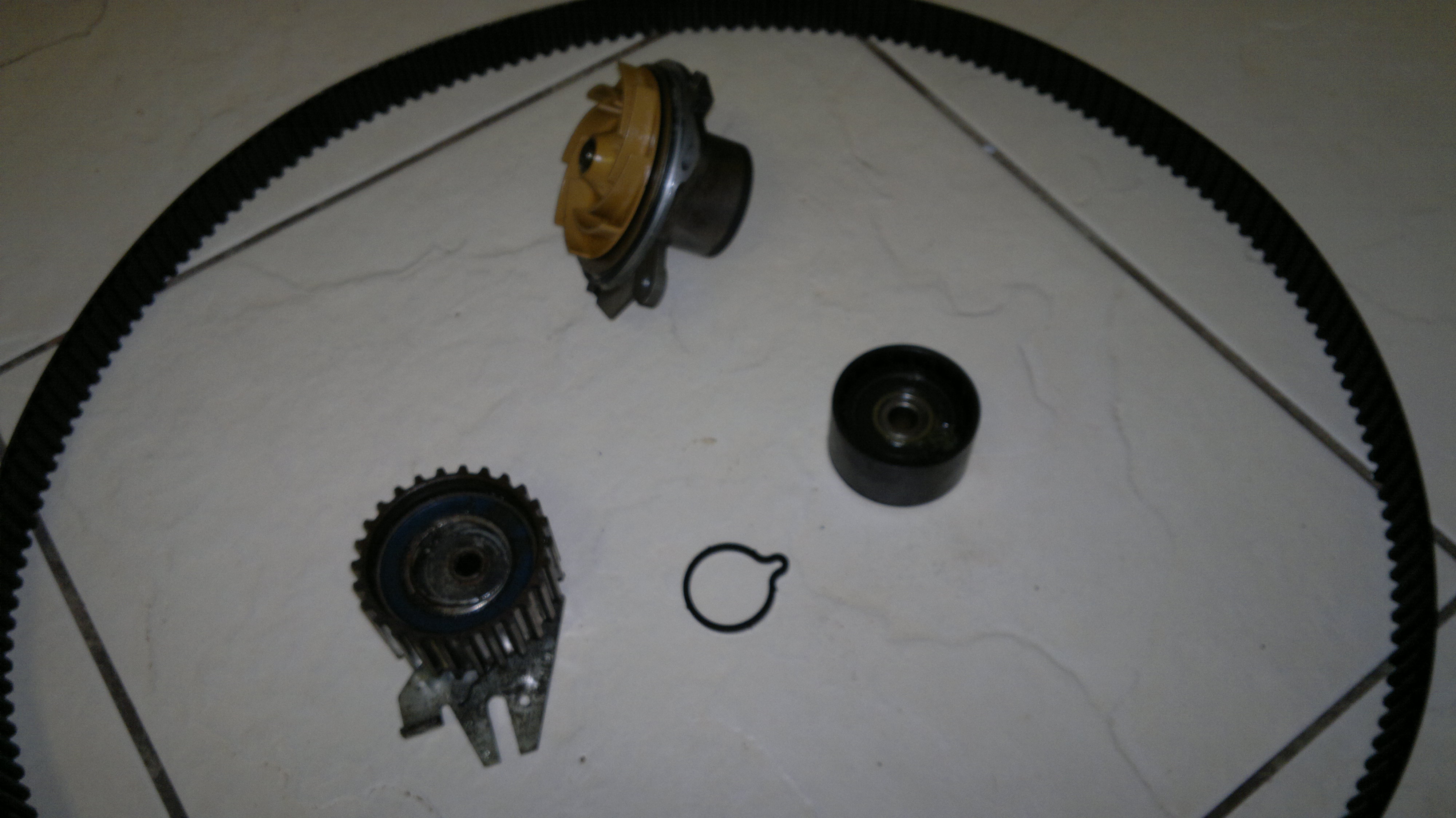

Well I'm a bit gobsmacked, the cambelt kit just arrived too. 3 different suppliers, 3 different couriers and everything arrived the same day.
Is the cambelt still made by Dayco or is it a Contitech belt?

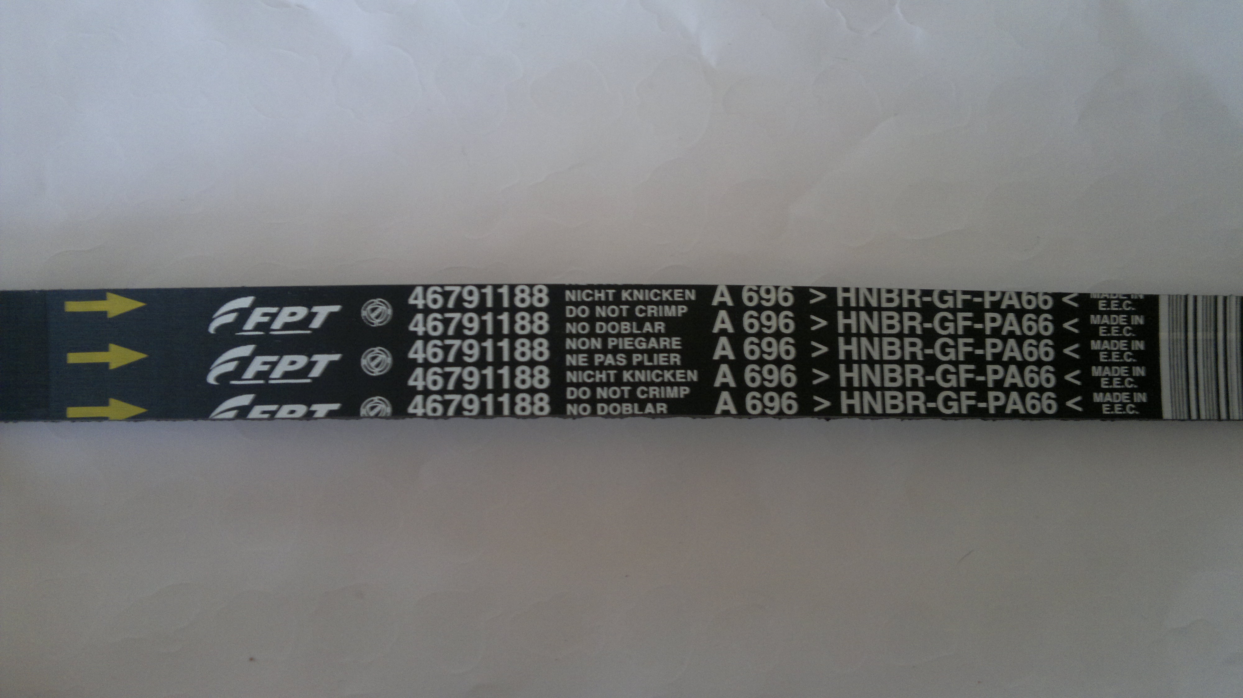

Fenner Power Transmission is the manufacturer of the belt. Never heard of them.
Also, the part number on the belt looks like a Fiat part number, but it's not in ePER. Get your friend to check it before fitting it.

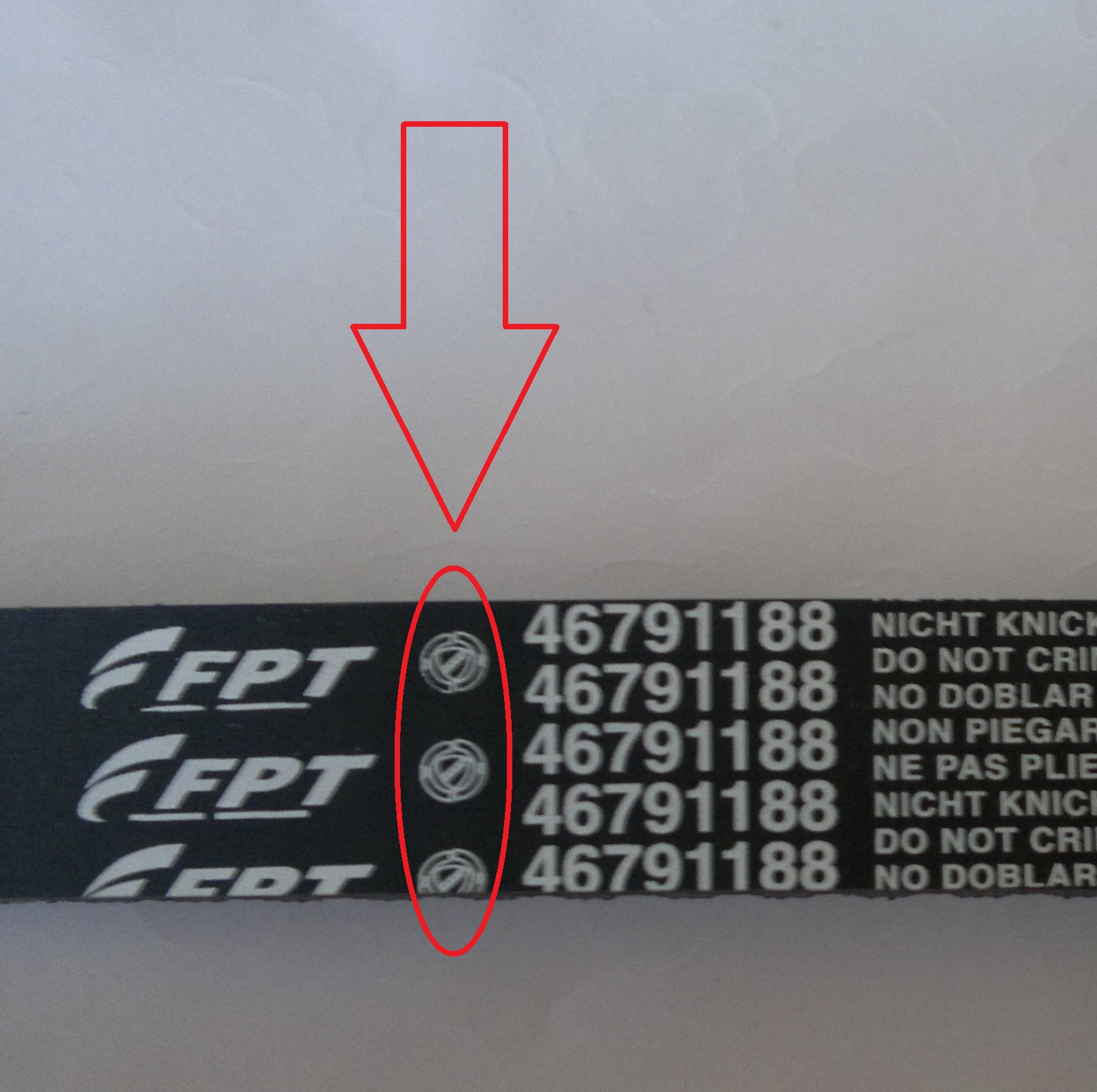

This is a photo of the writing on the belt, just shows the Fiat parts emblem, no other manufacturer name.
I suspect alexGS is correct and they are Fiat because the same emblem found on the Stilo's rear bushes is also found on this belt.

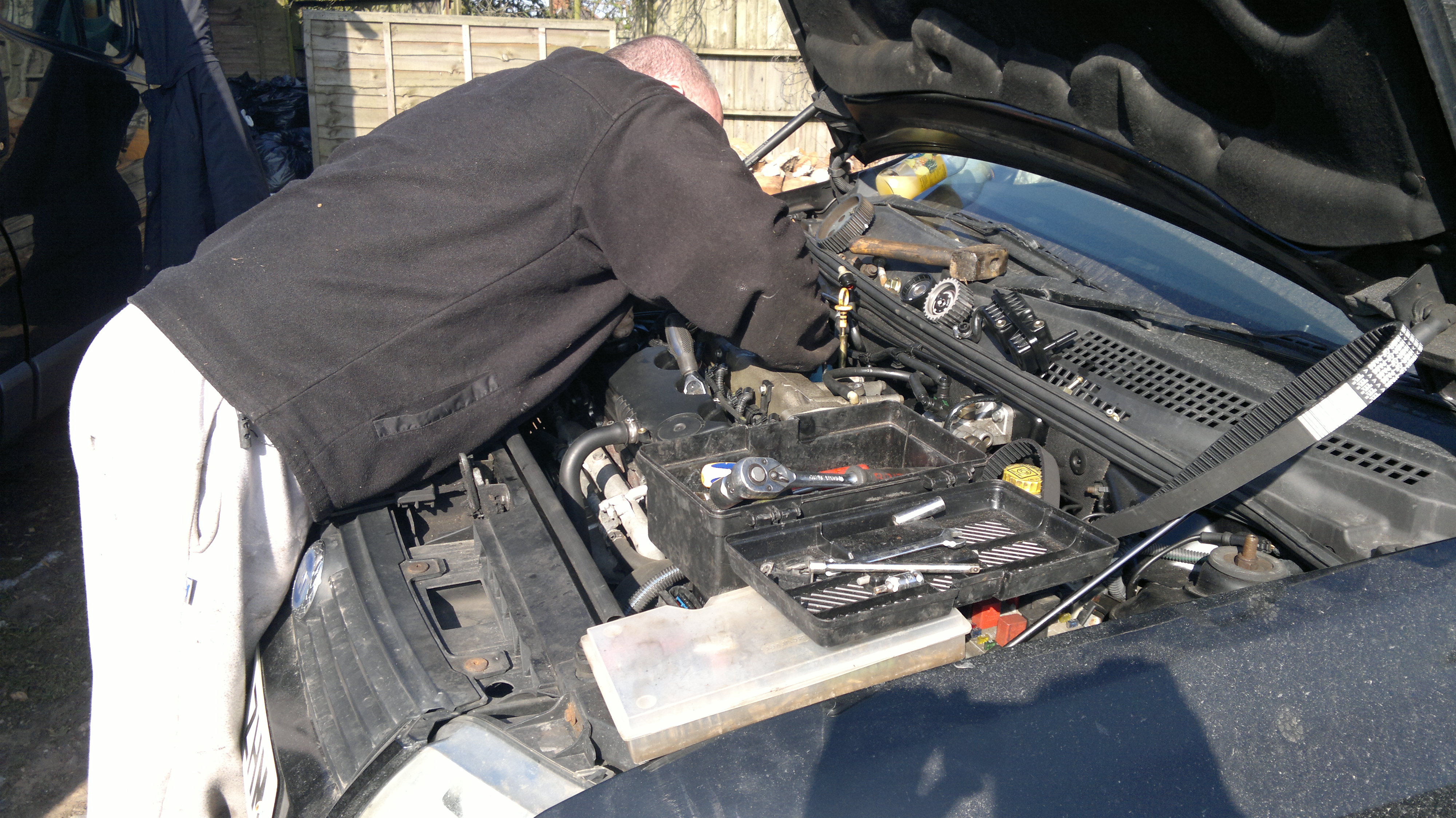

And the club hammer was for...............
