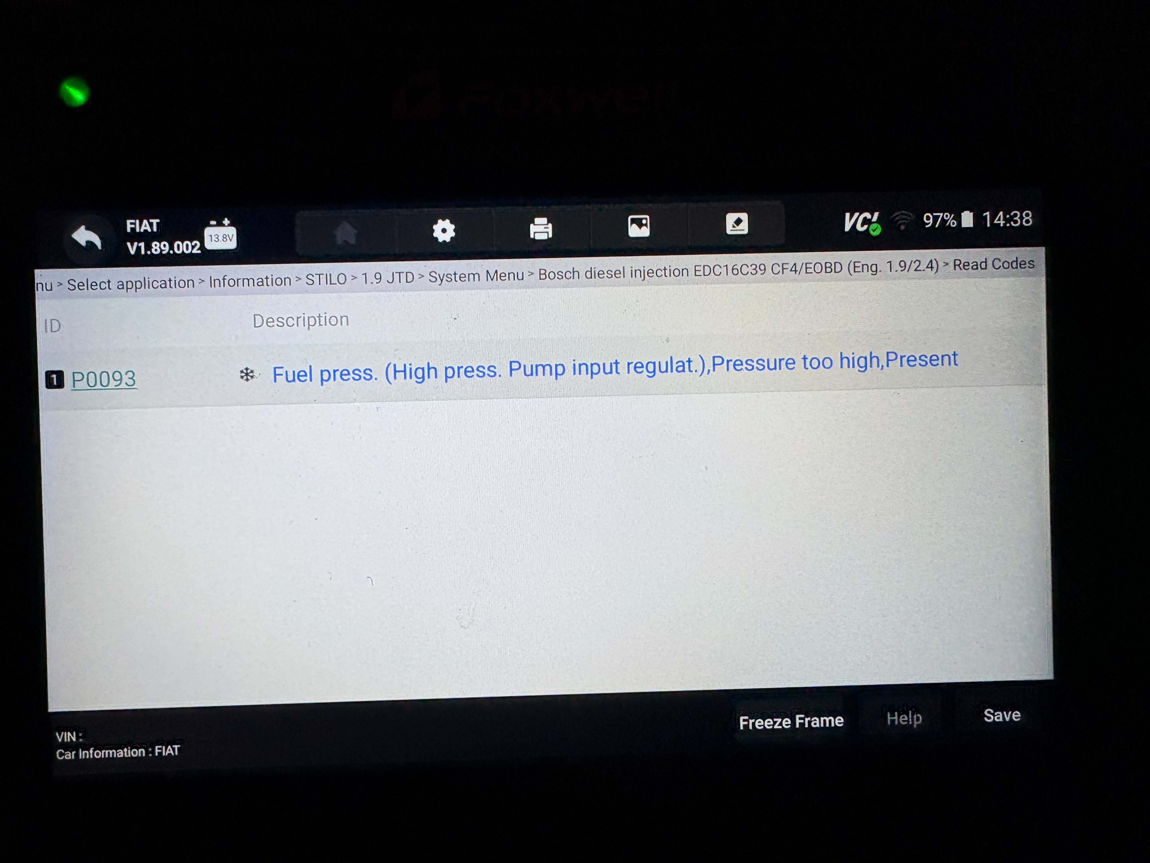

3) Installed new fuse relay today. All was well, car ran flawlessly, for about 50 minutes. Sitting at a red light, I suddenly get a check engine light. Soon after that, the fuel gauge randomly started dropping to zero and back again.
Well, see for yourself:
I think it's the fuel pumps fault... The pressure hold perfect while under revs, but doesn't drop at all at idle. I get check engine light immediately after startup now.

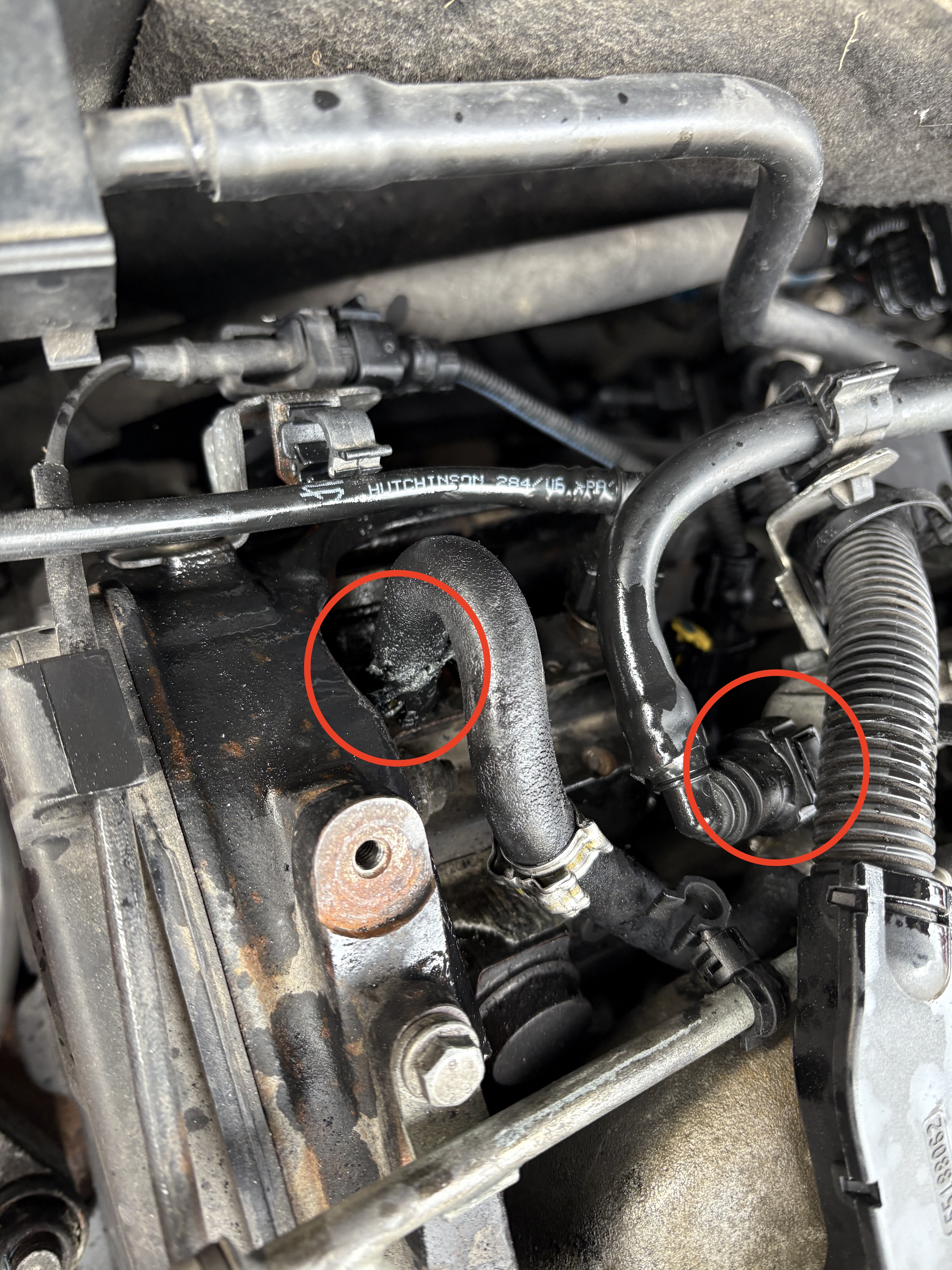

Today, I also removed the rubber hose that goes from the high pressure pump to the fuel return manifold and the return hose (that goes from the fuel return manifold back to the fuel tank) and blew in it, so I verified there are no blockages.
I also, again, removed the return hose at the fuel tank and as soon as I switch the ignition, fuel flows though it without any problem, and lots of it. Since I verified the return pipe from the HP pump to the return manifold, and I also get fuel at the return pipe at the fuel tank, I'm kind of ruling out blockages?
