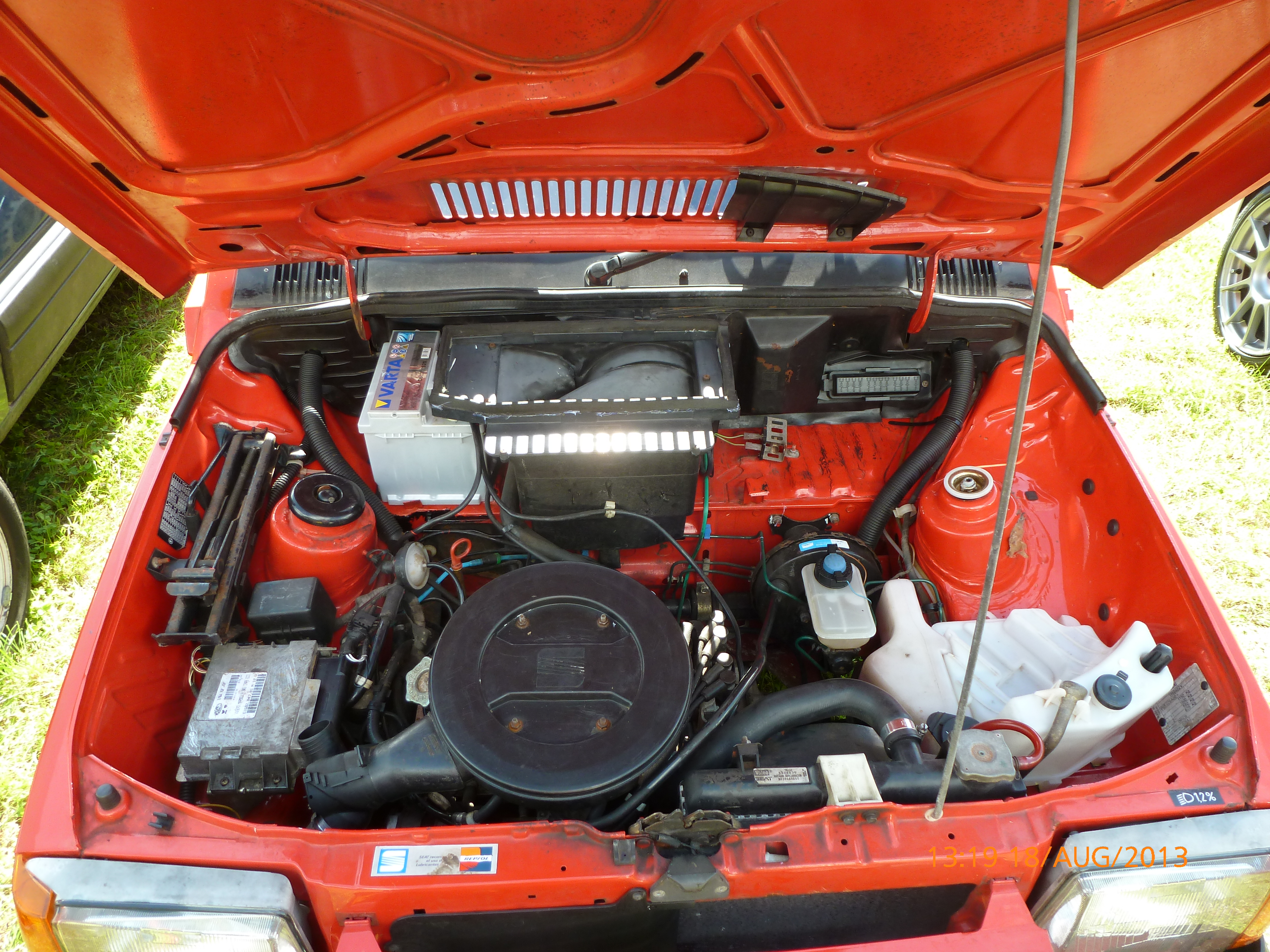

ahh well, i went to the scrap yard today to pick up a nice digital dash from a poor fiat tempra.
anyway while i was looking for the tempra i found a poor L reg white fiat cinquecento (with 30k on the clock and looked mint :( ). with it being an L reg it had the magic 6F ECU and engine wiring loom. so i managed to get both loom and ECU. oh, fuel pump and MAP sensor also.
i had a good look at the 899 engine. to convert the 903 i would need to use the rocker cover from off an 899 engine as it is used to mount the throttle body to the cylinder head.
now i am just making a list here of parts i will/may need to do this, feel free to add to anything if you think i have missed something.

whatever, this project is on! the marbella uses way to much fuel, and i do not have much faith in a "ECU controlled carbed system with a cat converter" every thing i have read about it says that they are prone to messing up.

If you want to convert a 903 do NOT use a cinquecento with the code system/code key. It won't work at all. You'll need a pre-1996 exemple.
The rocker cover can be cutted so the original Marbella one will fit, makes it much easier to set the valve clearance.
You'll need the map sensor, TDC sensor (as the marbella one doesn't work with the Fiat ecu) Lambda sond (4-wired) a 5 bar bosch electric fuel pump.
the wiring:
you'll need to cut the original Marbella wires near the ecu: it are four, and you only need the black one (12V from the ignition key) and the white-red one (the engine check light/sound).
Connect the black one to the brown cinque wire and the white-red to the white wire to make the ecu work.
Further you'll need a Fiat Panda 900 I.E. throttlecable, because the cinquecento one is way to short.
Did you take the ignition coils of the Cinque as well? You'll need them too, because the original ones of the Marbella won't work at all, as the coil cables won't do.

The fuel pump fot the fiat's spi is 1.2 bar, not 5 bar:)
John,I wonder why your marbella{ well your brothers} consumes so much fuel. When I measured the amount of fuel my 1991 pandabella burns, it was about 4.5l for every 100km, driving constant speed 90-100 km/h and about 5.5-6l when driving 100% inside city.Car is pre euro1 , simple carburator without messy ECU and cat. That is the reason why it works well probably? Some guys on the polish forum also have problems with high fuel consumption in their euro1 marbellas.
the high fuel consumption is a common problem with the ecu-marbella's. It is just because of the fact that the system is very delicate and actually doesn't work quit well. It actually allways runs to rich. Just by adding more air via a stepper motor on the front it should use less..
I used a 5 bar bosch pump, and the fiat injection does NOT run under 3 bars of pressure. It has an internal cut-off when the pressure gets lower. (that's what I found out whilst building my own Panda 34 Injection.
ginkelvanmichiel, my theory is that if i swap over "everything" from a cinquecento 899 engine, it should work just like a cinquecento engine. i have the places for all of the sensors to go already on the engine, and the best bit is, the cinquecento wiring loom looks like it will fit strait on to the cars loom using the 2 connectors i mentioned in my last post.
after all we are only talking about a 4cc difference in engine size.
i am hoping that the throttle cable from a cinq will fit. with us being right hand drive it gives us a little more slack. looking at the one i saw in the scrap yard, it seemed plenty long enough to reach.
i think that if i use all of the cinq's system (electronics and fuel pump) i should not have an issue
Well I didi it the same way, and whilst swapping I came across serveral issues, but they're tackable. The only thing non standard is the fuel pump. The injector simply won't run whith the mechanical pump fitted. You'll need an injection pump. But with that, it wil run perfectly. Not fast (due to the catalyst converter, and the acceleration tends to be a bit less with the injection) but it wil start every time you'll want it to :)
All original pumps for fiat spi, both bosch and magneti marelli spis were 1.1 or 1.2 bar, almost all cars with spi produced by bosch and marelli use 1 to about 1.5 bar pumps. 3 bar pumps are ok for naturally aspirated mpi fiats. Delta integrale uses 4 bar :) also some other turbo fiats lancias etc. 5 bar pump is used with bigger jets for tunning these engines to 300 400 hp.... In my opinion it is ok that you use 5 bar pump to feed 40hp marbella(y) but the factory pump is 1.2 bar.
