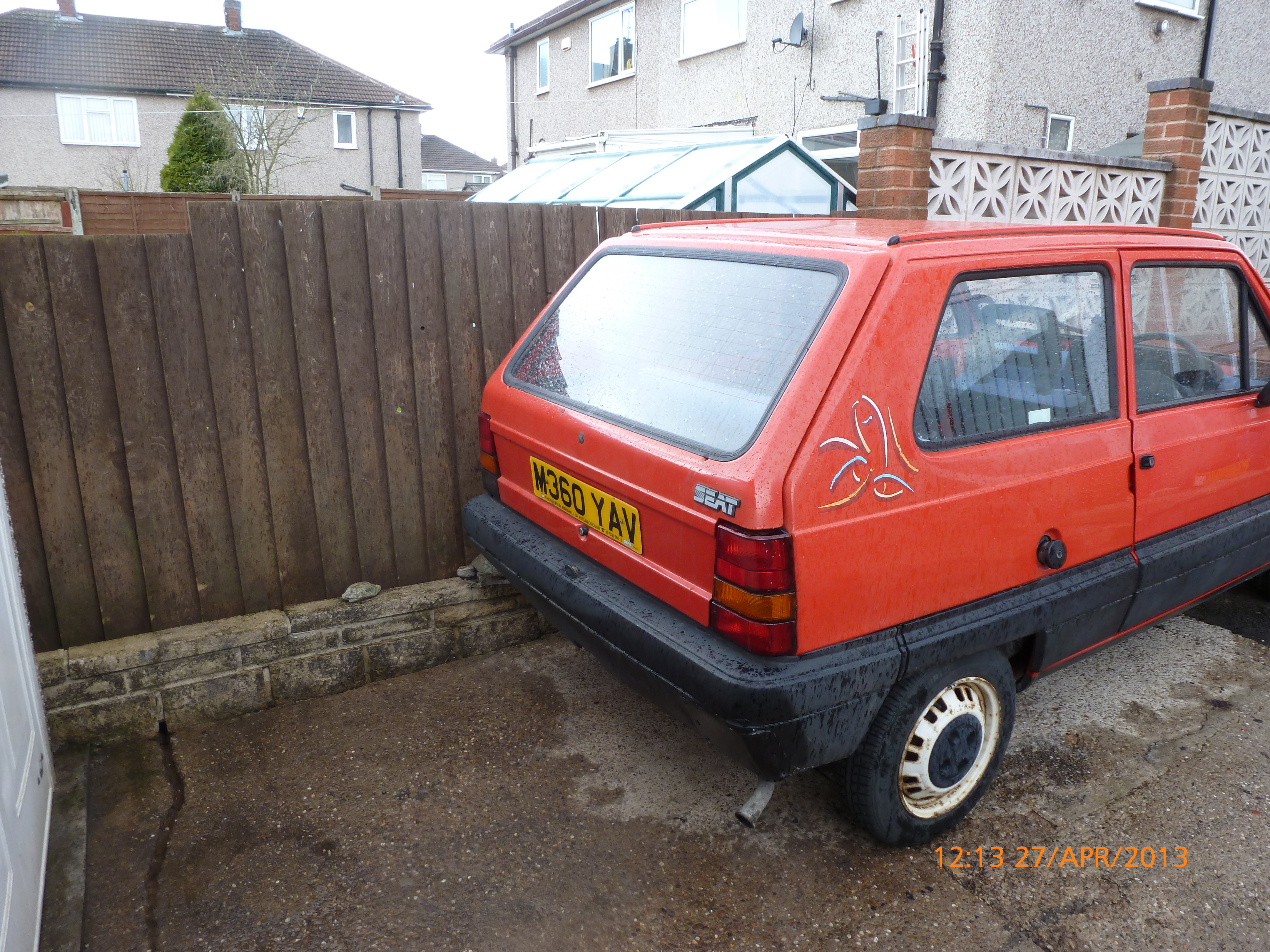

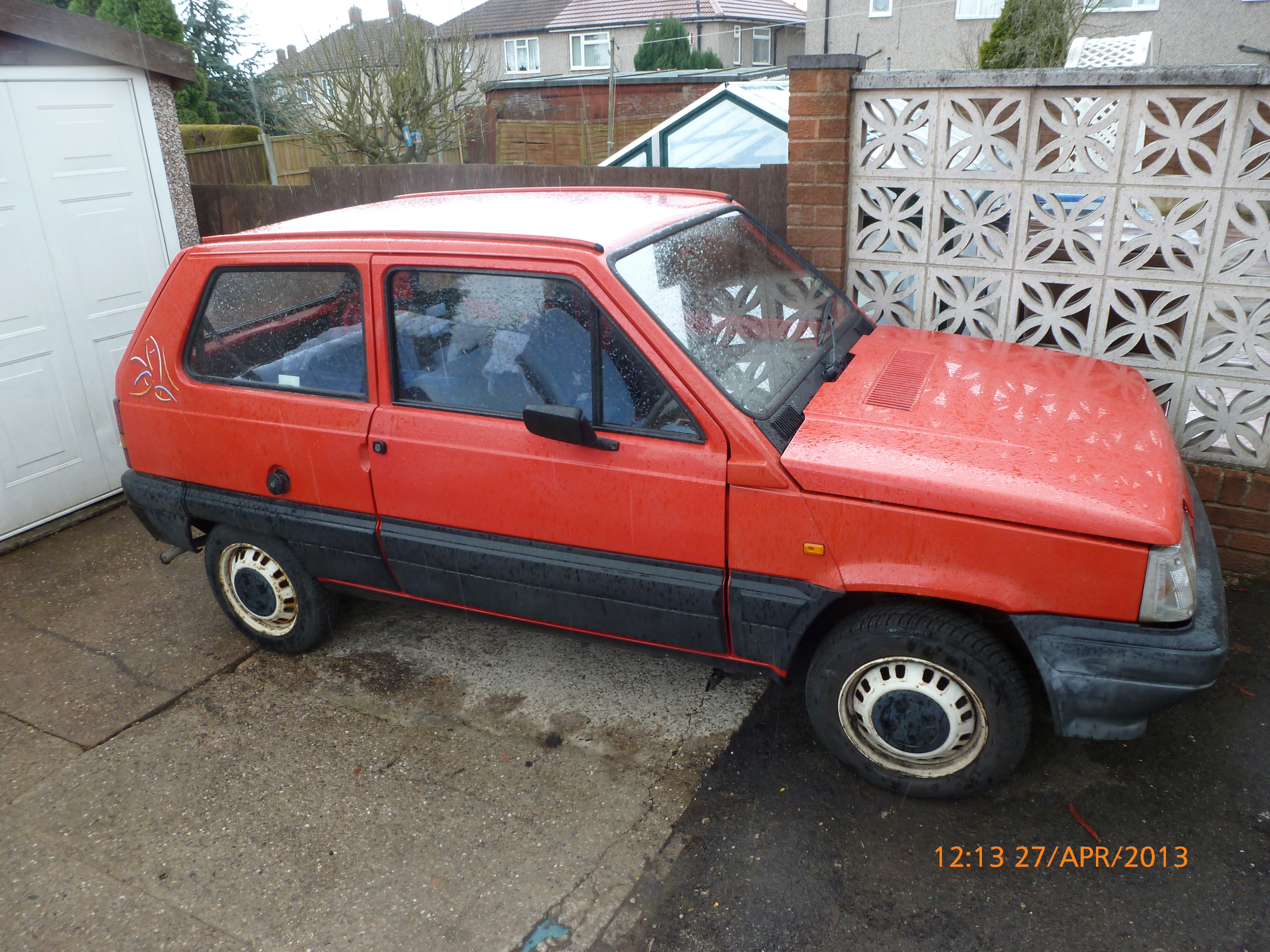

anyway i know you all love pictures so i just went outside and took some for you all, enjoy them :)
from the front.. whats that.. on the back of the car.. huh? is that a... :eek:
the back.. note the epic decal. makes you look twice >_<
underish side all still looks new!

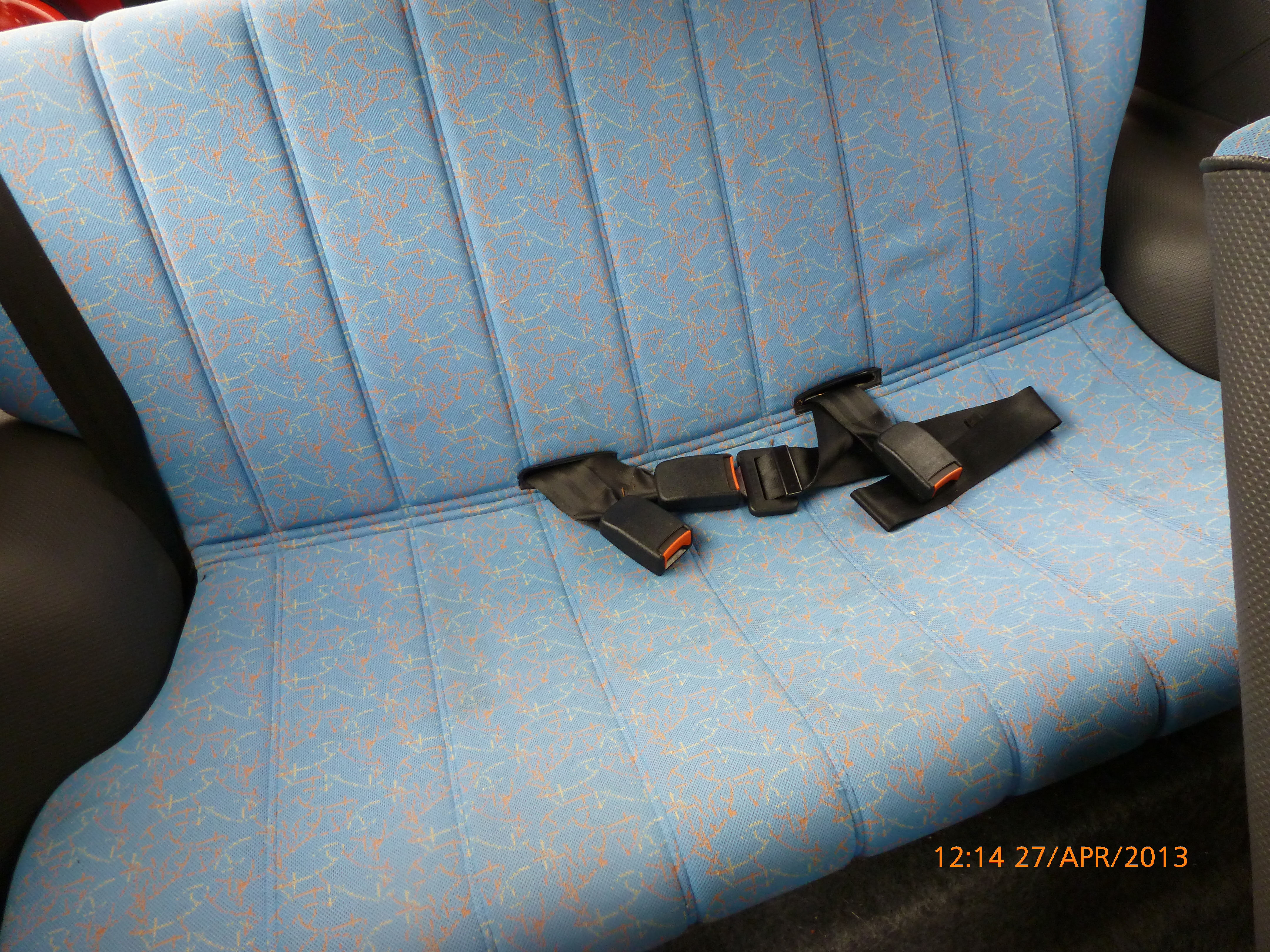

note how unworn the seats are ;)

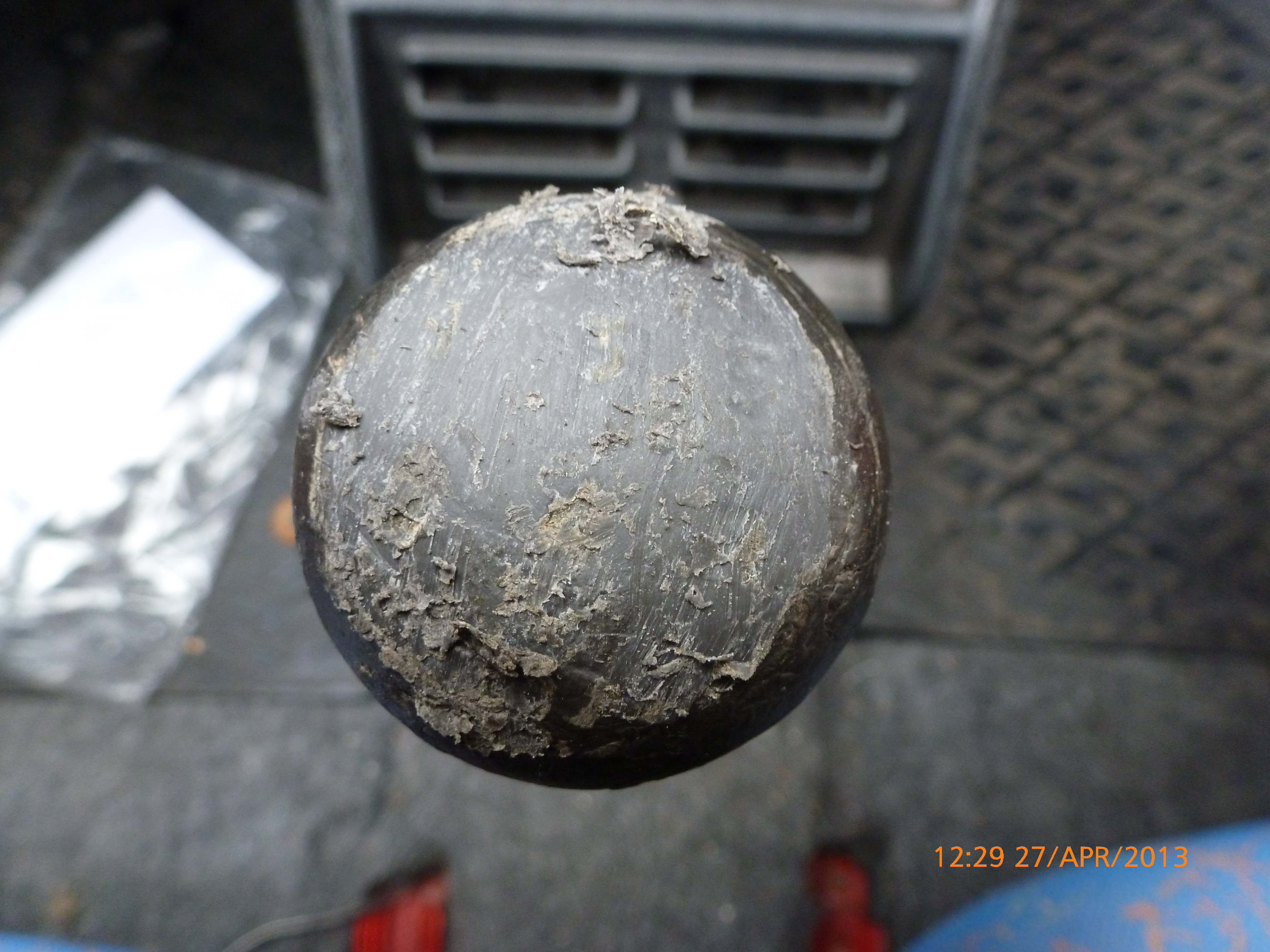

yucky gear stick.. need to clean this. but i fear the plastic has degraded :(

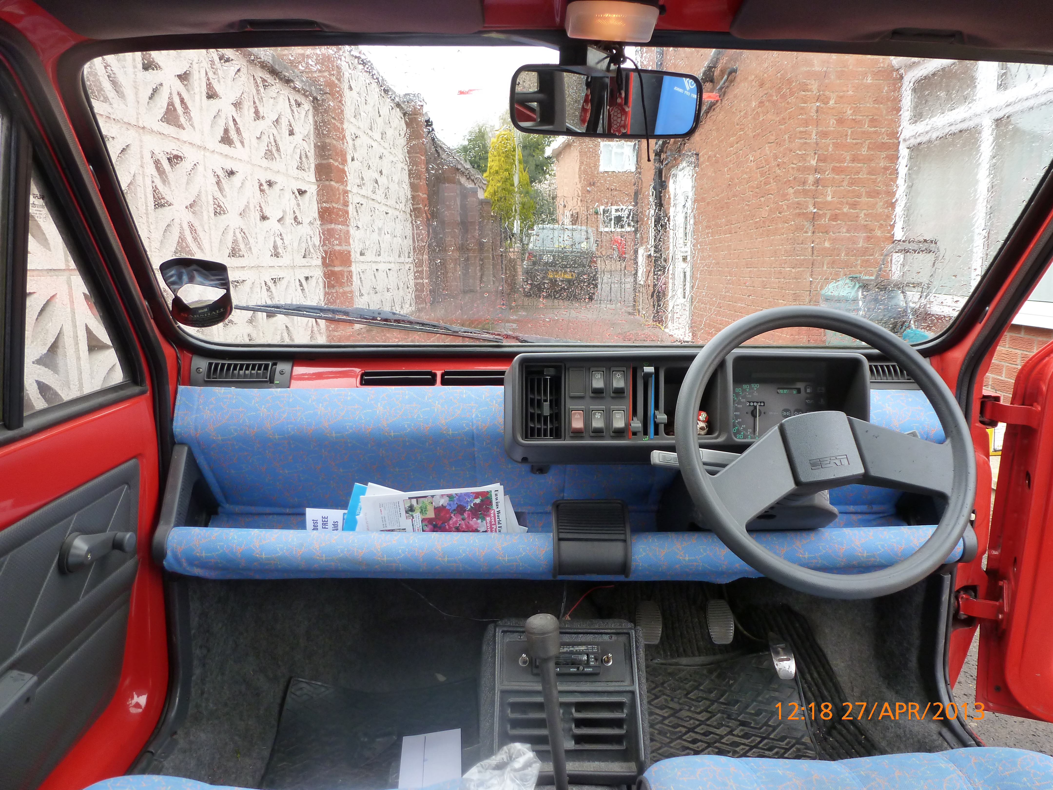

Driving view:
