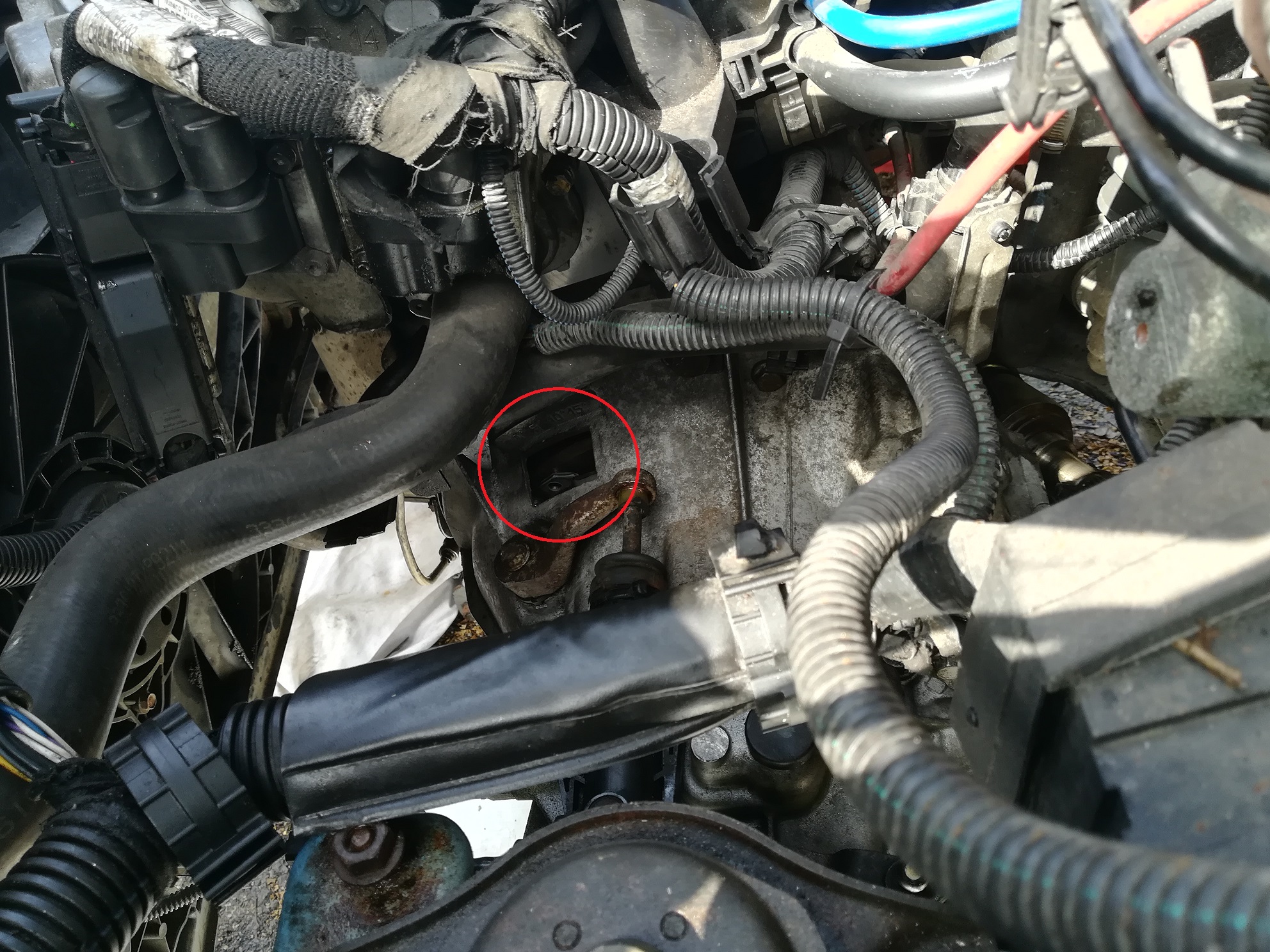

Before changing the clutch, stick a finger inside this inspection hole on the bell housing:
If it comes out oily, the input shaft bearing has probably given up, which could be causing the noise, rather than the clutch itself. It seems quite a common issue on these gearboxes.
Thanks, the pedal feels fine and the car drives OK. The inspection hole was dry so fingers crossed just a new clutch etc needed.
