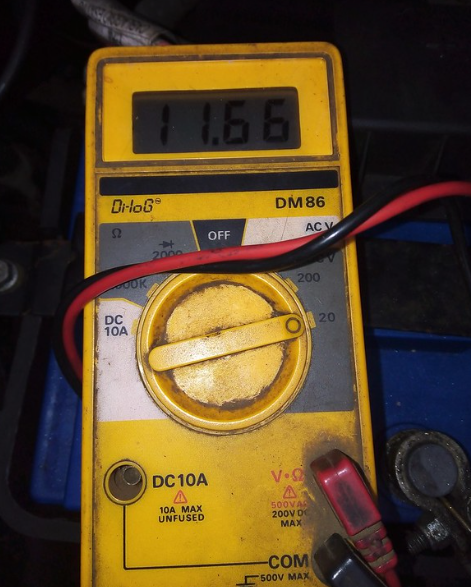

Many thanks here for all your kind help and apologies for length of delay resonding back to you all as one does not have a regular internet connection. As for my car battery well on Friday 16th December 2022 the battery failed and took it out and charged it again on a sealed charge instead of the standard that I did the last time and it took between 3.5 to 4 hours to charge and put the battery back in Monday 19th December 2022. A friend came to mine on Tuesday 3rd January 2023 and took a multimeter reading before the car was started (a resting voltage is the correct name is one is correct) and in the photo is the reading so took the battery out and under my warrenty got a new battery (same make/model) and put back into the car. My biggest worry is even though a new battery is how long this one will last as the previous one was 11 months old when problems started. Massive thanks to you all here for your kind help.
Remember to keep your battery at least 50% charged. When it’s so discharged that it won’t start your car the damage has been done. Perhaps you should consider buying a cheap multimeter and keep an eye on your battery voltage in periods of low usage. Batteries will vary a bit but I would certainly try to keep it above 12.2 volts.
depending on where you got it from, sometimes "brand new batteries" can have been sitting about on a shelf for years somewhere before they are eventually sold. The sort of places that sell them tend to have a lot of dust and dirt in the air so we think nothing of cleaning off the dust. But if they have sat around or worse been knocking around for a long time they can deteriorate badly.
11.6v suggests one of the cells shorted internally.
