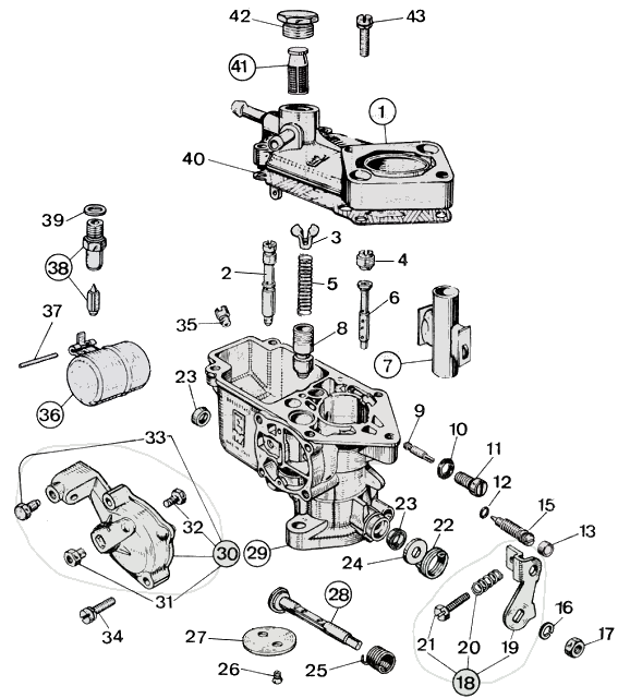

Here is an exploded view of the carburettor. Part 9 is the idle jet. Remove screw 12 (with rubber O ring 10 attached) and the idle jet should come out with it. It is on the face of the carburettor you can see when you open the engine bay.

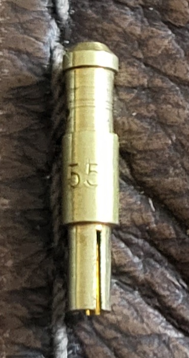

50 is the right size, though 4 turns out is too many. Try it at 2 full turns (720 degrees). Also see what effect the choke has at this setting.
Towards 2 turns (from 3) it started to run rally bad. First time turning anything on a carb for me, so i have to figure out how to do this exactly. Mayby the motor was still to cold (i let it run idle for 10 minutes before tuning.) First i set idle to point that generator Light was coming on, than adjusted mixture to point it started running bad 2 to 2.5 turns out and stopped at 3.
