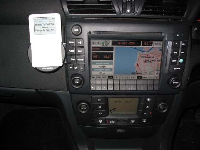

Just cobbled a make shift bracket together (washing up liquid bottle and a mouse mat) to come up with this more or less final effort.
Current software does not support track ID on the headunit but all controls work. (but not shuffle :()

In case others are wondering ... lardarse's routine is as follows
dock ipod in cradle,
turn on ignition and wait until "No CD" is displayed
THEN start engine
"CDC Scan" comes up and takes ages (5-10mins)
then turn Nav+ off and back on again.
Now back to Dension for the remaining problems!!

sorry for the long delay - I'm moving house at the moment. ipod screen shows the track being played. no controls on the ipod work, but there is sound.

But do all of the head unit and steering wheel controls work? If so I think you've cracked it mate,

They do! The only flaky sapect is Shuffle which will only work for 100 tracks

In this repect its better than the normal CD! Yes - it remembers exactly where you were up to last time you used the unit - altho you need to press play twice for some reason before resuming.
