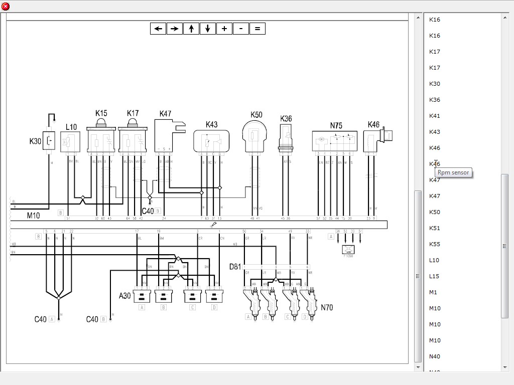

Disconnect the battery then disconnect the electric couplings from ECU and use spray for electronic contacts for clean the electric contacts from ECU and from ECU connectors. As you see on diagrams the K46 is the rpm ( speed ) sensor.
Use the spray also on K46 connectors. Do not use WD40. It is good ideea to clean also the connectors inside the engine bay fuse box. I use Liqui Moly pn 3110 spray because it contain silicone oil and protect against moisture.
