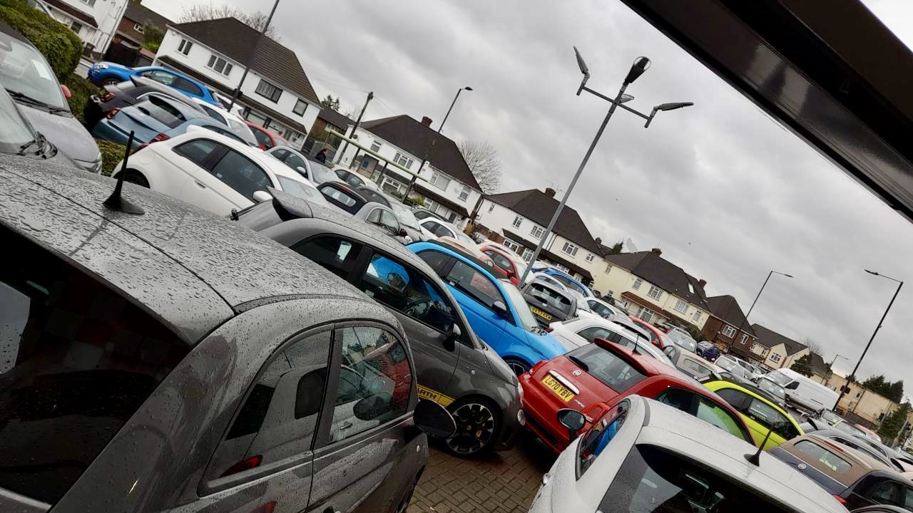

they must have had 100 or so 500s on the forecourt!

Replaced this morning. Did have a courtesy car booked, but when I arrived she said they can do it straight away. One garmin TIPO in the showroom and a hundred or so 500s. Of course straight away was actually all morning, two cups of coffee and a packet of biscuits. Never had a car new enough to have warranty repairs free before!
