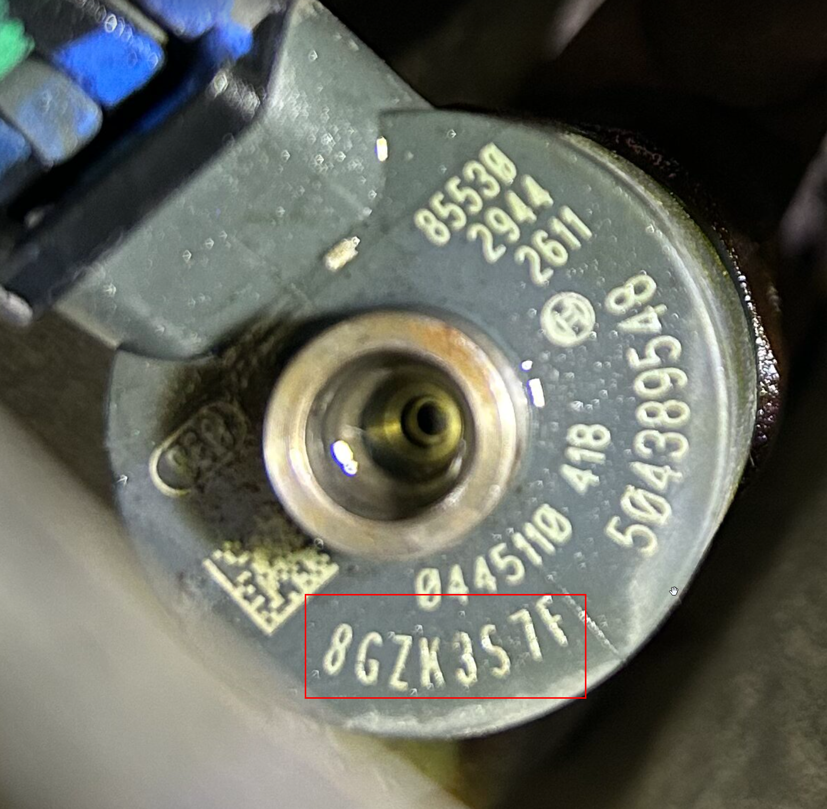

-> Ducato 2017, 177PS, F1AGL411A
Due to injector replacements, I tried to key-in new injector codes. AlfaOBD only allows to enter 7 alfanumeric digits while the code is 8-digit. MES notes to key-in 9 digits but also just allows 7 digits.
Has anyone a clue what to do to enter new injector codes?
What format are you old injector codes in?
Post photo of old injector showing numbers?

Understand. These injectors came with replacement engine.
Engine has correct motor code F1AGL411A and injectors are originally mounted as far as I can say.
BTW: Im driving this motor 2yr now, knowing of incorrect injector codes with no issues.
Someone else has previously had the same issue and the last figure on all injectors was F. They used the first 7 figures leaving off the F and had no problems.
I know im late to party still sufferering from black death .
you have correct injector and all injector seem to have the suffix F.
this injector is now obsolete and replaced by 0445 110 520 though took a while to sort out. fisrt off my order was refused as being wrong then reorder and changed to new . heres my old one 2017 2.3 130.
