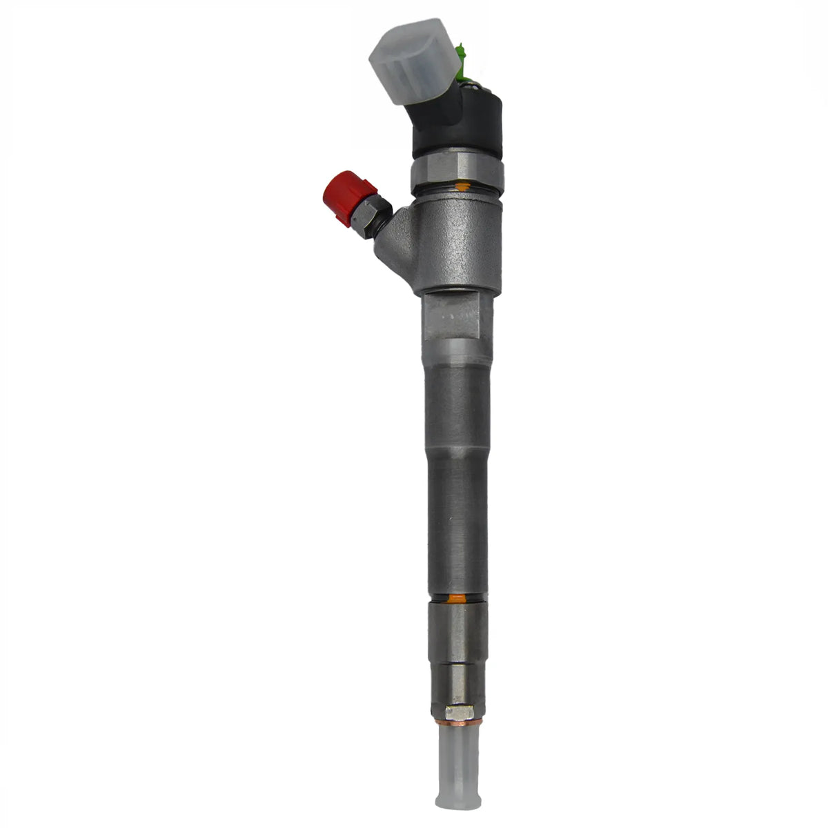

Check out this site. I have bought from them. Fantastic service
Hi Steve,
Thank you for your advice. It seems that a decent pricing is their streght also.
I’m not sure about the part number. I think my multijet needs 0445110273 injectors and there seems to be something else installed at the moment. I’m also wondering if those 0445110418 injectors might be slightly different too?
