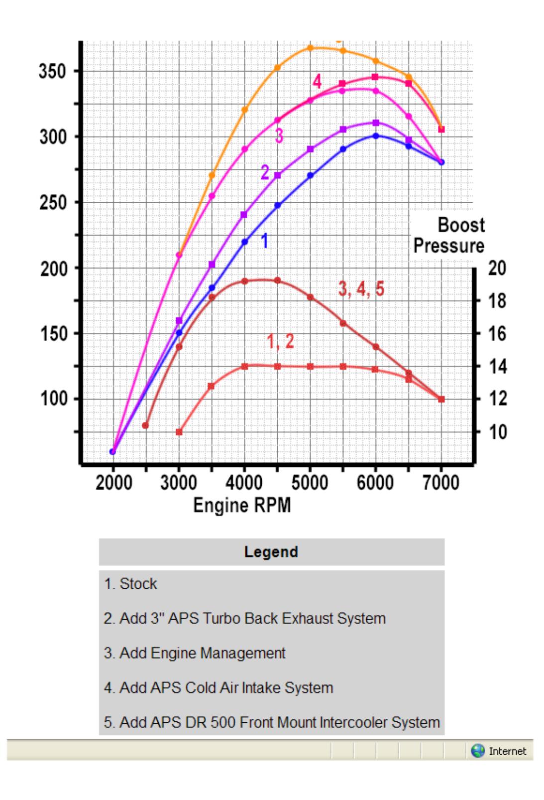

H, thanks for the comparison - interesting reading. I'm just concerned that the filter is only fed from air which has been through the radiator on the Panda, it's really quite well panelled in down there.
got any proof RR print outs? scan them in and post them up then.
Here's one:
I appreciate constructive criticism. And I try not to dismiss your points.
The problem with the 100hp is to start with space and a proper cold air feed is not as easy as some people think. The reason why hot air is less effective lies in the fact that it has got less density. Colder air would give a higher VE.
An cold air feed cna be much more tricky to deal with. Much bigger names than GSR suffered from similar problems. The Ford GT suffered from cooling problems, which did not make sense to the designers, where the air ducts were in the frontal area of the car. The reason wasn't the getting of air in. It was getting the air out. Unwanted turbulences created at higher speeds considerable problems. Some tiny lips at the exit in the bonnet solved the problem, but took 2 years to discover.
The Noble M400 suffered from similar problems.
In theory the cold air feed is a good idea. But in practical terms it has been in most cases better to draw still air despite the fact it might be slightly warmer.
