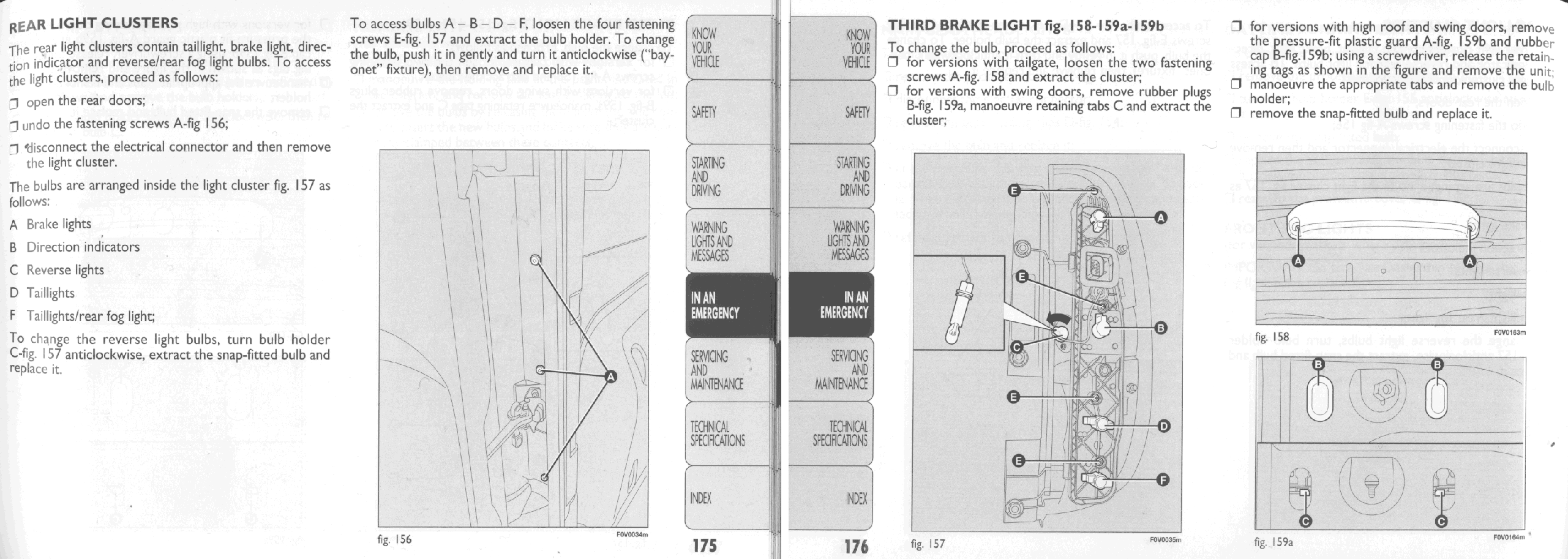

These pages are from the manual for a 2012 model with twin rear doors:
As Vcrazy says plug to light cluster corrodes\ burns can produce all sorts of faults
Light comes off easy 2 or 3 ST & a 17mm well on ours 57 plate, note there is no mention of nut in instruction
