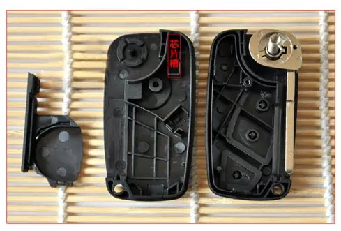

There two different types of blue remote key for early fiats (not including two and three button)
1/ the battery is in a tray beneath the key blade
2/ the back cover slides in half to reveal the battery
Make sure you order the correct one
The guts aren’t transferrable between the two
Here an example of the two types
Make sure you order the correct one as listings on both eBay and AliExpress are misleading

I posted a picture of the two types

All mine have had the type were the battery goes in the back not the side
I left it up to the original poster to pick the correct type.
The innards aren’t transferable between the two

I have had three 05, 06 and 10
All have the battery fitted at the back
The one you linked to has the battery door at the side
The parts aren’t transferable, and if you tried you would damage the PCB useless as the transponder chip would break off
The one @RalphM posted is correct for most people
