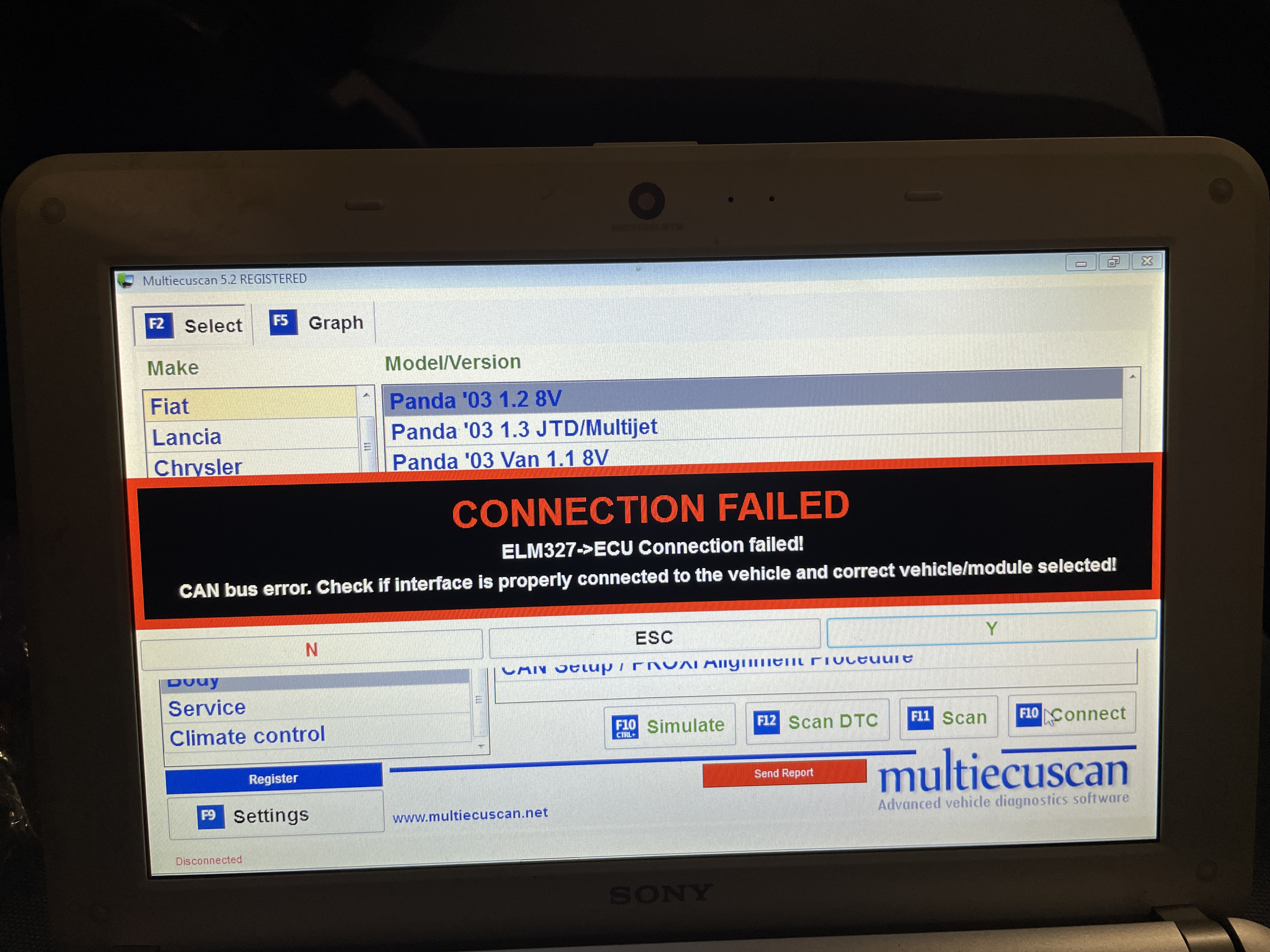

do i need one of the coloured connectors to connect to body control?
I can connect fine to engine but get an error when trying to connect to body
No
Not if it's an ELM 327 interface but does need to be the full version
Well thats what it says on there website it but I haven used MES in years, hopefully I have read it correct
Thanks
Yeh its an elm327 and can access the engine fine
It is the full version of mes too

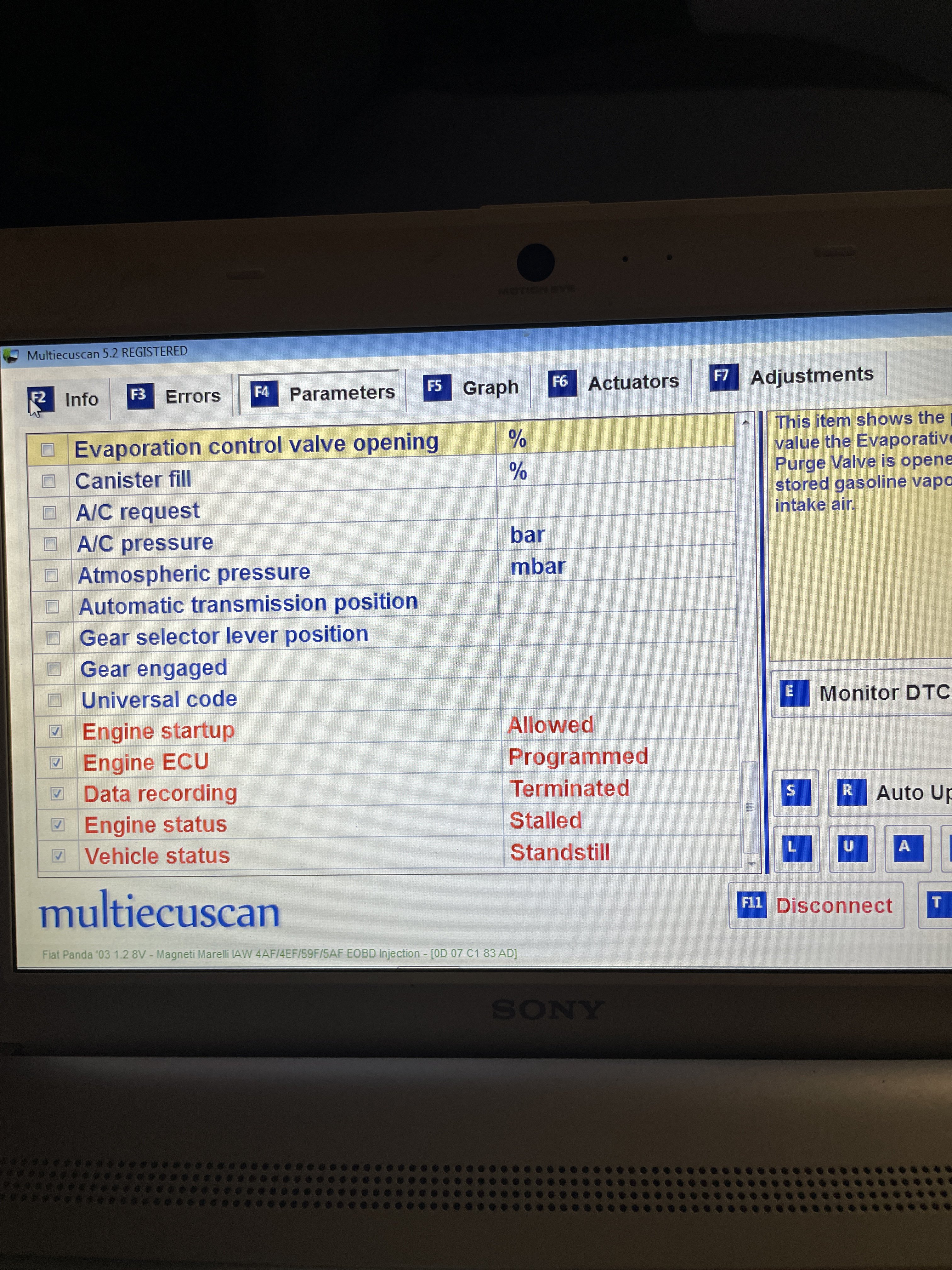

In the engine section of mes there are values for engine start etc
And i recorded what they do as i try to start it

This is the mes error i get when i try to access body but same setup lets me access engine
That's good it's telling you there is a network communication error, I forgot if it need an adapter it will tells you
Whether is a fault with your ELM327,the software or genuine, I can't say at this stage

Same mes error when i try to connect to my other cars bcm
I not an expert in multiECUscan as I don't use it
But if it connects to the ECU module that does not use the canbus
It sounds like you have the wrong resisters in the interface, very common
First check with ELM compatibility tester on the app store or Google play if all is okay
Then it's fairly simple to modify to work, normally just removing a resistor is enough

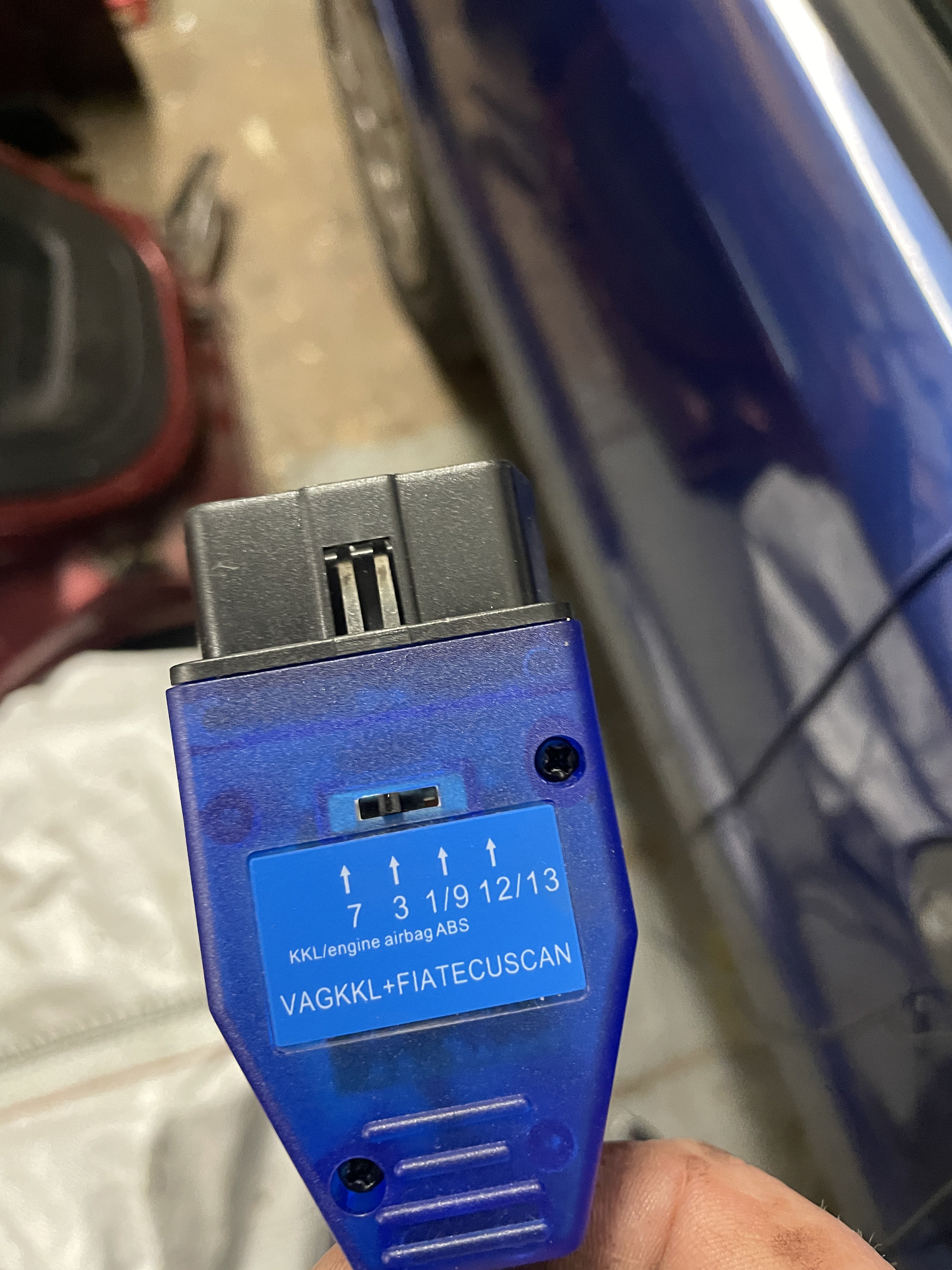

I will start with the simple stuff first
The blue interface cable will not connect to the body computer this needs to be canbus
The blue cable is KKL only
An elm327 will do both the KKL and canbus
I have one of those KKL cables they work very reliably, by flipping the switch you can connect the the airbag module and a few others
